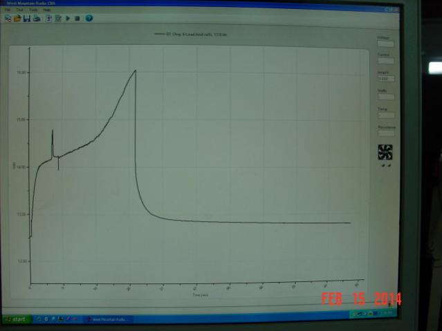

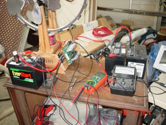

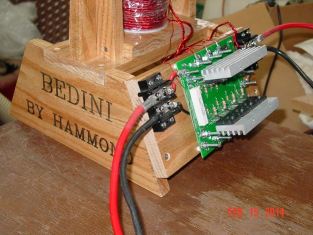

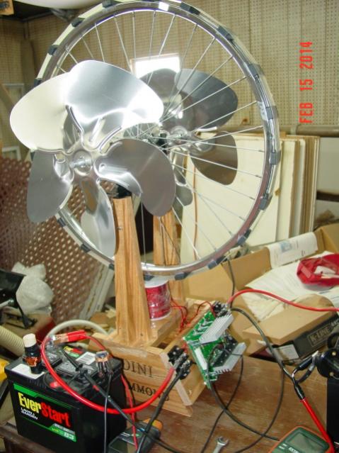

            I have been out of town ever since I posted my test results, until a short while ago. I just now started a one amp discharge as you requested at 7:30 PM here (central standard time, USA). I will stop it in exactly one hour and then let it rest for another hour and report the resting voltage as you have requested. It was resting at 12.69 volts at the start of this discharge having fallen from the 12.80 volt reading an hour after the reported charging. 12.69 is it's normal fully charged resting voltage after four or five hours of rest for this particular battery.
            I don't usually post videos, only pictures. I was going to post pictures of the recorded charge curve, but the battery in my old camera was dead and my wife was ready to leave town at the time.
            I'm not interested in "TOP STAR" or "winner of this thread". I'm only interested in sharing the results of my new ssg. I have performed this exact same test several times with my "second build" ssg in the past, and it always took 40 minutes at 2.0 amps from the primary batteries to recharge the one AH previously withdrawn from the charge battery. That equals 1.3333 AH to replace 1.0 AH for a cop of 0.75 . This was even with out the fans, as it was only turning a 26" bike wheel at smaller extra load.

            • #36
              Hi hobbyrobotic,
              Like I promised, I took a voltage reading an hour after discharging the 1 AH. (I actually went 3 minutes over the hour at one amp for a total of 1.05 AH discharge because I wasn't watching the clock close enough ) The voltage reading was 12.50 volts and climbing. I'll check it again mid morning tomorrow which will be about the same rest time as it was after the first one AH discharge. It will probably recover more over night like it did before.

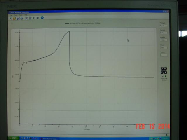

                              Hi hobbyrobotic,
                              This morning the charge battery was resting at 12.52 volts, so about .06 volts less than after yesterday's discharge. It got to 0 deg Fahrenheit outside here last night and my shop dropped from 70 deg F to 63 deg F as a result. Don't know if this had any effect on the voltage or not.
                              I ran another charge as well and this time it took 35 minutes @ 1.6 amps from the primaries to bring the charge battery back up to 16 volts. Then after another hour it was resting at 12.79 volts. Thats .9333 AH in to replace 1.05 AH removed for a cop of 1.125. Again, the energy to run the wheel and pull the two fans was not figured into the equation. The actual cop would be higher if this were added into the equation.

                              • #45
                                Thanks Gary, those are the numbers I would expect from the machine. They are pretty close to the numbers we got in JB's shop with the bike wheel kit.
                                Anyone should be able to get these numbers, just build it like Gary has
