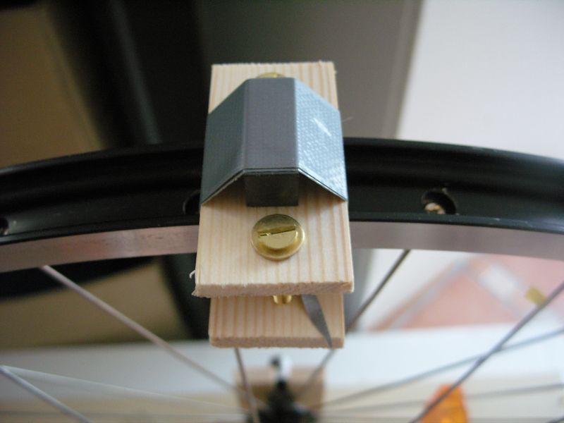

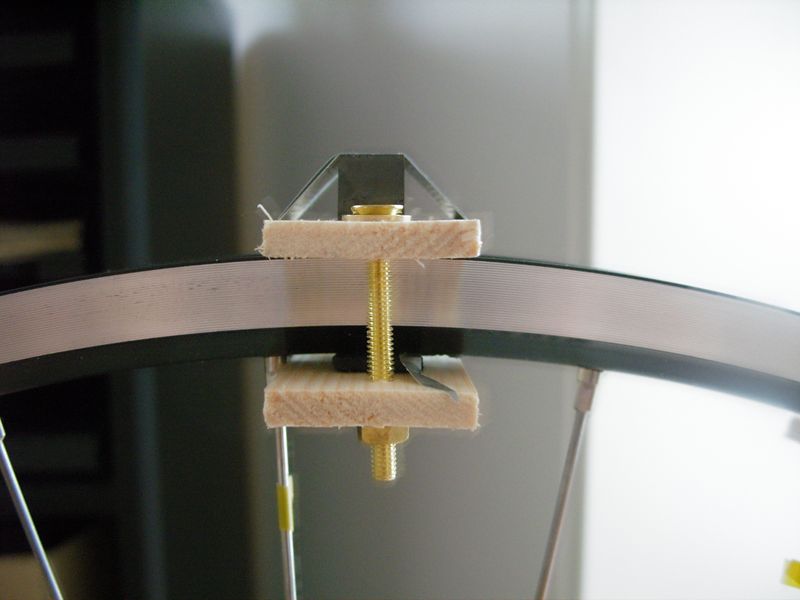

        here i post my version of fastening magnets to the wheel,...
        in this case, without glue, without tape around the whole rim..
        so i can adjust position if i want, reuse the wheel, reuse the magnets,
        interchange magnets with other magnet sizes
        (in its dimensions, for more bigger magnets it would need new expanded wood stripes)
        i used wood, brass screws, brass washers, magnet.. and tape..
        and rubber strip between lower wood strip and inner wheel side..
        against slipping under forces
