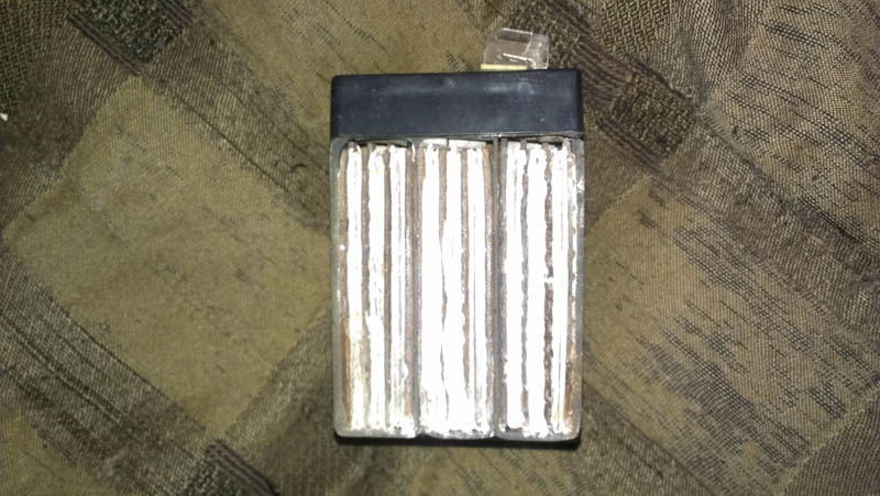

        I thought I would show a picture of the inside on one of them. This battery was left outside all winter and busted from the freezing but you can see the plates and separators. This is a small 12v 5AH...
