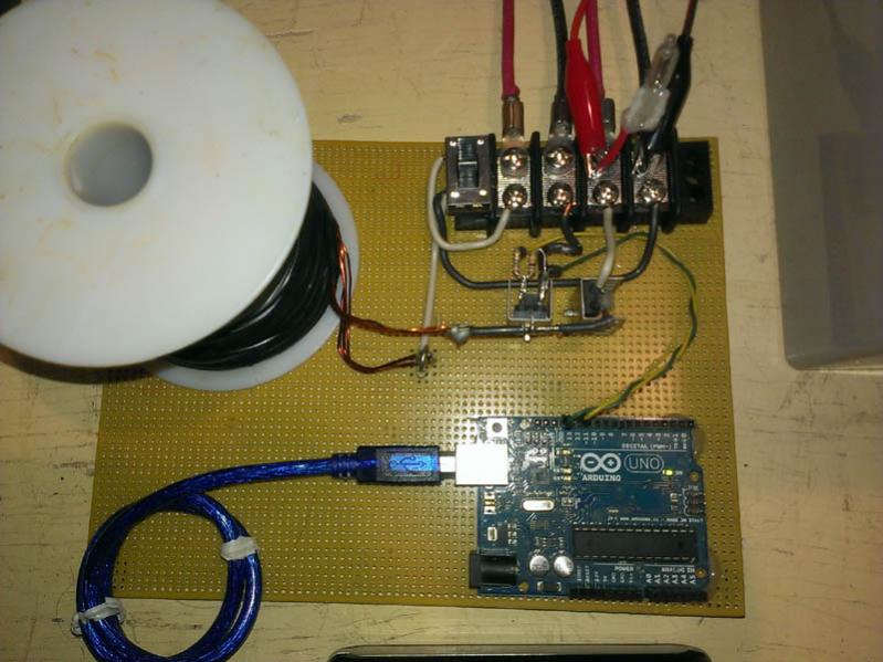

I have a new board to share with the group.
This is as close of a replication of FIG.1 in Mr. Bedini’s Patent #US7990110 as can be obtained with automated switching. Mr. Bedini’s diagram is meant to explain the process of obtaining a spike and mechanical switching is represented. I have replaced the mechanical switch with a FET and a micro controller but no other additions have been made.
Here is a picture of the board:
[ATTACH=CONFIG]3559[/ATTACH]
The coil is fed at the “top” end from the primary pos.
The “bottom” end of the coil connects to the drain of the FET, the source of the FET connects back to the primary neg. This is our switching point and it creates our closed loop.
Extended from the drain we have the anode of the diode connected and the cathode connects to the charge Pos. This is where the spike appears and is our open path.
The charge neg is connected to the Primary Pos.
I have a 75V Neon across the charge POS/NEG which is not necessary for the circuit. It is only there as protection and as an indicator.
The Gate of the FET connects to the microcontrollers logic signal (5v 20ma) through a 150 Ohm resistor. There is also a 10k Ohm resistor from gate to source.
The switching is then controlled by programming the microcontroller with ON/OFF periods of the logic signal. The power source for the microcontroller is external to the circuit; I use USB battery phone charger to power the board currently. The estimated draw for the triggering is about 40ma; 20ma out for the signal and 20ma is used up by the chips onboard.
This circuit is exhibiting some very interesting properties which I have not seen on other builds. For example it self adjusts to the load!
It feeds the charge battery at precisely the correct pace to achieve a perfect charge, simultaneously self adjusting the draw from the Primary.

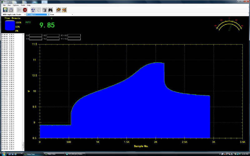

I have a charge curve to share with the group.
This is a 9v Ni-MH battery, the small kind you use on multi meters and smoke alarms. I wanted to show that this machine when properly tuned is capable of charging everything from the large deep cells down to a tiny little 9v and does it well.
Here is the chart:

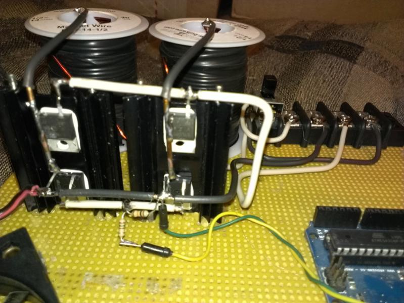

This is version two of this design. The first one was meant to be a prototype and as faithful to the FIG 1 diagram as possible. This new model is expanding on what was learned.
This model has two separate coils of 14AWG @ 40ft. The tops are connected parallel to the primary POS and the bottoms go to separate Diode/FET configurations. Each bottom connects to its own anode/drain. Then on the back end the cathodes are bussed together and connect to the charge POS. (See picture). In a way the whole thing is parallel but not really because the FET’s are each handling a coil before the parallel bus.
I used some larger heat sinks on this build and mounted diodes and FETs as a pair on each. Heat is not an issue with this system unless driving it pretty hard which I have not needed to do. I did when I was first finding its proper tuning however. I still have the fan on the board and continue to hook that to the primary.
Here is a picture from top side:
And this is a front view with the fan removed so you can actually see the circuit:

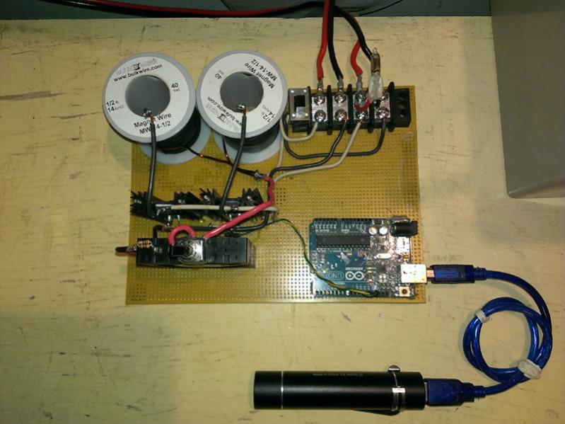

Hi guys,
I did not forget about this, just been delayed. I lost my original program for the timing so I have been tweaking on that before I can show the new configuration.
James that sounds interesting. I have thought about using a raspberry in my projects as well.
The new version of this board is not really all that different but Istill want to show it. I replaced the original fets with a solid state relay. I like the relay so much I have thought about making a mechanical machine that uses them.
I will try to follow up soon on the modification to this board.
