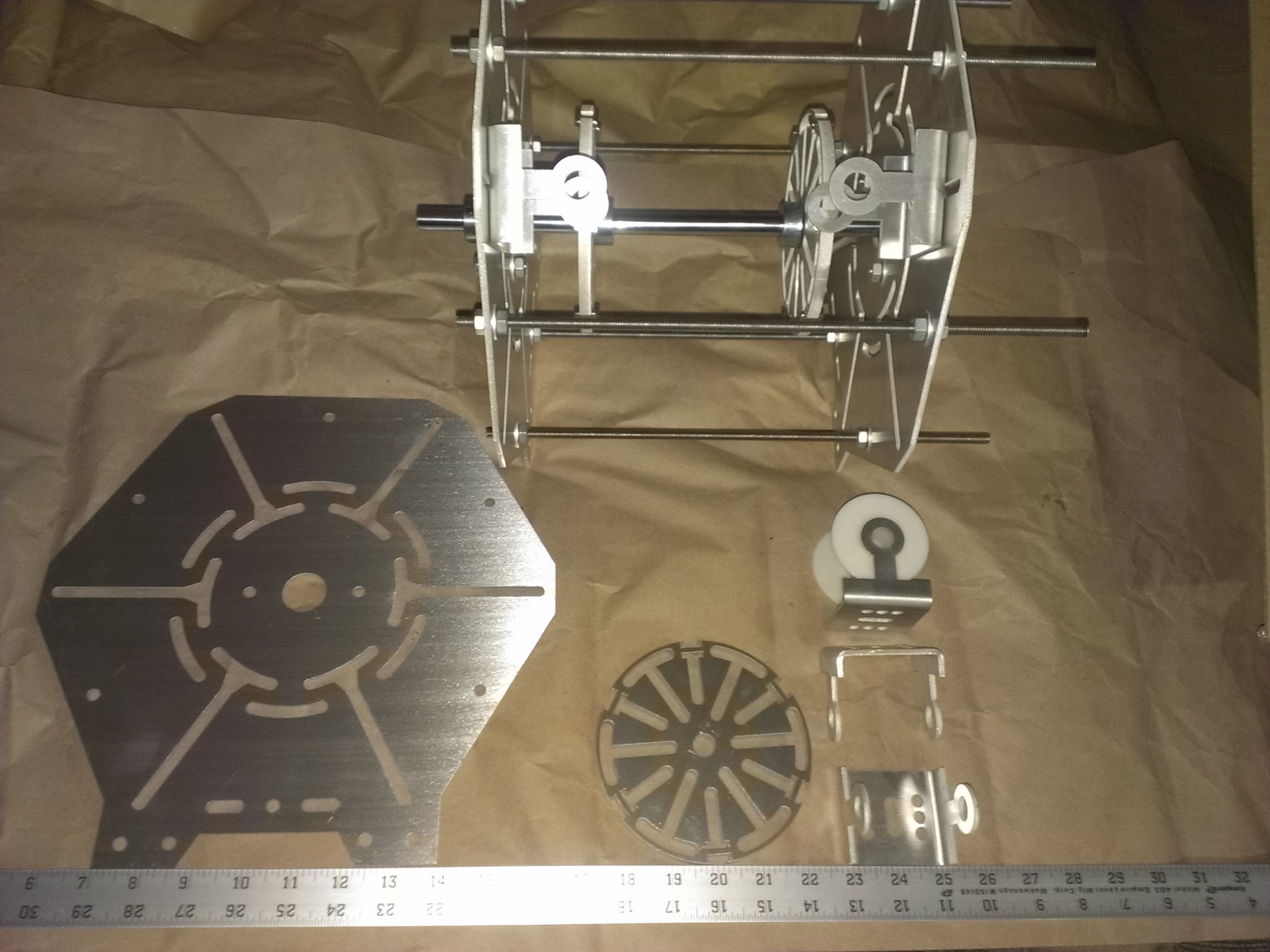

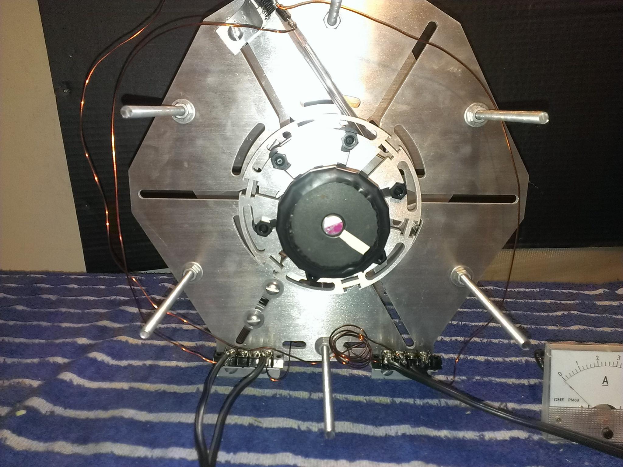

This machine has a frame of just under 12 inches with 5 inch wheels. When it is fully populated I have room for 12 coils, 6 in the front and 6 in the back using two wheels. The screws and nuts, threaded rods frame and wheels are all aluminum which did drive up the cost a bit but I expect this thing to last for a very long time.

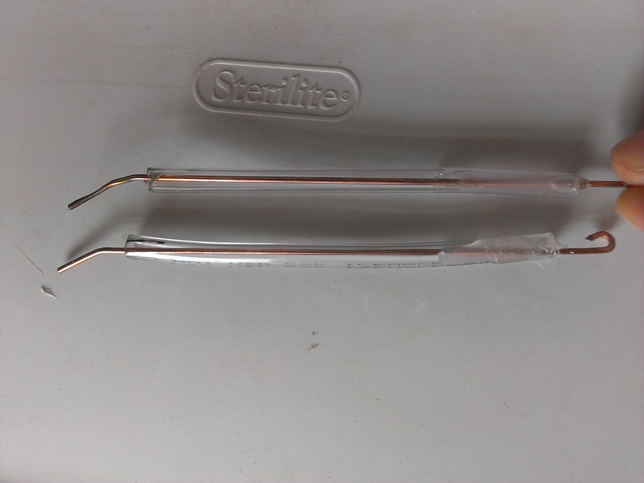

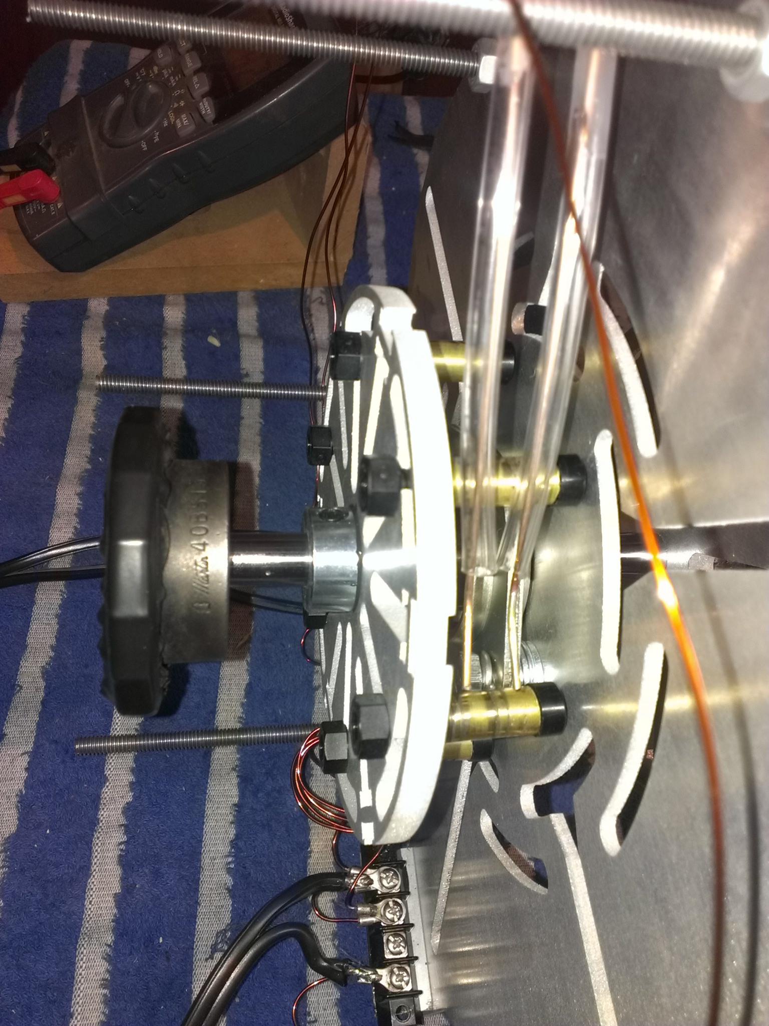

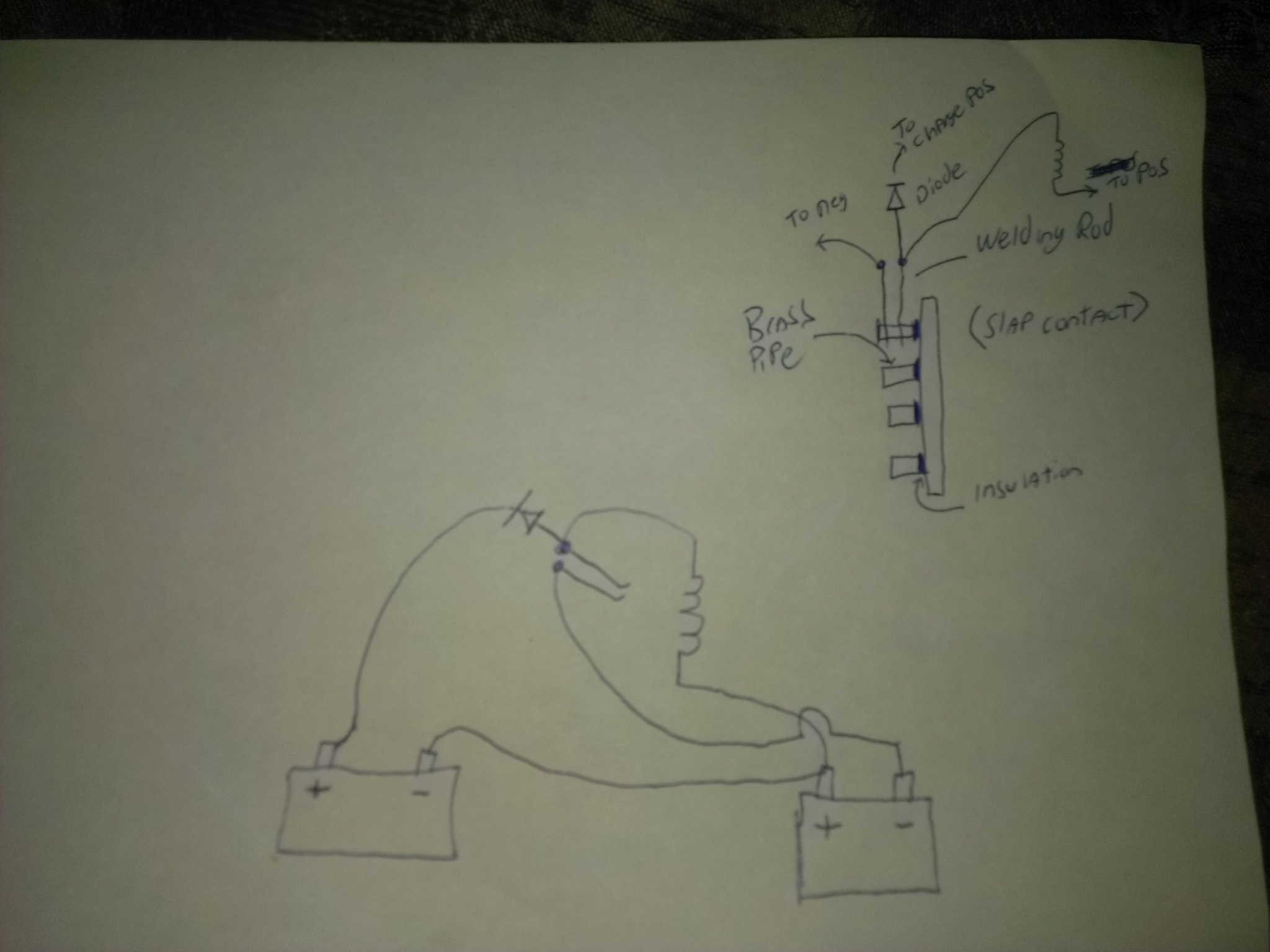

This machine will not be using transistors for the switching. I have been testing some different methods and I think I have found something that works pretty well. I use welding rods as contacts and some brass pipe which I cut into 1 inch pieces. The brass is mounted on a timing wheel with plastic posts and rubber washers to keep the current isolated from the machine. I know this will wear down but that doesn't bother me since I can just replace the rods as needed. I have only had it running for a day so there is much to learn about it going forward.
