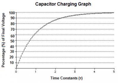

    I've been doing a lot of cap discharging as well recently, in fact my brain is a bit fried from it all. I'll mention a couple strange things I've seen, really I have been reduced to just making and breaking connections by hand to be sure of what I was seeing. So I took a 0.1 uF cap charged to about 18 volts and discharged it into a 470 uF cap. The voltage reading on the 470uF cap would then be 0.0036V. Now of course if you discharge that same cap through either a Bedini set-up or even just throwing a backwards diode across the small cap the ending voltage on the 470uF cap will be a decent bit higher than 0.0036V. However, what should the voltage in the 470uF cap be given that you can calculate the power in the small cap from 1/2cV2. It is just a bit of simple algebra and I must have done it 4 times before I trusted it. The voltage in the 470uF cap should be around 0.268 V, from memory, but again it is simple algebra. This gives an energy transfer efficiency of 1.3%. This is why I was doing things by hand and rechecking math, what the heck 1.3%, along with scurrying around the internet for info on discharging one cap into another it also occurred to me to try discharging the cap twice. In this case the first pulse moved the 470uF to 0.0036, the second pulse to 0.0072. So how about that! The 1/2C will remain constant, if we call the 0.0072 as 1 then the second pulse would be 2 so the energy in the cap would be 1 for the first pulse 4 for the second. the two pulses were twice as efficient in power transfer. And as 3 of 4 units of energy came from the second pulse the second pulse was 3 times more efficient than the first. Hey were up to 3.9% power transfer efficiency from pulse one to pulse two. This improving pattern holds through five pulses that I did by hand. At this point I went and looked at something I must have seen years ago, that is the capacitor charging graph as a function of time, just sitting there right under our noses.
    This graph shows capacitor charging per constant units of timeClick image for larger version
    Graph from Learning about Electronics http://www.learningaboutelectronics....r-charging.php
    So from 0 to nine volts takes 2 units of time, 0-18V four units, 0-30, 7 units. Knowing the energy in the cap is proportional to voltage squared you can deduce the relative efficiency of how the cap charges at different voltages. Realizing as well that as the cap fills the voltage difference between the DC source and the cap diminishes it is clear that the more efficient charging is not in the bottom third of the caps voltage range it is in the top two thirds top half I am guessing from 50-80% of the caps rated voltage. It is also not a small difference, so as I said this has sort of blown my mind as a whole nother aspect to things. I haven't heard that the charging graph is specific to electrolytics so I am guessing this is a property of dielectric charging. The two questions I have right now are what does the graph look like if you have an input voltage of 100V into a 20V cap. I would suspect it looks the same until you got towards 20 volts after which you would just be wasting an 80V discharge up against a full cap. Similarly does the graph look the same for a 20 Volt input into 100V cap. I.e is what is going on in the cap or is that as long as you haven't exceeded the voltage range of the cap you will see the same sort of graph with 1 or 99 Volts? By the Way, while it doesn't explain the lost power in a two capacitor paradox, I suspect it might account for it, that is it is less efficient to charge the bottom half of the cap.
    Enjoyed your vid, Ciao.

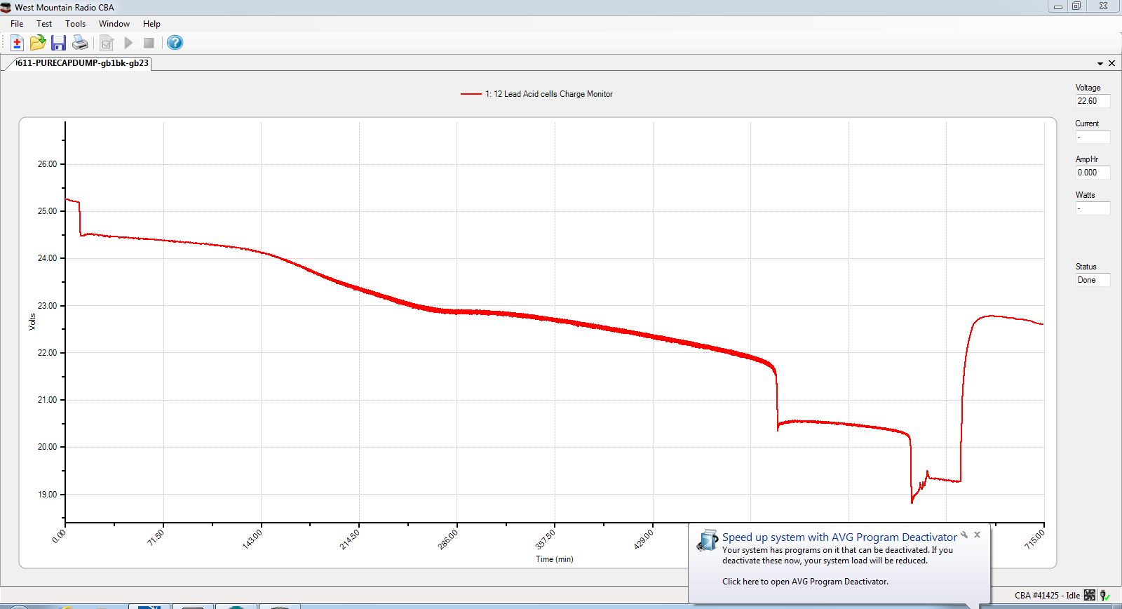

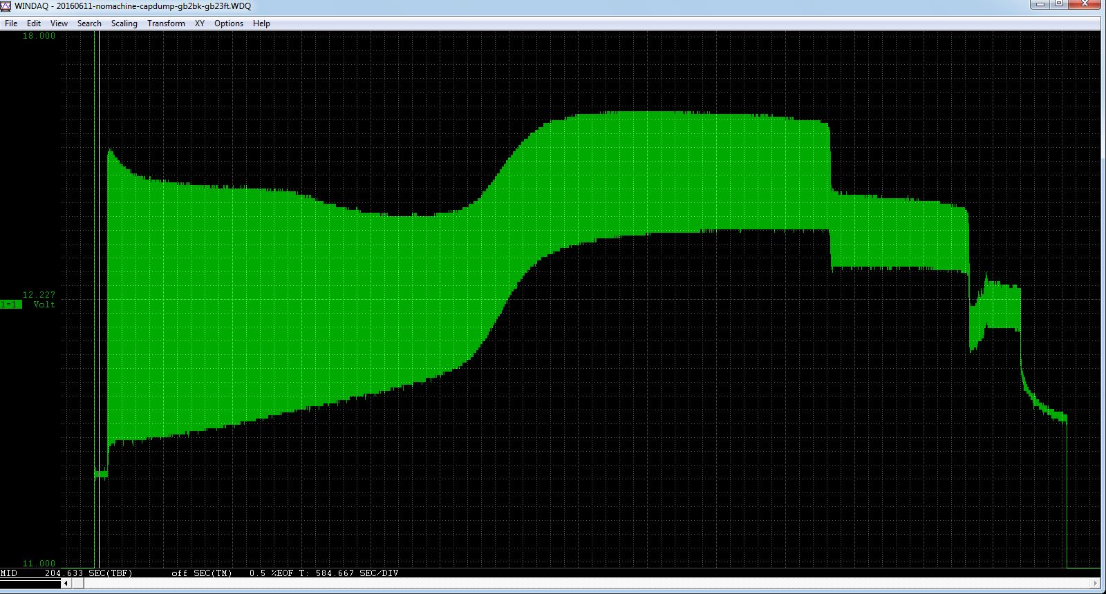

      I ran that cap dump using two garden batteries on the front in series and 1 garden battery on the back charging. I did shoot the first part of it in video but I goofed this one up guys. I set the charge last night and went to bed. I thought it would be fine but when I got up and checked it had gone way past the top in the middle of the night and kept going to the point of the primaries getting WAY depleted. When I say what had happened I switched it off immediately. I will have to do this one over and not let it run on.
      Here are the charts from that run however. The primary chart is from my CBA in charge monitor mode because at the moment my other meter can only mesure up to 20v so it would be out of range. You can see that things were looking pretty good if I had not slept through the proper time to cut it off.
      by the way the timing was set at 247ms OFF, 3ms ON. The first video shows what I mean by that if you didn't see it.
      As I said I will have to do this one again.

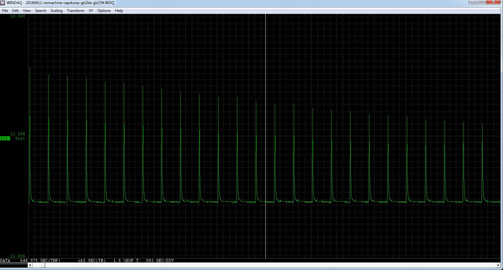

      I wanted to add two shots because this is important.
      The first shot is showing the dump near the start of the run. Notice the curve is small and the over voltage is high. This is a direct result of the impedance of the uncharged battery.

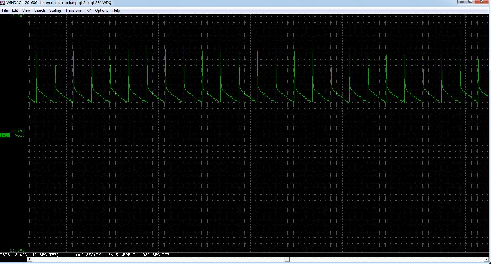

      This second one is toward what would have been the end if I cut it off at the right time. Again notice the same , curve and over voltage. See less impedance translates to more absorption. We see the battery taking more in.
      The time is in the lower left in seconds.

        I know from experimenting that the cap does fill faster in the second half of it's range than the first. Those caps I had in the video are 50v caps. I have used them up to 50v in the past but in doing so I have blown out countless FET's and a fer SSR. The density of the power is far greater when you get to the upper end of a cap, almost like a pressure that wants to get out. If I use higher voltage caps and do the same discharge into a battery it is not as "punchy".
        Just to bring in a little theory on the time that it takes for a capacitor to charge to the full applied voltage. A capacitor charges in 5 time constants. On the first time constant the capacitor will charge to 63.2% of the applied voltage. If the applied voltage was 50 volts then the capacitor would charge to 31.6 volts. The second time constant the capacitor will charge up 63.2% of the left over voltage which is 18.4 volts. So at the end of the second time constant the capacitor would have charged another 11.6288 volts. So the total voltage on the capacitor would be 43.2288 volts at the end of the second time constant. By the end of the 5th time constant the capacitor would have charged to 99.99% of the applied voltage. So your observation that the second half of the capacitor charging is faster then the first half is correct. So you need to calculate the capacitor timing first and this is going to depend on its size in Farads and the amplitude frequency of the voltage being applied. So its always safe to stay just below the second time constant. Not too much voltage to blow up the capacitor and not too much stored joule energy in the capacitor to fry your Field Effect Transistor switching circuit.
