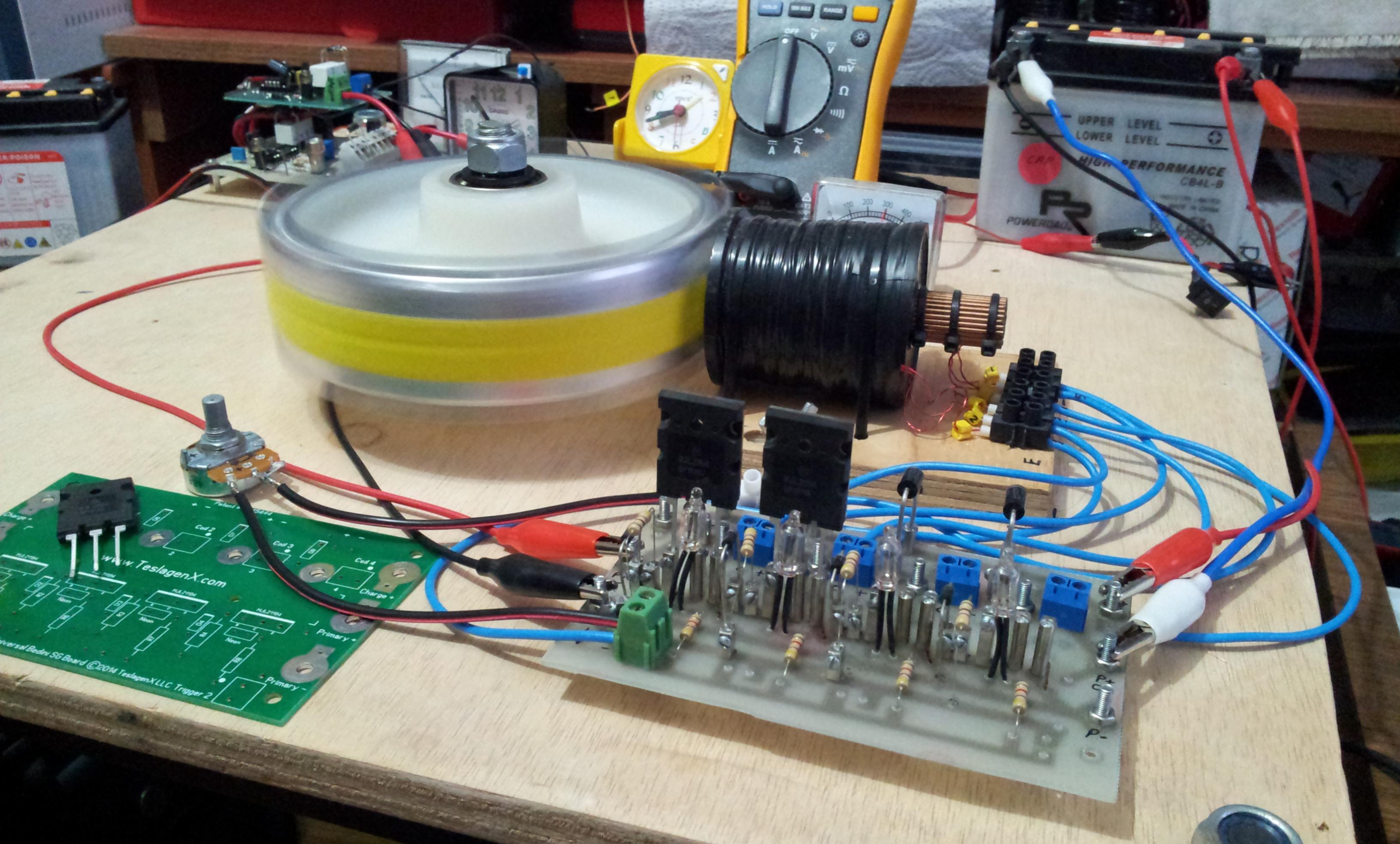

    O.k, I will describe my circuit:
    Primary BatterySecondary Battery(s): Completely new. 4Ah YUCELL CB4L-B. The battery is supplied dry, and requires electrolyte packs (acid packs) to fill. After filling the battery must let the battery rest about 24 hours. I loaded these batteries three times with a computerized charger-discharger. The charger-discharger long time it reaches 14.40vdc. The load current has always been 200mA. After I discharge these batteries three times with the same charger-discharger. The discharge current has always been 200mA down to 12.40. I have always respected the C20 rate. 80%(4Ah)=200mA 200mA/C20=160mA
    Coil: One trifilar coil. Is approximately 450 turns of SWG24 ECW as specified in Fig.33/ p.47 of the Bearden/ Bedini publication 'Free Energy Generation'.The coil former is 5.5cm wide, 8cm tall and the central hole is 1.6cm. I decided to use this type of coil, because after these tets I wanted to test a cap-pulser.
    Core: Lincoln R60
    Rotor: It's a plastic wheel of about 5.90 inches. Eight magnets. C8 grade. All with North pole facing out.
    Circuit: For some time I buy the "Bedini SG 4 Transistor Board and Kit" in Teslagenx store. It's a real pleasure to talk to Tom C. He is always willing to help if you have any questions. The circuit is ready to work with 4 transistors, but my circuit only needs two. I have a three wire coil (trifilar). A trigger circuit and two circuits run.

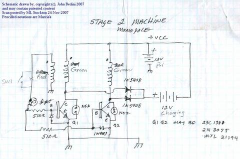

    The basic idea of my circuit is this ...
    I am using a 470 ohm resistor at the base of each transistor (MJL21194) and a potentiometer 1k. I think my sweet spot is when the potentiometer is set to 187.3ohm. I am also using the diodes 1N4007 and 1N5408.

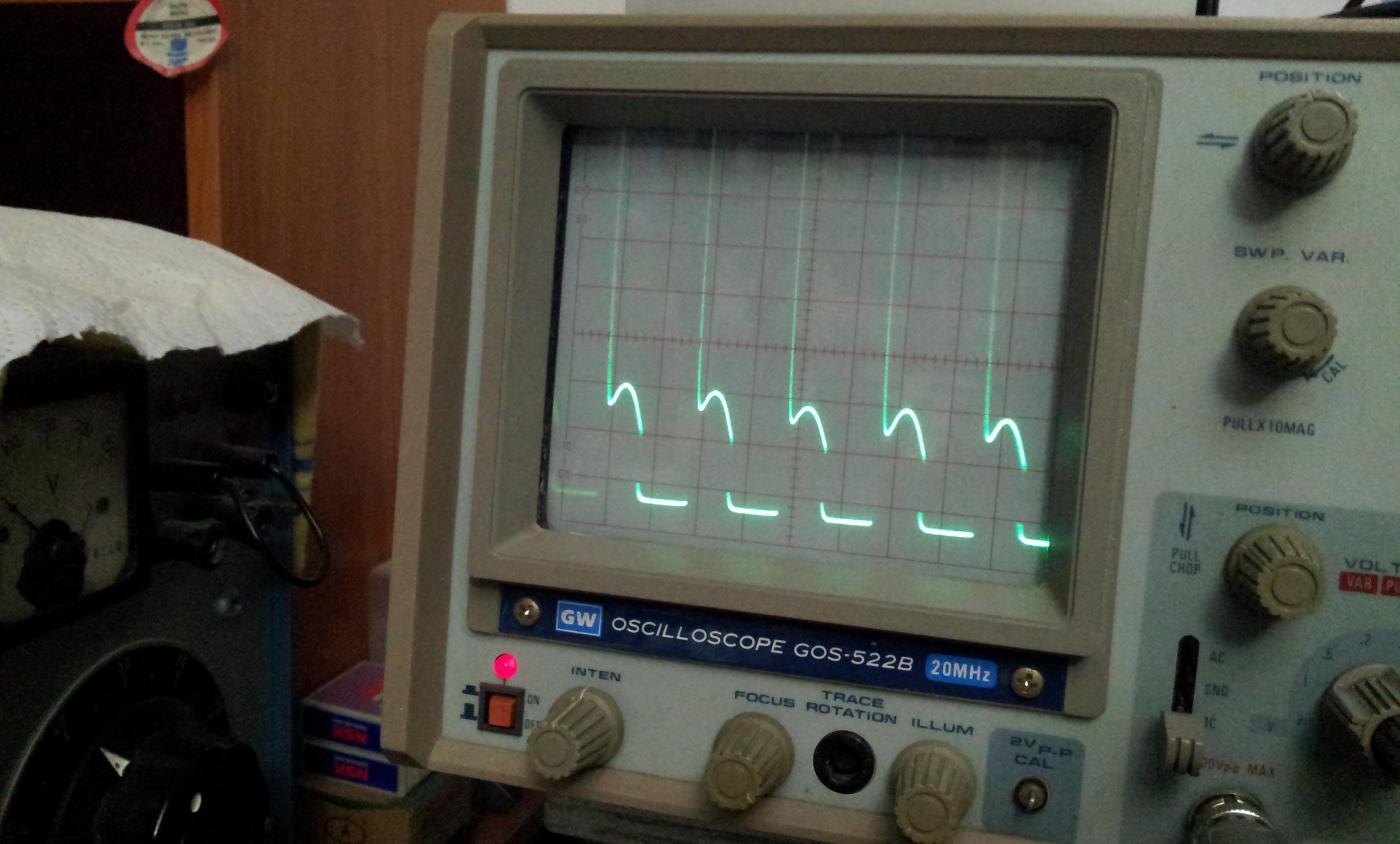

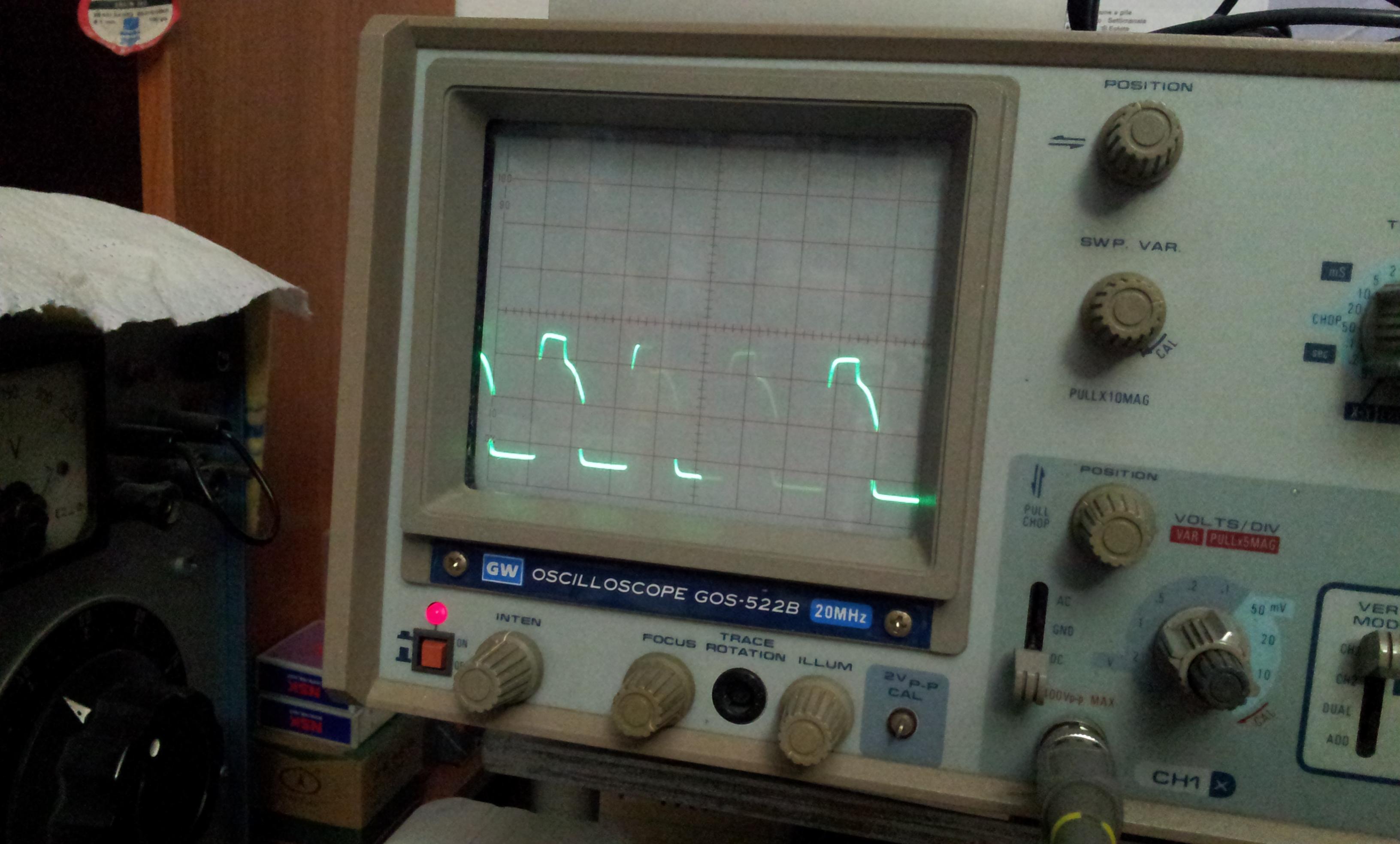

    The waveform in my oscilloscope when not connected to the secondary battery is this...
    And the waveform in my oscilloscope when is connected the secondary battery is this...

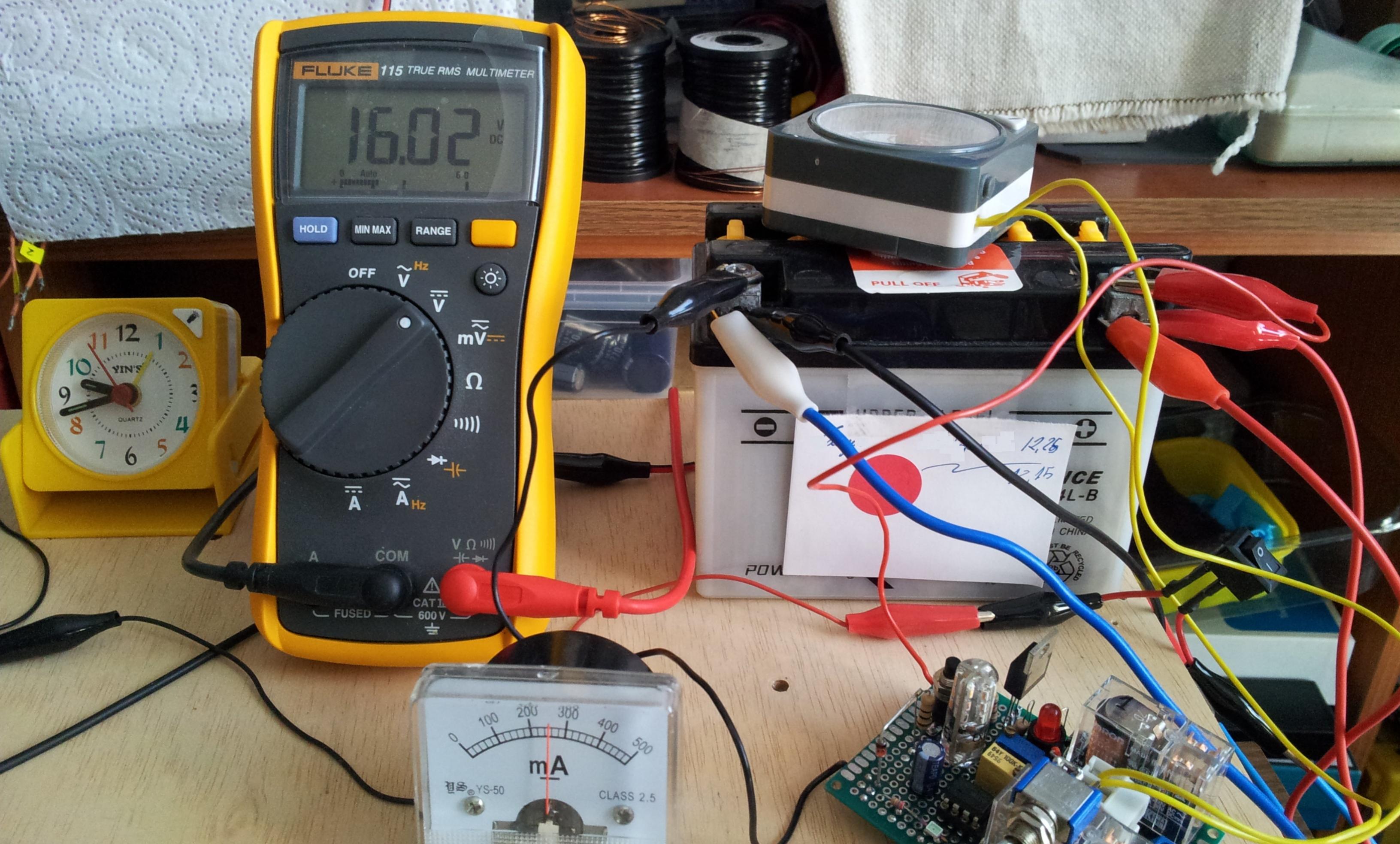

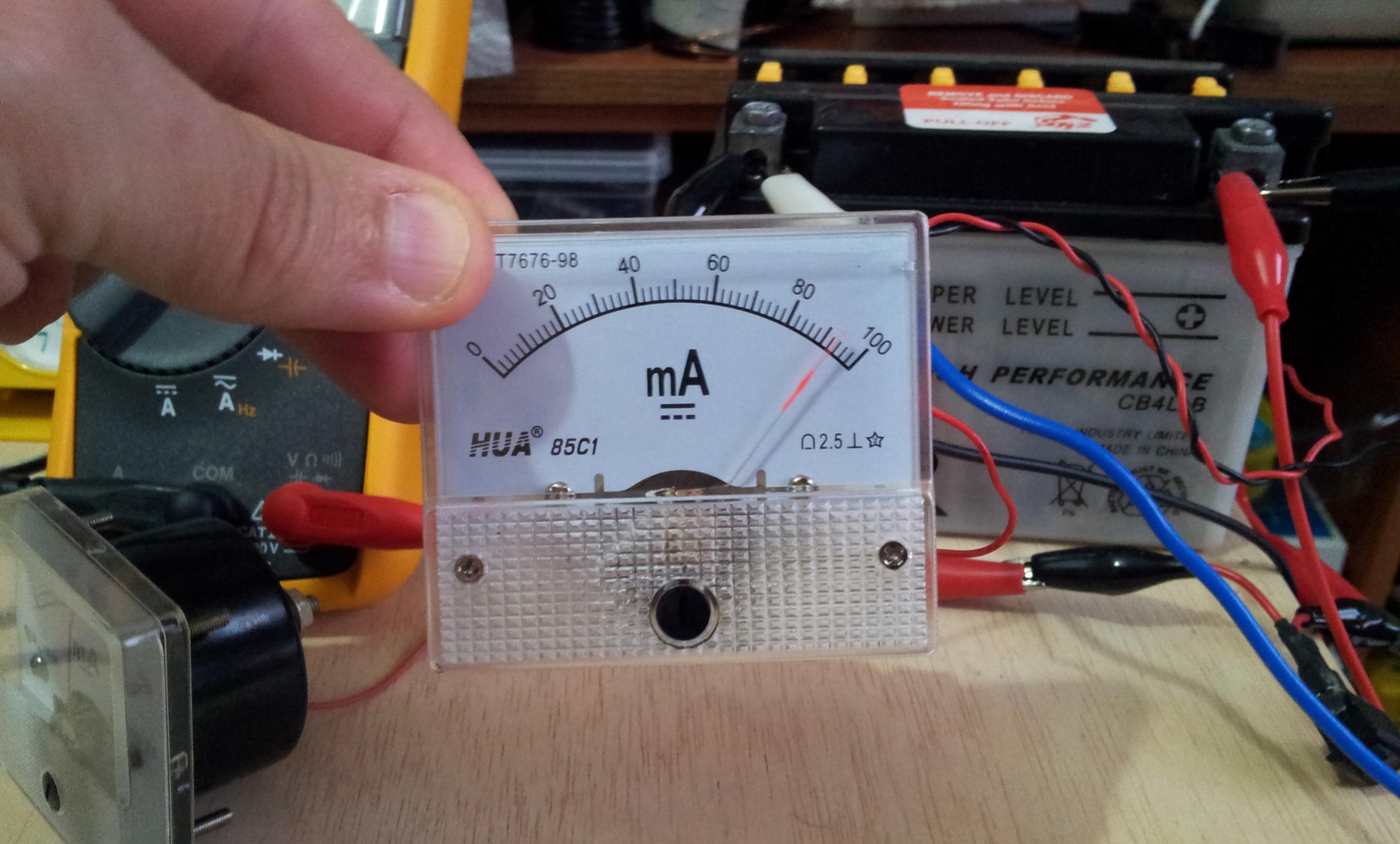

    I also put a small analog ammeter in series with the positive of my secondary battery. When the circuit is operating in battery are entering approximately 90mA.

        Tom, I only put my ammeter to take the picture. The whole time the ammeter has been out of the system.
        I also thought there was a mistake in my transistors. Both are fine.
        These documents (SSG_STARTERS_GUIDE-Two) are said to be possible to use 110V or 220V to 12V “wall wart” power supply as the “the input source”,
        which with two batteries form a ‘minimum practical requirement’. Having 2 batteries available to be charged is, at the very least, advisable so that you have one available to charge while load testing the other.
        Tom, is there an error in these documents?
                      [ATTACH=CONFIG]5459[/ATTACH]
                      [ATTACH=CONFIG]5460[/ATTACH]
