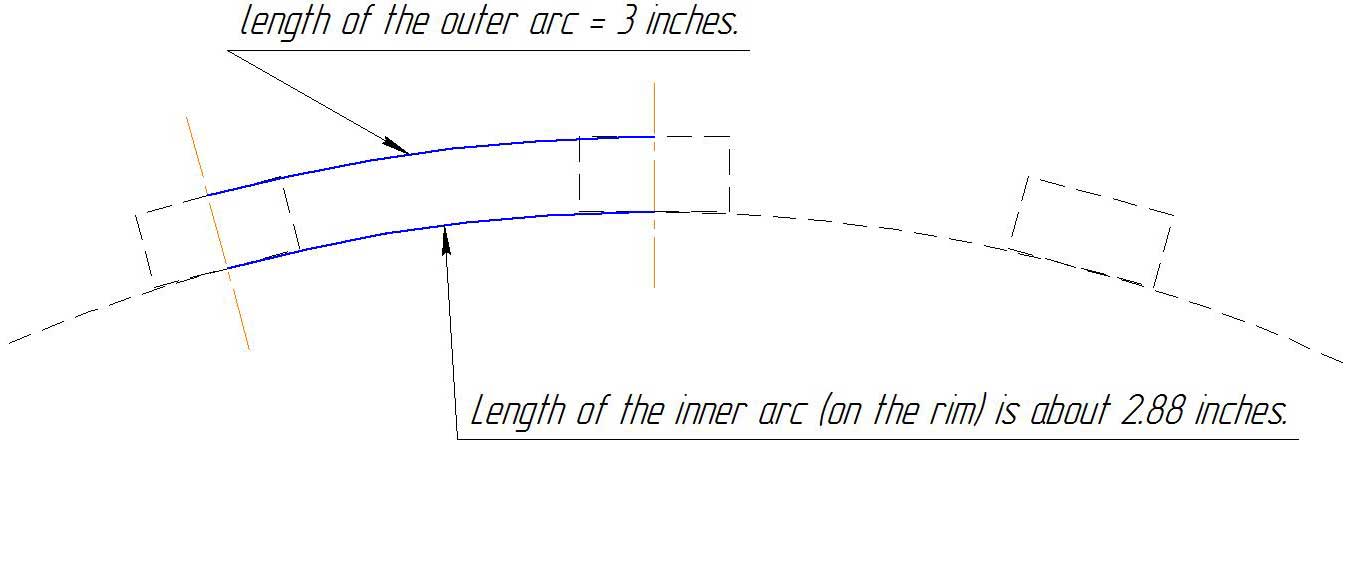

I found there might have some mistake in the beginner's handbook pg 55 about the spacing between the magnet on the rim. If the rim is 22inch (mine is 22.44in), then the circu
the circumference should be 3.14x22=69.08in, 24 magnet will have 24 intervals, then the spacing of the magnet should be 69.08/24-1 (width of magbet)=1.8in.
How can we have 3 inch spaing as stated in the book last paragraph of pg 55? Can anybody clarify for me? Thank you very much
The distance between the center of magnets should be the same as that between the edge to corresponding edge of magnet. That is why I minus 1 inch of magnet width.Originally posted by kingstingtin View Postlis_wang, likely in this case is, the distance between the centers of the magnets.[ATTACH=CONFIG]1727[/ATTACH]
I meant that the calculations in the book are true.Originally posted by lis_wang View PostThe distance between the center of magnets should be the same as that between the edge to corresponding edge of magnet. That is why I minus 1 inch of magnet width.
