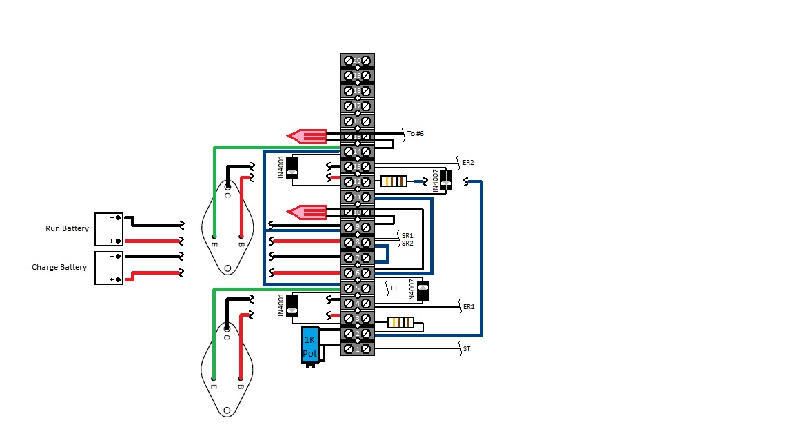

      Currently I have my circuit put down on a barrier bar so that I could attach it to the frame of my wheel. I am including the 'schematic' I drew up.
Name:	barrier bar circuit.jpg
      You said to put the circuitry on the coil like JB's 10-coiler. I am just trying to find the correct way to add 1 coil to my pre-existing circuit. I have found multiple ways that it is done, but I am unsure if any of them are correct.

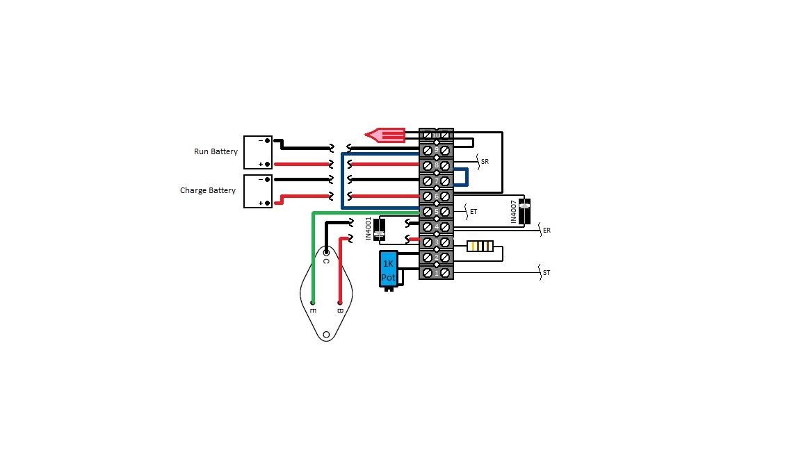

          I have a great team that I work with, and hopefully I can do the same here that I do with them-- can I get another set of eyes on this to make sure I am not missing anything?
Name:	new barrier bar.jpg
          Thanks!
          Dan
          • #20
            Originally posted by itunesdan View Post
            Finally able to put some questions to rest. Thanks Patrick!
            [ATTACH=CONFIG]5622[/ATTACH]
            Thanks!
            Dan
            Hi Dan,

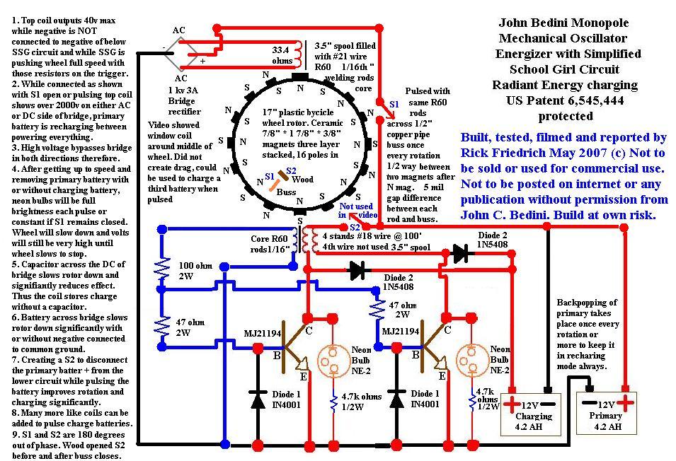

            to be honest, I find those drawings difficult to follow. Check out the schoolboy drawing with two coils here:
            • #21
              Hi Dan,
              [ATTACH=CONFIG]5623[/ATTACH]
              Hey guys,
              I think was Rick's work.. he essentially wanted to show a self runner with the recovery into the primay battery...
              • #22
                Hey guys,
