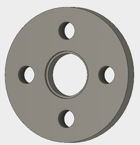

    Good suggestions guys but it won't help with the way this thing is currently. See the bearing is buried in between the frame and the bearing plate that I made. The plate has a counter sunk ring for the flange bearing to sit in and then that is bolted to the frame so if you can imagine it is sandwiched between the frame and the plate but does not stick out on either side. Anything I would try to put on the axle would then rub on the frame or the other side would rub the mounting plate. I had tried some tape because it was thin enough to get in there without rubbing anything but it's not doing such a great job.
    Here is a pic from the software of the bearing mount plate. So imaging a flange bearing pressed into this and the flange sits even. That side then is bolted to the frame.

      can you cut a straw? cut to length you need then slice the remaining part lengthwise and cut some more to fit. if it works, use some glue...
      • #48
        That could work, might have to try that. I eventually want to share the plans for this machine though and not everyone would be able to put fixes in place. I want it to be as simple for someone to put together and have a working machine. I have also thought about reversing my coil current. If it is pushing away as it is right now then perhaps it will draw it in if I reverse it.

          you can also get various diameter brass piping from local hardware store and cut to length. Glue in place might work... however, as you say redesign for future print would be best.

            So I have made modified plans to use a half inch axle and the bearings that have the keeper screw. I am in the process of printing the new one out now. I took he chance to also thicken up my coil holders a bit.
