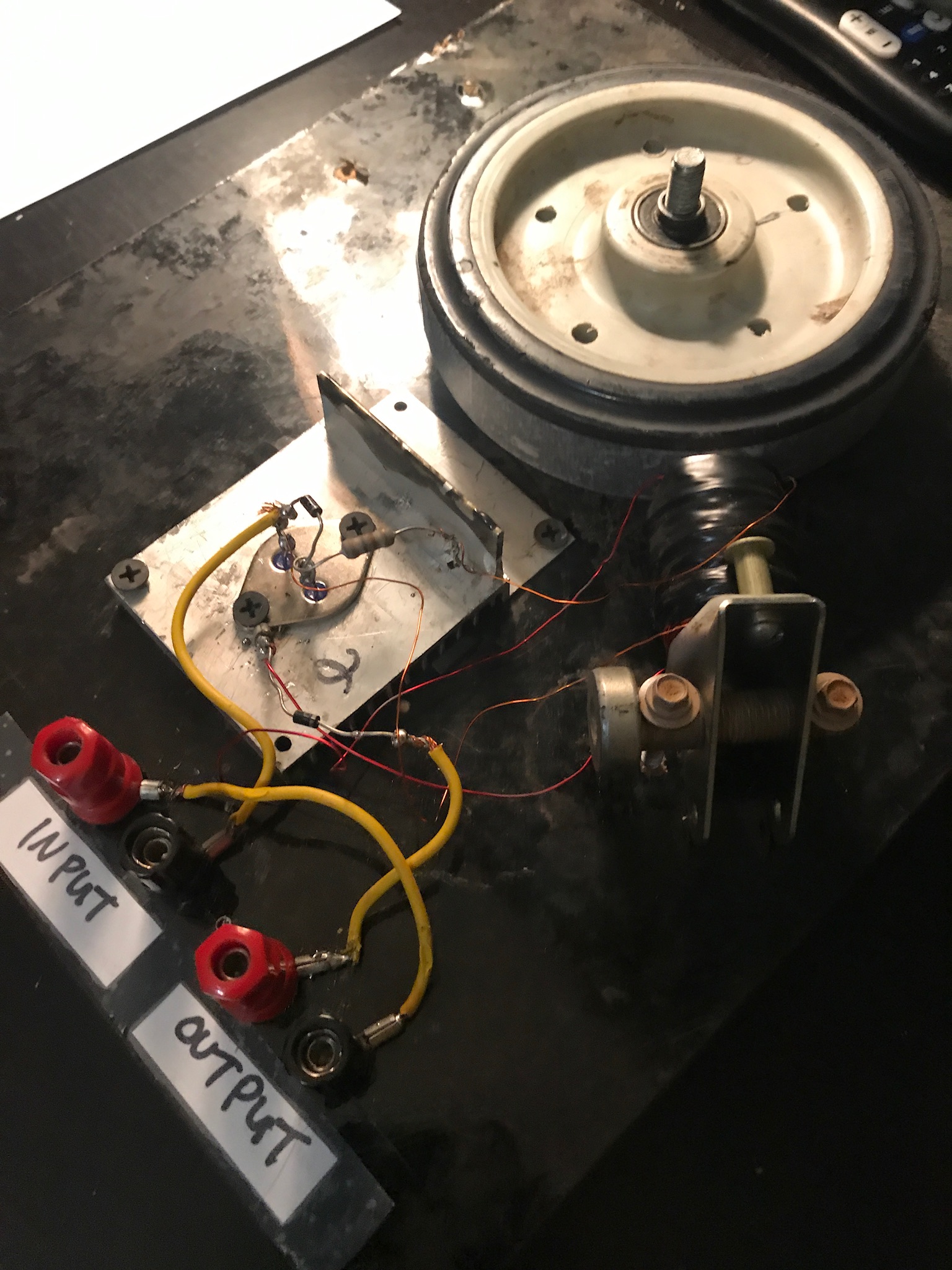

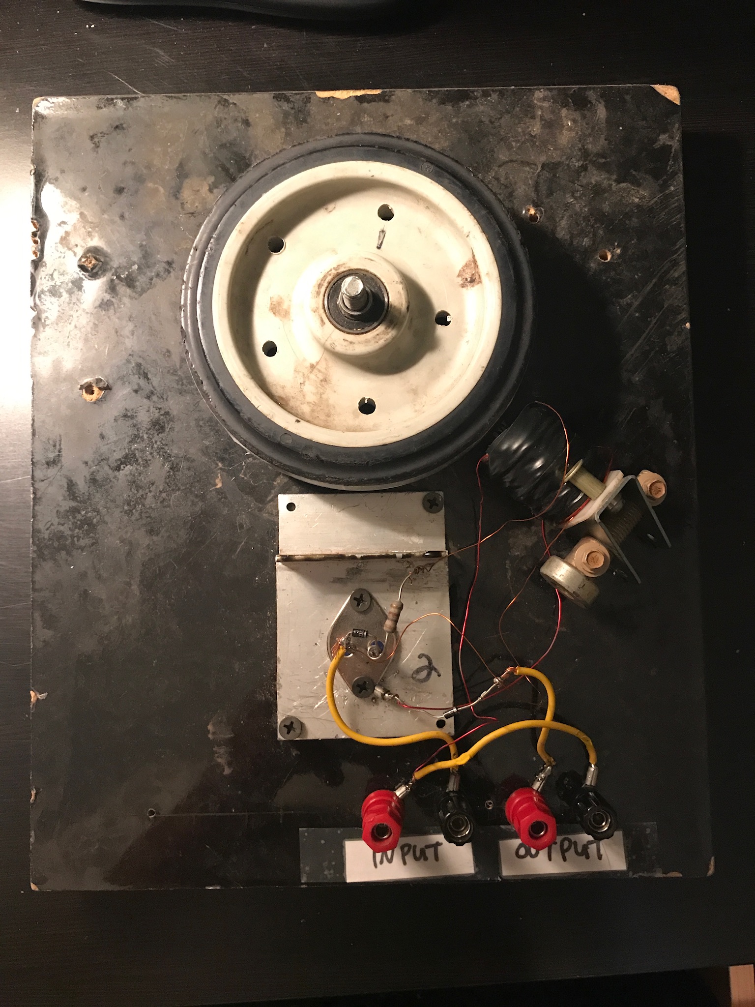

Hi guys, I was able to make 2 coils. a 20/23 on the standard size coil spool. and also a 23/26 on the mini coil spool. I was able to get the circuit working today. It works using either coil, but I have a slight problem...
The coil doesn't want to repel the magnets on my rotor, it seems to attract them instead. The circuit is hooked up correctly and I am using ceramic magnets. What I ended up doing was sticking a magnet on the backend of the coil and this worked. So I got the coil to repel the magnets on my shopping cart wheel rotor and the wheel started to speed up and was finally running normal. After a couple minutes I took the magnet off the back end of the coil and it still ran fine and repelled the rotor and stayed spinning. (I had this issue using either coil for some reason) The shopping cart wheel rotor has ceramic magnets embedded into it. It runs very nice and smooth and fast.
I decided to take the standard size coil with me to my shop where I have my 25" bike wheel on the wooden frame I still have from a few years ago when I first built one of these (I never got that far even back then. I only got it to run and never learned how to tune it. I ended up kind of melting the plastic on my coil somehow running it off 24v.) So I know this bike wheel works. It turns really smooth and doesn't wobble. So all I had to do was stick the coil under it and hook it up to batteries. I did this but had the same problem with my coil wanting to attract instead of repel. So I stuck the magnet on the backside again and was able to get it to repel finally, but the bike wheel would not stay spinning. No matter how hard I spun it to start it, it would end up slowing down eventually.
Now earlier in the day I used this same coil with my shopping cart wheel and it ran fine, even using 9v batteries. I thought maybe the little 12volt battery with about 10 volts in it wasn't enough for it to run the bike wheel so I hooked it up to my solar panel. All this did was heat up the transistor pretty quickly but still would not stay spinning. So my questions are:
1. Why is my coil not repelling the magnets on the rotor (even though I have everything with the north poles pointing each other)
2. Why will it run the shopping cart rotor but not the bike wheel rotor?

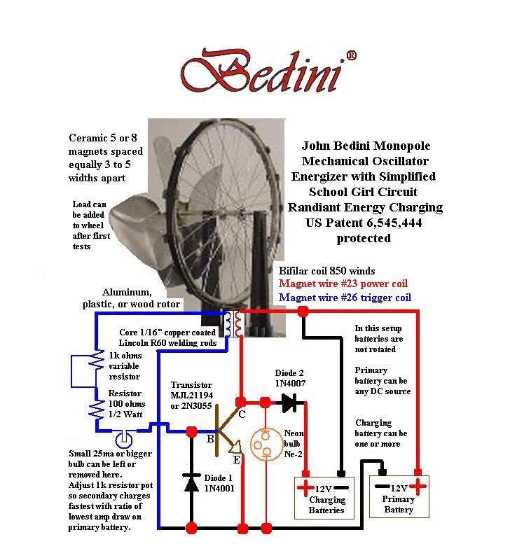

I have double checked everything. The bike wheel ran fine a few years back when I first started messing around with my first ssg. That coil was purchased through rpmgt.com and it was a 23/26 standard size spool. These ones that i am using now are ones that I made myself. I have wound them the correct way. They don't have as many turns as the one I used back then, but they have enough. I am having issues with both of my coils now doing this. The standard size coil has the welding rods and the little coil has tie wire as the core. They both work with the shopping cart wheel (as long as I put the magnet on the backend to get it to repel the rotor magnets when starting it). I am using ceramic magnets and I am going off the same circuit I used back then using everything exactly as it has in the picture
