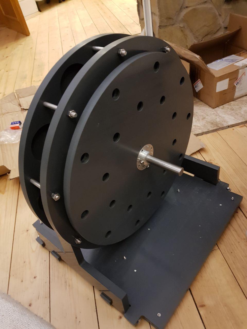

    Hello everyone.
    I've bought a 10 pole monopole kit from r-charge, but I've bought it locally from a guy, who buy it few years ago from r-charge and didn't assemble it.
    Kit have no coils and manuals, so I'm asking for help assembling it.
    Atm I need to make coils, any recommendations and advice will be helpful, also I can't find any schematics, only in videos on youtube, but they are not so clear to read.

      The spools size are 3 1/4" H by 3.5" top and bottom, 3/4 bore.
      I want to understand the important points when winding, from what to make a start.
      In John's videos he use twisted coils, Rick sell on his website parallel coils.
      Also there are options of 23awg and 18awg wire, which is better? Does wire need to be a specified lenght/resistance or the main parameter is the number of turns.
      I've read beginners guide, but it's not give me answers to build a generator in my case.

        Hi,
        There is some clue in why this is different. look up at how Rick carried out the switching and how it is different from the John Bedini method. what does twisting do to the coils in the way the Magnetic Field response to the switching. as a hint did you notice the Genny coils were same as the non-twisted parallel coils.

          Just my few observations.... Rick also uses Neo-magnets in these holes, and his switching are hall -switch based or reed switch based.

            If you want coils to run the 10 coiler SG, the answers are in the Beginner's book. A typical SG coil for that can be 8-9 wires that are 120 feet long and 18 awg - all twisted and wound on a bobbin. 1 wire is a trigger and the rest are power windings that each have their own transistor circuit.
            If you want information on generator methods, it is in the Advanced book. Alternatively, pay attention to Turion (Dave's) posts in this thread: http://www.energeticforum.com/renewa...ng-system.html - particularly in the last 1-2 months. He gives away his low drag method, which is related to what is in the Advanced book.
            It is best to ignore what Rick F. does because he hasn't the slightest clue about what he is doing. Also, if you want efficiency, only use ceramic magnets. Everything Rick knows about this he took from John Bedini and then degenerated it all so it is no longer correct. The SG book trilogy gives you the correct information, which comes straight from John Bedini's work.
            You can however use neo magnets for the generator section but again, study Turion's posts.
              Rick also uses Neo-magnets in these holes, and his switching are hall -switch based or reed switch based..
              You are correct, there are neo magnets in this kit as well as hall sensor with additional small circuit.
              Also magnets are from both sides from coils, faced north poles to the coils.

                  Deuis, this is your setup ? Does it done it's job (OU effect with switching batteries and have extra load)
                  Did you use neo magnets, because I've a manual from this energizer, and it use neo magnets as well.
                  I've read all 3 SG books and John everywhere recommend to use ceramic magnets.
                  And I didn't get you in "1st step throw in bin." - what do you mean ? English is not my primary language, so I may not understand some moments
                  Also almost all of John’s models have a different arrangement of coils - like that of a classical SG, while Rick has another, is it as important as coils are located relative to the wheel and magnet?
                  There is no desire to assemble a deliberately inoperative model, so I'm thinking how to arrange the coils best way, can I use this device, which I purchased, or should I think about a different arrangement of the coils and made another mount.
                  And in some schematics John write grounding, in others don't. Does grounding important part of the system ?

                    The guy who designed and built it said not to use Neo's.
                    No, this 10 coiler did not operate OU.
                    The good news is that you may be able to use the rotor and frame still.
                    Find some ceramics to fit and you should be ok.
                    Copy the SG books as best you can and you will get some results, then keep improving them piece by piece.
                      Neos have their place else where in the Monopole motor..think think... it takes thinking nothing else.
