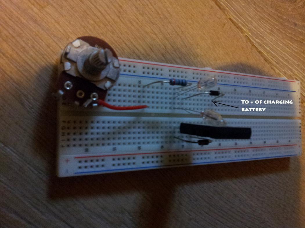

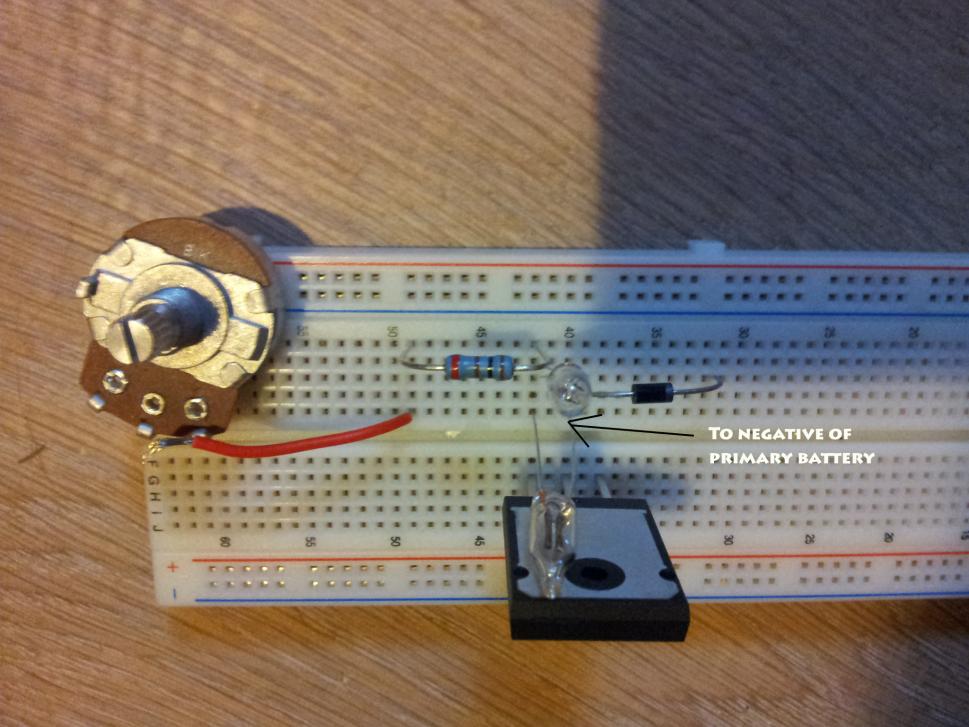

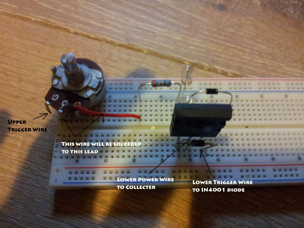

    I've placed all the components for the basic ssg circuit on a breadboard, and I wondering if someone can double-check me before I solder this all together.
    I am still very much a beginner with circuitry, so I'm sure something is wrong. I have drawn arrows and typed in some notes...hopefully the photos are clear enough.
    I just didn't want to solder it all up and waste the components until I'm sure I have it sorted out correctly.
    Thanks for any help!

    It looks alright to me. I didn't use breadboard or any "board" on either of my builds, because low contact resistance for every connection is crucial. I won't even need a board for the 5-filar. You can still do a good neat job just by vertical-glueing the tranny & soldering everything in place with some good stress-relief bends, etc. Make sure your magnet wire is thoroughly stripped, fluxed & tinned first. Soldering doesn't waste components. If you make a wrong connection, just de-solder, clean up, re-flux & re-solder. Go for it, dude!
      Right on! The main thing I'm concerned with is if I have the transistor backwards, or either of the two bulbs. I wasn't sure how to tell what end was positive vs. negative on the bulbs...

        She's right, mate. Go ahead. The bulbs are non-polarized; they go either way. You can pull up a data sheet on the tranny or use the diode test function on your multimeter to check transistor polarity.

          Hi,
          Right, the grain of wheat and the neons are non polarized. It's the led lights that are polarized, and you have to watch that if you want to use them as a load.
