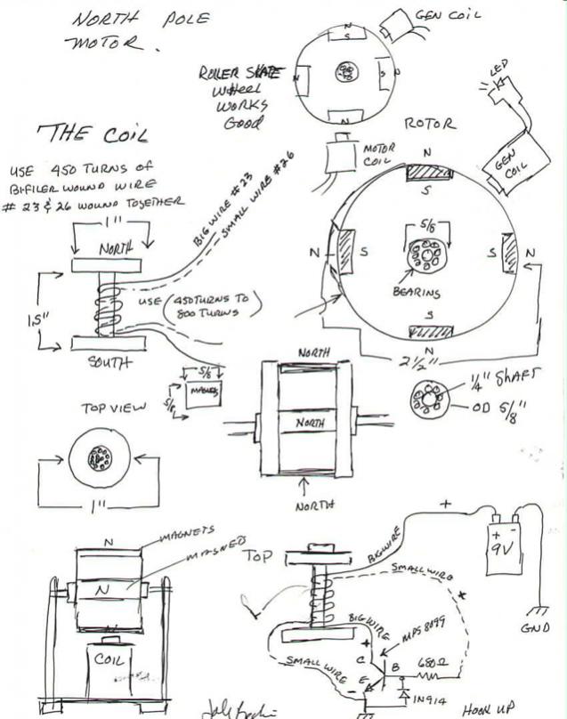

    This is the first Bedini SG that I made 12~13 years ago. Originally, it ran on a 9v alkaline radio battery and the transistor was a mps8099 as shown in the old drawings - this was around the time that Jeane Manning put out her Atlantis Rising article "The Attractions of Magnetism".
    When I first built this, I used these drawings as my guide - I think Keelynet was the first place these may have been posted online:

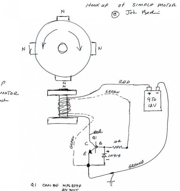

    Notice in the second drawing the ground symbol at the bottom is not just ground but is Earth ground - meaning connect that ground to a rod in the Earth.
    I didn't even know what a transistor was at the time so I basically just got the components and wire and connected everything by laying it out on the board and when you looked at the circuit, it actually looked like the schematic. If you're a beginner, you can see that you don't even have to know what you're doing to make the wheel spin, literally. There have been plenty of engineers with a serious background in electronics that couldn't even get the wheel to spin so don't feel bad if you're a beginner and don't get it to work on the first try.
    The pink wheel was from a $3 or so pair of roller skates from the Goodwill so cost wasn't an excuse to not do this.
    Every 90 degrees are a double stack of 3/8" neo magnets. Should use ceramics, but this is just what I did for that model. With another identical wheel with magnets every 120 degrees, that actually ran faster than having them every 90 degrees.
    Before this SG, John recommended that I build the Hammel Spinner using his North Gate ring and I played with that for probably 2 months before I even started to build this SG. The Hammel Spinner with the North Gate seems really simple but there are actually countless experiments that can be done with it. It is really worth doing.
    Anyway, I just remember when I spun the wheel and it started to speed up - it worked on the first try and I was hooked! I performed hundreds of experiments with this SG and did that for many months before I ever cared about charging batteries. Learned a whole lot more about the nature of it that way. I had different coils wrapped around the wheel on the axle testing different things, a second parallel shaft with a second wheel with magnets spinning that wheel by magnetic coupling, slid ring magnets over the shaft and pushed it towards the wheel, that way I could increase or decrease the strength of the field at the wheel. I didn't do any serious tests on that but I was able to get it to speed up or slow down simply by placing a magnet on the shaft. Sitting there with it long enough with that pulsed magnetic field also influences consciousness.
    [ATTACH=CONFIG]809[/ATTACH]
    [ATTACH=CONFIG]813[/ATTACH]
    [ATTACH=CONFIG]812[/ATTACH]

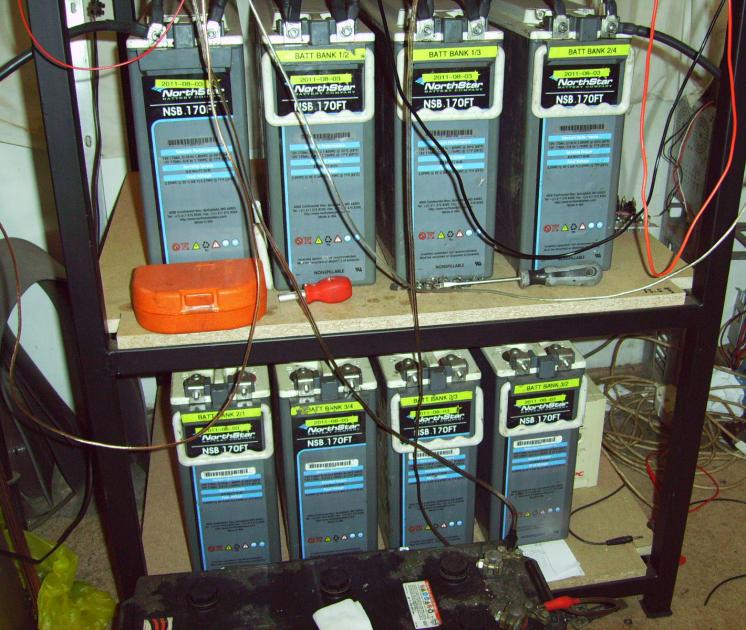

      Any suggestions where to go from here, I have 8 x 170 amp Telco AGM batteries that needs to get charged or I am going to lose them,

        The Plain Jane version of the SG is that first hand drawn diagram by John I posted (without any recovery).

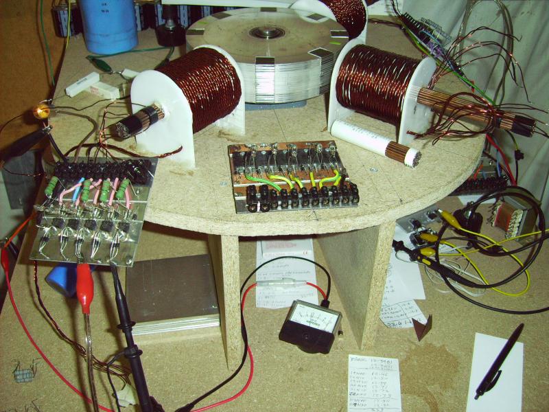

                Way of the winding and material for the coil
                Faced with an interesting feature, I hope to be useful to the repetition of the SSG.
                Coil №1: the diameter of 95 mm, height 91 mm, in the center of 16 mm, number of turns w=100 turns of the four pairs (eight wires). When connecting consistently total number of turns is 400.
                Used wire twisted-pair (English-twisted pair, guide in isolation, the outer plastic shell is removed, the protective screen deleted:
                * diameter with insulation D=1.3 mm
                * wire diameter d=0,47 mm
                * material, alloy made from copper
                * turns W=400 turns
                * the radius of the winding winding from the center of b=35 mm
                * winding resistance R=10.
                * inductance L= 15,4 mH
                Why use twisted-pair? The idea was to experience a special connection бифиллярных windings to meet each other and see how undergoing high-voltage pulses.
                Coil №2: the diameter of 63 mm, height of 95 mm, in the center of 13.5 mm, number of turns w=500 turns of copper wire is covered with varnish with the insulator of silk.
                * diameter with insulation D=0.9 mm
                * wire diameter d1=0.8 mm (power)
                * wire diameter d2=0.3 mm (management)
                * material, of copper
                * turns W=500 turns
                * the radius of the winding winding from the center of b=24 mm
                * winding resistance R=a 2.7 Ohms
                * inductance L= 11,8 mH
                Tests:
                Coil №1 in the SSG is not earned. The wheel after a rotation stopped. High-voltage impulses scheme generated when passing magnet over the core. However, the magnetic phenomena are not enough to maintain the rotation.
                Coil №2 in the motor SSG well earned. The wheel spun around 20 hours of battery 12 V, 3 A*H.
                Began to feel the push of a permanent magnet from the core when applied to the coil power from a DC source. The magnet on a close location to the core could not kick in the Coil №1 Prevailed attraction of iron to a magnet. At a greater distance repulsion poorly expressed and therefore lacked the force pulse for rotation.
                The Coil №2 was well expressed by the repulsion on virtually any distance to the core with a current in the coil.
                Dr.. Bedini engine in the film and Assembly instructions SSG warned that it is very important to repeat the dimensions of the coil, conductor material, the direction of the windings and magnetic material adequacy General categorization of the core.
