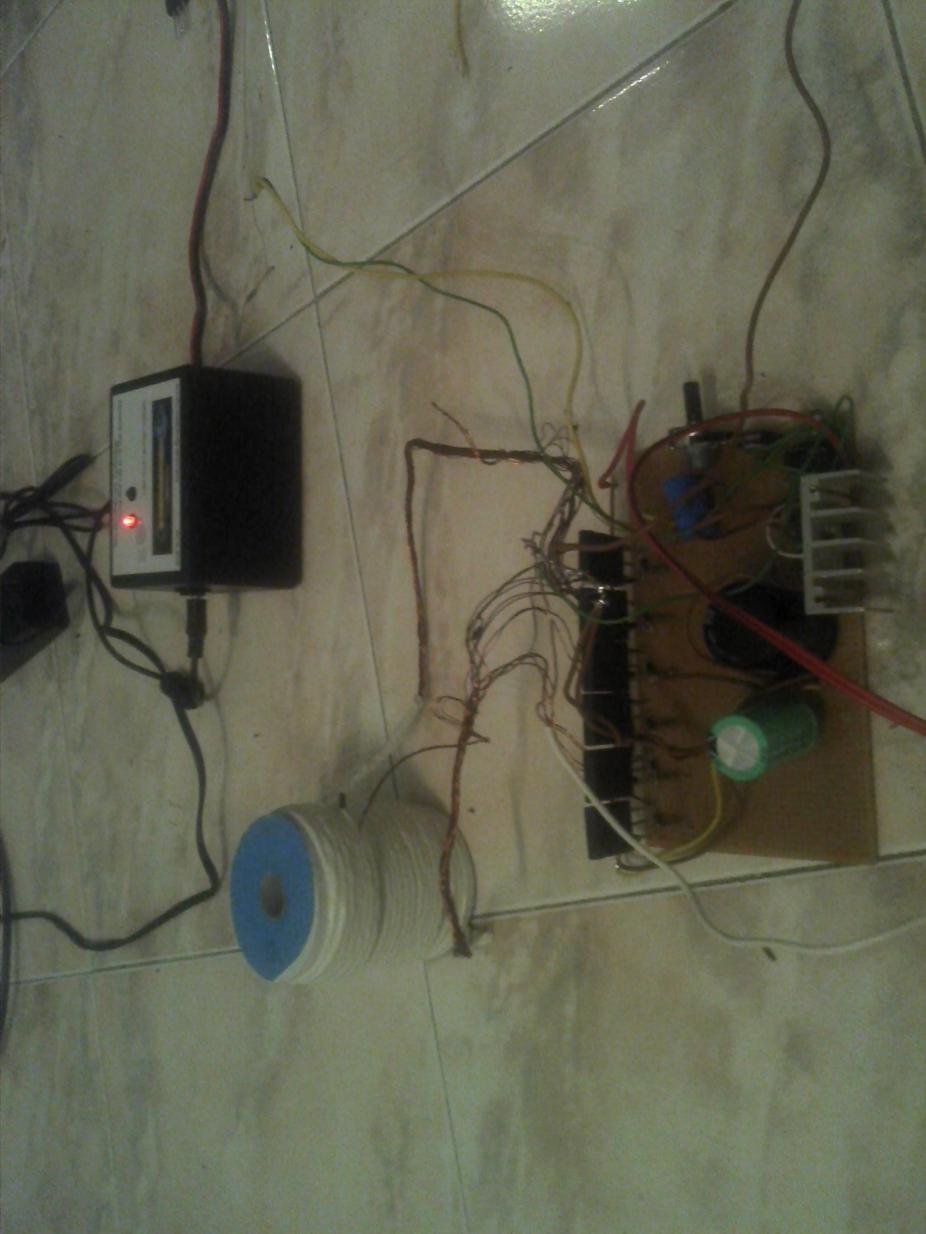

                        • Hi Aaron
                          I have read the intermediate sg book and built a ss ssg with 6 transistors with the modification mod of patrics ss circuit
                          i wound a multifilar coil litzed just like i saw john bedini doing in the last video but with wire that i already had from previeus buillds that was 23# and 26# so i anwound the coils i had that were (1#23 and 2 26#) and cut 130 feet times 6 and wound it .So i parallaled 2 23# for each transistor and 2 26# for the trigger
                          i also built a 555 circuit the one that comes with the transistor mj15024 but with a 220 k pot for slower time and i used the circuit of the irfp260 mosfet to dump the negative side.With the ss mod i can adjust the amp draw from 0.400 A to 2.5A i only have 4700mf cap i still don`t have the r60 lincon rods for the core because i can`t find it in Portugal. i bought a rc-2a12 charger from RC and i compare the performance from my circuit it is similar i here the battery clicking tic tic but my circuit is weaker.i only have one mosfet that heates up alot, need to buy another one and more caps Click image for larger version
