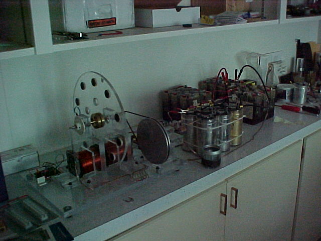

        Regarding the magnets suggested in the book,if I decide to using the configuration given in this picture , with round magnets,Click image for larger version
ID:	45142 what is the optimum recommended ratio between diameter of the core (in our case 0,75 inches in diameter ) and diameter of the round magnets ...I can,t find in area where I live the dimensions of the magnets what you recommend in the book (just smaller magnets)...Also, round magnets seems to be cheaper than rectangular magnets...

          sinergicus, that is a different machine than in the book. It uses a hall switch and a timing wheel instead of the trigger winding. The magnets may not be strong enough on that machine if you are using a trigger winding.
          In any case, the diameter should be at least the same diameter as the coil core (0.75").
