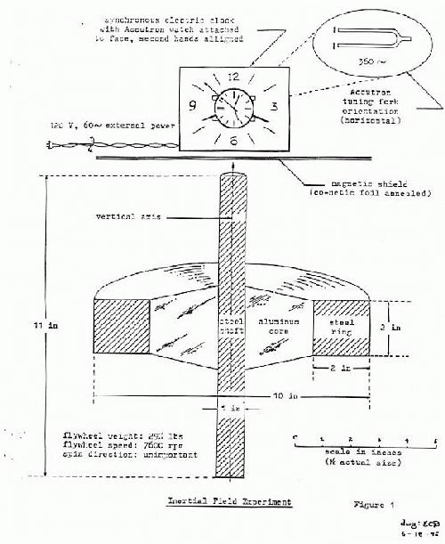

    The Experiment: A good way to detect a field whose effect is a spatial inertial anisotropy is to use a time measurement based on an inertial property of space and compare it to a remote reference. With reference to figure ( 1 ) we have a situation where the timekeeping rate of an Accutron tuning fork regulated wrist watch is compared to that of an ordinary electric clock with a synchronous sweep second hand.
    The Accutron timepiece is specified to be accurate to one minute a month. Examination of the relative time drift of the Accutron - electric clock combination shows a cumulative drift of .25 second Accutron ahead for 4 hours of steady state operation. This is within the specification of the watch.
    With the flywheel spinning at 7600 r.p.m. and run steadily for 1000 seconds (17 minutes), the Accutron loses .9 second relative to the electric clock.
    Much experimentation has shown that the effect is greatest with the position of the tuning fork as shown. Magnetic effects from leakage fields from the gyro drive motors are almost entirely absent; any remaining leakage is removed by co-netic magnetic shielding. The Accutron is also in a "non-magnetic" envelope.
    The purpose of the experiment is a simple demonstration of one of the effects of the od field of a rotating object. The demonstration may easily be repeated using any one of a variety of rotating objects, motor flywheels, old gyrocompasses, etc. The rotating mass of the flywheels used in these experiments is 29 1/2 pounds. The rotational speed of 7600 r.p.m. is easily accessible. The effect is roughly proportional to the radius and mass of the rotating object and to the square of the rotational speed.
