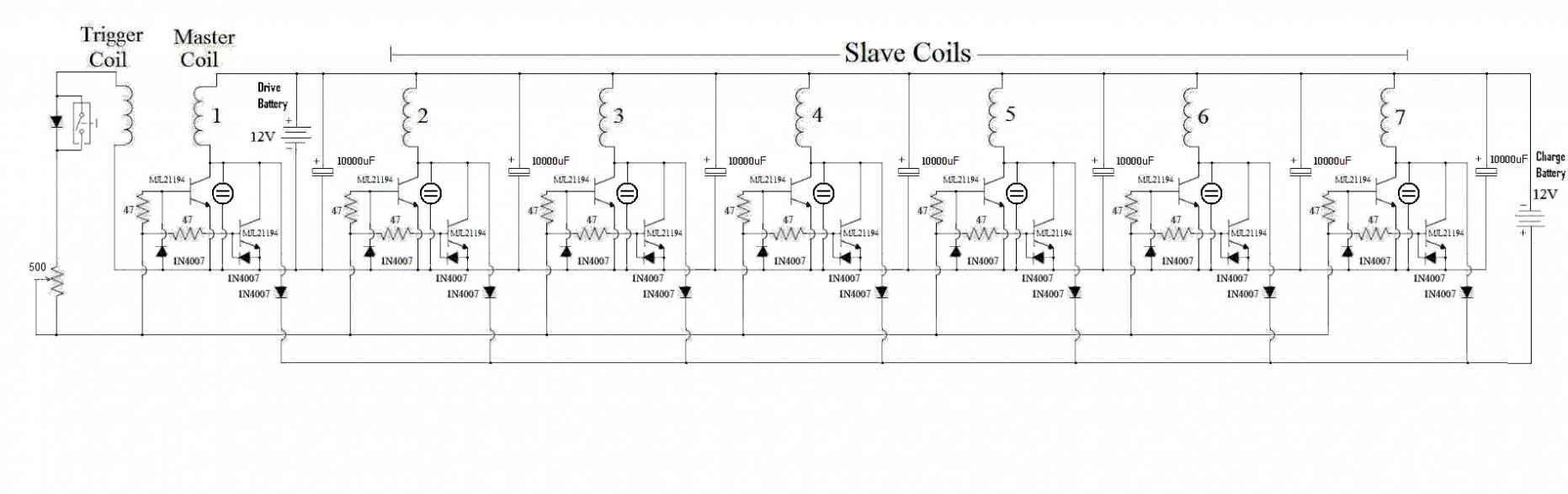

            Knag, overall that is a pretty good setup. I would not have the coils held on with zip ties. I would also change the coils out to 4 strands of #18 wire for the slave coils and the master I would make 4 strands of #18 and 1 strand of #23 for the trigger. If running at 12v you could have 1 transistor for 2 strands safely.
            Also, use an analog amp meter for draw current measurements not a digital one. As for tuning, once you have the base resistance set so you get 1 pulse per magnet pass and the highest RPM adjust the coil to magnet gap on all coils for faster RPM. I can't see what's on you scope.

                if you build it like JB designed you will have good results, there is a reason he does EVERYTHING...... otherwise you will play with variables all day long. resistance of the coil is not the only factor inductance is also which has to do with turns which has to do with wire size and spool core diameter. I dont know why the transistor configuration is not clear to you.... one strand one transistor, common trigger bus, output diodes to common power bus..... you are not getting good charging now, which is why you posted. first build it like he says to then work your way to different builds. 4x18 as John K said is a viable coil.... every build I have seen from JB is 1 wire 1 tranny.. now on the output you can split the outputs to branches, single diode single battery (see forced oscillator thread) all batteries share a common ground.
                  I would follow Tom's lead and go one tranny per strand. I did try 2 x #18 per tranny on the 10 coiler I had and I spoke to JB about it and we agreed that as long as you stay within the SOA of the tranny you'd be fine. But JB is keen for people to experiment once they know what they are doing.
                  Is it better or worse? Well that's for you to find out by doing the proper experiments.
                  Karel, I once ran a very similar setup to yours with #23 wire and the charging was absolute crap. BroMikey, #14 is probably going to smoke your trannys. Don't know why you'd want to use a different tranny than the tried and trusted MJL.
