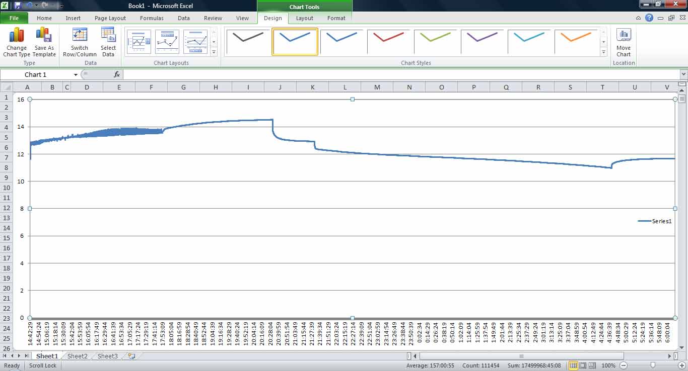

Hi,
I converted an old car battery that did not start the car anymore to an alum battery and after a few charges I did some
experiments to see if it could realy deliver some current.
I could drive a few 500 wat devices with an inverter on it.
After a few weeks it was still at about the same standing voltage and performing ok.
Karel

) discharge till 4:30 am (no sleep for patrick) and then let it come back up a little. So you are roughly pulling 2.5 amps for 7 hours in a 7.5 am hour battery. Looks like a winner. Nice! I do not think I have that concentrated of a mix, maybe I should thicken it up some more before I dump it in my next batteries. I mixed until I saw sediment stay, but I wasn't boiling it, just heated it up. Aln
