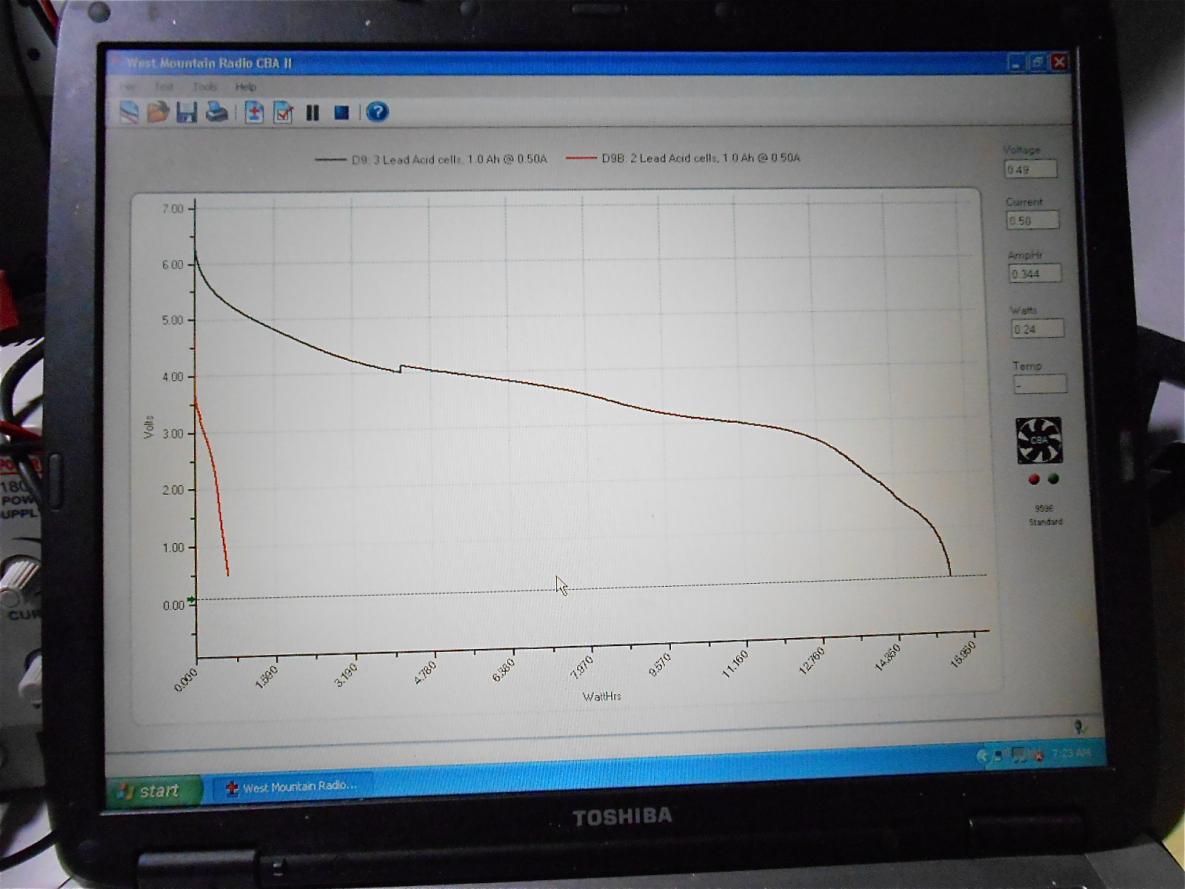

I made a small solid Alum crystal / lead plate cell today like we did with the magnesium and copper. It kinda worked. I formed the plates first and then built the cell with melted Alum and a simple mold.. I could not get it to take a charge unless I got the crystal slighly moist but it did take enough of a charge to run an LED oscillator. It was just something that I have been wanting to try and today was the day.
