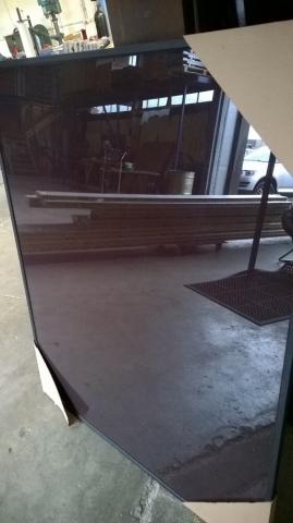

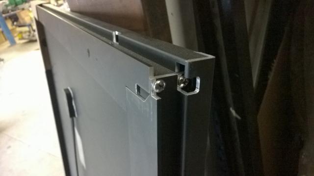

                I called a guy Bevan who installed this system from http://choosesolar.com.au. He had done a few other installs of these panels, he stated "they are a phenomenal bit a gear" and stated the build quality is excellent. He mentioned a 15Kw system and stated when you compare the numbers accounting for shade/cloud etc it behaves like a 30Kw Poly system.
                The only reason they don't do many installs anymore is due to Poly/Mono cost changes over the last few years and said it was a shame. He even TXT'd me some pics so I have posted them here with his comments.
                "Very Strong Frame"
                "High Quality Finish"
                He only has stock of the default 77Vmp version...

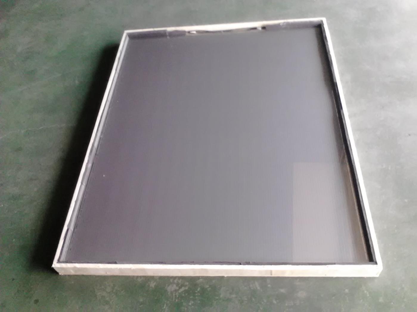

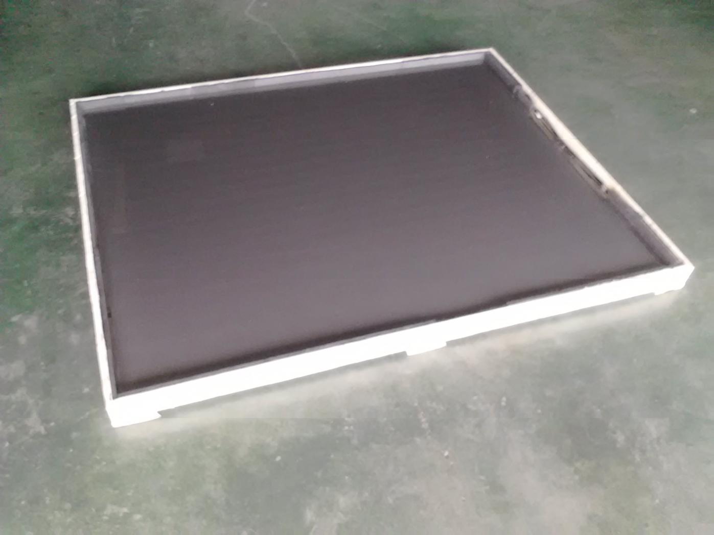

                  An update on the weight and dimensions. This is and email received from them:
                  "The size of the solar panel with an aluminum frame is 1106*1406*35mm, and the size of the solar panel with package is about 1420*1120*45mm.
                  The panel weight is 20.3kg, and the wooden box is about 35kg, so the total weight is about 55kg.
                  I have put pictures about package for one piece frame-less double glass solar panel before, please check."
                  I stated CM before which is incorrect. It's 142 x 112 x 4.5cm.
                  Pics provided by AmpleSolar about packaging.
Name:	package for one piece frameless solar panel.jpg
Name:	package for one piece frameless solar panel  .jpg

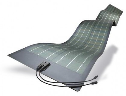

                    Another panel for research that will custom make modules spec'd to the TST5 12 and 24V. This one is a CIGS flexible panel. Currently investigating a link between Global Solar PowerFLEX and Sun Harmonics. The 200W and 100W panels are pretty close to TST5 already if you look at the Global Solar PDF.
                    Sun Harmonics quoted $3/watt which is more expensive however they are flexible meaning lower install costs with better efficiency
                    Global Solar are US based which could be beneficial to some of you.

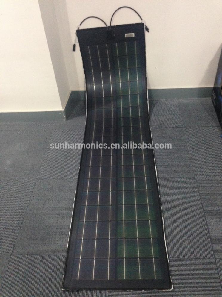

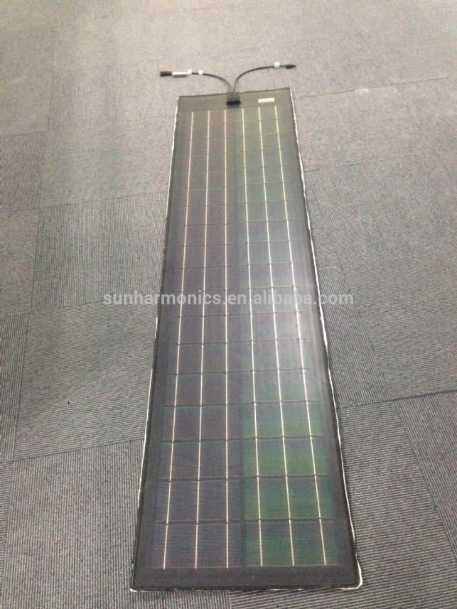

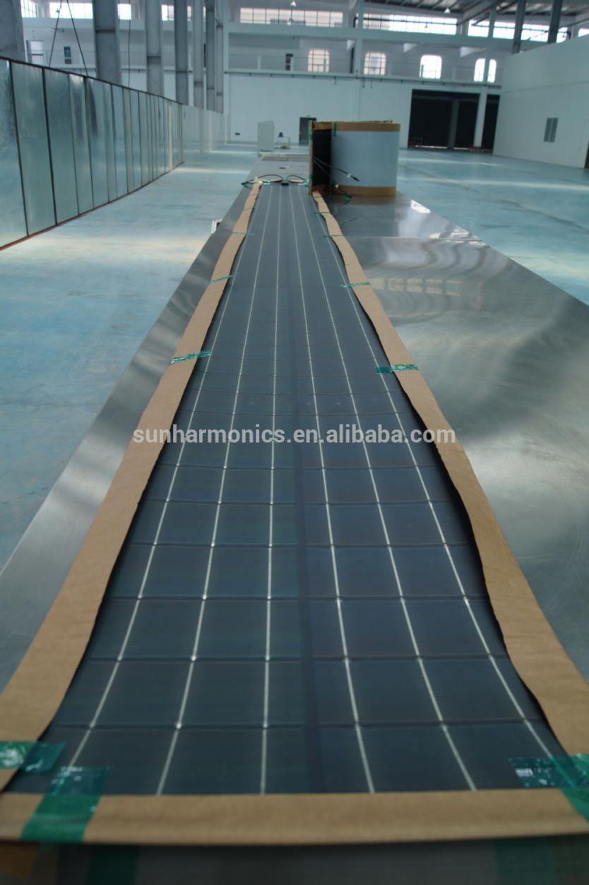

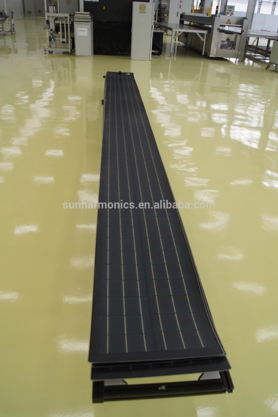

                      Received some pics from Sun Harmonics. Certainly look like the Global Solar Powerflex panels

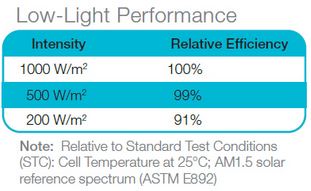

                          Low Light Performance
                          I have been liaising with Sun Harmonics to organise some samples of the 100W panels. Could someone with more knowledge explain in real world terms the Low Light Performance of these panels. From what I can understand a Poly/Mono crystalline panel's power drops right off at about 800W/m2, whereas these panels are still 91 percent efficient at as low as 200W/m2 which seems pretty awesome (see image below).
