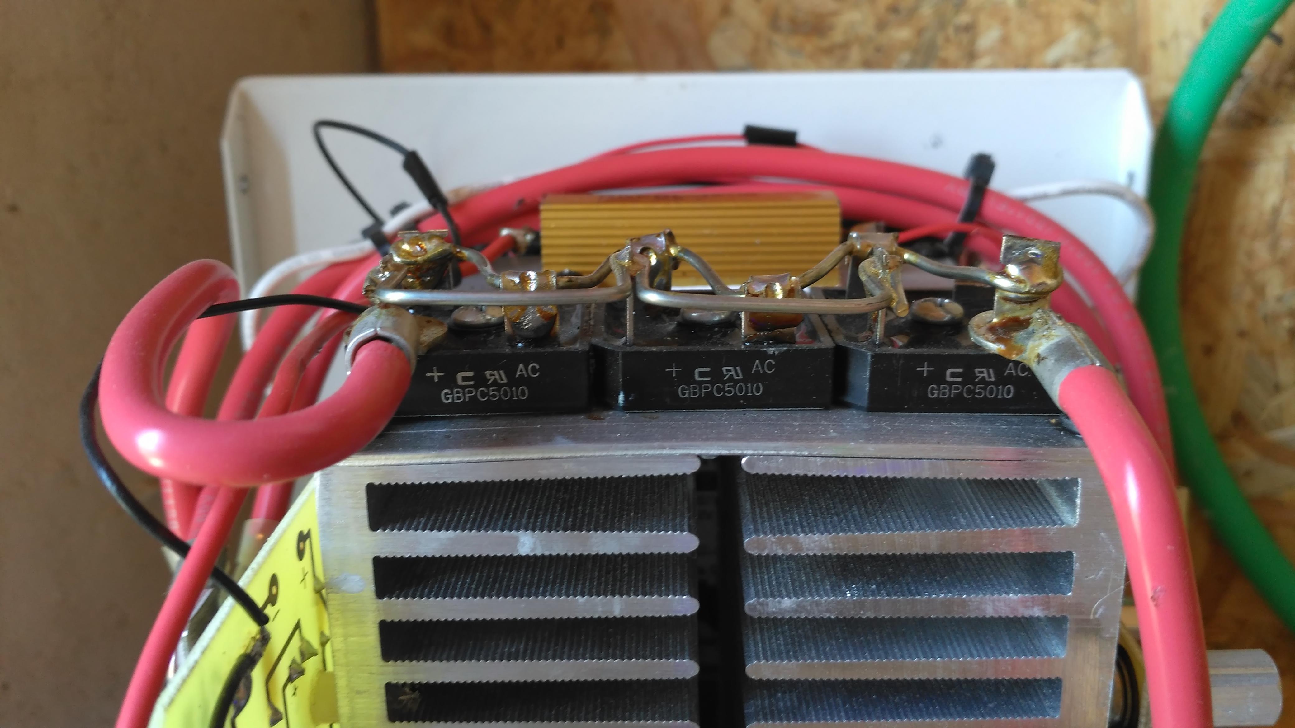

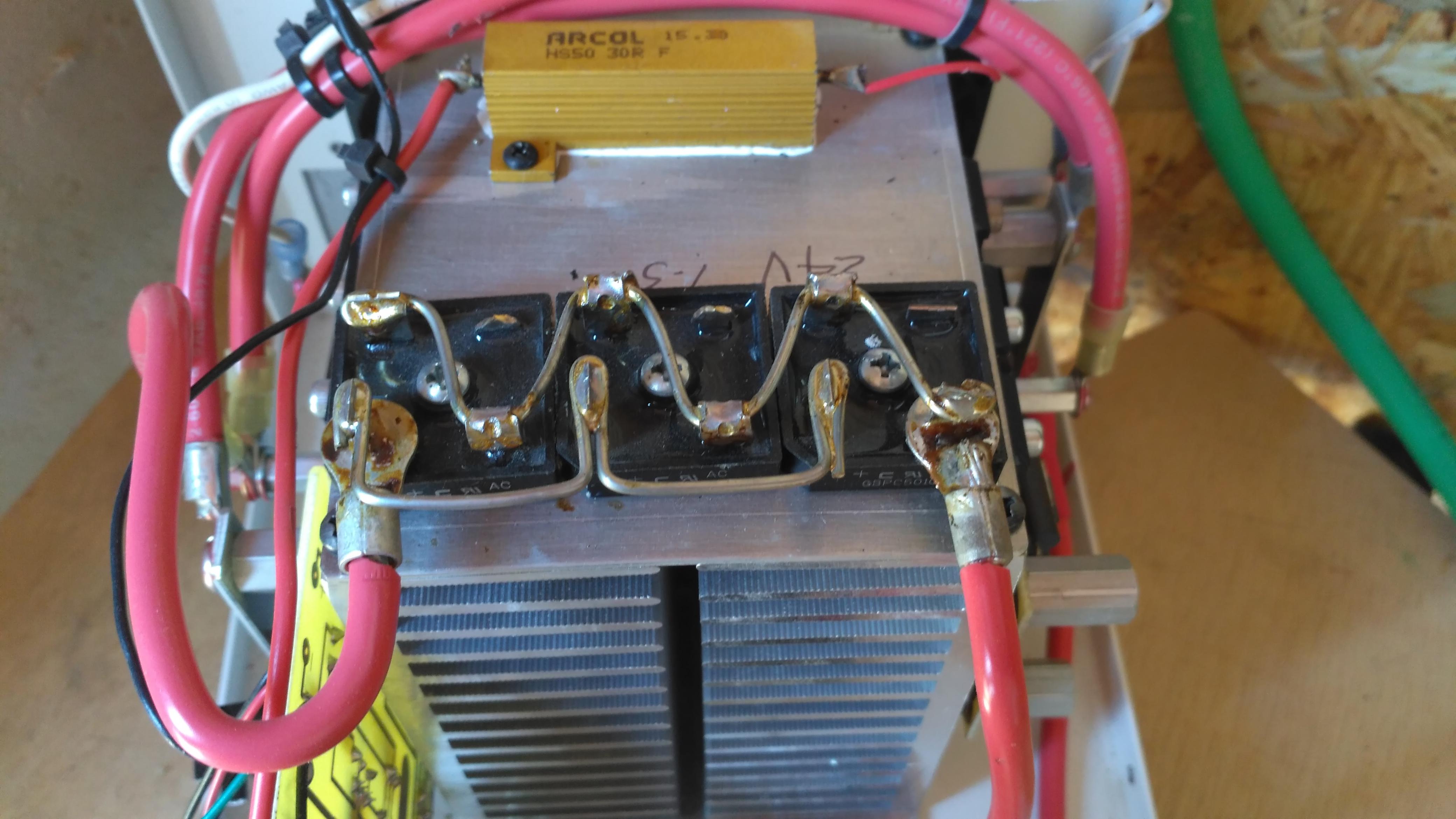

                so I have done some more tests and it seems like the unit is overheating. When it is cooler or I take the top off the unit it floats the batteries at around 30.7v. As the unit starts to get hotter the float voltage starts to increase.
                As you can see in the photo. when the fan failed the unit got so hot that the flux has come out of the solder on those components. Do you think that those components could be damaged and that is what is causing the unit to malfunction?

                  I'm sorry, I do not know what the problem might be. Is there a way to put multiple fans on the unit instead of just one?
