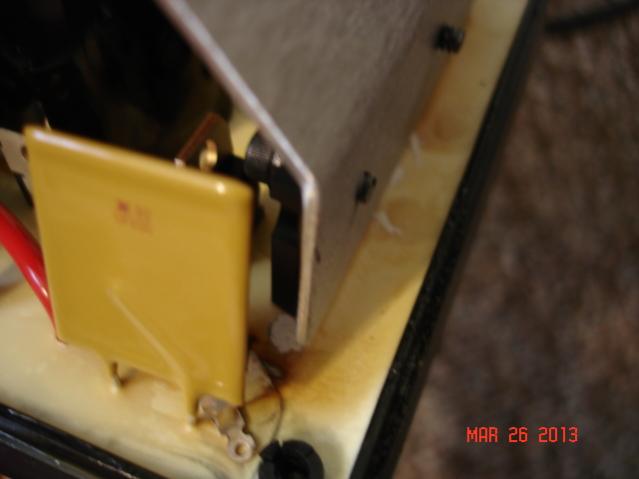

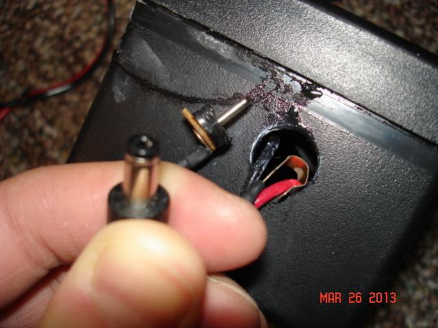

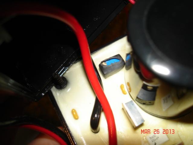

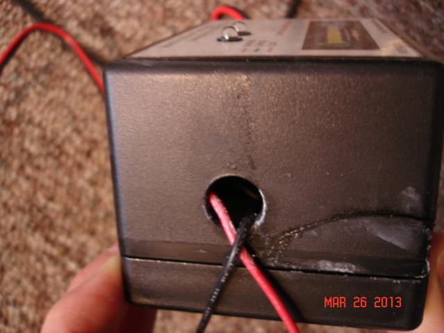

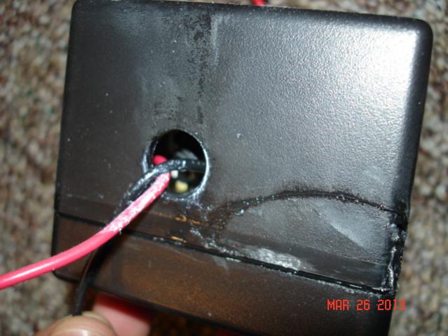

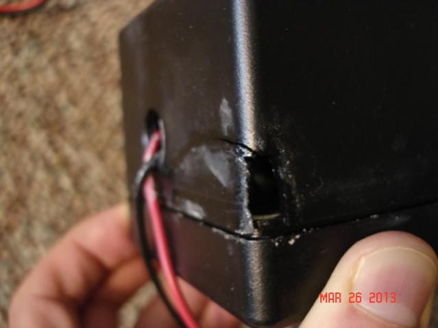

                  I just heard from a different user of 2A12 that it took him 3 days to fully charge 400+A/H battery. It makes me think maybe my charger is defective? The week I purchased it, it leaked some oily liquid when heated, then plastic cracked. How much would be to service it?

                      Originally posted by tesla View Post
                      Well, as per my previous post it was discharged to 8.76 volts the next morning after 3 weeks of charging, and it's not the only battery that loses charge the next morning. Aaron, are you recommending to charge it for another 3 weeks to 13+ volts? I am afraid that next morning it will drop to low again. I am saying this because of my experience with 2-3 days charging the same battery, it would always drop low the next day. It will take me 6+ months to do cycling with this speed.
                      When a battery is fully charged, it is normal for it to then drop a bit, but if you're talking about a few volts or something, then it isn't holding for some reason. If the capacity is reduced, it may be just charging to that lowered capacity. You probably have checked the water level, but I want to mention it anyway. I'm not sure how a 2A12 fully charged a 400+ah batter in 3 days, but stranger things have happened.
                      If you're taking about oily liquid leaking from the charger, please send us an email with details. There shouldn't be anything like that going on. If you purchased this from Tesla Chargers, please email it to the customer service email listed on the banner at Tesla Chargers | World's Most Efficient, Effective & Advanced Battery Chargers and if you can email some pics, that would be great. Something sounds strange about that. Just include details when your purchased it, etc...
                        I posted another result, see here: http://www.energyscienceforum.com/te....html#post6887

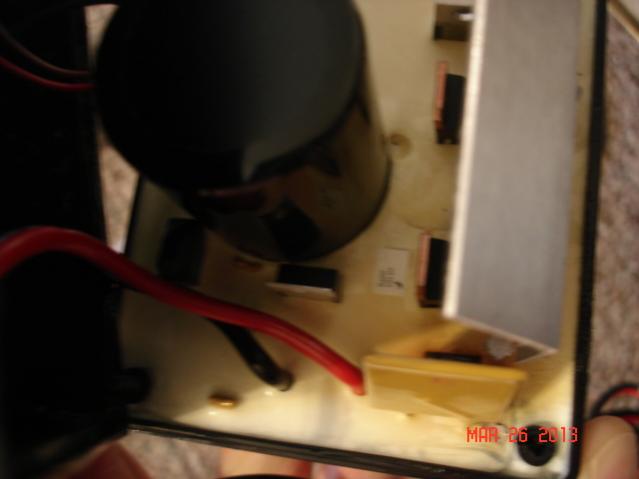

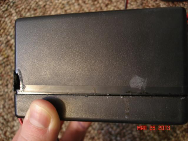

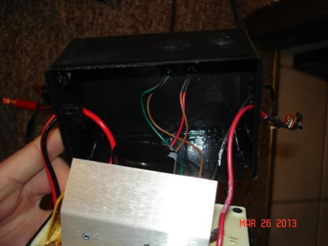

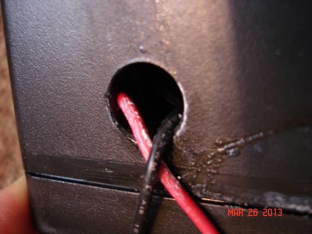

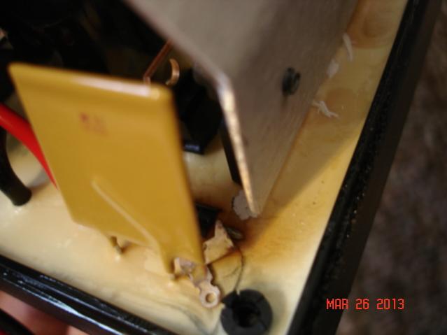

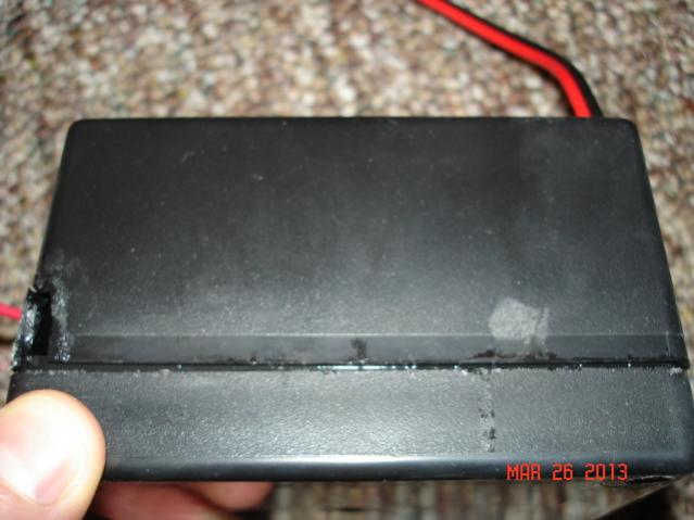

                        When it comes to warranty I believe I purchased 2A12 last fall from Rick Friedrick -"Going Green Saves You Money" Renaissance Charge/Energnx , but since the cover cracked and oil leaked and I had to open the unit to see what is going on. I guess you wouldn't want to have a fire in the house caused by a 2A12 charger, right? Opening the unit voided the warranty according to the manual. And support was appalling for the product that I will never buy from them again. Terrible, terrible support team. I was also disappointed that all parts in the unit are non-user-serviceable and filled in with hard epoxy, so if anything goes bad after 12 months you feel like you made a really bad investment.
                        I will post some pics here for you to see soon.

                            And more. Notice how oily the inside of the 2A12 is in these pictures. Notice how the epoxy has become brown in spots and it is oily as well but not so visible on pictures. I would wipe this oily liquid from outside of the box, but it would come back in a week or two. Also as you have seen, that round hole where the power supply plugs into the unit has manifested by itself, one fine day it just came off just like that, and the crack with that chunk missing also one day came off - beats me, I don't know how it happened, I don't know how oil happened to be in the box, and I don't know, how that round thing came off. The whole unit is a mess, I can't even tighten the screws anymore after I took these pics, probably thanks to the oil again, or corrosive oil maybe. And maybe I am also having a problem with charging my batteries because I got a lemon charger. :Click image for larger version

                              At Tesla Chargers | World's Most Efficient, Effective & Advanced Battery Chargers we have excellent customer and technical support.
                              The circuit is filled with that potting compound to prevent people from reverse engineering the proprietary circuits and there is no need to have user serviceable parts when you have a warranty.
                              I have seen various chargers returned to EnergenX and out of all of them, it is extremely rare that the problem is from a manufacturers defect. It can happen that there is a bad capcitor or something, but it almost never happens.
                              Almost every charger that is ever returned is because the user has abused it and used it in ways that it was not designed to be used. Some people have used these to jump start their car, they use them as power supplies, etc... and then complain that they power transformer melted. I'm not saying you abused your unit - this is what we deal with occasionally.
                              For your 2A12, as Tom mentioned, it sounds like a cap exploded and leaked oil but I'm not sure why you would open it if you knew that would void the warranty. Even if Rick is unable to provide you with customer service and you purchased it last fall, it would still be covered by warranty and you could contact EnergenX direct for a possible replacement unit. Hopefully Rick actually sent you a new unit when you ordered one and didn't accidentally send you one that was returned.
