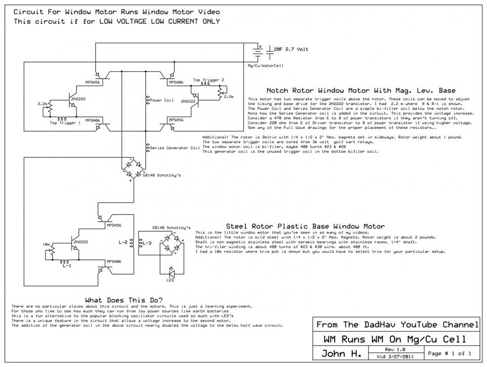

Do you mind showing the circuit your using so others can see what is going on? Or if you prefer to keep that to yourself that is ok also. If I'm close the coil impedance is around 5 ohms, Cole circuits were 3.3 Ohms and some that I built were 10.2 ohms. The window motor on the Rense show was 5 ohms self running on the cap 40000Uf, for about 10 minutes. At the current your using it should run for a very long time. Happy to talk to you about the window motor, you do excellent work and very neat to say the least. Excellent circuit too. I have two extra windings on that motor I showed #20 and #21 wire as I was doing series hook-ups with short triggering.
