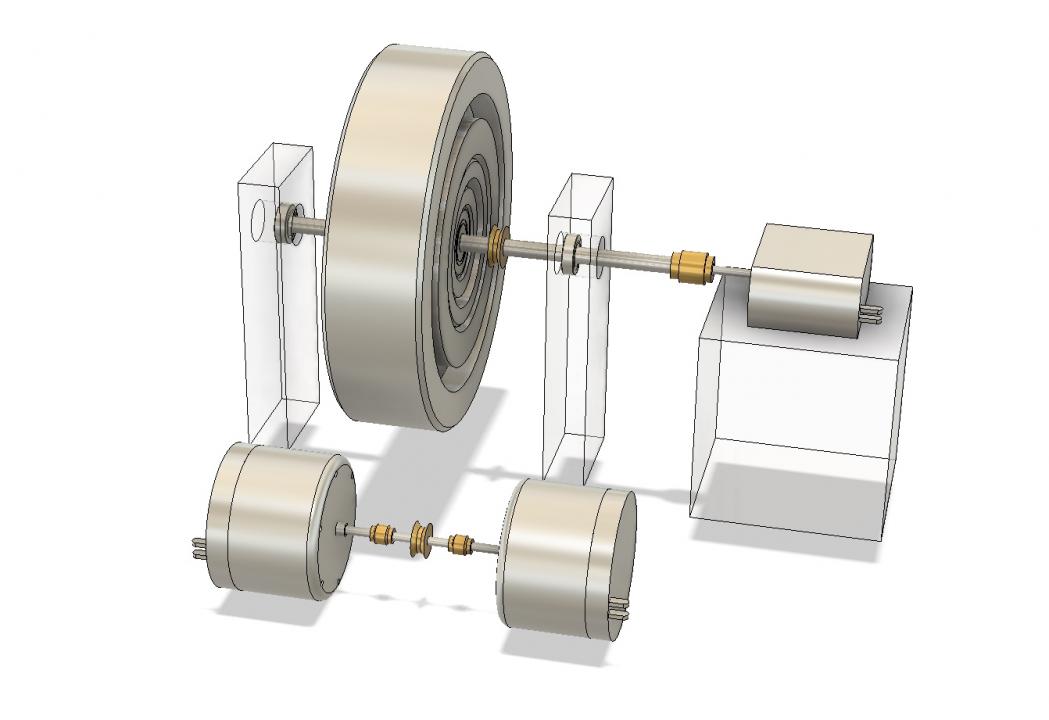

    Some of you may have seen this before but, as a prelude to my starting work on a fully working scale model of a flywheel generator, I though I would post this.
    The 1200% mentioned by the reporter in the text was in fact meant to be a multiplication of 1200 (120,000%) that would result in the approx 110kW to power the town at that time.
    My model will be based on the attached design.
    Jules

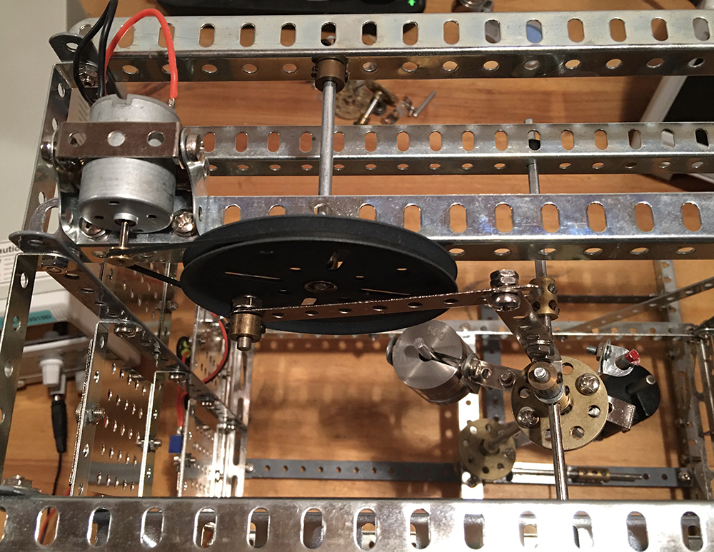

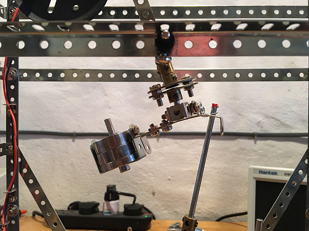

      Hi all,
      I have spent the autumn building a small scale replication of the William Skinner device using Mecanno. My aim was to test the principles of the device, make a series of measurements of input and output power, using a classical dynomometer approach and to calculate the CoP.
      From this I planned to embark on a full scale replication with a view to producing a device capable of generating about 3kW.
      As it happened my experiments on the small scale device gave a CoP of 0.1 so a lot more energy was being used by the small motor to move the upper weights and the translation joint then was emerging from the output shaft connected to the lower weights.
      This was a big disappointment and very surprising but I have to stand by my results in the scientific approach.
      If anyone would like to read my 4 page report and see the video of the device then these are available at: https://www.dropbox.com/sh/bws0akodi...fIdN6zVZa?dl=0
      Thoughts and suggestions are welcomed.

        Jules, thanks for posting your work. I just downloaded the report. You're right about the small scale vs large scale friction losses. The bigger it is, the smaller the friction percentage per bearing, etc.
        I know someone that has a full size 4 quadrant unit - he just has to add the elliptical input mechanism. I'm looking forward to the progress and hope to be able to report something.

            Thanks for posting your results. I admire the professionalism and dedication you bring to your experiments! Good work.
            I noticed in the video that Skinner's device used four weighted shafts for the output and only one input motor. It also looks to have less inclination on the lower rods (with the output weights attached) and the center of gravity on the lower weights seem to be higher from the bottom attachment point than on your model. I assume that the ratio between the mass of the top and bottom weighs is very important as well as the angle between the center of orbits of the top and bottom shafts.
              Hi Gary,
              My small scale device did not replicate all the features of Skinner's original system. You rightly point out some differences but I argued that the key issues of the independently moving upper and lower masses, a greater than 2:1 mass ratio and the elliptical movement of the translation joint should be sufficient to at least demonstrate a CoP around 1 or even a bit under. While raising the centre of gravity might help I did try stacking more weights on the bottom which both increased the mass and raised the CoG but that also required a lot more input power on the small motor to keep it running so I found a happy compromise of all those factors, including the long shaft angle caused by the upper mass orbit. The fact that the CoP was way down has to be due to something else and I proposed that the friction losses will be much higher gram for gram with a small device than a 30kg or larger system and that may or may not be the key.
