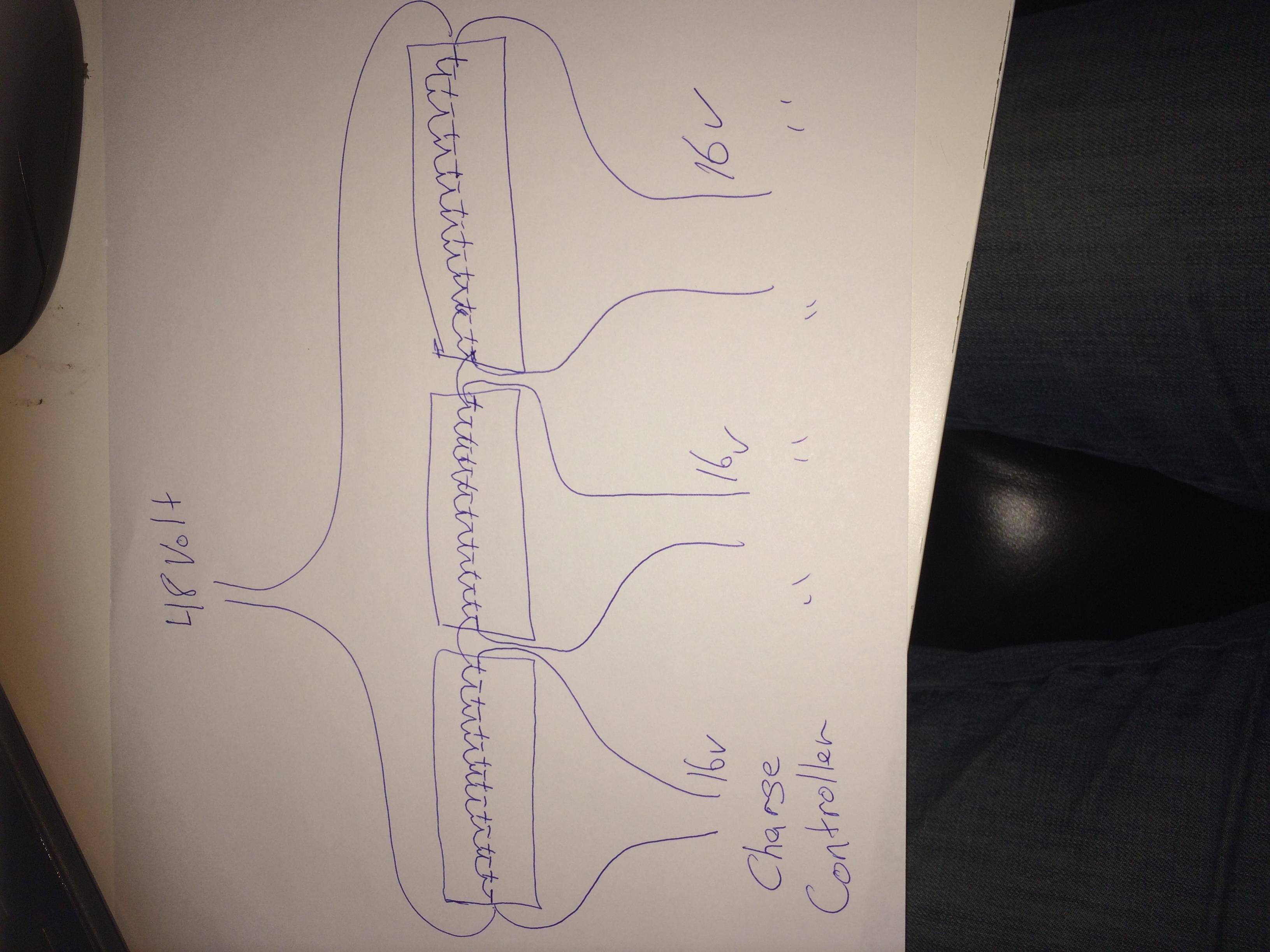

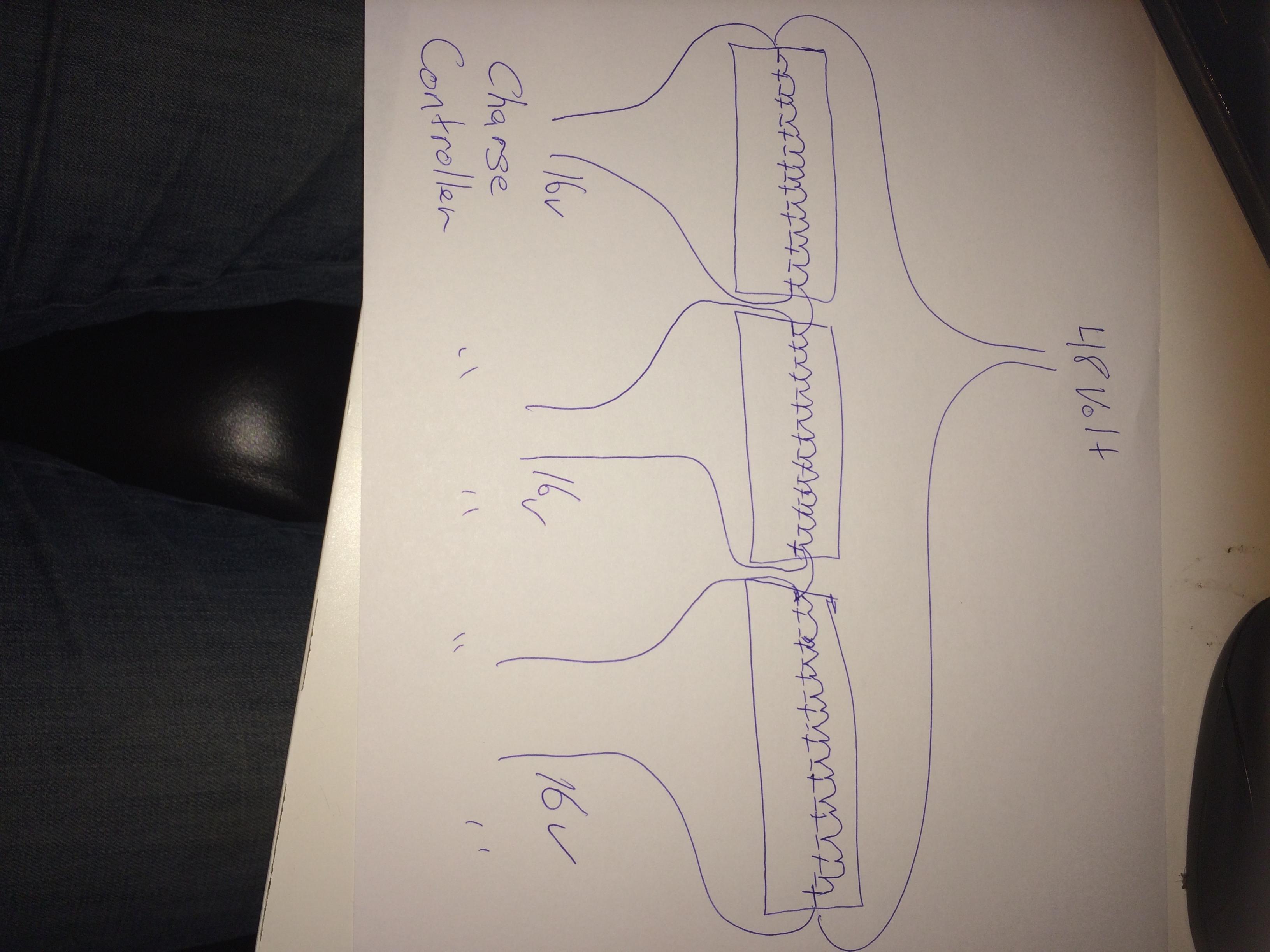

    [ATTACH=CONFIG]5571Hey Guys Looking For Some Knowledge on Charging A 48 Volt Batt Bank. Yes I know 24 Volt is Ideal for certain reasons However My question is this and there doesn't seem to be a lot of knowledge out there regaurding my question so here it is...
    I would like to divide three chargers beetween my 48 volt bank in order to optimize equalization. So to do so I would like to set parameters so as to charge 8 cells with each individual charger 3x8=m 48 and can I do this and let each charger take care of 8 cells instead of three in parallel trying to charge the whole bank off of each end +to- hope this is understandable somebody has to know.

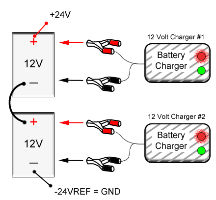

    [ATTACH=CONFIG]5572[/ATTACH]
    If you are using 12 volt batteries, just get a 4th charger, one for each batt.

      Yes this is a good way to do the charging...however 8 cells for a 12v Battery..??

        That would be 8 cells 16 volts per charger 8x3=48Volts.One String of 24 cells in series 2 Volt Rolls Surrette Tapping into three different sections One Morning Star Charge Controller every eighth cell to Charge 1 of 3 sections each... That twelve Volt Picture is just an example.
        Thanks for the input Trying to get this Nailed Down
