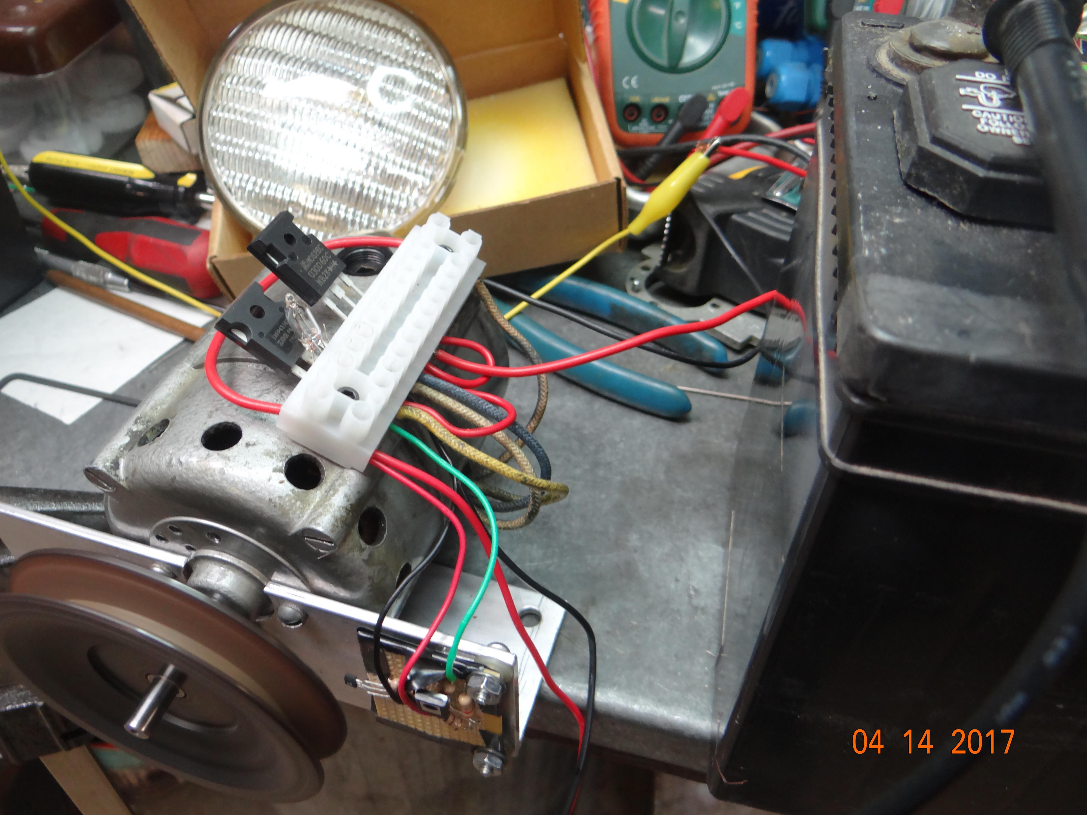

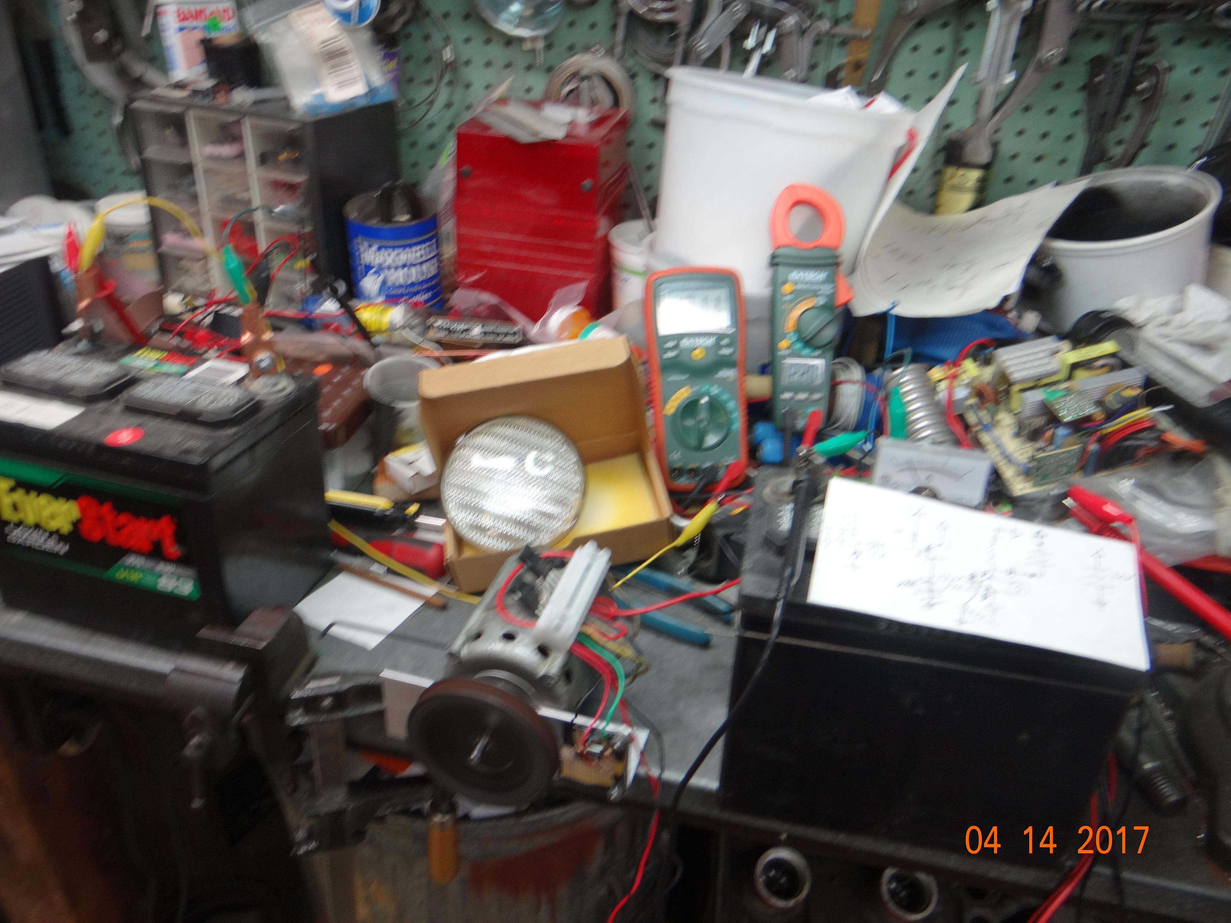

    I have decided to replicate Peter Lindemann's Rotary Attraction Motor. This design has always fascinated me, so I decided to replicate it. It's a no BEMF design and can be seen on the "Energeticforum Y-tube Channel" here https://www.youtube.com/watch?v=-F39DaTXC7E and here https://www.youtube.com/watch?v=UNa_jryP8MY . If I can get good results I would like to try driving a no-BEMF generator with it.

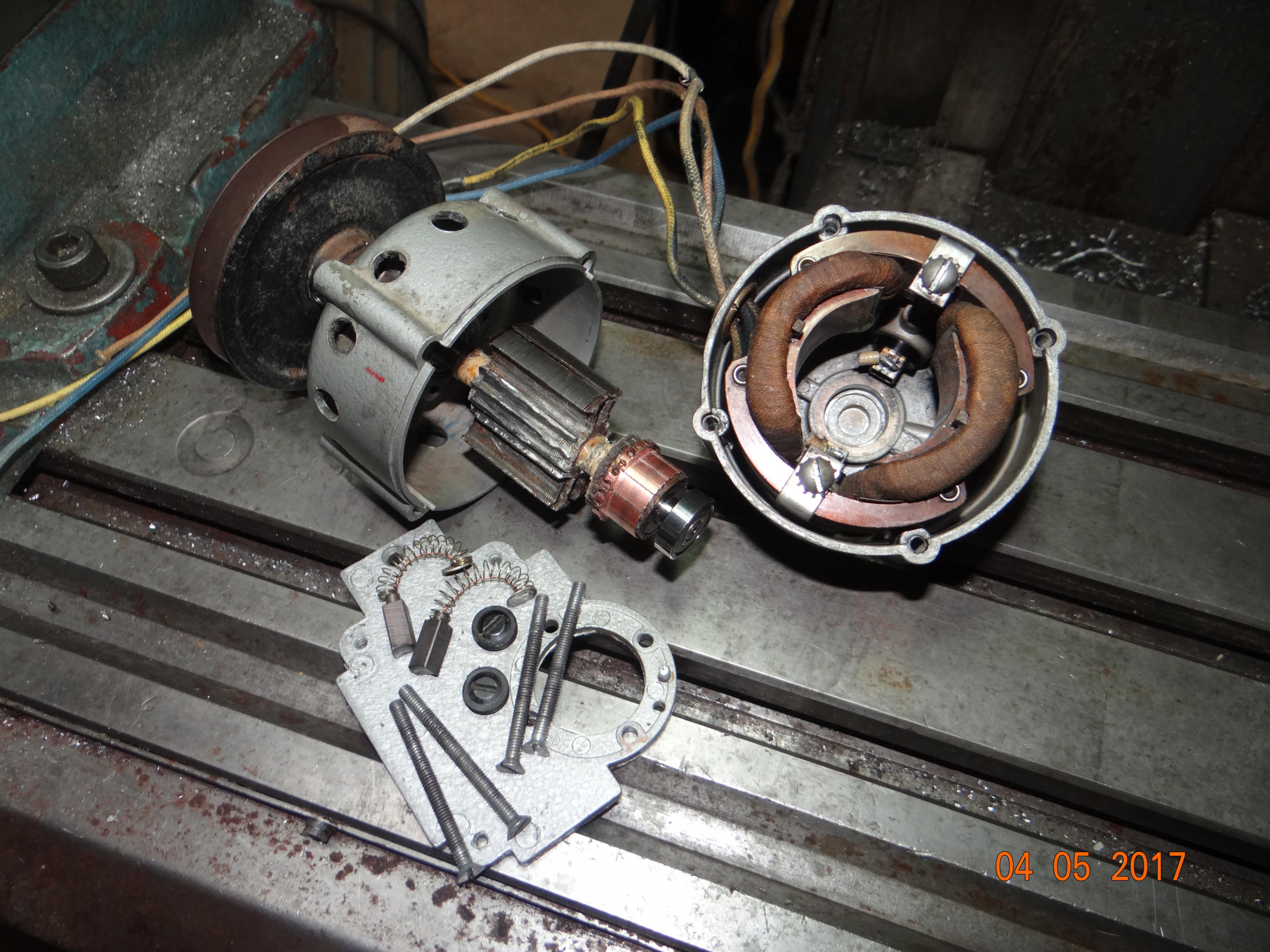

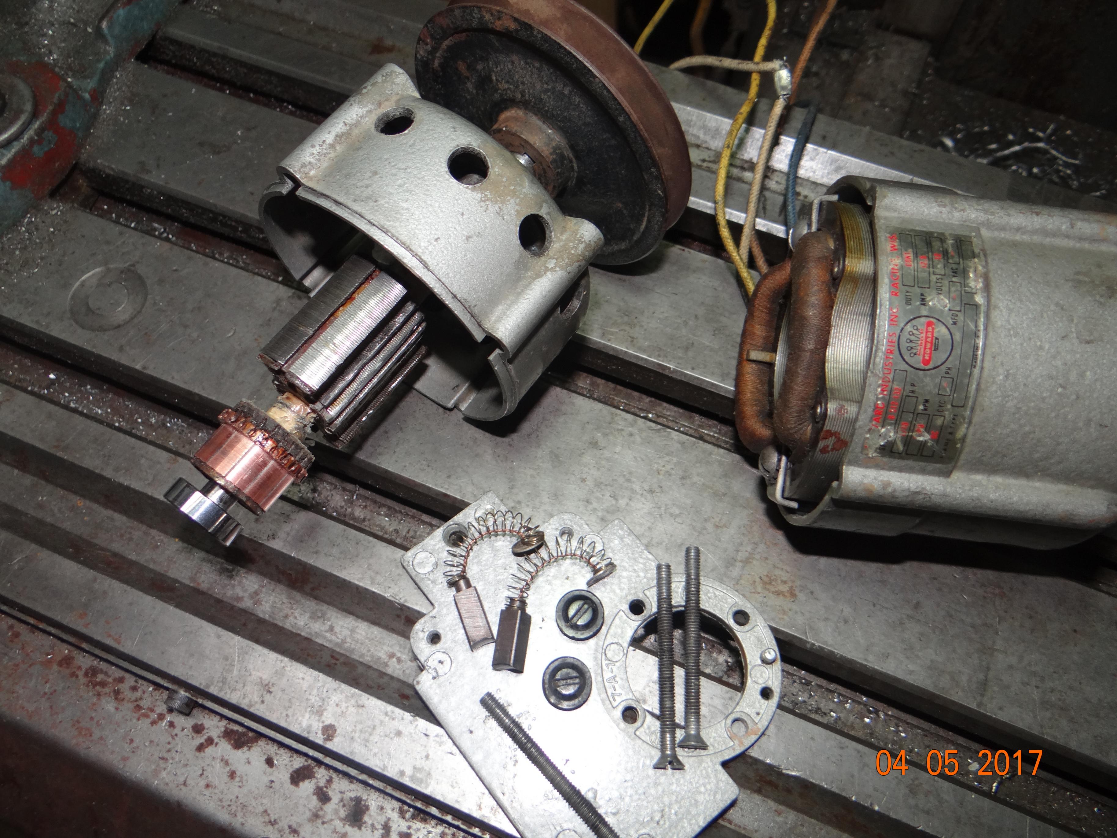

    I just started the build last week with an old DC motor I had lying around. It will probably take me a few weeks to get it finished. Here's a few photos of my first progress. Click image for larger version

    I removed the windings from the rotor, removed the brushes, and shaved the rotor down to match the stator width. Upon energizing the coils, it pulls the rotor into alignment with a fair amount of force. The original motor was rated at 1/10th HP, 7000 RPM, 12.5 Amps, and 12 Volts. I removed the gear reduction from it as it was originally designed to power a wheel chair.
    I experimented a little with magnets on a cast pulley and reed switches, but wasn't happy with the inconsistent results. I plan on using a hall switch arrangement instead, as I've achieved good results with that on one of my SSGs. And I may go to a non-magnetic flywheel as well. I want to be able to control timing and pulse width. I will be capturing the coil collapse with a fast diode and experimenting with various uses of the recovered energy.

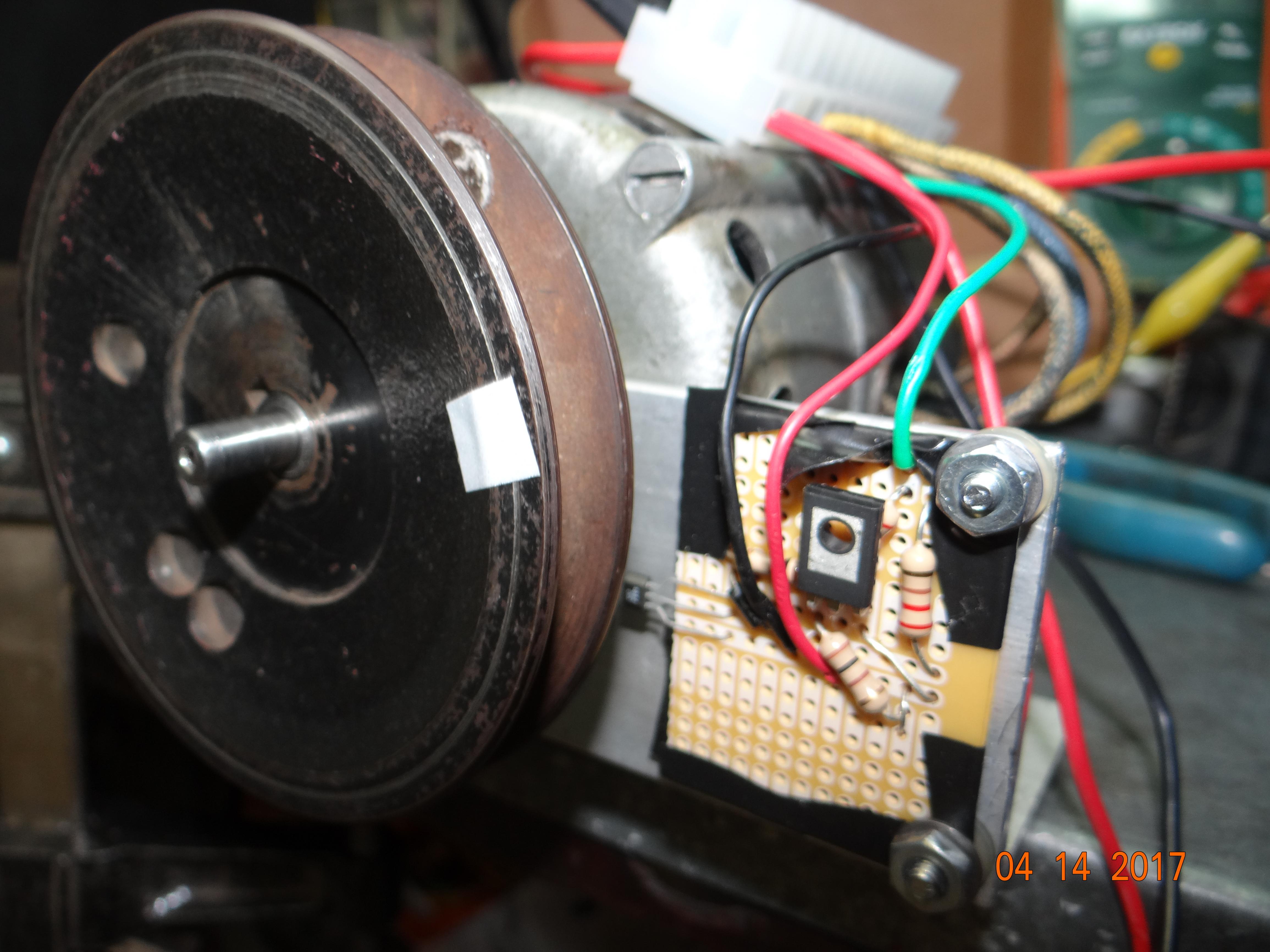

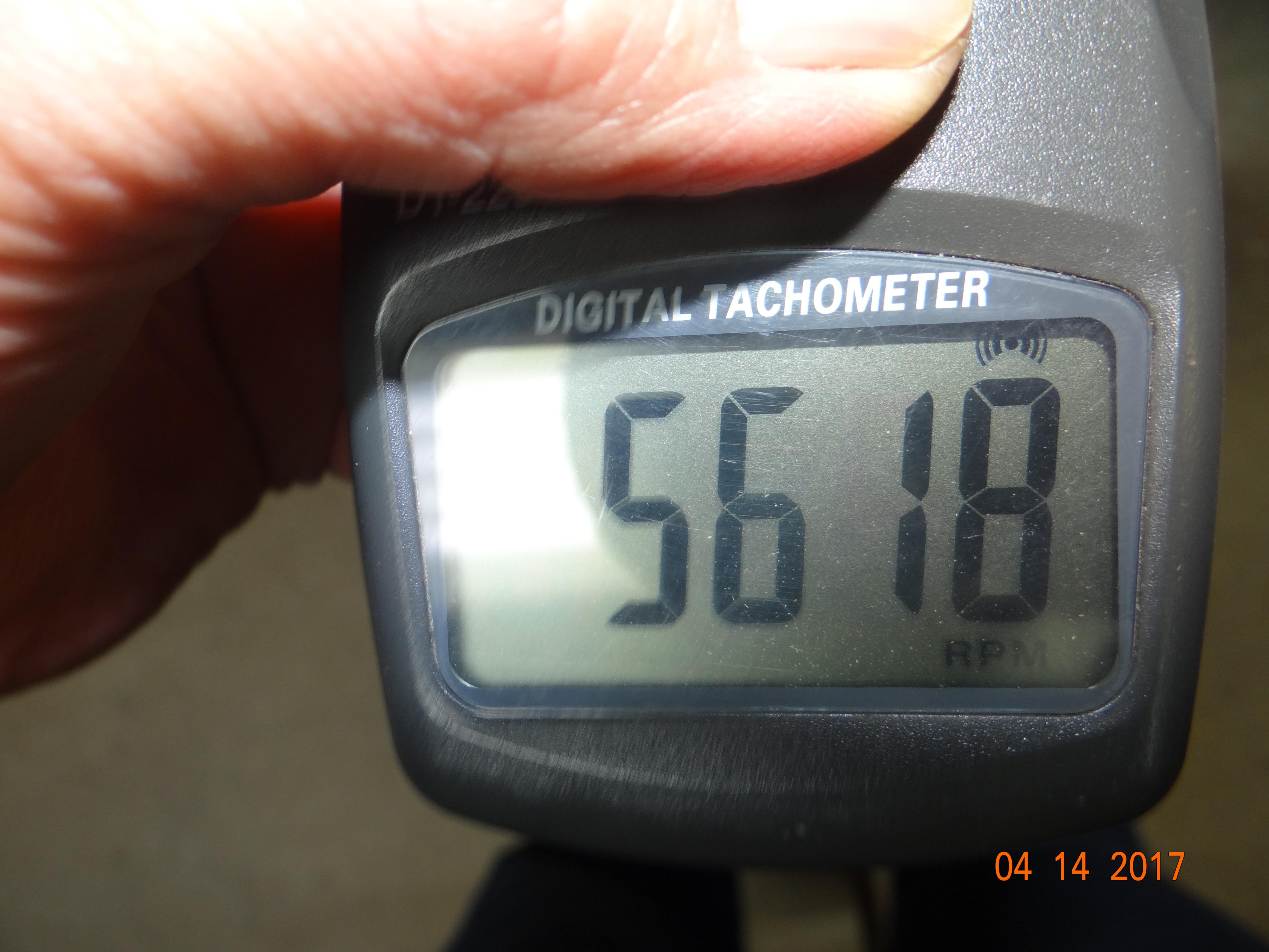

        Got my rotary attraction motor up and running today after a few false starts. LOL I started out using an MJL21194 transistor, but it was running way to warm to suit me, so I switched it out for an IRFP4310 power mosfet. This thing runs cool as a cucumber! No heating anywhere in the circuits or coils.

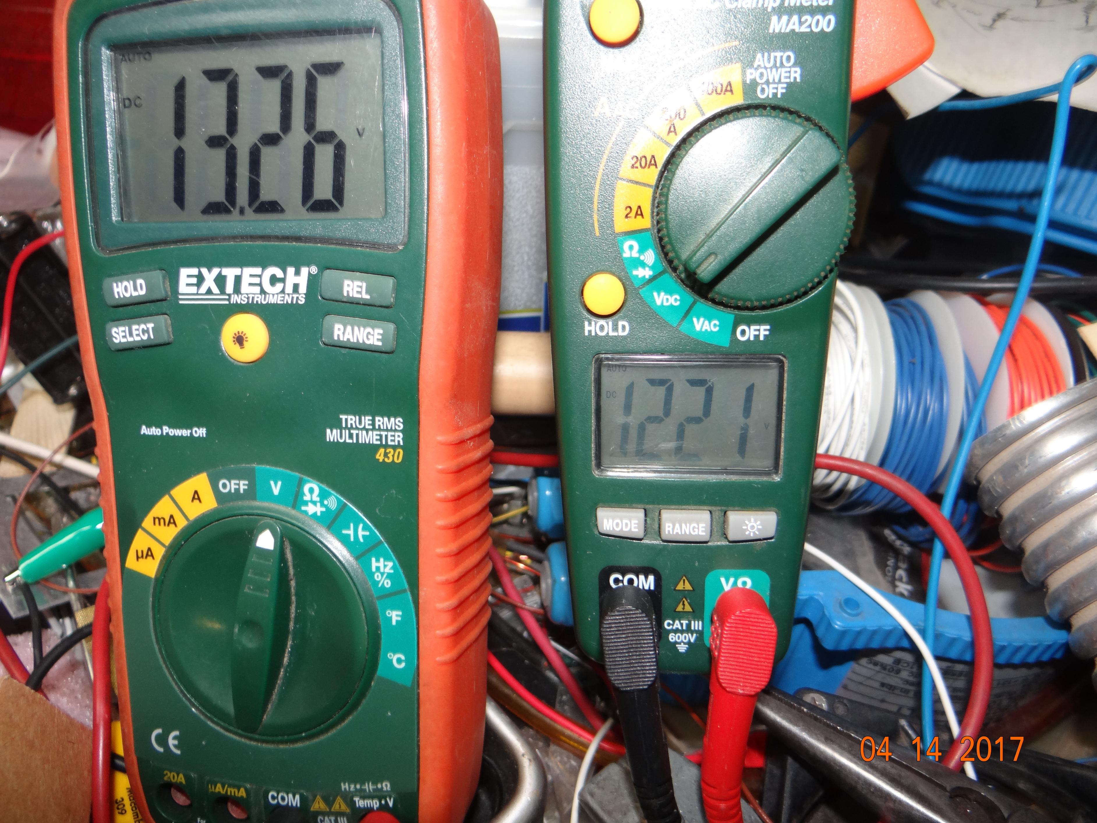

        After experimenting with the timing I settled on a spot that gave good acceleration, moderate speed, and the lowest current draw. I hooked two lawn tractor batteries to it, both of which started with a resting voltage of 12.56 volts. It accelerated to 5500 RPM and immediately started raising the voltage of the charge battery while drawing about 510 ma from the run battery. It was developing more torque than I thought it might, and when loaded the charge battery started increasing voltage at a faster rate. And the current draw went up to about 700ma.
        Here's some photos from the first run. After maybe 15 minutes the RPM was up to 5600+ and the voltage was increasing on BOTH batteries.

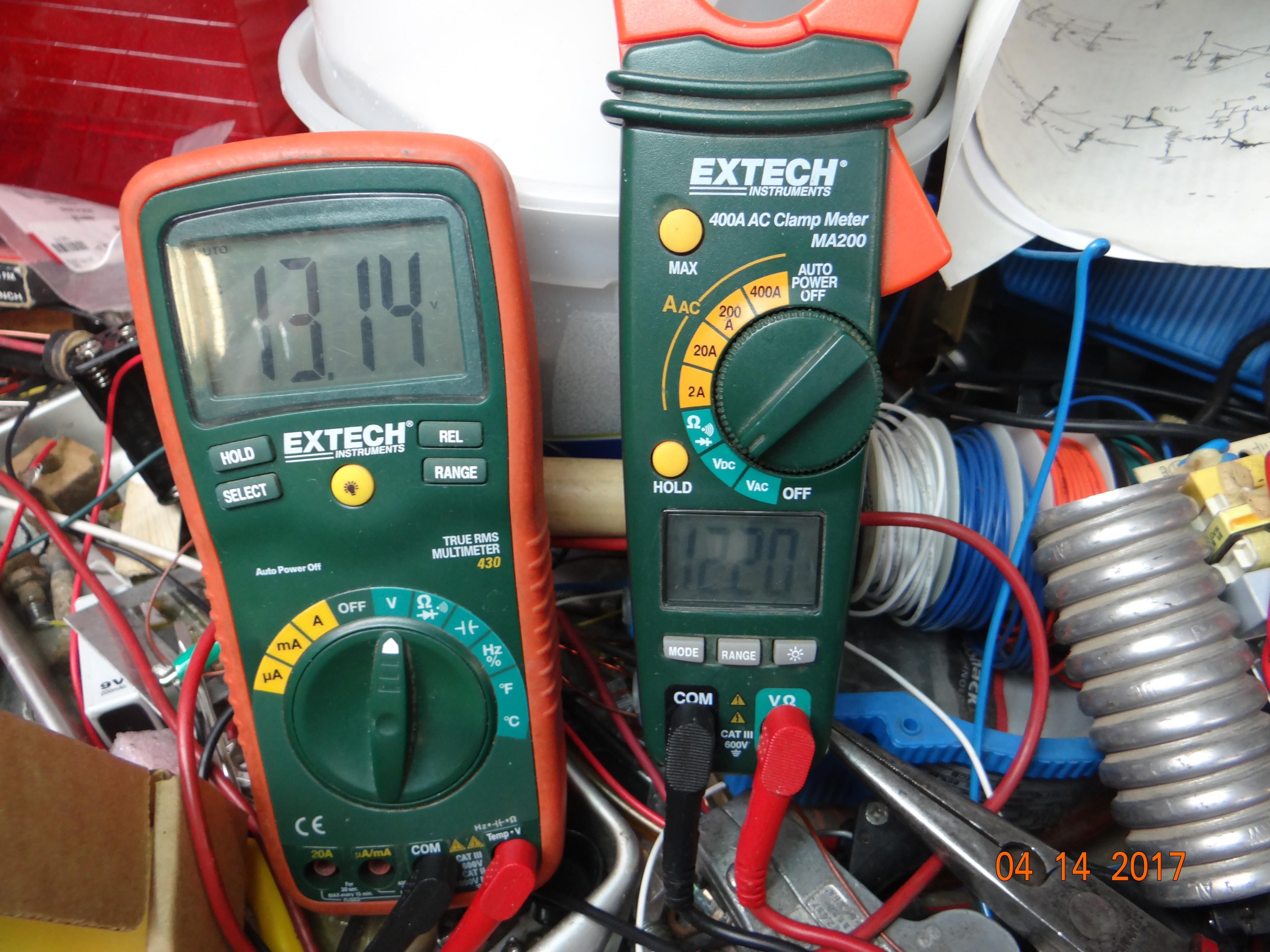

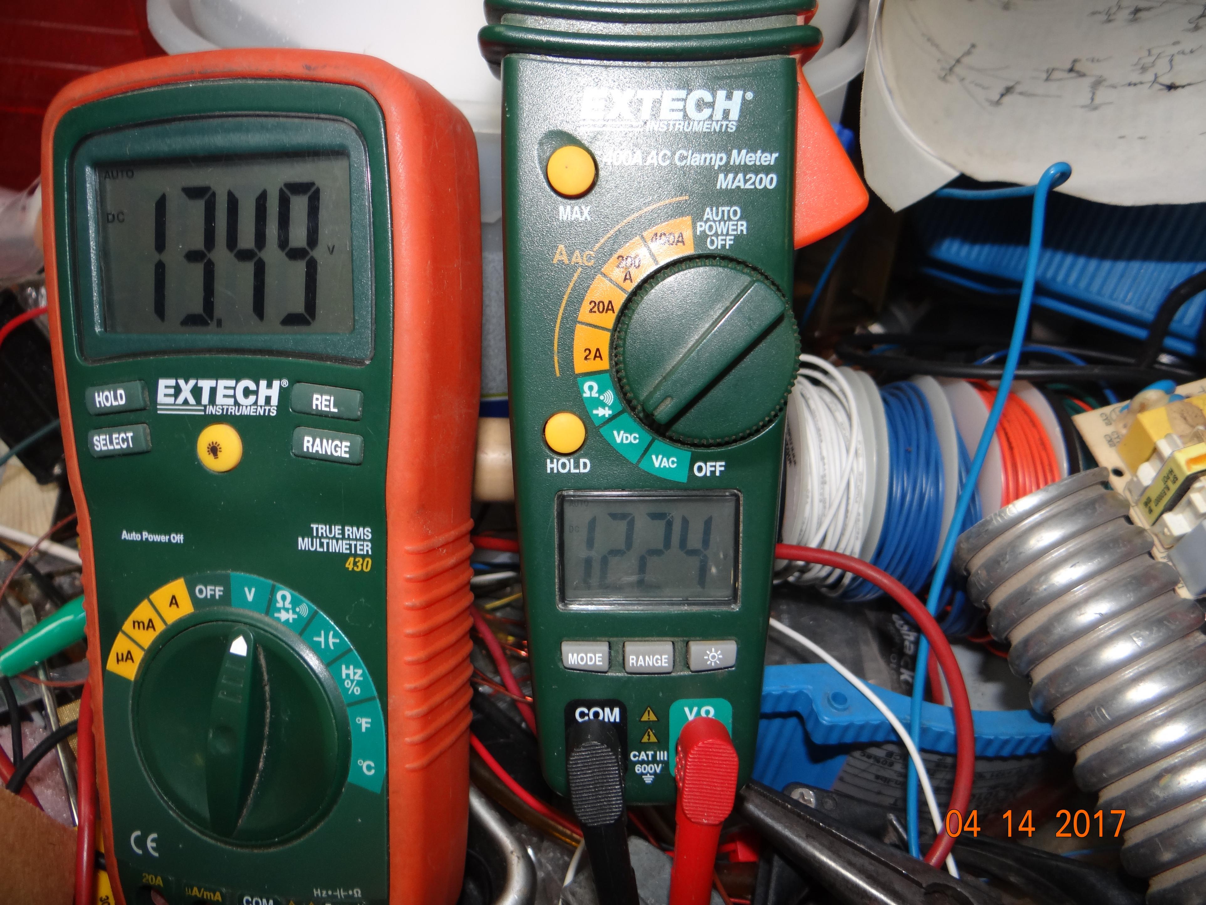

          And here's photos of the voltage increase on both batteries.

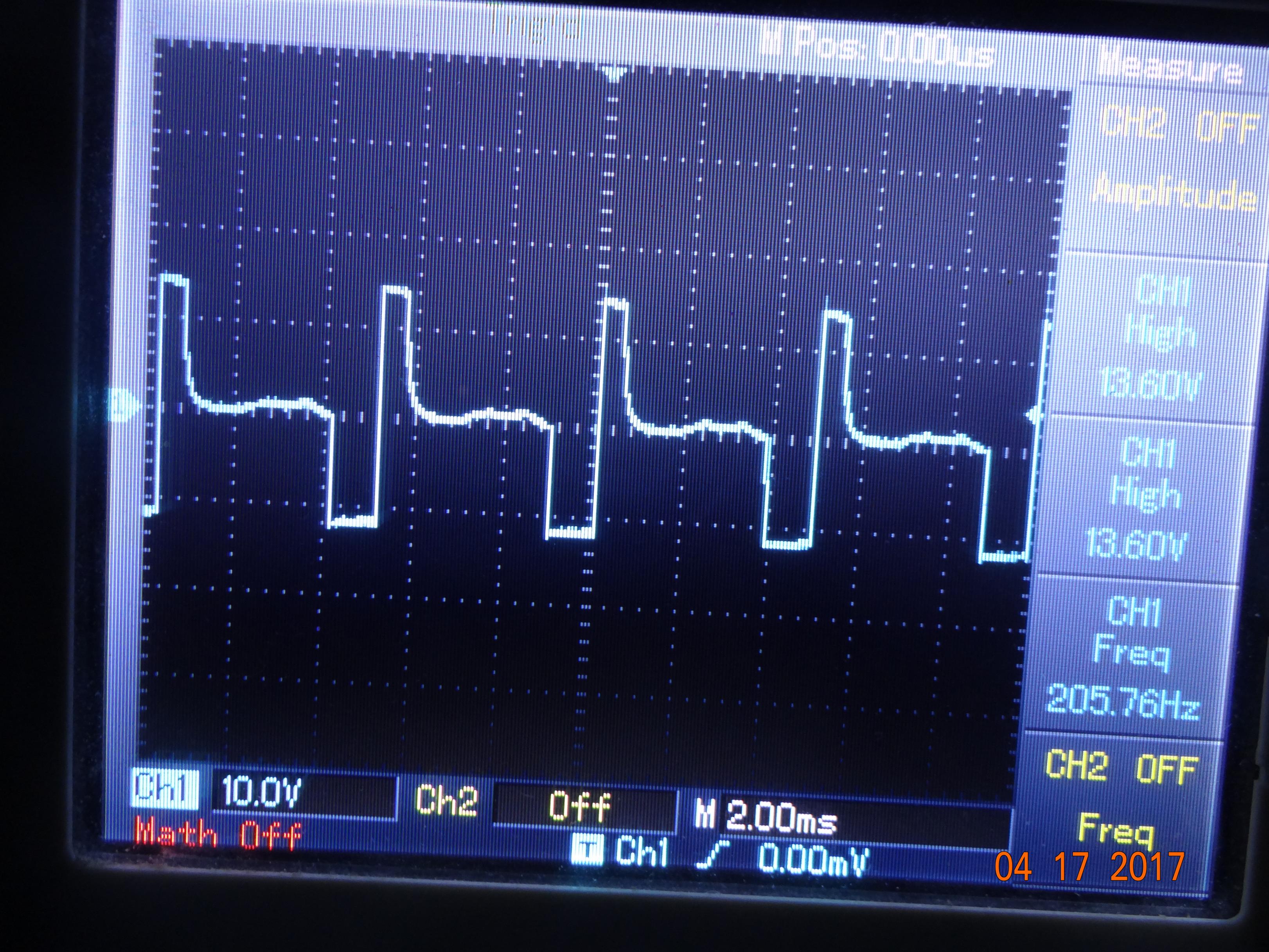

                  The first scope shot shows about a 20% duty cycle, 205.76 cps (6173 RPM), and noticeable ringing throughout coil discharge. This is a lot more ringing than any of my SSG machines!

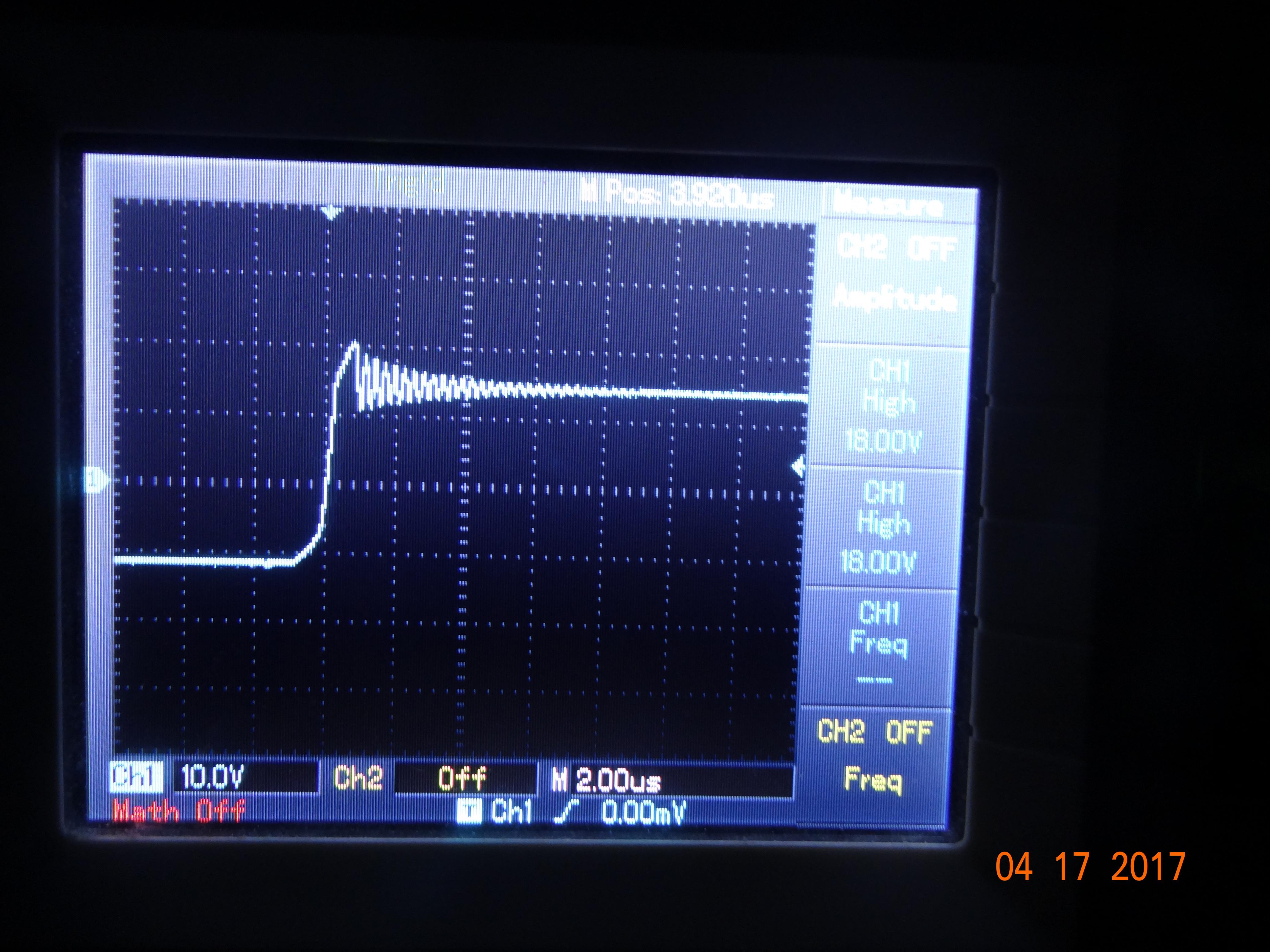

                  In the second scope shot, you can see the 6 volt radiant spike when the FET turns off. And you can also see some of the ringing over the rest of the wave form.

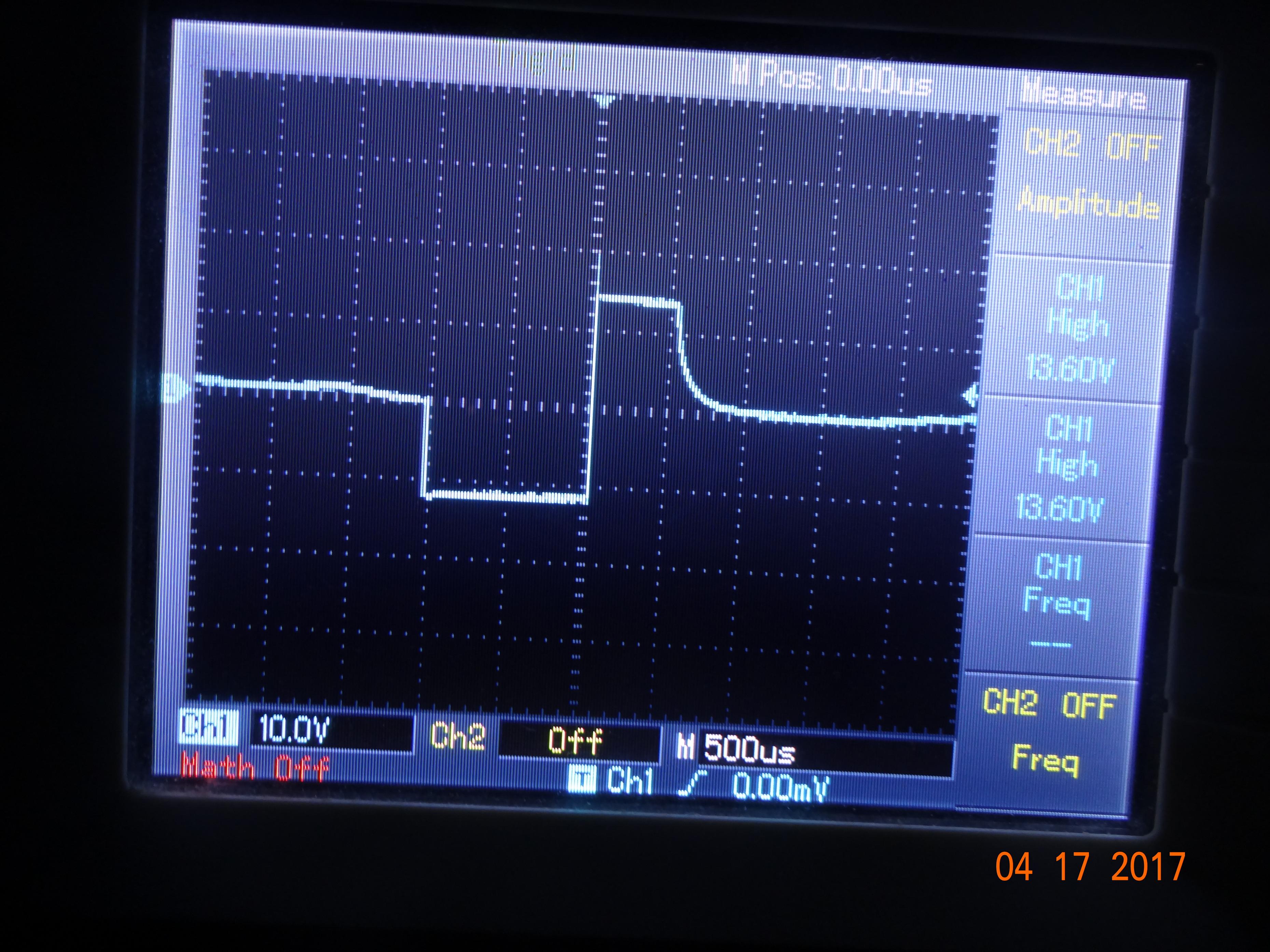

                  In the last scope shot you can see the pronounced ringing after the FET switches off.

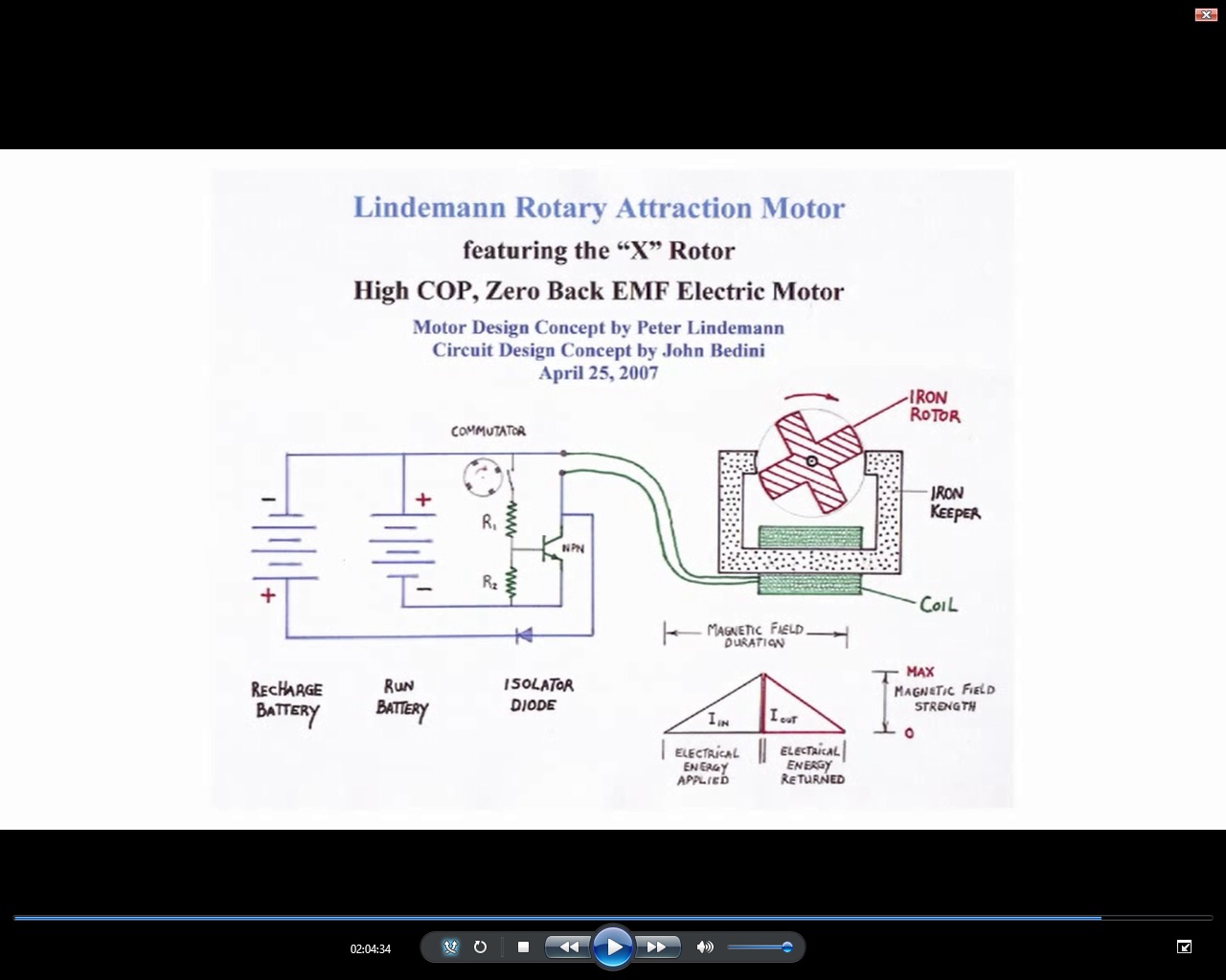

                  Since there are no magnets going past the coil, I thought there would be less of an "h" shape and more of a triangular shape to the collapsing wave form. But then again, I was probably thinking in terms of current rather than voltage! Peter shows a triangular current wave shape in his presentation as shown in this photo.
Name:	Rotary Attraction Motor.jpg
                  Anyone have any ideas on why all the extra ringing shows up?

                    Hi Gary,
                    After referring to your drawing in post #5 my first wild guess is that you are picking up ringing off the batteries. Less likely would be an interaction between coils either electrically or fields. Last possible is you are developing capacitance some where in your circuit possibly in the windings.
                    It might be helpful to know the exact points you were probing for each display, but honestly probably wouldn't change my guesses.
                    I am not really much help just throwing some guesses out there.
                    I believe the triangular diagram you showed is supposed to be a representation of total input current vs total output current as a relationship and not necessarily what you would see on a scope even with a current probe.
                    Michael
                      Hi Michael,
                      Thanks for the response. The scope probe was attached to the junction of the FET drain with the coil and diode. The probe ground lead was attached to the other end of the coil at the junction with the primary battery positive lead and secondary battery negative lead. I also got the same overall wave form with the scope ground lead hooked to the primary battery negative lead (which shows the voltage across the FET).
                      I then removed the ammeter from the negative input lead as this reduces the slight ringing after the spike on my SSG. The only affect that had on this motor was to increase the free running RPM a little. And I noticed that when loading the motor down, the amplitude of the ringing increased but the frequency remained the same. I was able to measure this frequency at between 4.35 MZ and 4.55 MZ depending on how I had the scope set. It does reduce in both amplitude and frequency the farther past the spike it gets in time until it is mostly damped out. Then a much lower frequency sine wave appears on the scope trace which appears to be a harmonic of the pulse frequency of the motor.
                      On my SSG, a sniffer coil positioned close to any of the battery leads shows each current pulse to consist of an 833 KZ diminishing sine wave. I haven't checked that with this motor but suspect it would show the same thing. This is the same on all my SSG's, and I think it must be the resonant frequency of the batteries.
                      I'm guessing that the SSG greatly dampens the ringing in the run coil due to being multifilar wound and having a trigger winding that absorbs some energy and shunts some of it to ground thru the diode across the base emitter junction. This motor doesn't have any of that to dampen the high frequency ringing, which I assume must be due to the natural frequency of the coils - i.e. inductance and capacitance.
                      Like you, I'm just guessing at what I'm seeing on the scope. My biggest surprise was how closely it resembles the overall wave form of the SSG when there are no interacting magnetic fields (no rotating magnets) and a single filar coil with no trigger winding!
                      Now I need to get working on a small dyno to measure the mechanical output and then fabricate a small no-BEMF generator for a load!

                          You might be picking up the zener diode ringing in the fet?
