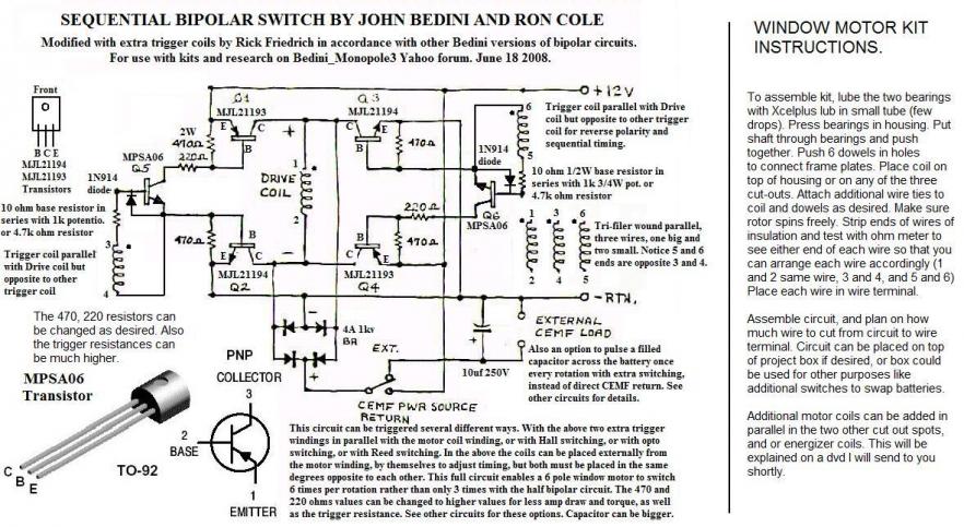

        Here is a couple pics - one is the Bedini - Cole circuit that I believe Peter is using to power the coils, the other is another zero force motor that John made. This is simpler, and would be a great starting point to experiment with.
Name:	zf motor.jpg

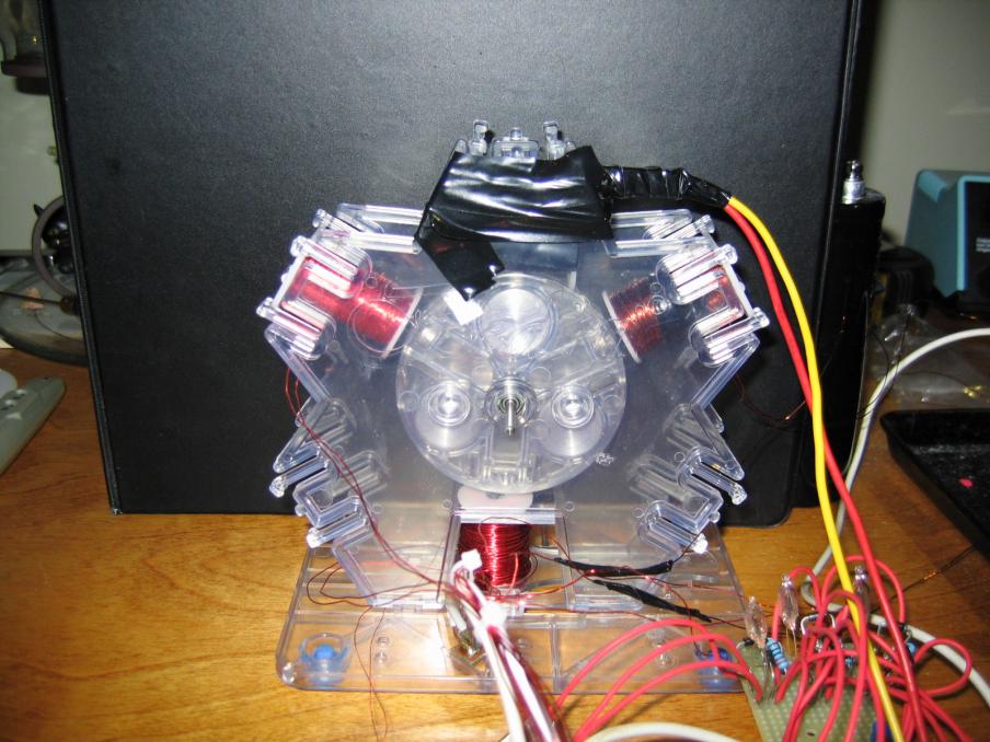

                      Here are a couple pics of the 3 pole setup I have - the darker pic with the super bright light shining through it is actually the timing light - the rotor is turning around 2800 rpm here - frozen quite nicely! You can see the zero force coil taped to the 3 pole @ the very top.
ID:	45257Click image for larger version

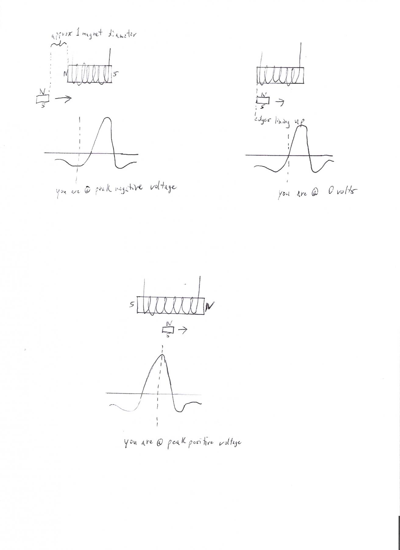

                      So for me, the highlight of this evening was strobing this setup, and trying to figure out what waveforms were happening at what rotor position. I believe that the drawing below is reasonably correct, however I am not entirely satisfied with this yet, and would like to find a more accurate timing method.
                      I find the whole sequence interesting, and worth contemplating. It appears that the negative voltage peak occurs when the rotor magnet is approximately 1 magnet diameter away from the beginning of the core. This totally fits with Paul Babcock's presentation, in that it shows there is a decent inductive coupling between rotor & stator at this point, yet not an overwhelming one. In my mind - terrible for power generation, but perfect for motor function. (Paul says this is where he pulses his motor coil.)
                      The zero voltage point appears to occur just as the complete magnet is now 'on the core', with the rear edge of the magnet in line with the edge of the core.
                      The positive peak appears as the magnet is around the center of the core, or in the center of the coil.
                      I did not draw the rest of the sequence - the magnet exiting the coil - since it is a mirror image of the entrance.
                      It appears that the rotor magnet is inductively coupled with the coil & core the entire distance, and looking at the coil induced magnetic field is quite interesting also. You'll notice in the drawing that I've marked the magnetic field of the coil, as it would be from the currents induced into it. It seems that the entire time the voltage is negative, the coil will produce a North pole on the left, and a South on the right.
                      As the voltage switches to the positive, now the South is on the left, and the North pole on the right. These two do seem to fit into Lenz's Law. Hopefully when the voltage is negative, and the rotor is not able to induce a high emf into the coil, the coil will still be able to create a strong motoring effect on the rotor as it's magnetic field expands and interacts with the rotor. The zero force motor vid certainly seems to show this as true.
                      Also, just to point out a couple differences between my experimenting and JLN's - It appears in his pictures that his magnet is larger than his coil. This probably has an effect on the coupling, including what he mentions of the orthogonal flux density dropping to zero, and there being no magnetic coupling between rotor & stator during the central positive pulse. May be worth looking into? In my setup - the coil is definitely very much larger than the magnet.
                      He also is running an air core, which I was not able to do in my experiments - I did not have enough voltage to properly conduct shorting tests & more.
                      At the same time, my waveforms look the same as his, and this makes me wonder if his coil was just too small to collect accurate results from. My setup was barely adequate, and ultimately probably needs a lot of revising to collect some real, hard data.
                      For your reference, in the 3 pole monopole, there are only 3 neo magnets. In both pictures, they are lining up with the coils. The large circles you see in between them are aluminum weights to give the rotor more of a flywheel effect.
                      Happy contemplation!

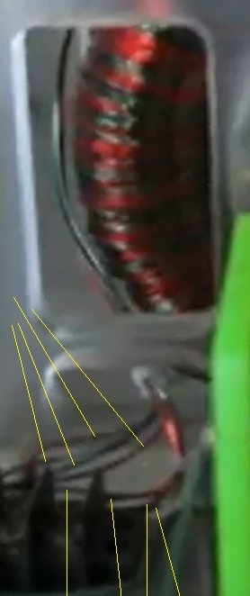

                        I took a small snapshot from the video to show: I can see 2 bunches of wires coming out from the stator coils on the left side to the terminal connections and also 2 bunches of wires on the right hand side, and I think each such wire-bunch consists of 4 wires (not number of turns as I indicated them with yellow lines. This may mean 8 wire endings on the left and 8 on the right so alltogether there may be 8 stator coils. Click image for larger version

                          I figured it to be 8 wire endings on the left, and 8 on the right also. Then taking into account that there seem to be 2 main coil sections (left side, right side), they probably each contain 8 strands, and are probably wired in series with each other. That's how I came up with the number of 16 coils.

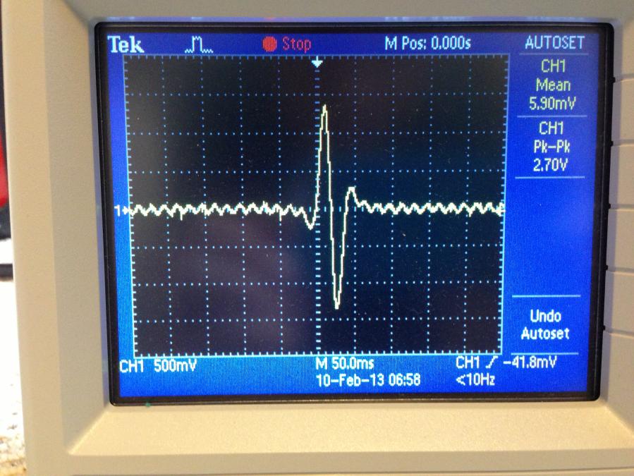

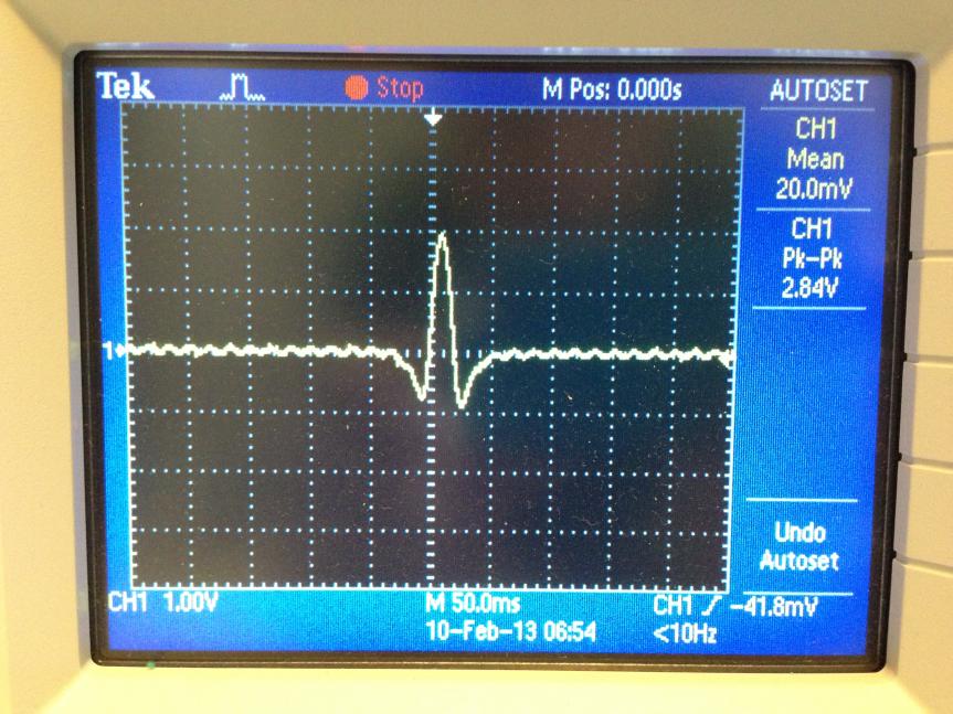

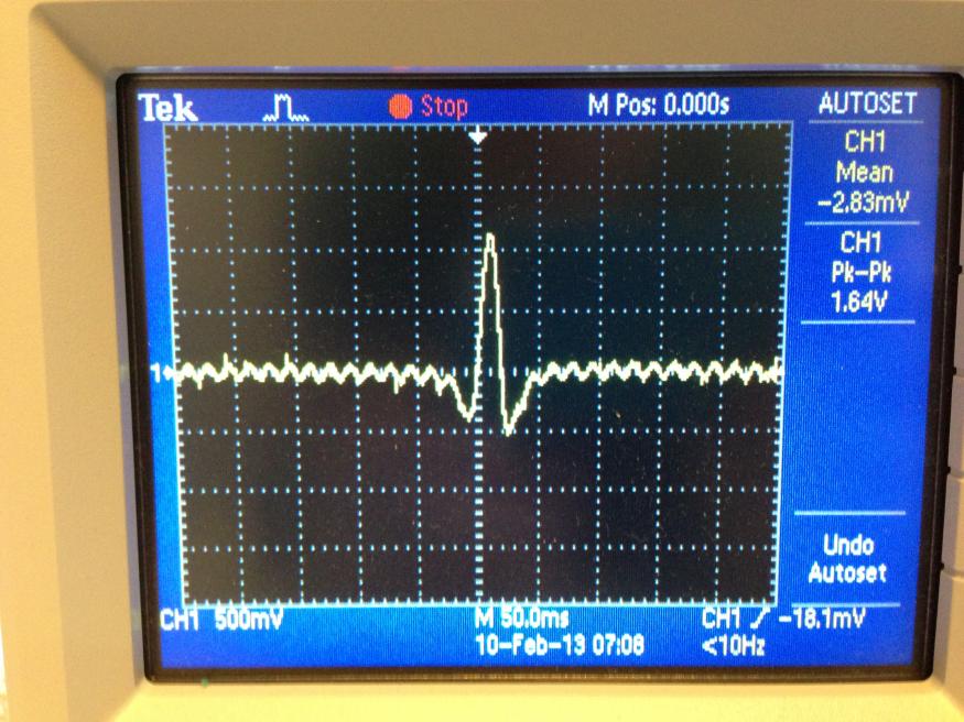

                            Just wanted to share some interesting scope shots that I made this last weekend, with the help of my friends Gestalt, & D.

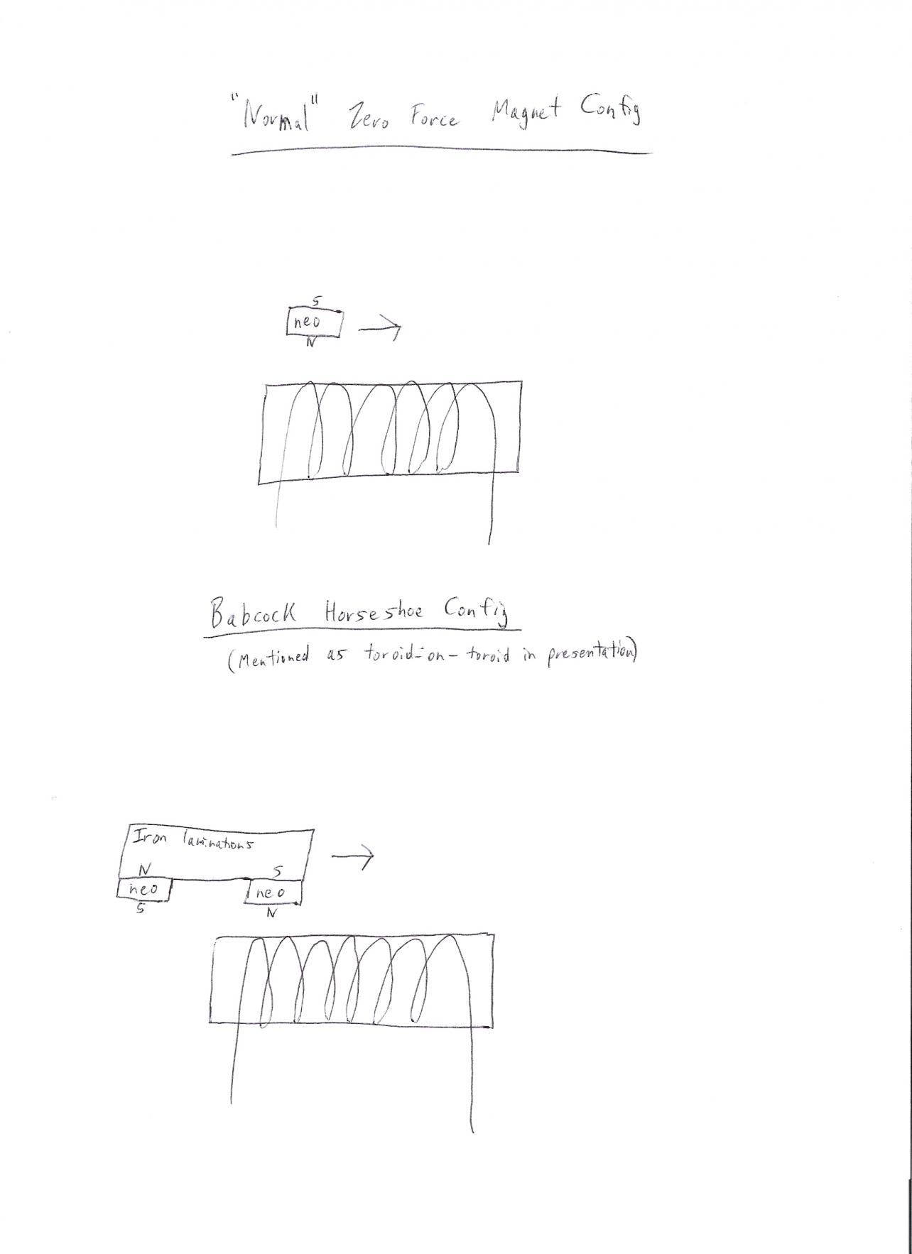

                            I was trying to find out why Paul Babcock uses a horseshoe magnet configuration in his low lenz motor, and the scope shots reveal more than I thought at first glance. Below is a couple pics of his horseshoe design, which I believe he calls something like a "toroid-on-toroid" configuration in the video. We only did a few tests, but I feel these are real numbers...
Name:	Magnet Config.jpg
                            So I sat down & analyzed these closely tonight, and found some results that were surprising to me. I had thought that there was little difference between the horseshoe config, and the single magnet, but the differences are great! These are the generated waveforms as different magnet configurations pass by on a pendulum.
Name:	Horseshoe Magnet Config.jpg
                            Numbers on Horseshoe Config:
                            - Neg initial, Pos final peaks (each) - 0.3 volts
                            - Main central peaks (each) - 1.4 volts
                            - avg time for initial neg, pos final peaks (each) - 22.5 ms
                            - total wave time - 78 ms
                            - initial voltage/central peak voltage - 21.4%
                            - initial peak/main peaks (time scale) - 28.8%
Name:	Large magnet regular config.jpg
                            Numbers on the large single magnet:
                            - avg neg peaks (each) - 0.86 volt
                            - central pos peak - 2.0 volt
                            - avg time for neg peaks (each) - 32 ms
                            - total wave time - 85 ms
                            - neg voltage/main peak voltage - 43%
                            - neg peak/main peak (time scale) - 37.6%
Name:	2 Small Magnet regular config.jpg
                            Numbers on the small magnet config:
                            - avg neg peaks (each) - 0.45 volts
                            - central pos peak - 1.15 volts
                            - avg time for neg peaks (each) - 30 ms
                            - total wave time - 100 ms
                            - neg voltage/main peak voltage - 39.1%
                            - neg peak/main peak (time scale) - 30%
                            Most fascinating!!! The Babcock config reveals some tricks of the horseshoe magnet configuration - that it is probably the way to go, and goes even further towards reducing Lenz effect. This is seen in time and voltage - the % time spent generating voltage while in the firing area (initial & final pulse) is reduced - 28.8% per pulse compared to 30 to 37.6%. You could possibly spend the same amount of time firing the electromagnet as you would with a single magnet, and gain a little more torque out of it. This thought is because even though the rotor magnet field doesn't appear to extend as far out towards the electromagnet, when the electromagnet field expands, it may still interact well with the rotor magnet.
                            Also the voltage difference is significant - 21.4% compared to 39.1 to 43% - this may be where the real magic is - in reducing the Lenz effect. That is a huge percentage difference!!! I'm using percentages so as to hopefully create a fair comparison between different configurations - the pendulum may have swung a little faster here & there, the magnet in one test was significantly stronger, etc... A note on this - percentages may be a poor comparison because voltage increases as time (period) decreases, and with the horseshoe config - you can see there is a greater flux change in the central area, as there is also a polarity change. (more flux change packed into the same time) This may be boosting the central peaks, which makes the percentage look better. The last scope shot (small magnet config) is using 2 out of the 4 same magnets that the horseshoe config was using, so we should be able to compare those numbers directly at least.
                            In comparing those numbers, we still see that the voltage generated with the single magnet is greater in the firing area. Note also by the time of passage that the single magnet appears to be travelling slower in this particular scope shot, since the period is longer. So I believe we are still ahead using the horseshoe config, even if the percentages may be skewed.
                            The downside to the horseshoe config is that you need to fire the electromagnet both ways to get the most power out, whereas with the single magnet, you can fire the same way to draw the rotor magnet in as you do to repel it out. (seen by analyzing the initial and final voltages generated.)
                            Interesting to note the Mini Romag page again - the magnet configuration is very similar to Paul's configuration. Hmmm...
                            I'm thinking the benefits are there because the magnetic field is folded inward more as compared to a single magnet - thoughts?
                            Daniel

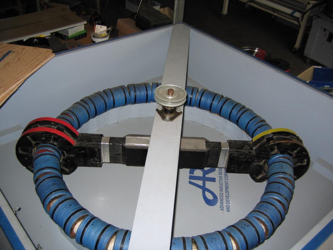

                              Hi Daniel,
                              Very good tests you have been doing. One thing I wish to mention is you say it is a horse magnet configuration Babcock uses and indeed this is shown also as illustration in his patent application (US20110156522) but you can see circularly positioned magnets fixed in the perimeter of a ring in the figures too. BUT those circularly fixed row of magnets face the coil/core uniformly with only one pole while in a horseshoe setup (as shown in your excellent quality photo) the magnets (albeit they are covered, the form of the yokes making up for a horseshoe shape can be figured out) actually have two poles at the yokes' ends so what you wrote about the firing differences is valid.
                              Now that circularly positioned row of magnets with one pole may be another possibility (besides the horseshoe shape), you could fire the coil the same way like I mentioned earlier for the single orthogonally positioned magnet: attract in on approach, switch off for the center passing time (maybe utilize the induced 'positive hunch' in the center) and then (towards the other end) switch on again with the same polarity to repel the magnets out.
                              Wrapping up the rotor magnets in a circular fashion may seem to be the best arrangement to utilize the most of the flux of a solenoid coil, which appears in the near space everywhere around the coil, to have the biggest torque from the input. "Normal" pulse motors utilize coil flux from either one end of the core or better designs use both ends, and there is the orthogonally positioned coil like in the Mini-Romag but the coils (made of copper wire) facing to the outside cannot 'see' the inner magnets' flux (albeit the steel wire coils are wound directly onto the magnets). A horseshoe magnet uses two sides and some more of a coil flux but they have the Bloch wall in the center part with small interacting flux, still not the most possible flux utilization.
                              When you have time, have a look at this thread here http://www.energyscienceforum.com/al...generator.html and also the videos referred to. Albeit those setups are intended for generators, the mechanical arrangement is the same as the motor with circularly fixed magnets, the coils are just not pulsed but loaded.
                              Thanks for showing your scope shots and the excellent quality picture on the Babcock prototype, (where did you get it I wonder).
                              Greetings, Gyula
