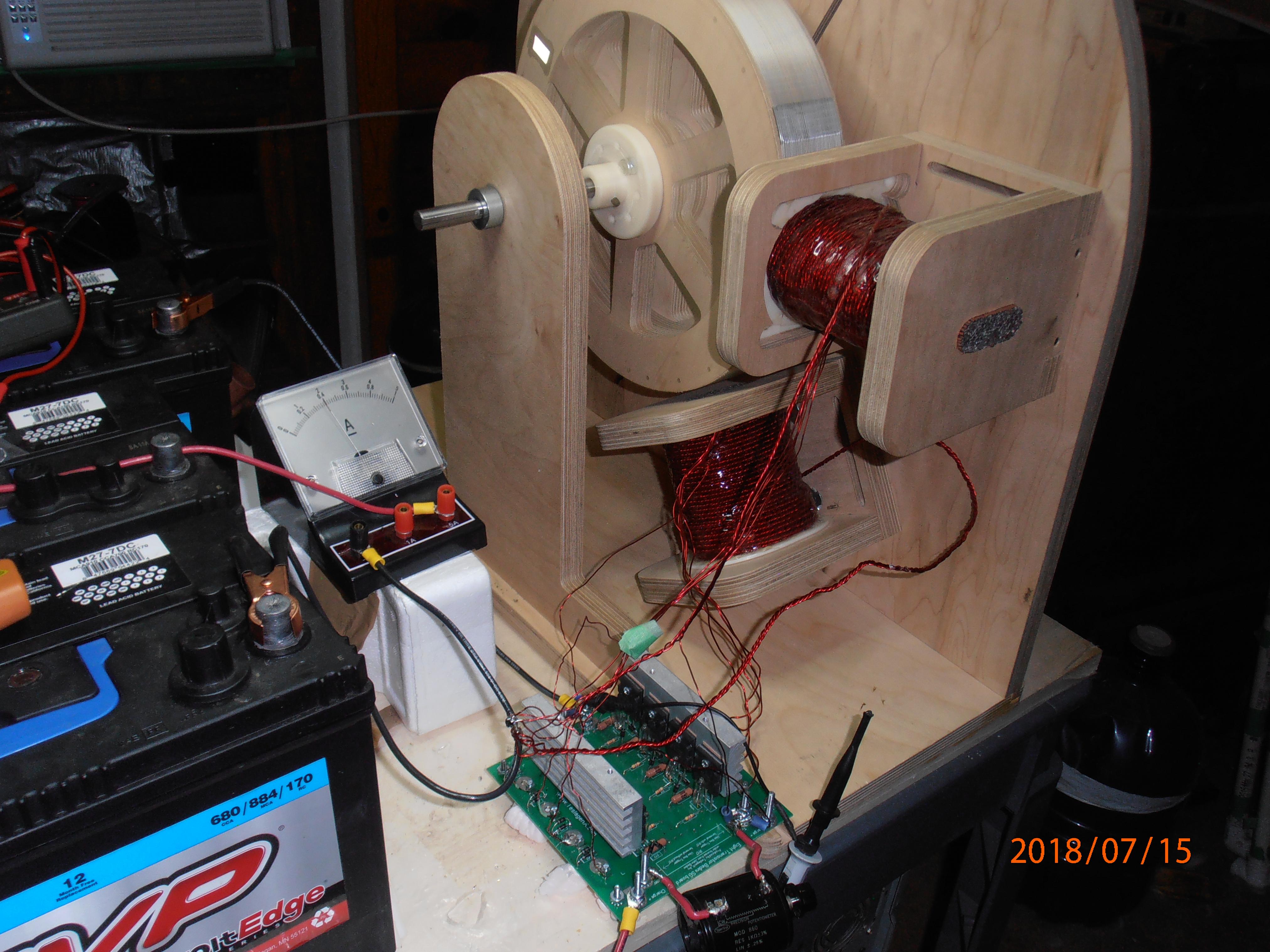

              • Enjoyed reading about charge/discharge and will keep in mind. Added second coil and started second run after discharging the charge battery to around 12.3v. After adjusting the coil-to-rotor distance for second coil like the first coil, system happily runs at 910 rpm's at 1.5 amps. I adjusted the 1K pot for input draw of 2 amps to help get more Radiant energy for charging. I noticed a charging difference depending on setting of pot and can see it on the o'scope because the Spike gets smaller as you tune for max speed meaning higher resistance. My little digital o'scope with 1GS/s shows the amplitude of the Spike just like the analog HP 275Mhz o'scope I just received, so I can depend on my little digital o'scope to get an idea of what is going on.
                I connected the second coil like the first coil as a drive coil with the fifth wire as a trigger. I had to try this since I know RS mentioned other variations so I have to see what happens for my notebook and I still do not know what "back popping" the primary is and need to see a schematic to show how and why? Unless it refers to something in SG3 book which I have not gone back to yet to check need more time.
                Being curious, I posted early on about the 1N4000 thru 1N4007 family of diodes are the same thing except for their voltages and curious about the 1N5408 diode and see that it is the equivalent to the 1N4007 except for one major parameter, Peak Forward Surge Current is 200A where as the 1N4000 line of diodes is only 30A, no matter which voltage diode is used!!! I have in the past played with 1N914 and 1N4148 diodes for the base diode and noticed no difference as an experiment with my bike wheel version back in 2013 because it worked!!
                The bike wheel just kept going as it is now, but different wheels are being used to continue on with project. Hope pic works this time...Click image for larger version

                  Hi rdvideo,
                  Admire your hard work!! great job man!! just few pointers... always remember the Machine is a High-Frequency operated so every wire length is an Inductance and every alignment/orientation is Capacitive so be watchful on how close you make it look similar to PL & JB machine. the copper tubing used for the junction for all the strands of each coil is vital, so why not have it there?
