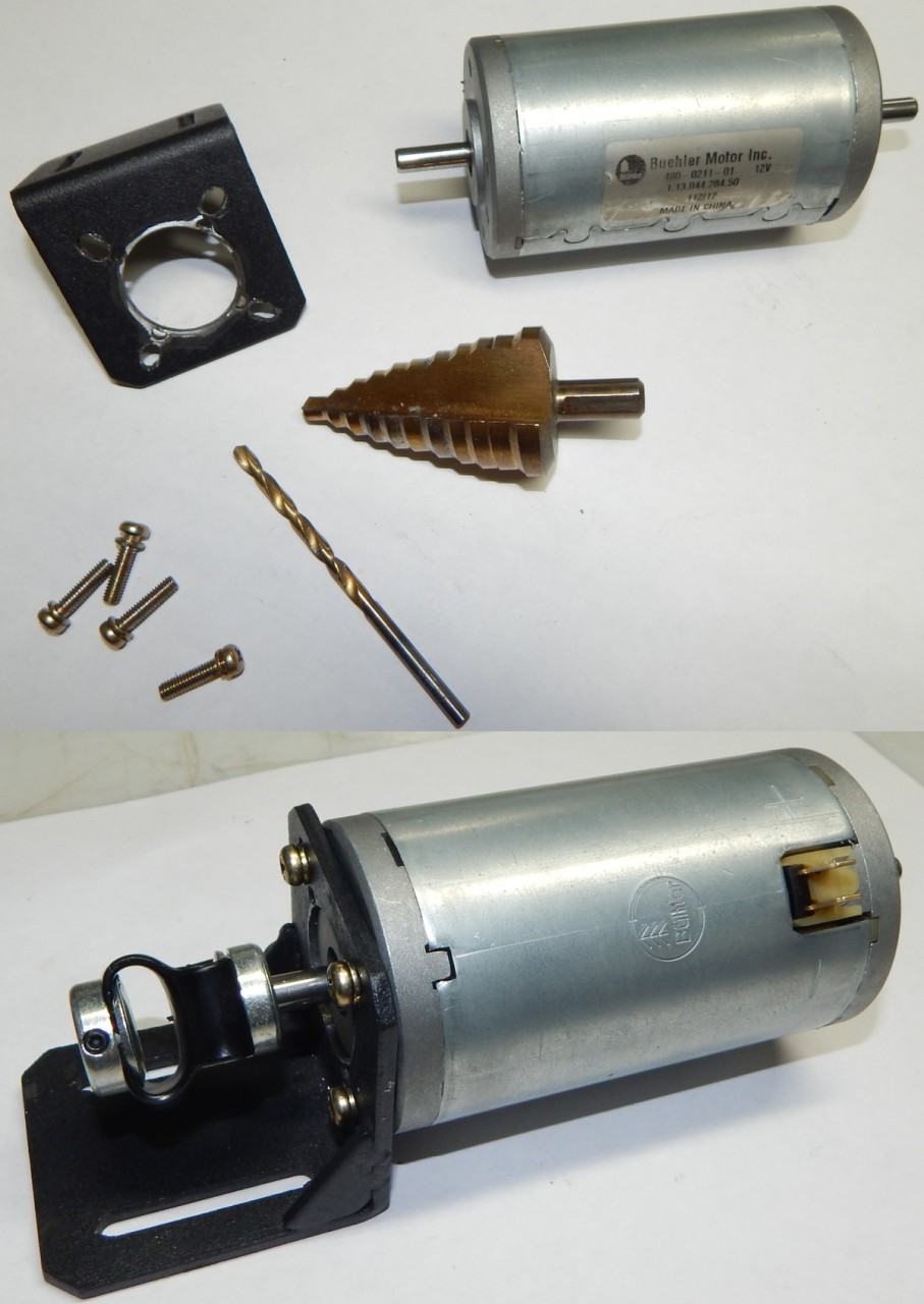

                        Build Progress photo
                        Hello all.
                        Just a minor update and build photo.
                        Started with a Nema 17 bracket which is not quite the right size for this Buehler # 1.13.044.284.50 50 watt motor.
                        Used a step drill to enlarge my center hole then a #20 twist drill to cut new mounting holes.
                        Still not sure if this is the best thread to share an actual build as these previous questions still remain unanswered...
                        -What is the wire gauge John used for the rotor coils?
                        -What is the approximate number of turns he used per coil?
                        -Are his rotor and pole pieces solid or laminate layers?
                        -Are ceramic (ferrite) magnets suitable?
                        -Is this the correct thread to start detailing a replication attempt based on the recent disclosure or is there another thread of other builders actually building these on this forum?
                        Please respond.
                        Kindest regards;
                        • #42
                          Scorch
                          1- 23 gauge will work.
                          2 its not about turns, 3 strands in parallel to make a 3.1 ohm resistance circuit.
                          3 - solid cores not laminate. use ductile iron, non ferrous axle, brass is preffered
                          4- BaFE magnets are needed not ceramic or neo magnets
                          5- a slip ring assembly and brushes from an alternator will work to get the power out of the rotor.
                          .002 gap rotor to pole pieces. rotor gap radiused to match the pole piece.
                          you really need the kromrey DVD
                          • #43
                            Hey Tom.
                            Fourth try is a charm? I am not sure but I think there is a web form bug because it appears this site has crashed several times after I tried to reply and I have to keep 'tweaking' things to get this to work...
                            And this is not first time this has happened and also Aaron hasn't replied to the last three messages over the last few weeks and don't know why. . .
                            At any rate; thank you for the pointers.
                            I think I do have some 23 gauge on hand.
                            Do I understand correctly that John actually wound three lengths in parallel for each coil?
                            One thing I observed is that it appears his coils are somewhat cone shaped and I believe there may be a specific reason for winding less wire close to the magnet.
                            This design reminds me of the original Muller Motor coils.
                            I do have the Kromrey DVD (along with many others from the series) but it's been a few years since I viewed it so I do need to review that.
                            Not sure about Barium Ferrite magnets.
                            As near as I can tell; this actually is the same thing as the common ceramic magnets as described here-
                            And the photo of John's original converter looks like he used the same 1.875" x 0.875" x 0.375" ceramic-ferrite magnets commonly used in many SSG projects.
                            Am I missing something here?
                            Aren't ceramic ferrite magnets the same as BaFE magnets?
                            And if not, can you provide a reference or source?
                            I do have brass shaft and a few different types of slip rings.
                            I also just acquired a very nice 3", 3lb brass disk and hope my drill press and skills are good enough to make a decent flywheel somewhere close to being true and balanced...
                            Thank you for your assistance.
                            Kindest regards;
                            Scorch
