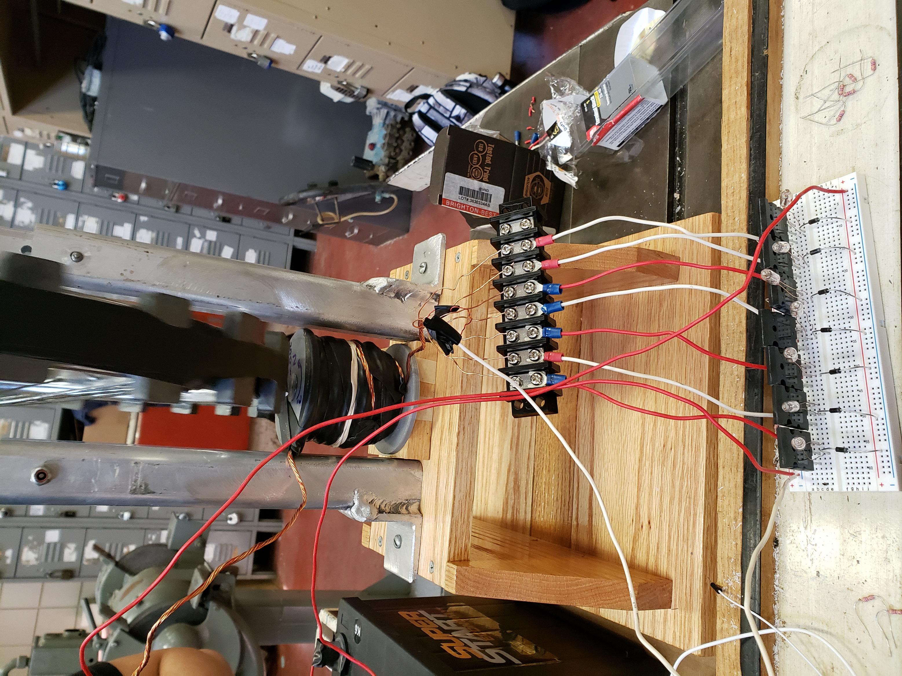

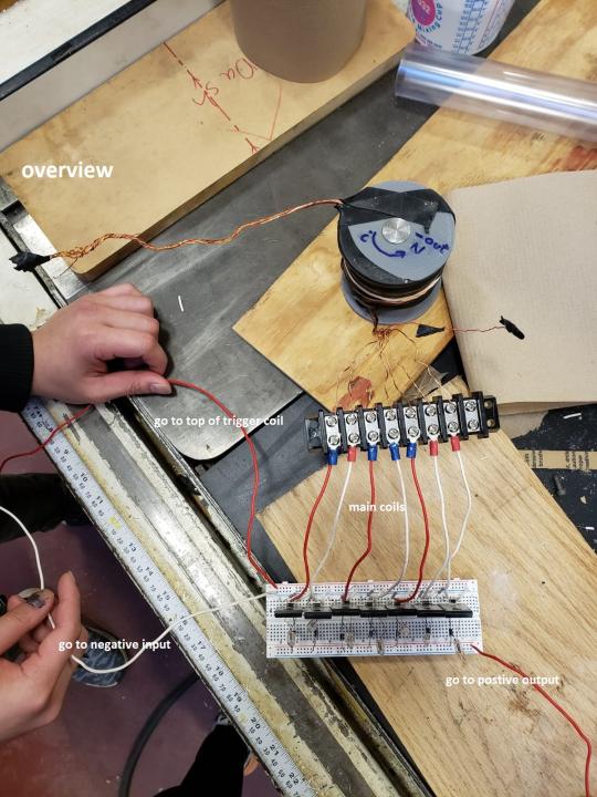

                Attached are the figures of our circuitry. We hooked it up to the solenoid and power and charged battery but nothing seems to be working. Do you have any ideas on what might be wrong and what can we do to trouble shoot.
                Could it be due to the fact that we have yet to discharge the battery to about 10.5V?
                  Thank you so much, we will continue discharging it and wait for it to go down.

                      Hi,
                      I hooked everything up the way as the circuit shown in the Bedini beginner guide, I spun the wheel but the wheel did not rotate continuously and eventually stopped, is there a way to check if the circuit is functioning properly and troubleshoot it? I tried reducing the resistance from 470 ohm to 120 ohm but it still did not work. We did the circuit with the 7 resistors, transistors and 14 diodes.

                          Can you show some good quality close up pics of the circuit?
                            Okay, I will get a better and clearer picture tomorrow. At the meantime is there anything basic I can do to troubleshoot? For the power battery, can I use a 12 V 5Ah sealed lead acid battery? If everything is hooked correctly, could it be the circuit components that are faulty?

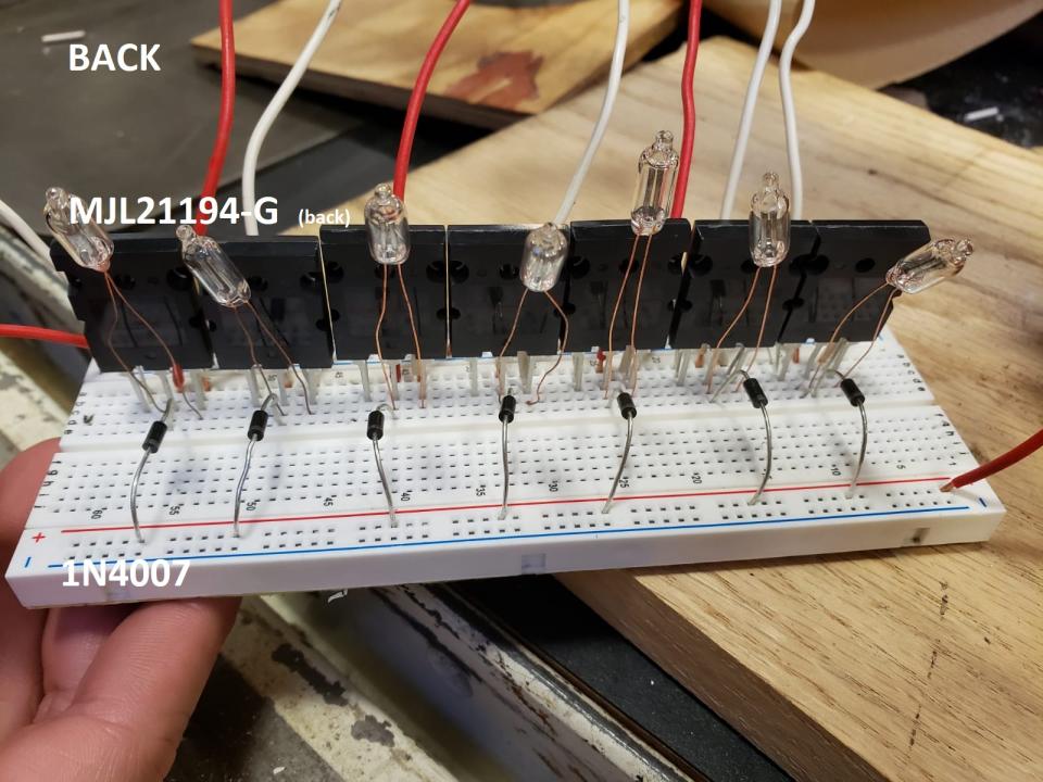

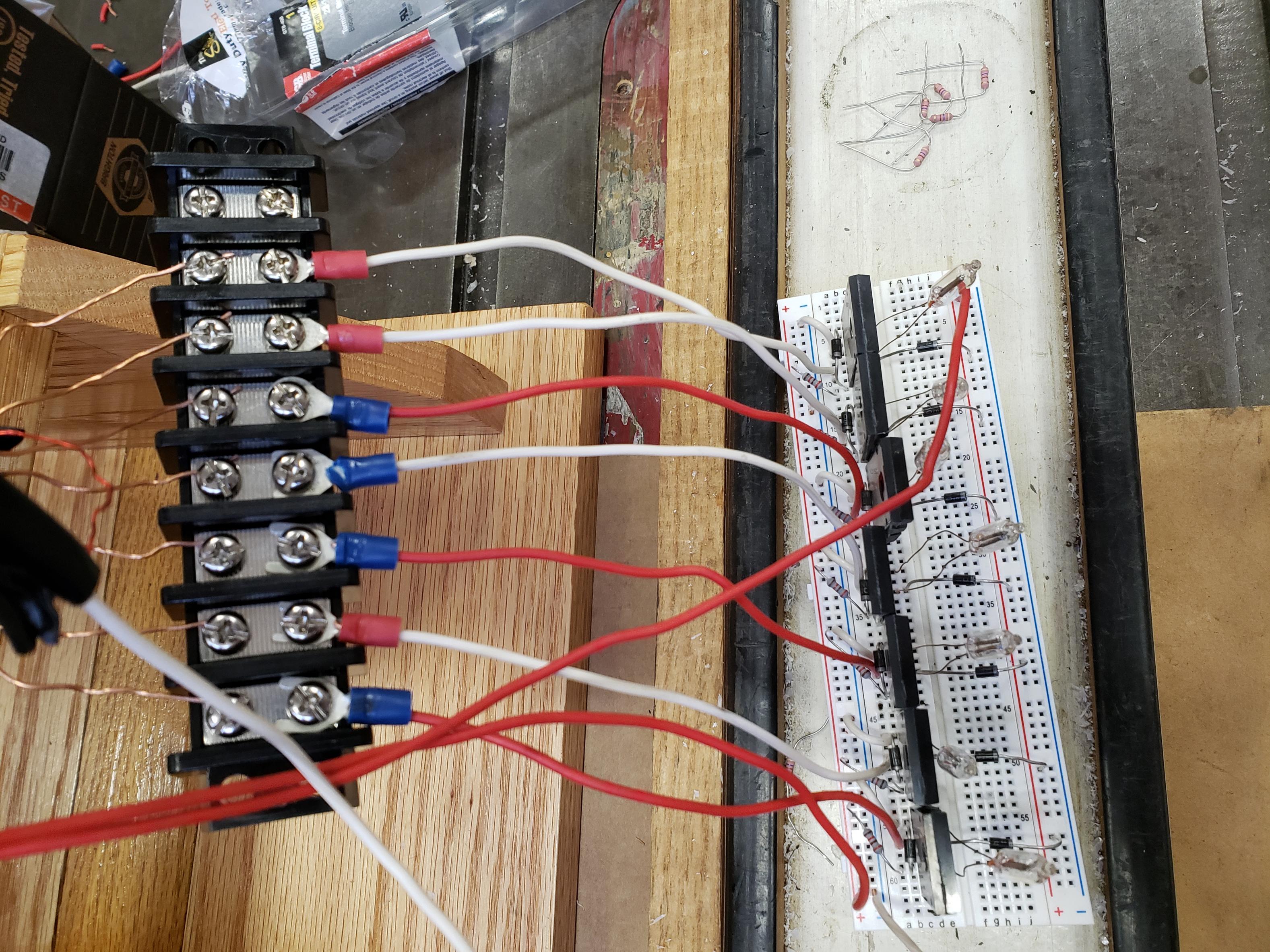

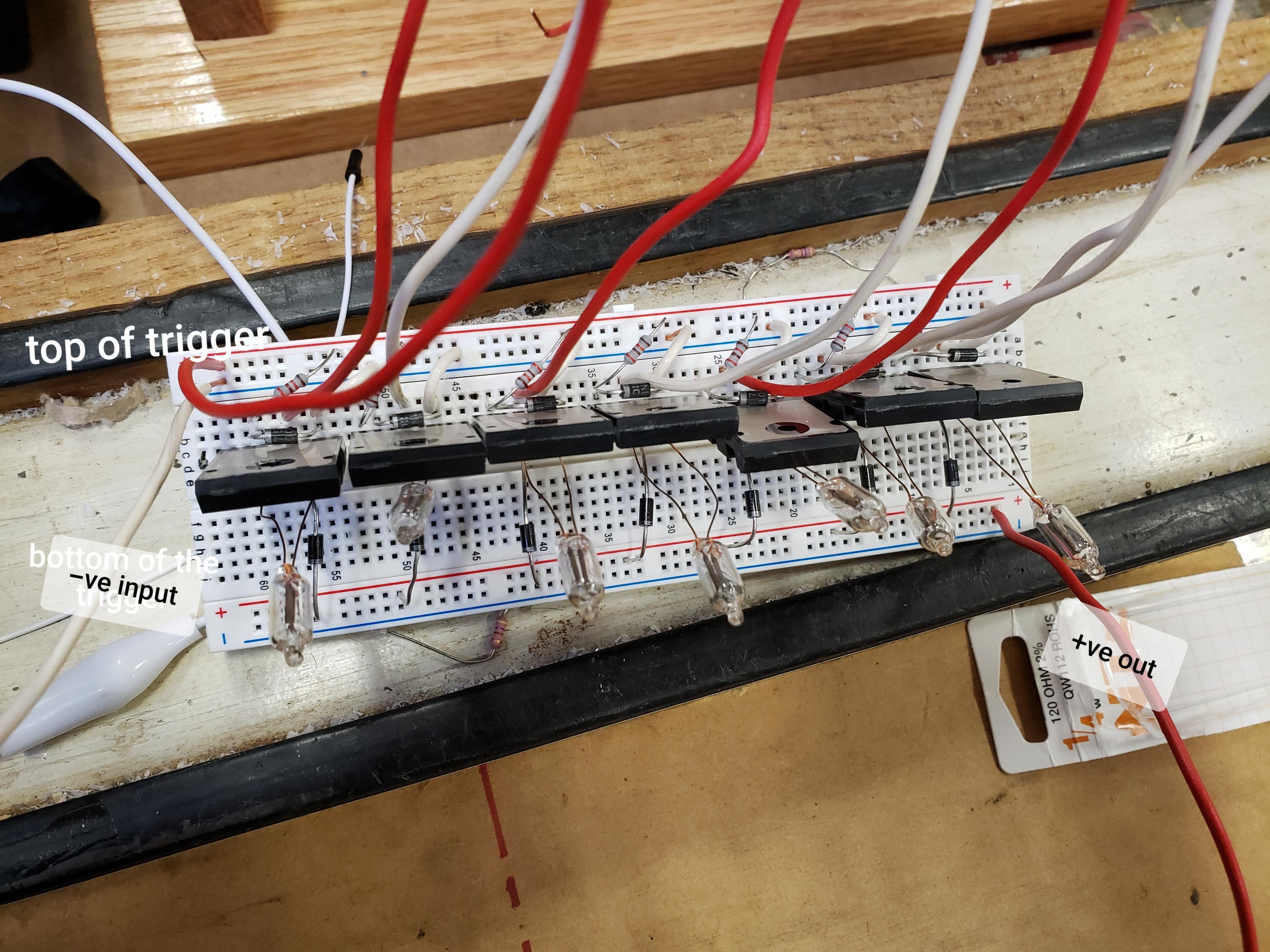

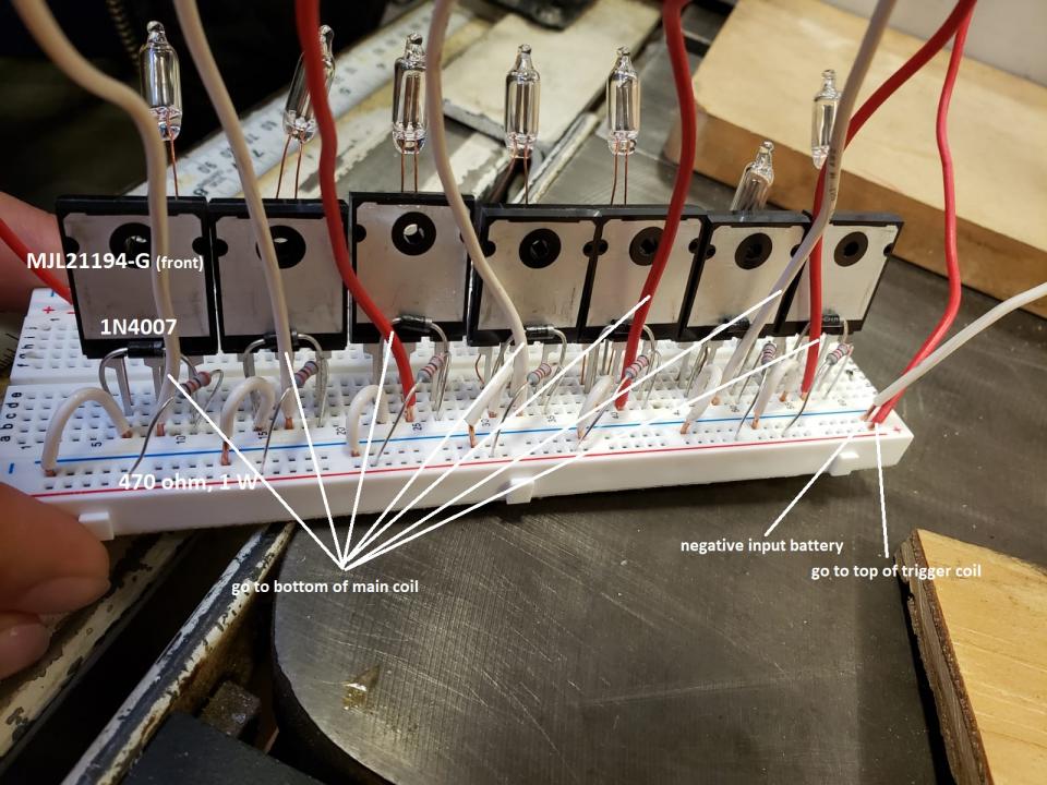

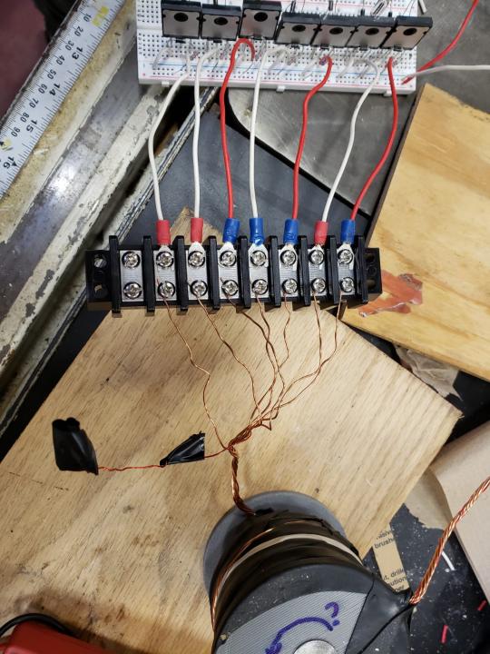

                              Hi, Here I have better pictures and labels, they're not connected to the batteries as it will be harder to take a picture. I think everything should be wired up correctly, but it still doesn't work. The wheel does not spin continuously. The battery I used is 12V 5Ah, does the Ah rating matter? To my understanding Ah just means that in an hour the battery can supply 5A of current.
