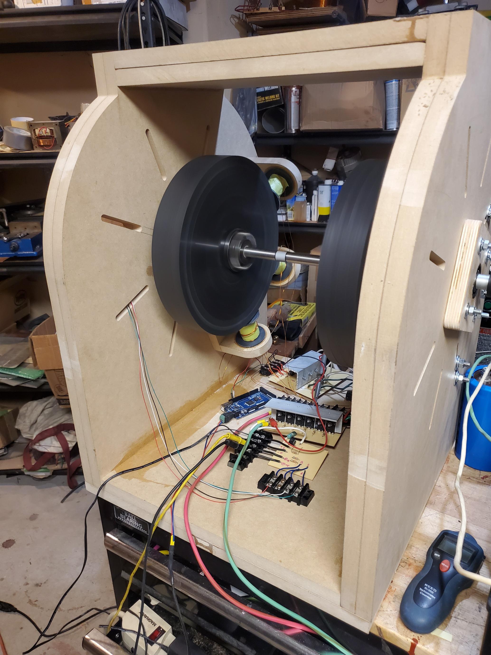

ID:	74201 Hi All,
      With 6 coils she passed the smoke test.
      Every thing worked as desired or better.
      No bank switching yet. Will do after I can run it with 16 coils and 48 volts.
      I ran it at 12v, 3A and she did 1600rpm. Very smooth.
      The charging cct worked and I was pulsing the chr batt with 38v pulses.
      I put the opto sw at dead center of the firing position and guessed the right direction.
      NO HEAT! That was a big concern. Every thing stayed room temp. might change with higher V.

          Hi All,
          I turned it off and timed the free wheeling - 14min, 4sec.
          I reduced the on time by 50% and it ran at 880rpm instead of 1600. Lower Amp draw.
          I can control the temp of the coils at higher voltages with this method.
          The rotors are pushing some cooling air.

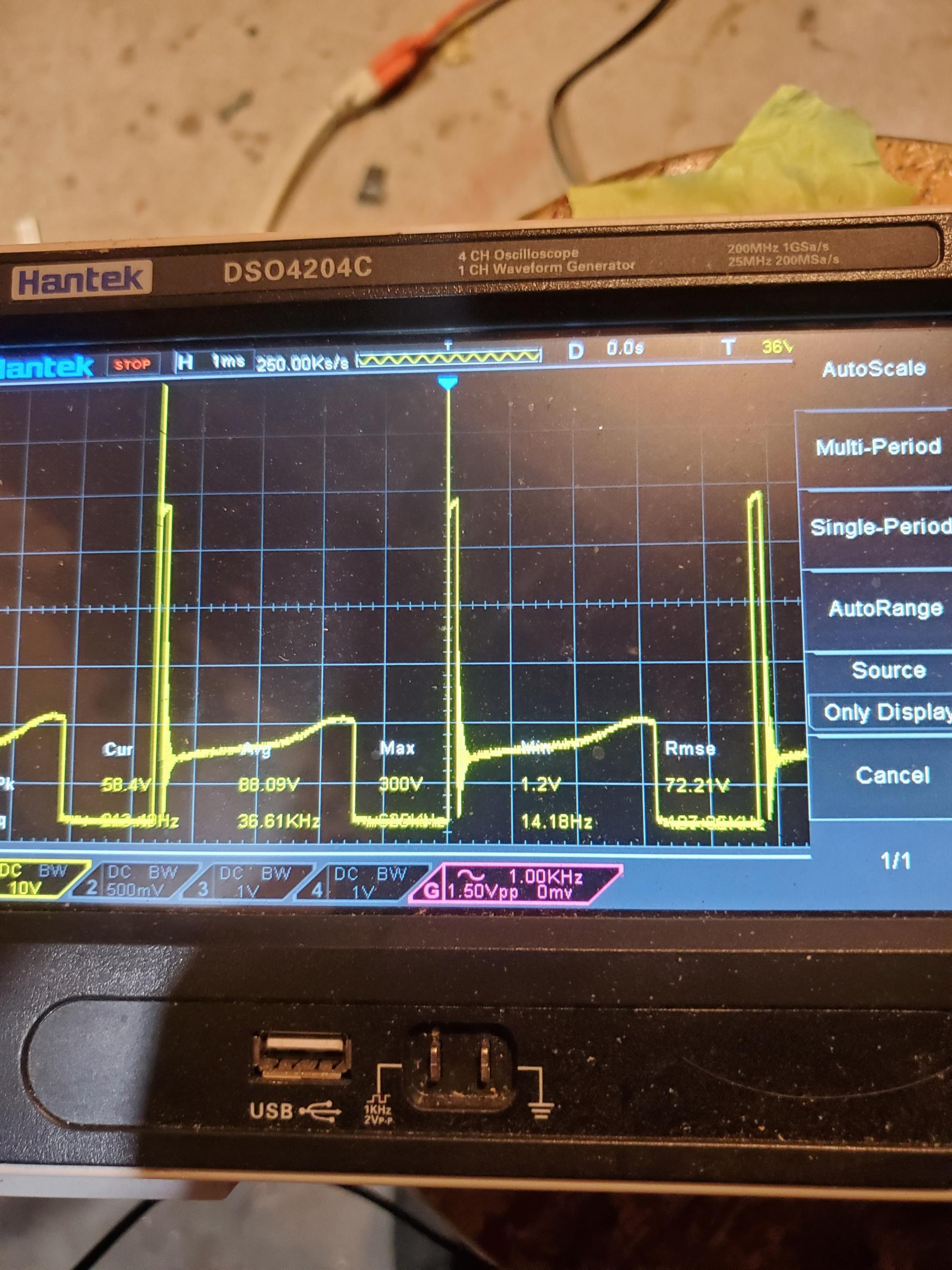

          3.6Amp 12v - 1600rpm
          The spikes at both speeds are over 200v.
          Next I have to run 8 coils with sic fets and sic diodes.
          Then 2 groups of 8 fets and a 250w generator.
          Also 2 bank battery swapping.
          Still plenty to do.

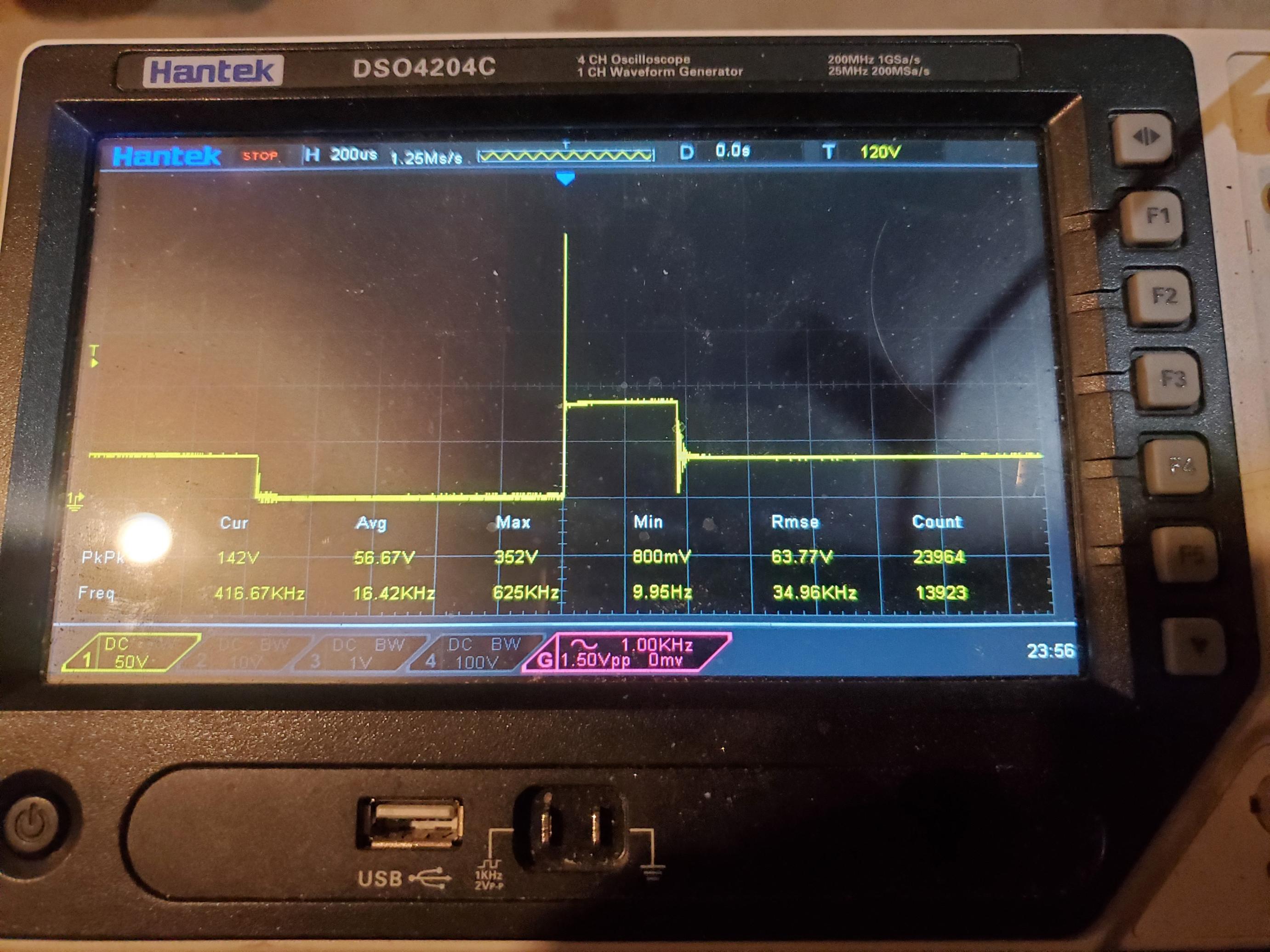

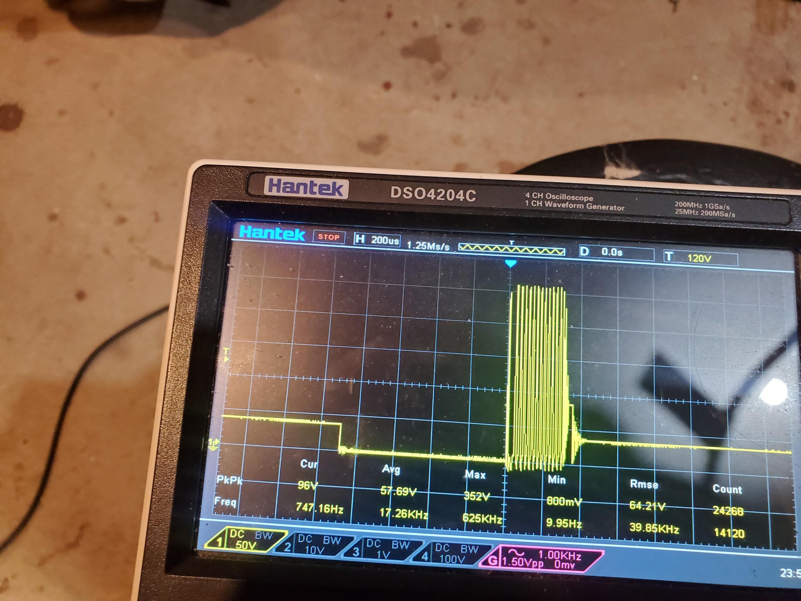

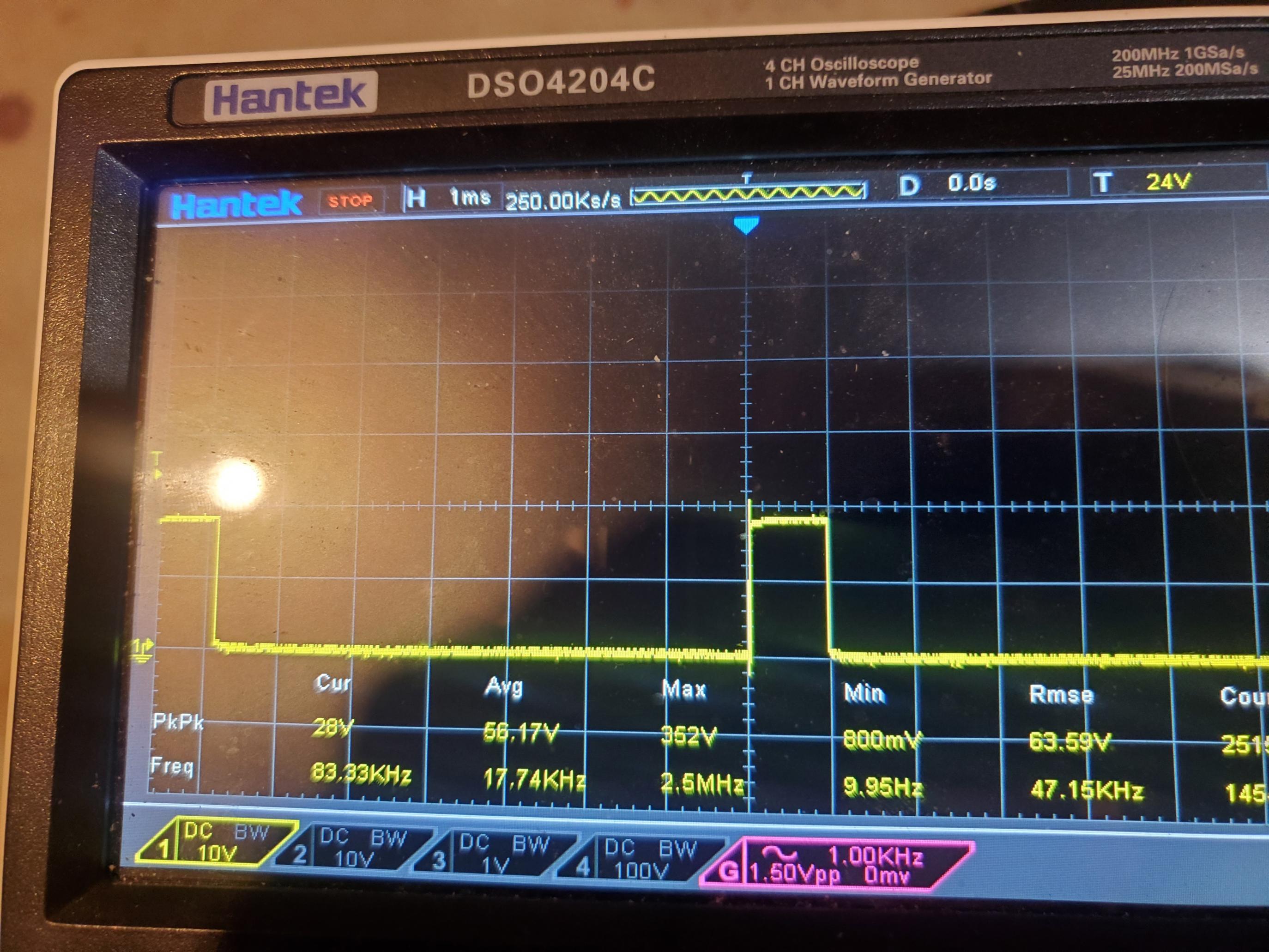

                Any one an expert with sic fets.
                I have a 2 fet setup working but have questions.
                I was using 6 si fets in parallel and switching with the driver with and opto device. 6v into the opto and 12 into the driver.
                With 2 sic fets in parallel I'm with same opto I'm driving with 18v (15required( and 21.3v into opto switch.

                The pic with interference is intermittent.
                The 2nd is a shot of the pulse at the driver.
                3rd is clean shot of coil firing.
