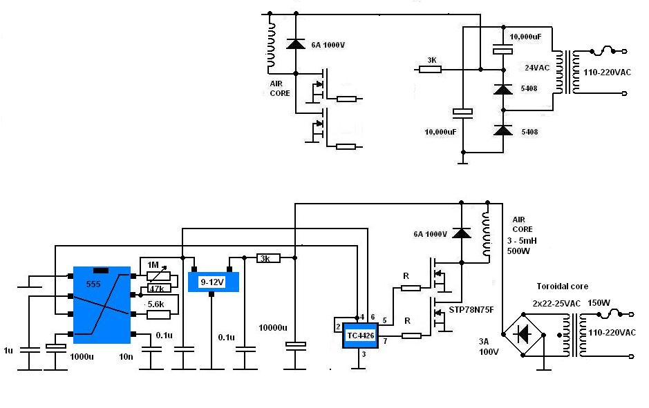

When I was browsing Magnetic Therapy and devices I found abundance of projects, research and applications. There are companies such as Canadian SOTA and European - German, Russian who build and sell them. Except SOTA, which sells devices for personal use many others are available mainly to the clinics or practitioners. Couple thousand dollars isn't the price tag affordable to the average person. I guess, I'm way below an average since I couldn't afford even SOTA products which lead me to more research and development of this abandoned/neglected technology for benefit of people like myself.
I liked Bratton idea of stepping up input by means of voltage doubler since I was looking for ways to keep high voltage out of this design. 60-70V being separated from mains fits the bill. I decided to use gate driver for Mosfets instead of transistor buffer and I'm able to pulse up to 5Hz without heatsinks. My current Mosftets are IRF640 but they'll be replaced with a pair of STP78N75. They can handle 70V and continuous current of 80A. I'm running on 30V PSU at the moment and have only one 10,000uF capacitor hooked up. I also have only 1mH 18ga coil connected but it is capable of lifting weight of double large ceramic magnet off its face. I need to wind another coil or two and compare results but from what I see right now it suppose to work well.

Mosfets can be substituted with stronger STP120. First number is its A rating and the second is max V. I'll use perfect layer air coil 3.0mH - 5.0mH. I need to experiment further.
