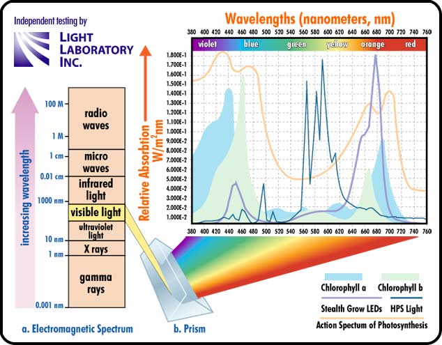

We know based on Photosynthesis (Chlorophyll A & B) that the plants utilize primarily 439nm, 469nm, 642nm, and 667nm, (4-bands) while most other wavelengths are use a little. Aside from these colors we know that humans must see their plants to monitor their health, which requires the use of white or green light (1-band) in small quantities will work, as these reflect off the plant. Lastly a light should contain 740nm far-red (1-band), which triggers flowering within the plant during a 12/12 light cycle. 740nm also stimulates the Emerson Enhancement effect, which increases photosynthesis rates up to 30%! UV light in the region of 285-315nm also has a benefit for resin-producing plants such as poison ivy or cannabis.
The visible colors of light from shortest to longest wavelength are: violet, blue, green, yellow, orange, and red. Ultraviolet radiation has a shorter wavelength than the visible violet light. Infrared radiation has a longer wavelength than visible red light. White light is a mixture of the colors of the visible spectrum. Here is a summary of wavelengths (nm).

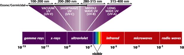

200 – 280 nm UVC ultraviolet range which is generally harmful to plants. LEDs in this spectrum are non-existant or very expensive. You can see on the bar graph below that it borders with X-ray wavelength.
280 – 315 nm Includes harmful UVB ultraviolet light which causes plants colors to fade. This is the part of spectrum reaching Earth around noon.
315 – 380 nm Range of UVA ultraviolet light which is neither harmful nor beneficial to most plants.
380 – 400 nm Start of visible light spectrum. Process of chlorophyll absorption begins. UV protected plastics ideally block out any light below this range.
400 – 520 nm This range includes violet, blue, and green bands. Peak absorption by chlorophyll occurs, and a strong influence on photosynthesis. (promotes vegetative growth)
520 – 610 nm This range includes the green, yellow, and orange bands and has less absorption by pigments.
610 – 720 nm This is the red band. Large amount of absorption by chlorophyll occurs, and most significant influence on photosynthesis. (promotes flowering and budding) The ratio of red (660nm) to far red (730nm) in sunlight is about 1.2:1
