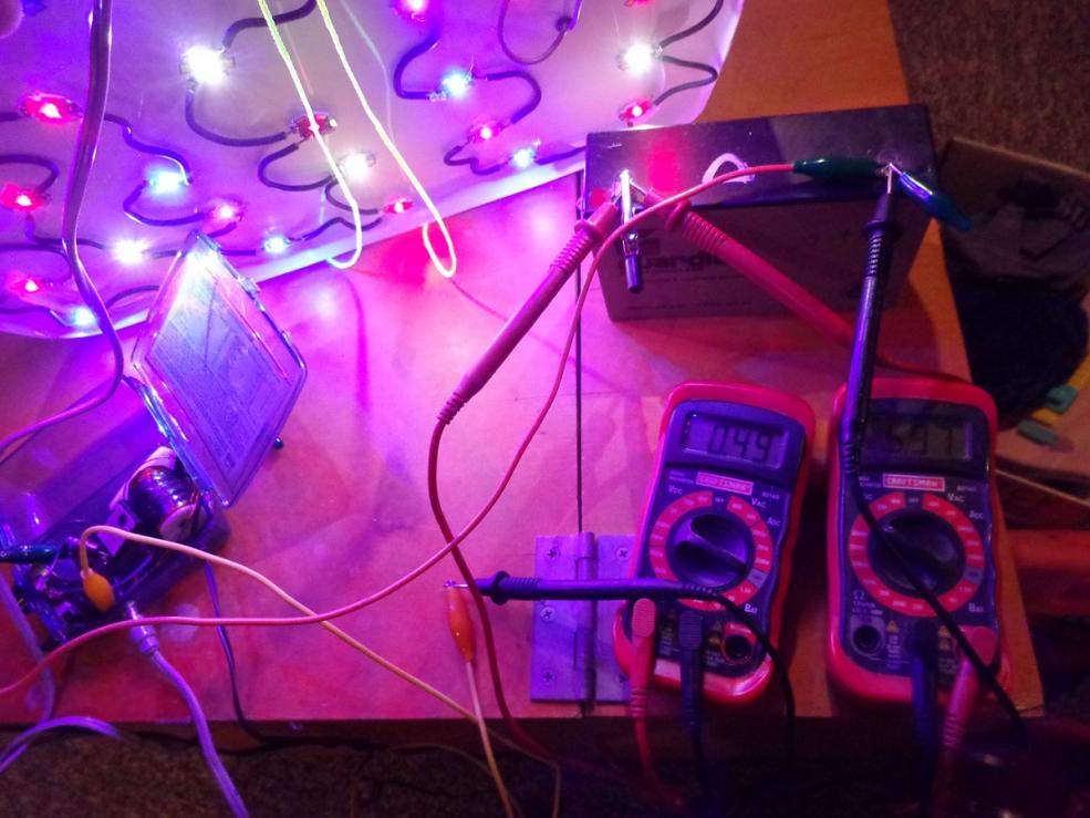

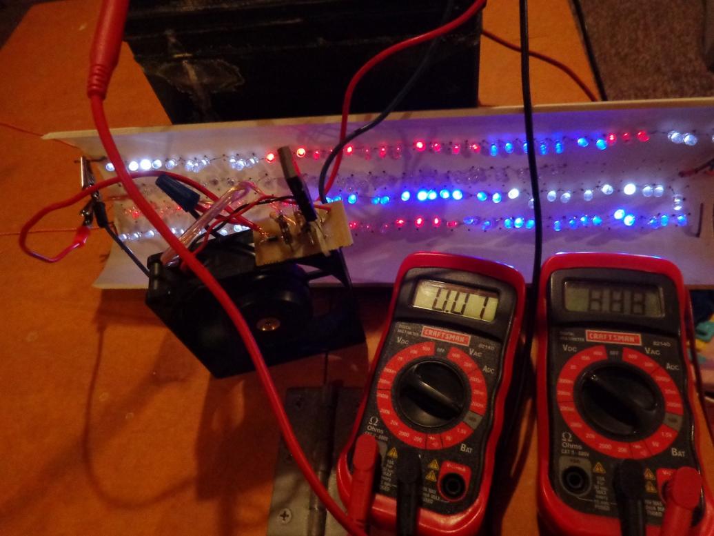

        Here is the draw on the white lid panel
Name:	white panel draw.jpg
        a lot less than if hooked up on parallel, then you would need heat sinks too.

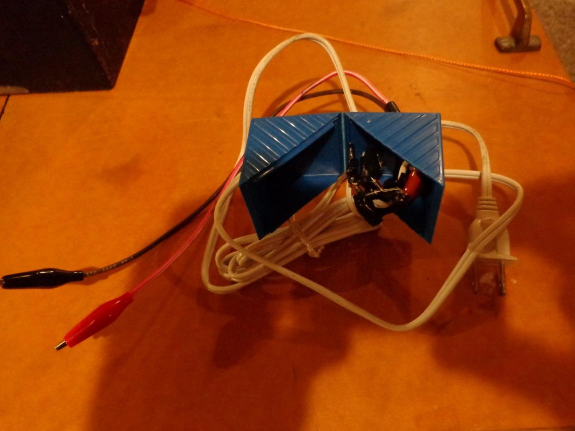

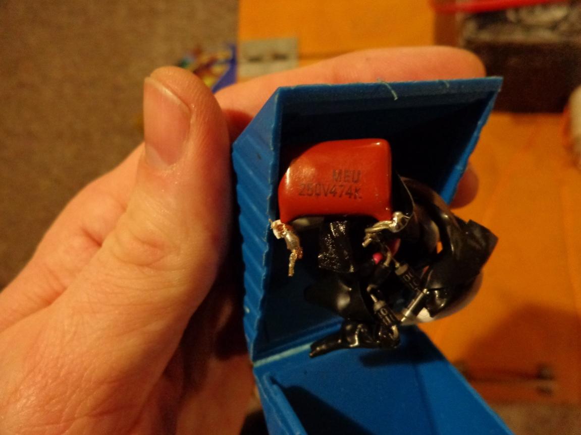

        Here is a mini driver with the ac cap fwbr method
Name:	mini driver.jpg
Name:	mini driver up close.jpg
        That Cap is a little small, but will light the panels dimly.

        For both pictures with meters Amp draw is on left voltage on the right meter. Set at 10 amps.
