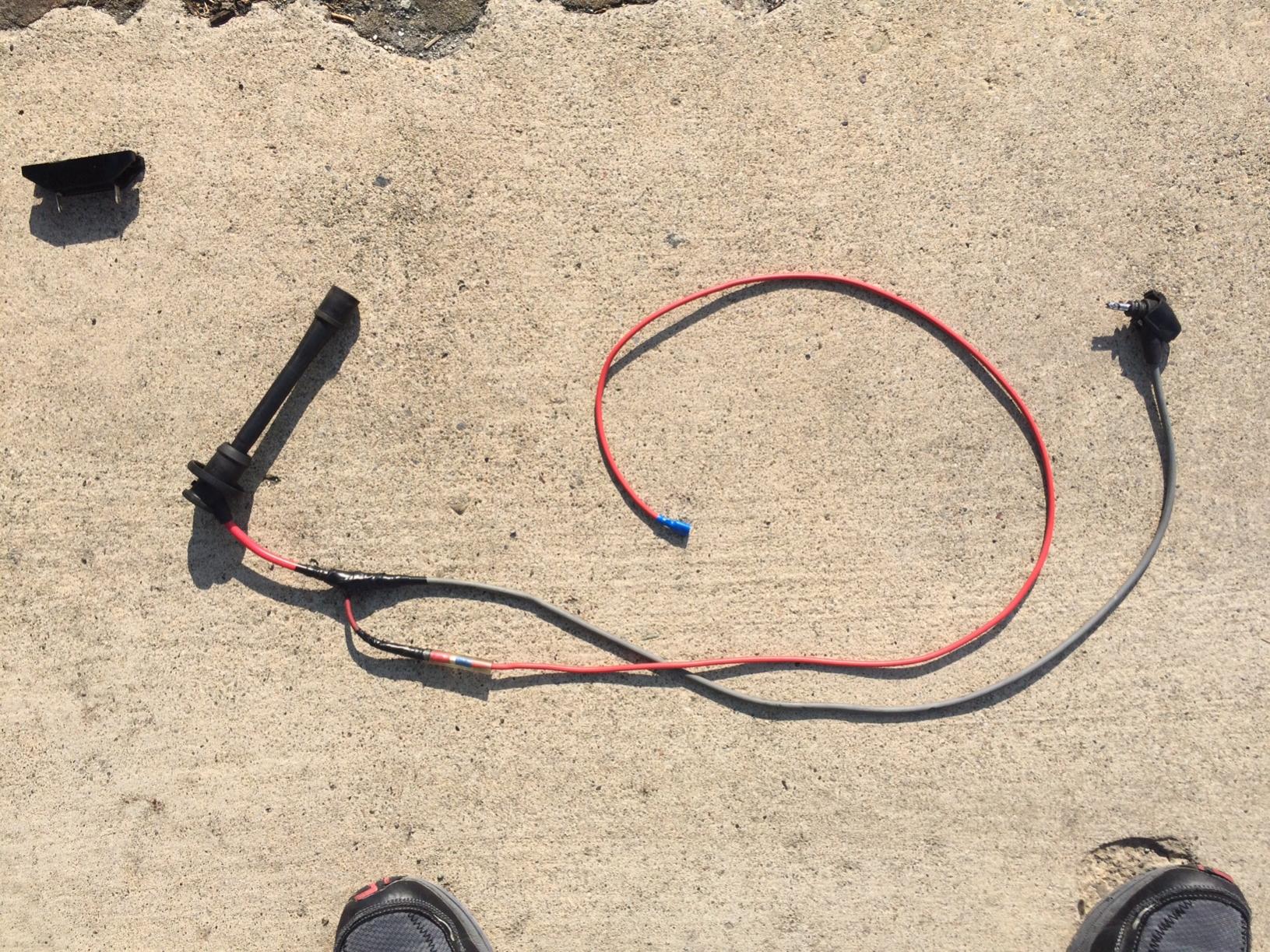

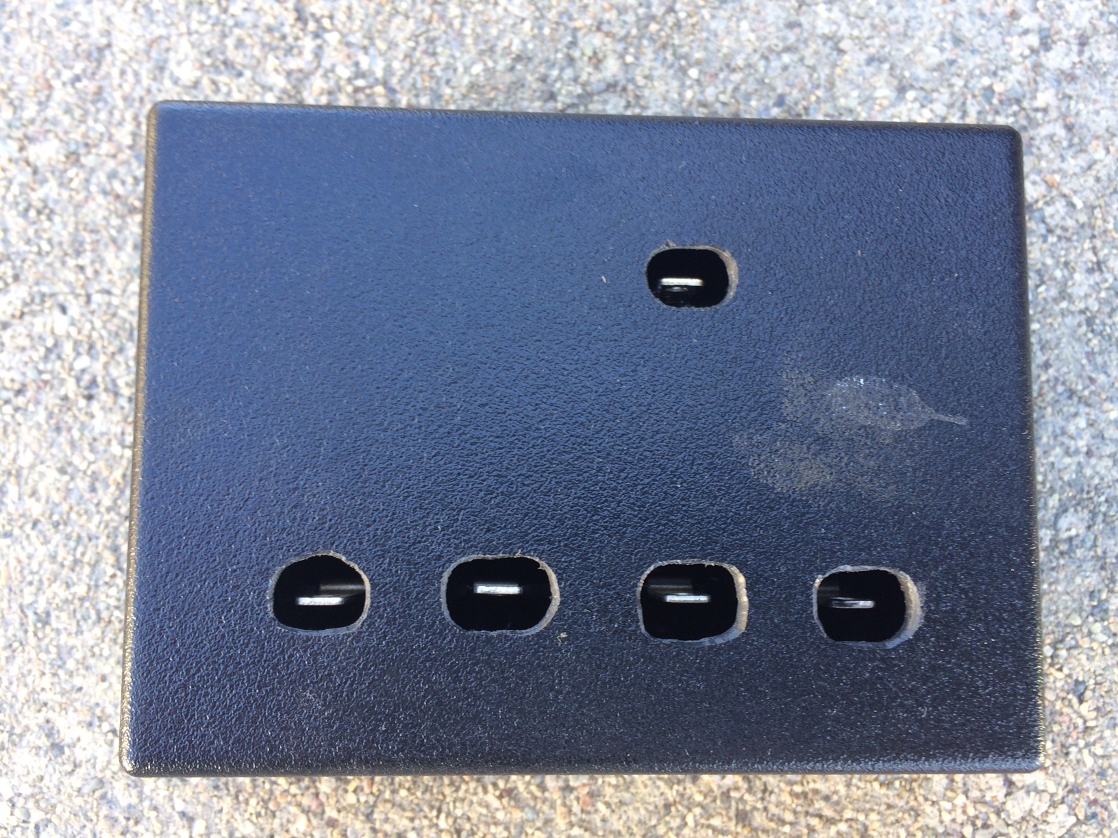

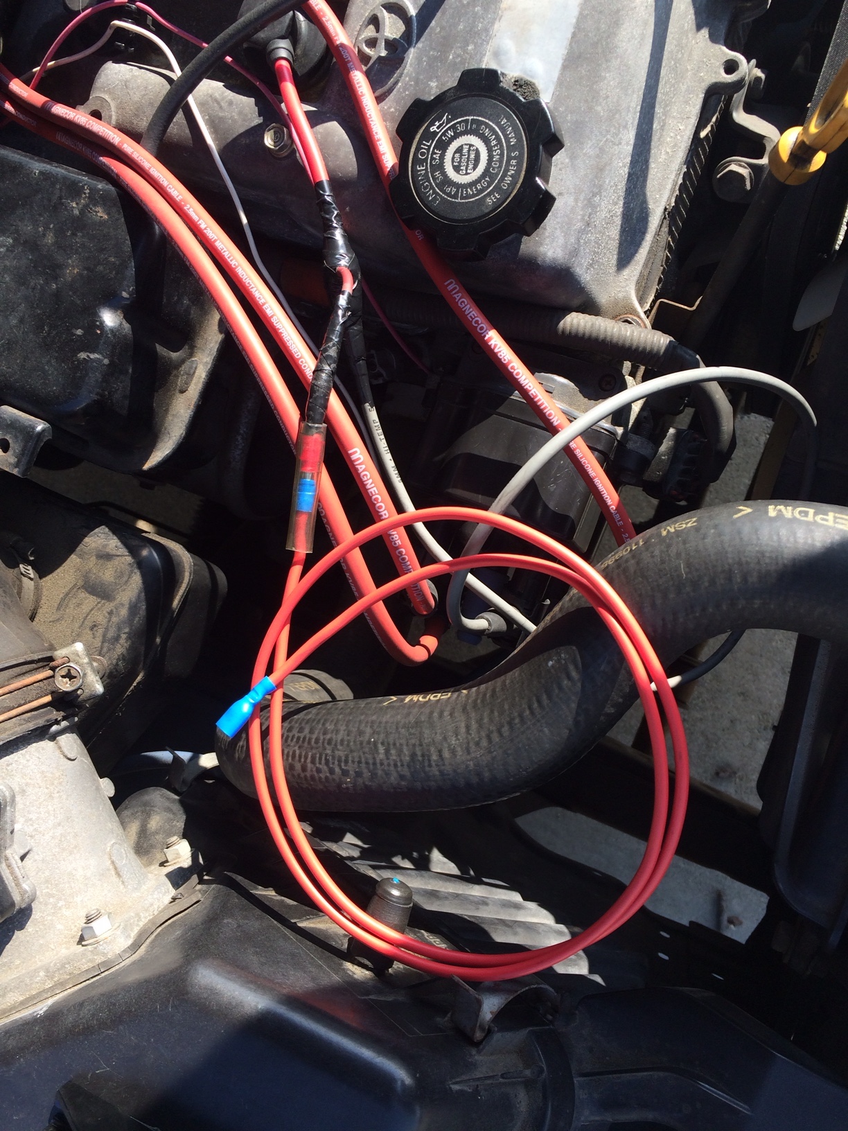

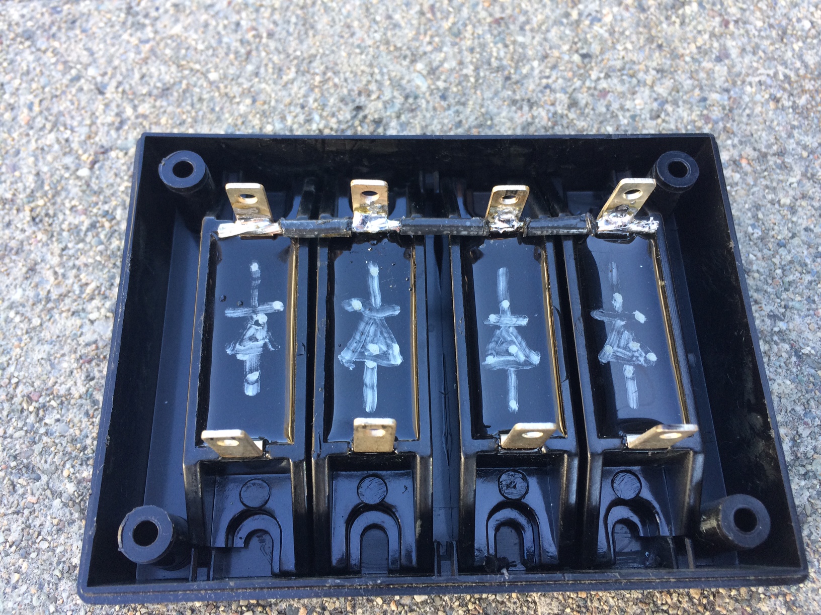

          Well, I have a problem? I got my diodes and mounted them in a nice little black box and did all my connections. When I start it up it barely runs, sputters and pops. So I disconnected everything and did a test with one plug and one diode. The original direction I connected everything I get good spark and when I reverse the diode I get no spark. So why does it barely run when I have it connected the direction of spark?? Again, this is a 1996 Toyota Tacoma 2.4L 4 cylinder engine. Something is strange about how Toyota ignition works???

                    It is possible that the wires you have coming out of the boots to connect the ignition coil + to is firing over to the head. In my first experiment with the Datsun, I had the wires going underneath the boots and they weren't insulated well so the HV spark went from under the boot right over to the head bypassing the plug completely every few firings.

                      Ok, new test! STRANGE PHENOMENON!!
                      I connected my modified spark plug wire to #1 cylinder, started right up and ran good with nothing connected to it
                      BUT then all I connected to it was my jumper wire which would go to the diode and the whole engine started missing and died! And the other end was connected to the air! To nothing! And it just missed and chugged until it quit running??? The red jumper wire is rated at 6KV

                          Yes, the firing order is correct because if I disconnect the diodes it runs perfectly. Awesome spark is when I have one wire connected outside the engine with a plug in it and grounded to the engine and I connect it with the diode it creates a STRONG spark BUT the engine still runs terribly until I disconnect the diode even though it is only running on 3 cylinders. It will run on 3 cylinders with out the diode connected to the plug but when I connect a diode it won't run long on its own before it completely dies. In simple MSD mode the spark is weak. I tried the 3 caps in series and 4 sets of those in parallel, that works great on my 1995 Honda Accord 2.2L VTEC but again, on the Toyota it barely runs?? I have a positive connection to the plug with no spark jumping away to ground.
                          Somehow that extra HV spark is feeding back somewhere it is not supposed to be??

                          That's interesting - it is possible the hv is going to the top of the plug and some hv id being lost in that jump wire in invisible corona right to the air - it's possible, but not sure how probable that explanation is. It wouldn't take much to diminish the energy from the spark enough to cause the engine to miss. But if you only did that to one wire and the other 3 plug cables are connected and it died, that is worse than just removing 1 cable from a plug, which would let it run rough on 3 plugs, but still run.
