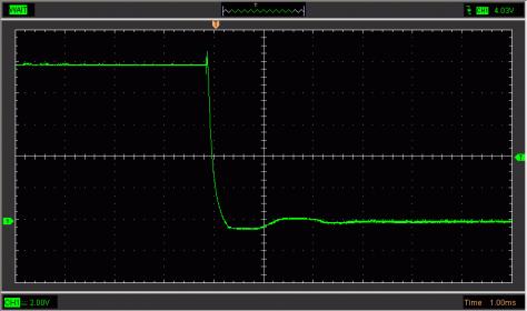

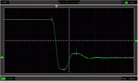

                  • I'm late to the party. It seems like things have calmed down.
                    I wanted to add a comment about this effect which has not been mentioned. That is, it has a very sharp threshold with respect to the voltage on the capacitor. Very much all or nothing. In my setup, using a standard 10K ohm spark coil, 40uF cap, and 15 1N4007 diodes in series, I need to be above 130V on the cap to get a plasma discharge. Below that it is just a simple spark. Above that, it is like an avalanche conduction.
                    Quite interesting, negative resistance. I would like to know what changes so dramatically to initiate the effect, with such a small increment of voltage. Since there is already a simple spark well below that 130V threshold, it is not about the air being ionized.
                    Here are a couple of scope shots of the voltage across the capacitor, that show first the subplasma threshold, and second the plasma effect. The first shows that there is still some flux left after the spark has ceased, which oscillates a bit until the energy dissipates. The second shows a steeper fall time, and very little flux left over at the end of the spark.

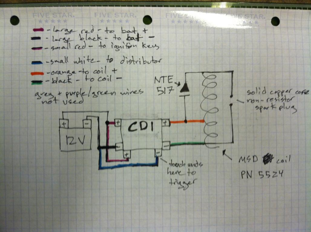

                        Can you post some pics and exact diagram of what your setup is?
                        You definitely should only have to use 1 of those diodes.

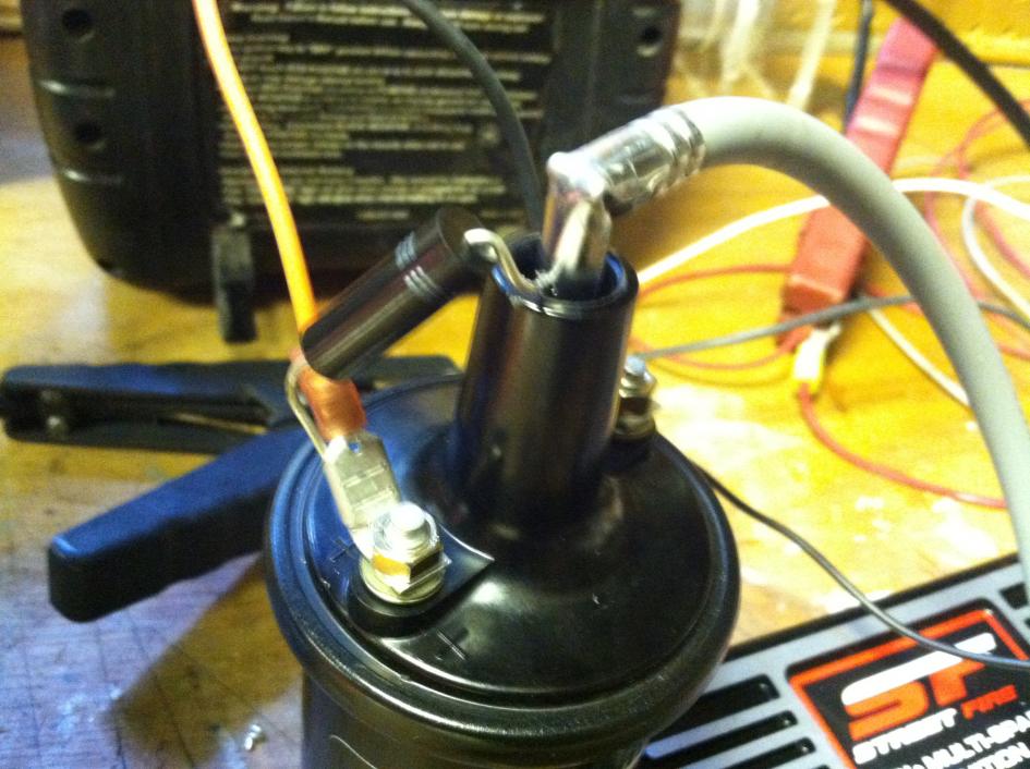

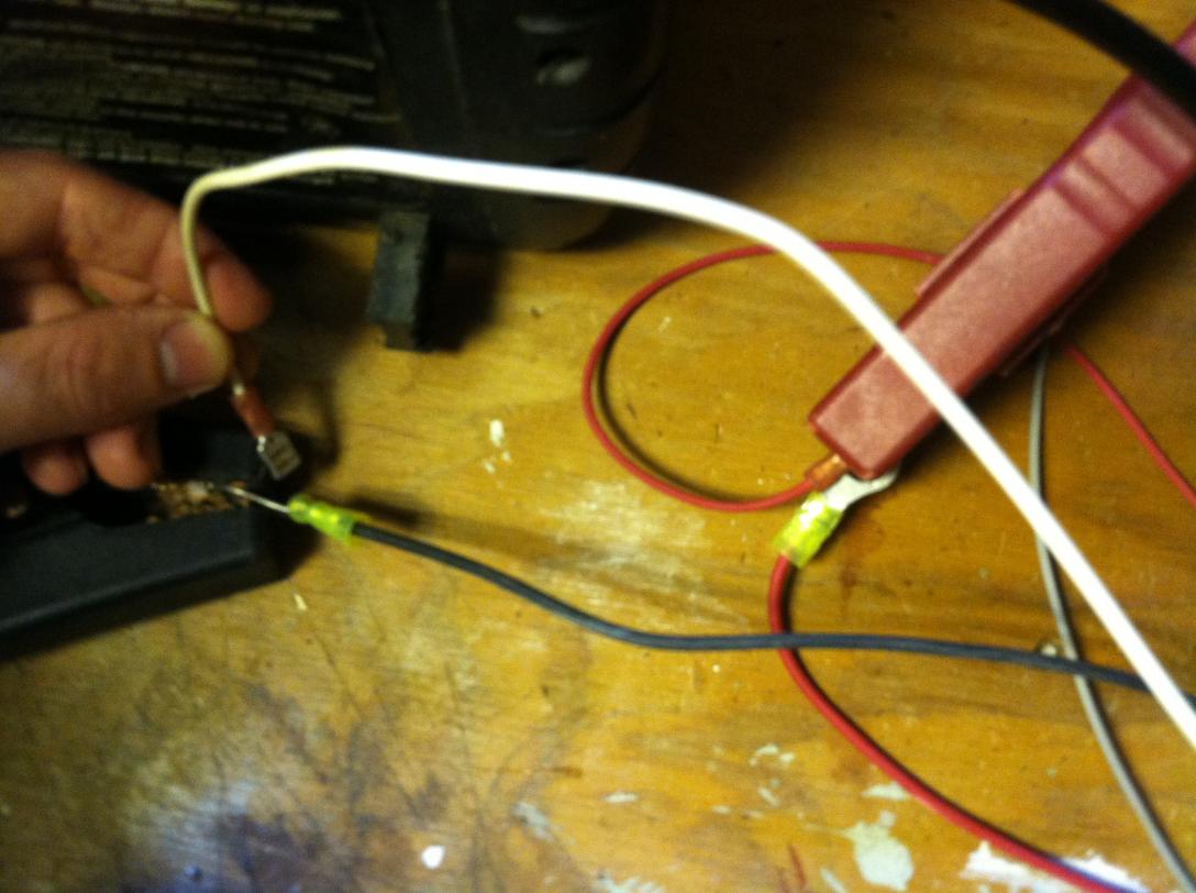

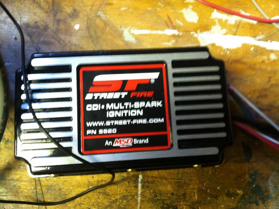

                        • Wow thanks for the prompt reply. Sorry, should have posted pics to begin with. Having trouble getting some of them to upload through this forum, so I'll post a link to my photobucket in case that doesn't work either.

                            Ok, looks like they changed a red to orange.
                            Looks like you have it setup right.
                            Big red and black to battery.
                            Little red (orange) and black to coil.
                            Ignition red to battery +
                            White wire just needs to be dropped to ground of battery and of course the ignition coil neg needs to be connected to the battery negative - I would make sure it is not just going back to the negative of the wire on the negative of the coil.

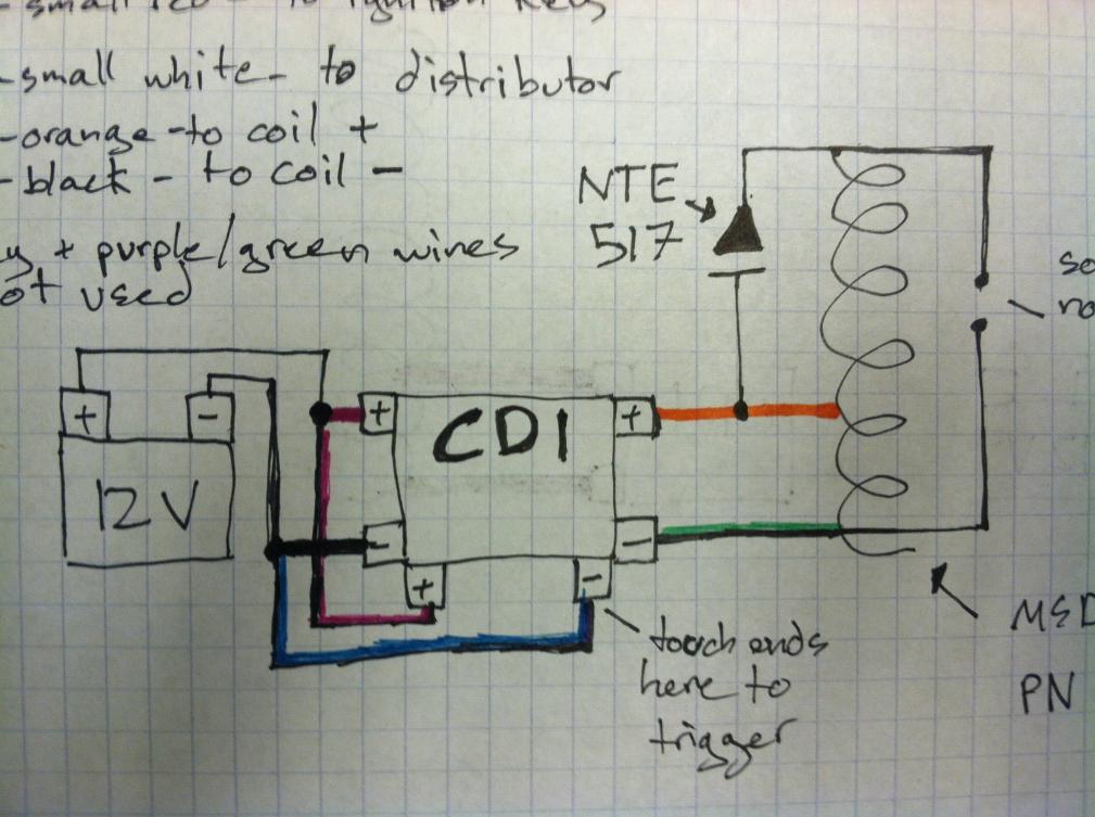

                            • Just checked the wiring and ran it again. Ignition coil negative is going back to bat negative. CDI is still fully functional when the diode is not hooked up. With diode in place there is no spark just a buzz/click that I'm now pretty sure is coming from inside the CDI. I'm thinking there might be a short going on somewhere inside from the increased current; got this off ebay and it might be refurbished - going to take it apart once I can find the right bit, but not exactly sure what to look for once it's open.
                              In case I can't get it working, would you mind sending me or pointing me towards a schematic for a simple CDI that would work for this purpose that I can take down to the electronics store and build myself?

                                If it works in normal mode without the diode, it should be fine.
                                It is possible the diode is blown. If the diode is good, the ignition coil might have a negative hv polarity. I actually am not using a stock black ignition coil for anything - been a long time anyway.
                                You mentioned hooking diode from neg to neg but if the HV is neg, you actually want to keep the diode in the same location between ignition coil + and HV, but just reverse it in the opposite direction. Try that and let me know what happens.
