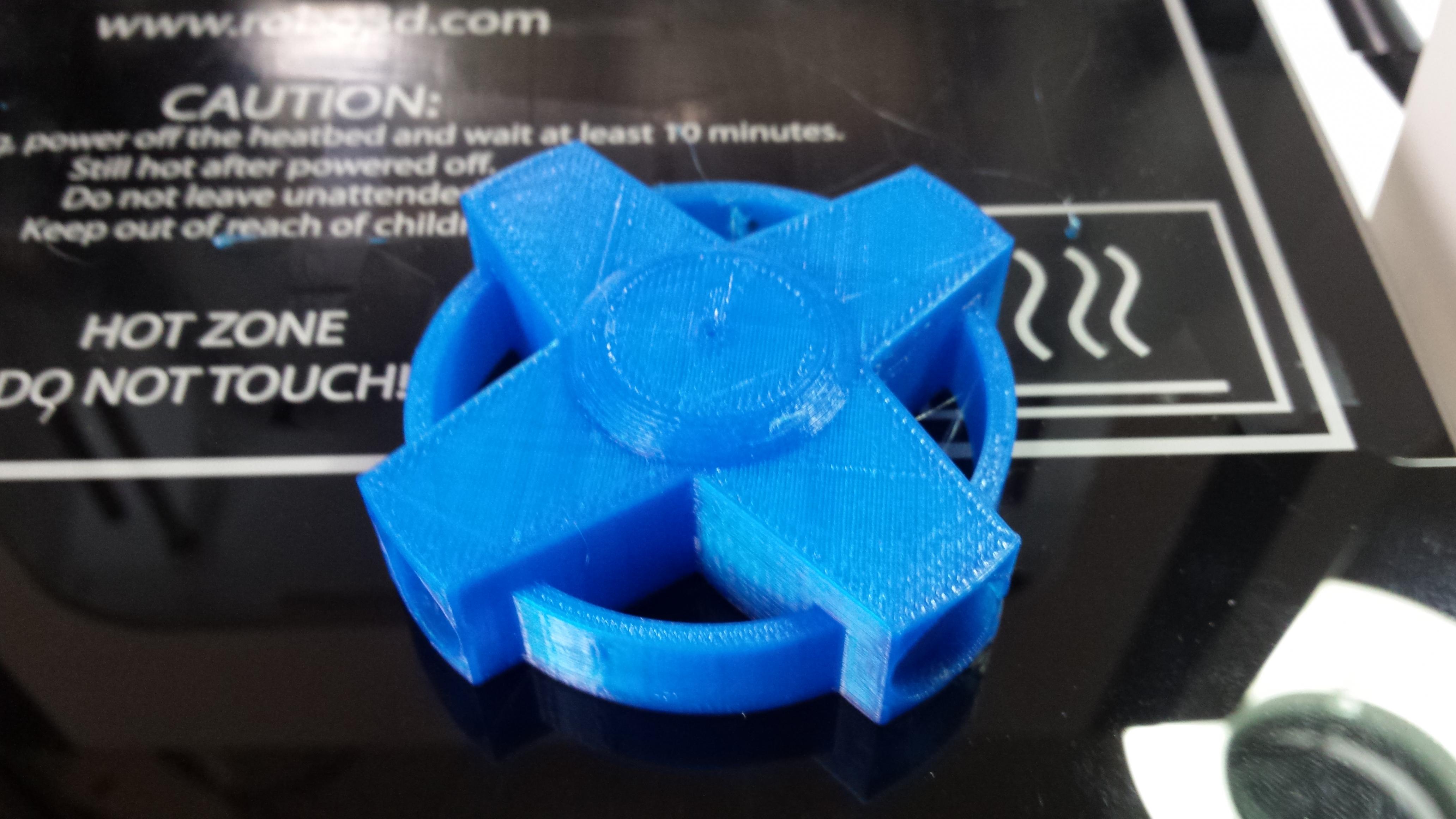

here is the latest version of the rotor we are working on. it is larger than the EZ spin and as such it will be easier to work on. we are working to make it easy to source all of the parts locally, or we will sell them together as part of the kit. looks like we will be doing this in either ABS or PLA, depends upon how we can source filament at a good price.
Hey all, Just found this thread from Aaron's newletter (still waiting on the conference video of Graham Gunderson Aaron...) I have been following John for well over a decade and excited to see an open source project with his backing. I have a 3D printer and I'm proficient in SolidWorks. Holler if I can be of any help. I will happily print and mail anything to anyone if you cover the cost of postage and plastic. I have great success with PLA but ABS does not stick to my bed well. (I need some kapton tape). Is anyone publishing STL's yet?

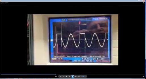

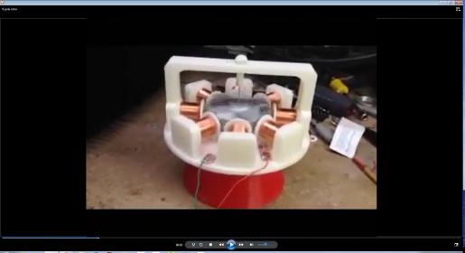

Now that's what i'm taking about - nice!Originally posted by Tom C View PostWe are moving along here, the latest version of the 8 pole back charges the primary. you can place a dead alkaline on the machine and it will charge back up. still working on the bearings for the kit.
