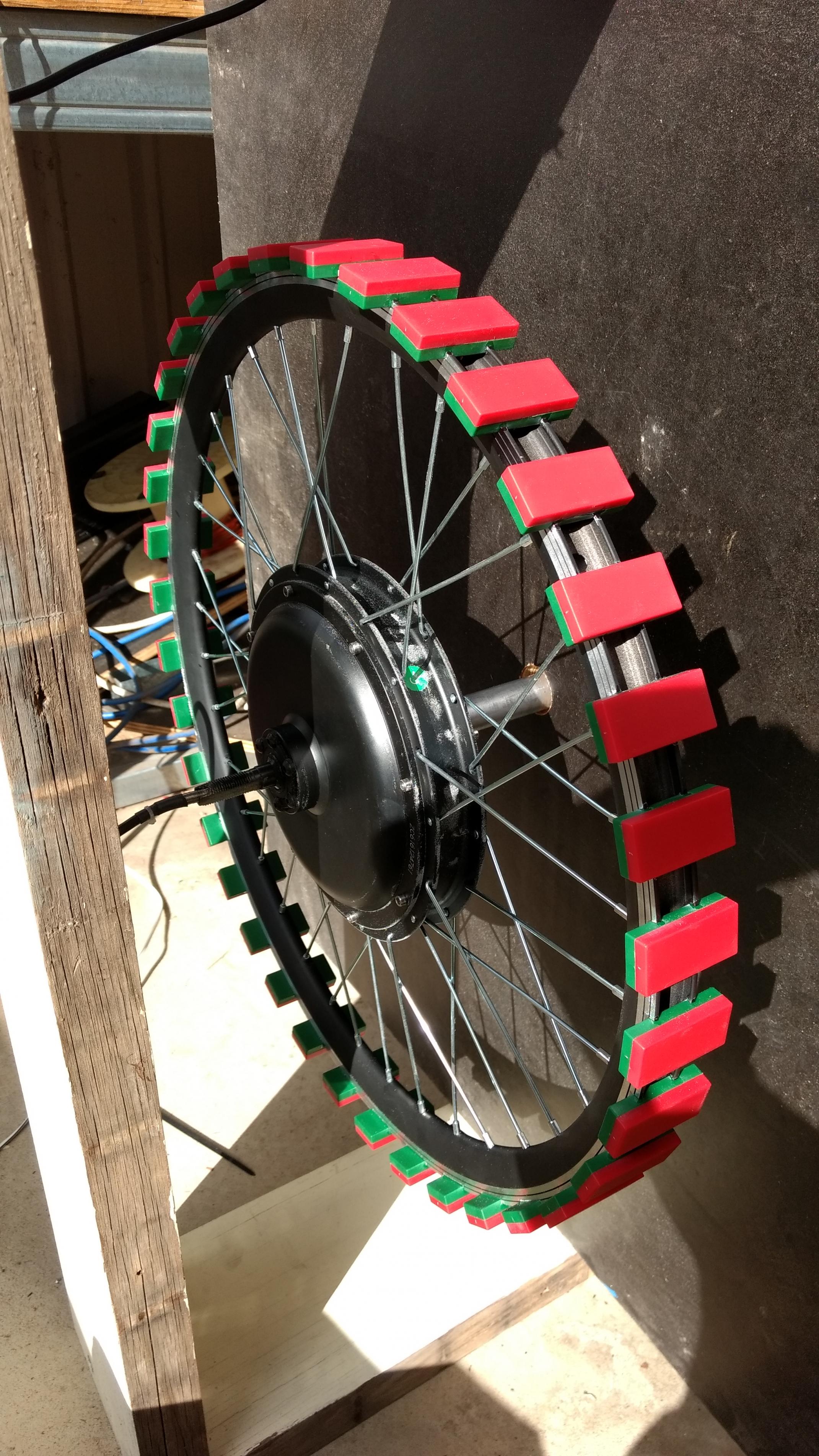

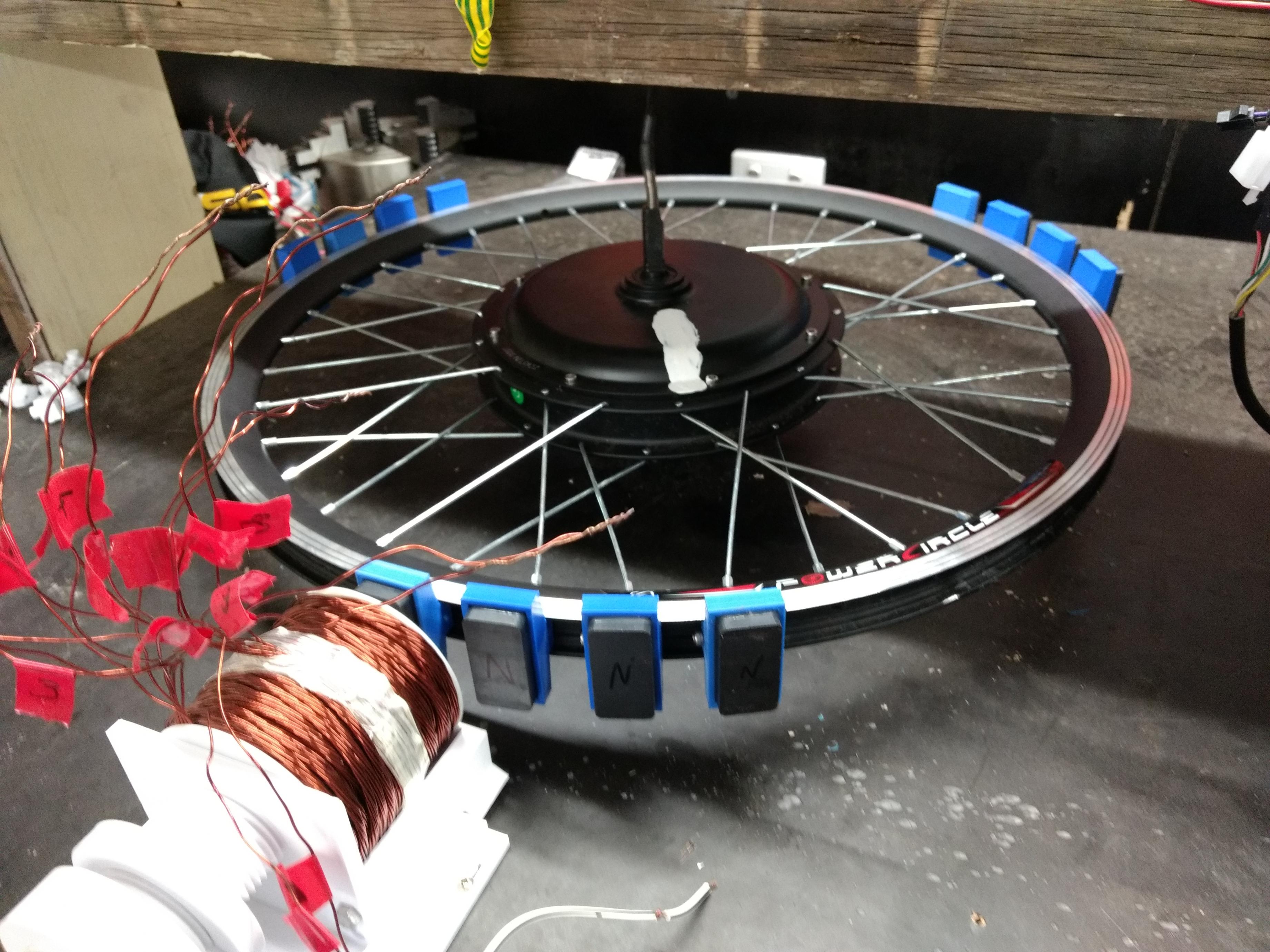

Well here is a big fairly balanced wheel (580mm diameter) with markings on the rim which allow a 5, 10 or 15mm cutouts for magnets which can be done with just a file.
The shaft is strong for mounting, bearings are good and as a bonus a 1000W brushless motor is attached.
With the motor you can used it to drive the flywheel (the motor wheel and magnets weigh about 4kg) at any speed you wish for testing various coils.
You can do as im doing, test various coils as gennie coils for their effectiveness.
Maybe you could even just use the big wheel and throw 40 gennie coils around it.
The motor itself uses 45W of power to drive the wheel at 500rpms. (without stripping the grease from the bearings)
I'll let you all figure out the potential for yourselves.
Cheap wheel, throw a few magnets on and hey presto a really good rig for experimentation.

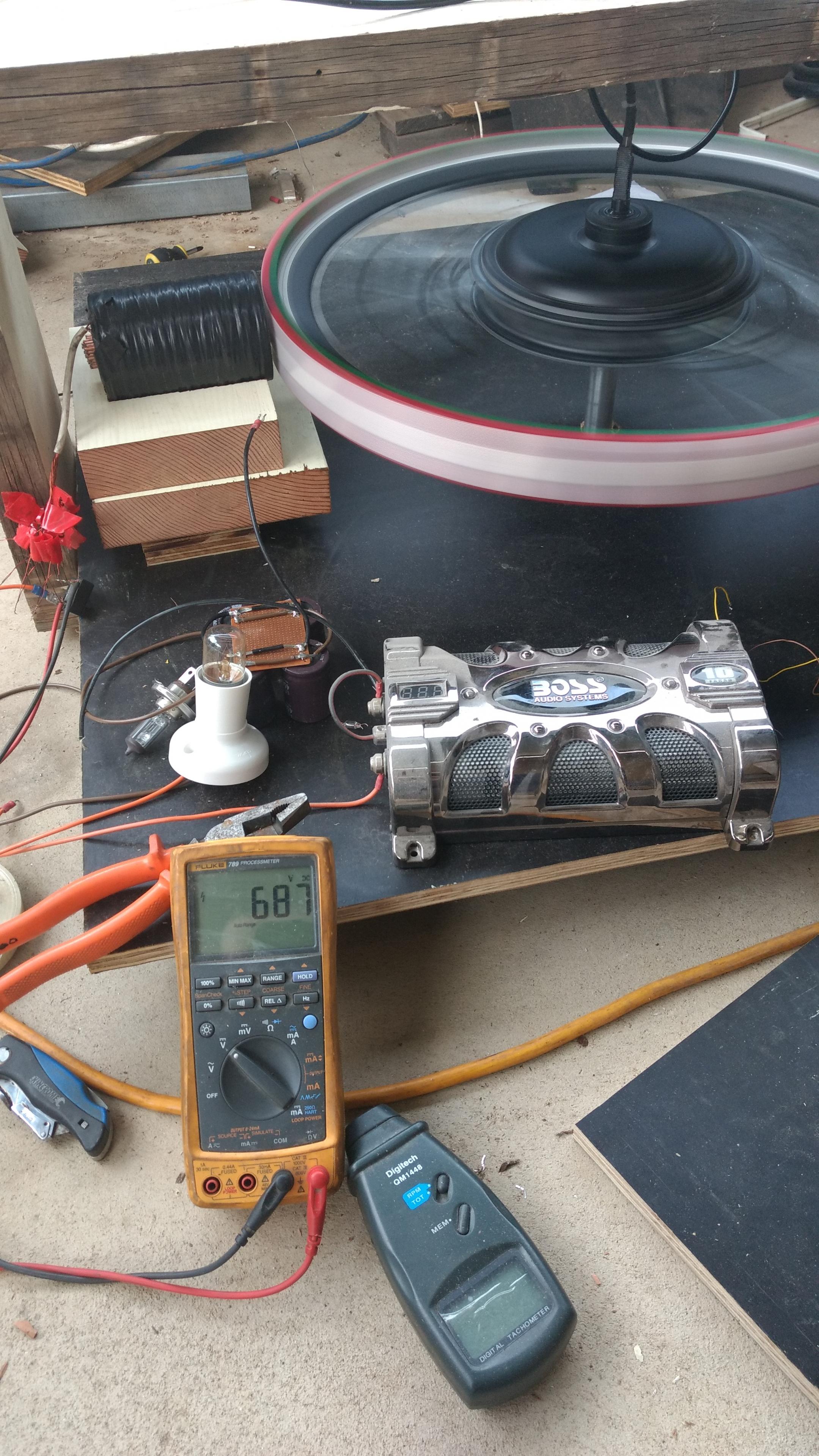

Today I hooked an 8 Filar 18Ga coil in series and charged a 10F Capacitor.

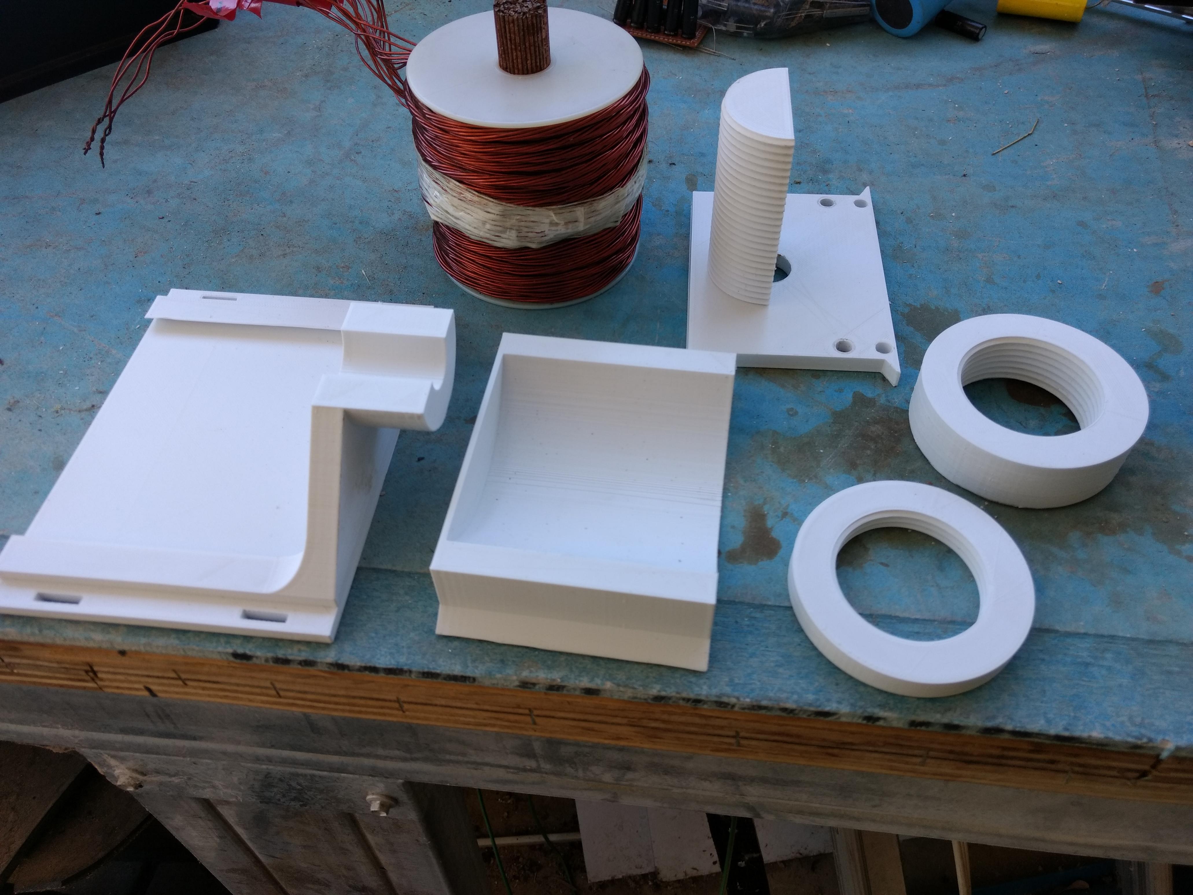

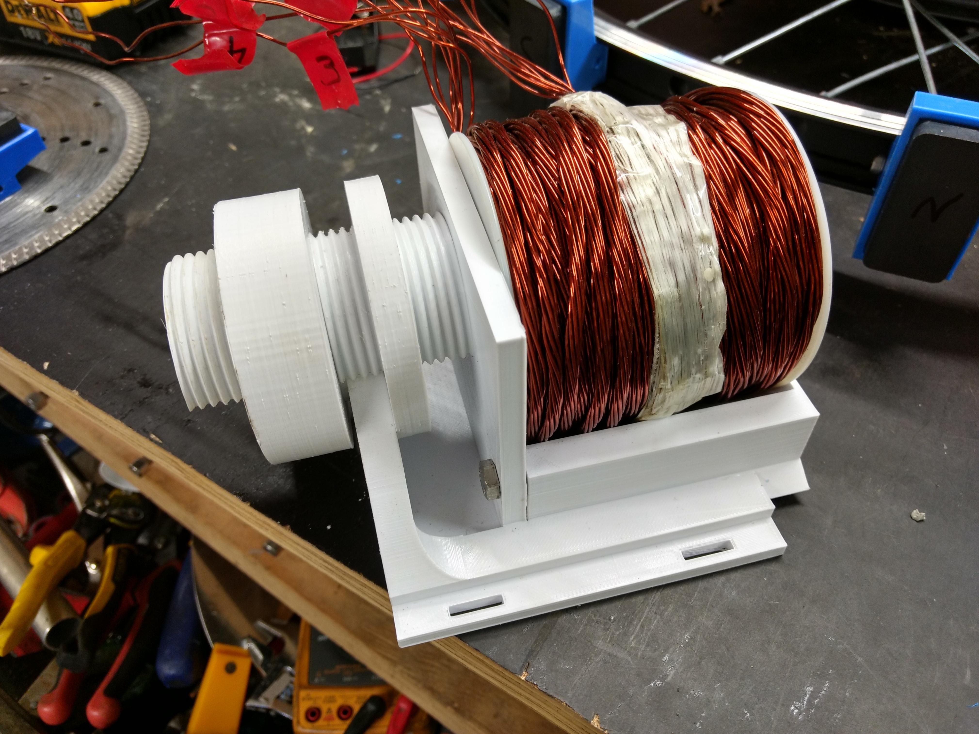

I've built a core out of transformer steel which matches the width of the magnets.
I will be wrapping that in 18ga and comparing to the 3/4'' standard 8 Filar for some base readings.

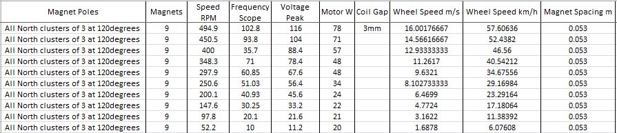

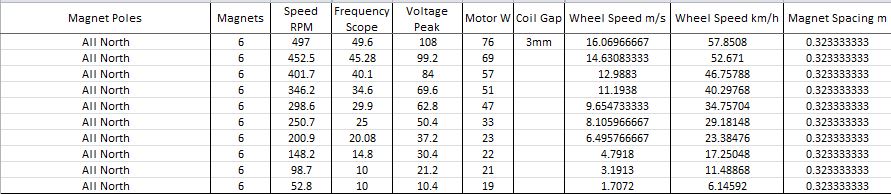

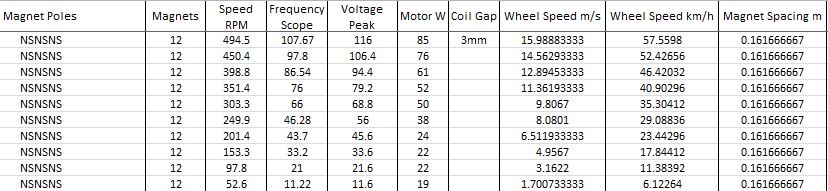

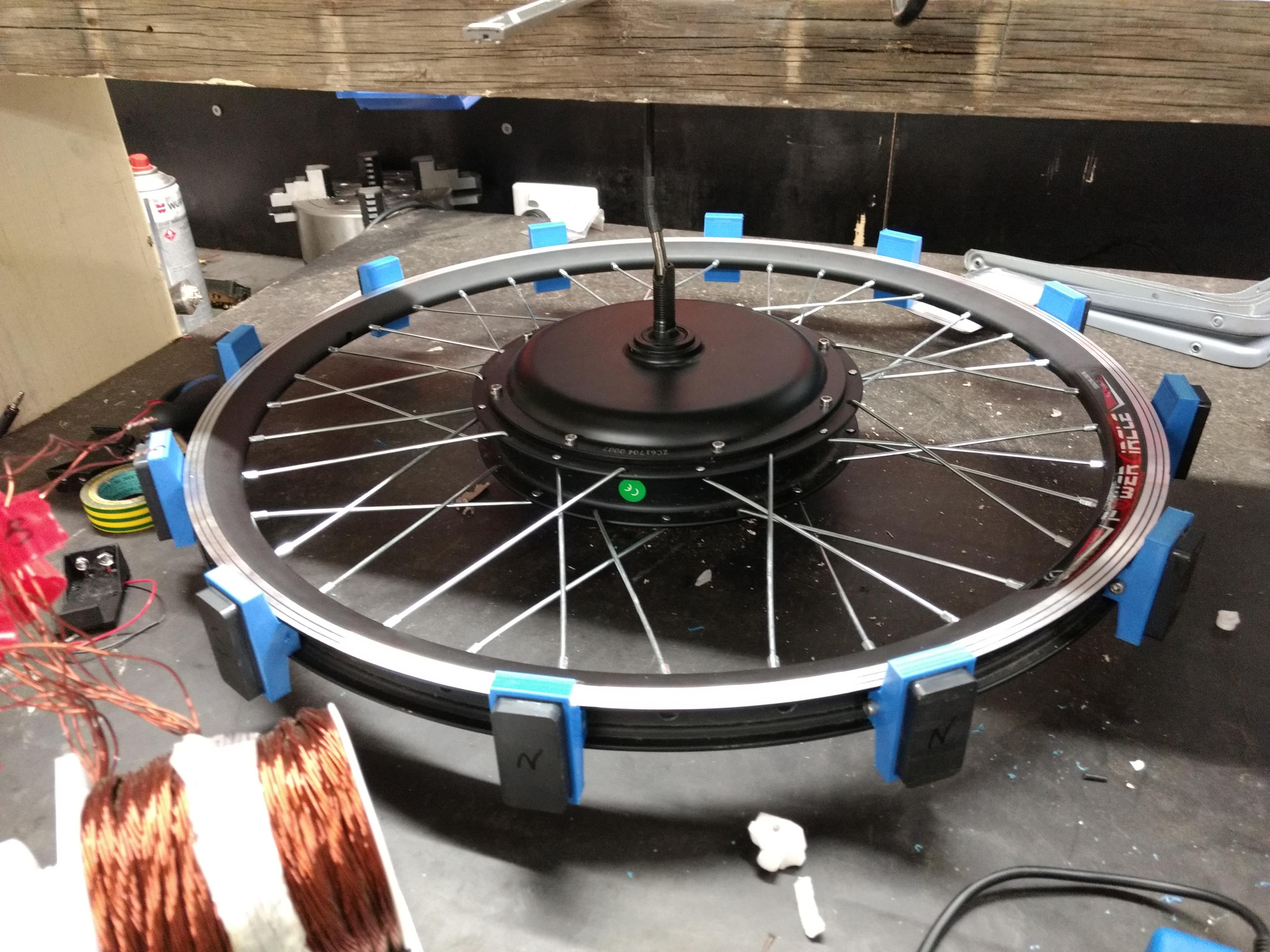

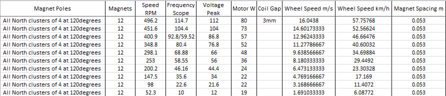

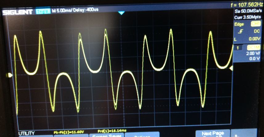

Just waking you up! Interesting results to charge that capacitor in 84 sec. Be worth the effort to post a short video of this and the arrangement of the set-up to flesh out the details.Originally posted by Deuis View PostI removed 24 magnets and spaced 12 around the wheel.
some interesting results.
Coil was completly random (4ohm 5filar) and tuned very roughly.
Calcs with the coil generating were subtracted from free wheel to give actual power used to generate.
Don't be overly disappointed with the seeming lack of interest - time of the year when a lot is happening. Many are still looking over your shoulder - just do it.
YaroYaro

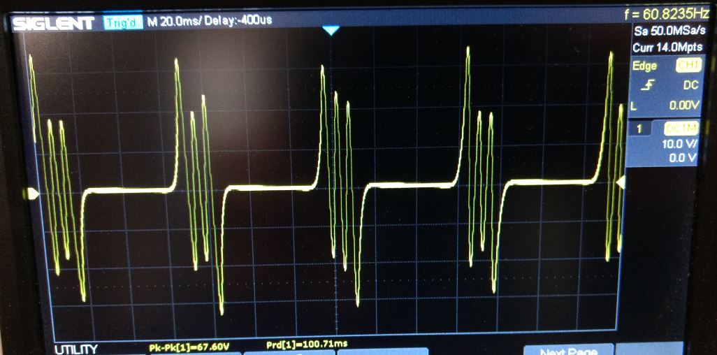

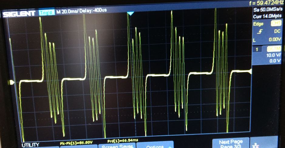

Happy Valentines Day and thanks for your complete test results and pics on the magnet cluster progression. Nice meaty spikes generated that multiply the output for a minimum additional input. As a suggestion an accompanying chart with the freewheel data without magnets would be useful to establish the input baseline.
For us neophytes it would be useful to briefly explain your goal in these experiments and to broaden the perspective. Nice work on the coil holder - assume that the 3D printer was in play here.
