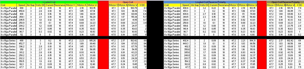

Originally posted by Deuis
You keep mentioning spec coil but I've not come across one like yours before. If I guess here can you correct/update me?
1 - 3"x3" spool with 1/2" core
2 - 100 winds of twisted 18 awg x 8 strands
so if all 8 in series - 800 turns?
what is the ohm resistance on all the wire in series?
If all 8 are in series what are you using as trigger?
Thanks! - Patrick A.
Ps - I tried to read the whole thread to find this and may have missed it, if I did would you be so kind to point me to the post?
