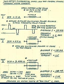

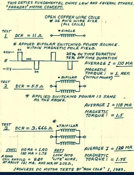

R Cole produced a schematic of a coil configuration experiment that took a quadfilar strand Coil wind and proceeded with an experiment that at a given voltage tested the various amperages in parallel of each added strand to the coil. The experimental results are somewhat mind blowing in that while the overall resistances of each parallel strand addition were calculated in the classical method the overall operating amperages for each strand addition were not. Contrary to expectation.
Here is his data sheet.

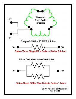

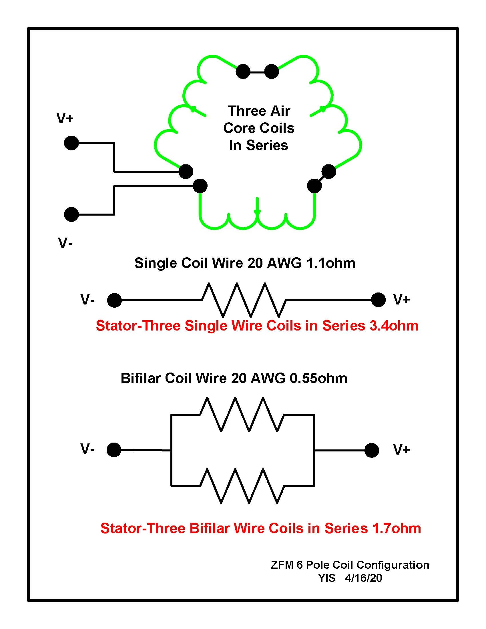

So this intriguing information from R Cole's experimentation triggered a "what if" question and it was applied to two experiments with the existing 6 Pole ZFM. Here is a schematic of the basic ZFM configuration used in these experiments.
EXPERIMENT 1 Single Strand
Three bifilar coils, #20AWG, with 1.1 Ohm resistance per single coil strand with 6 pole rotor. Connect only one strand per coil in series. Total series R equals 3.4 Ohms.
Experiment 2 Bifilar Strand
Same config as first experiment, but with coil strands in parallel with 0.55 Ohm resistance per coil. Coils wired in series for a total R of 1.7 Ohms.
