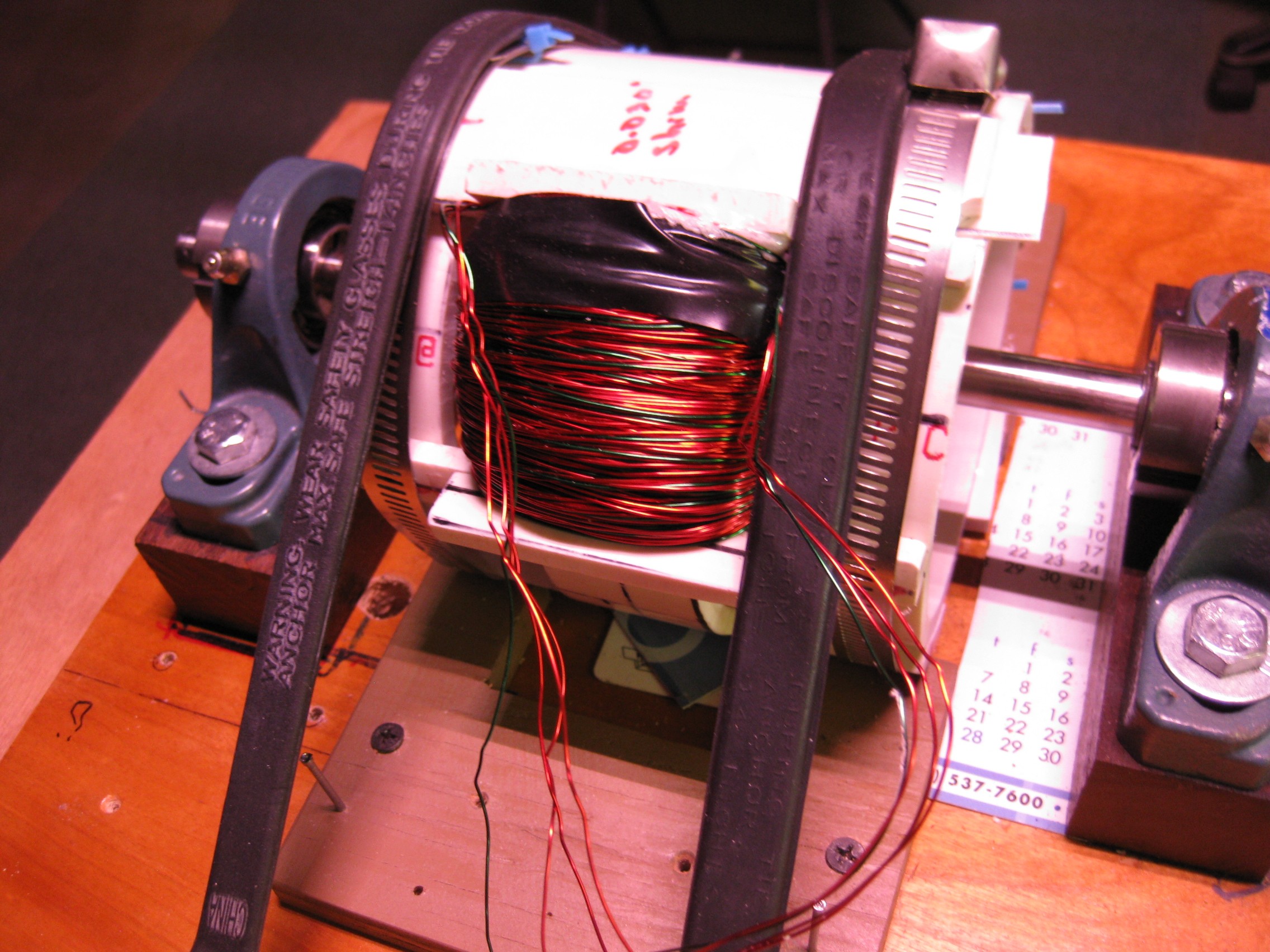

Well, the prior BEMF experiments were very useful in helping to the design the newest coil version with 4 strands of AWG#23 magnetic wire. The modified coil design was based on many experiments over the past year that all enhanced the understanding of this DC motor.
So there have been multiple tests and experiments where the primary goal was to extract relevant information, some may question this experimental approach, but in the end it is no different than any other research that does not have a book such as "ZFM Design for Dummies" as a reference point.
The specific coil design information will be very light for the time being, however the modified coil has been upgraded with with specific dimensional end points that allow a much more accurate means of duplicating coils to specific design dimensions. Don't really need a fracken 3D printer when simple tools, PVC cement and inexpensive PVC pipe will do the job for low budget experimentation, albeit that the rotors have to be machined, the shafts purchased and machined, the Bipolar switch built and the Neo's purchased ( BTW N52 Neo's in certain sizes are hard to get with our current political spiff with China).
Fortunately, a small measure of forethought was put into the current design and many components can be reused many times. In this configuration the 6 Pole rotor, initially with 2"x3/4"x3/8" N52 Neo's and modified with an additional 1-1/2"x3/4"x1/8" glued on top to give the appropriate height along with the modified coil design.
The ZFM is a very flexible and forgiving motor - so the question here is whether it will operate with only a single coil?
The answer is Yesss! But does it perform and does it perform beyond expectation?
Preliminary testing demonstrates that it will handle the normal 950 gram load easily with a performance efficiency of around 46% at 24 volts. Certainly, with additional tuning it will easily pass over the 50% efficiency threshold. Impressive for just a single coil!. One can only speculate what the future addition of another coil or two or three will yield.
