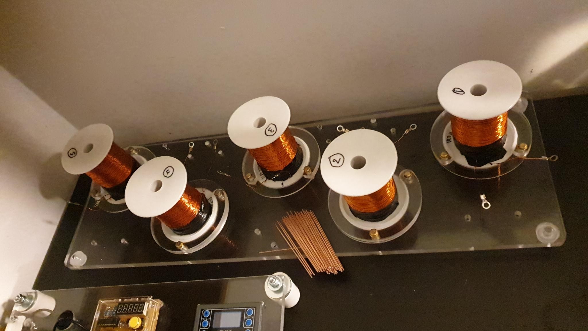

    Yes, my coils will be on a separate base plate, I’ll post some pictures when it is done, but first will finish the main base plate/circuit connections.

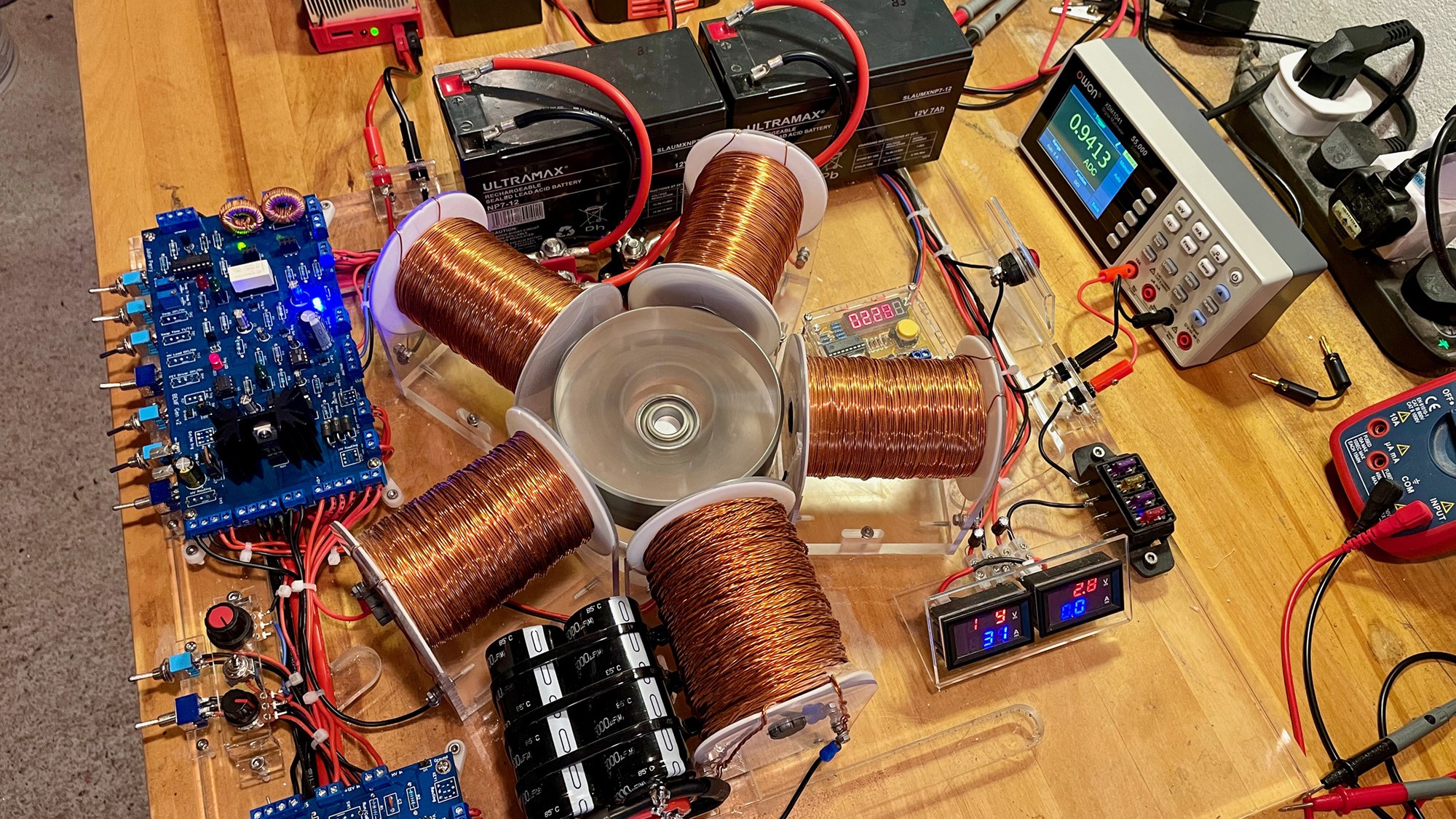

    • #77
      Hi Julian,
      Quick update regarding the coils:
      -Resistance (individual): +/-14 Ohm
      -Inductance (individual) without any core material: 62.5mH
      -Inductance (individual) with core material*: 273.5mH
      *The Ferrite rods I ordered from Aliexpress are slightly too big, so stacked 1 coil with welding rod material, see picture (material: R45-G / DIN: 8554: G1 / w.nr 1.0324)
      Will put the ferrite rods on a lathe and turn them down to fit and remeasure.
      Measured with: LC100-A Digital LCD High Precision Inductance capacitance L/C Meter (aliexpress)
      Regards,
      Rodolphe

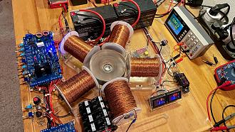

              This weekend I started with testing components and sub-systems; went pretty ok, see image below. Swapper works. One thing that I noted was that when SW2 is OFF (swap on/off), LED3 (swap on) was still lit very faintly… I measured the voltage over R11 (10k), this was 0.12V. (9.6V when SW 2 is in the ON position). So either that switch is not completely disconnecting in the off position, or U1 (CD4060 unit) is leaking from somewhere a bit.
              (White tape indications will be replaced with stickers further down the road)
              Click image for larger version  Name:	Post 81 - Main board.png Views:	0 Size:	617.9 KB ID:	74153

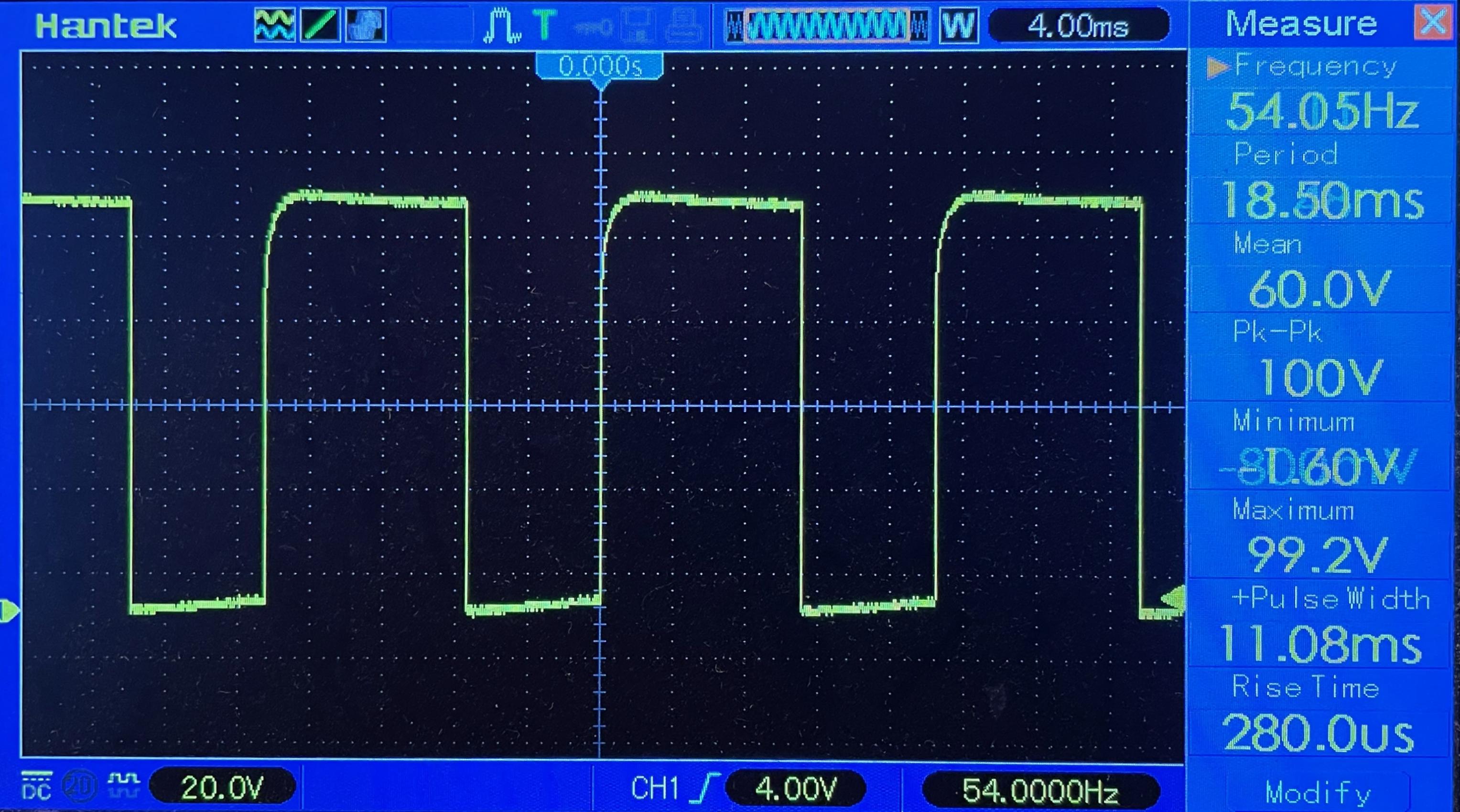

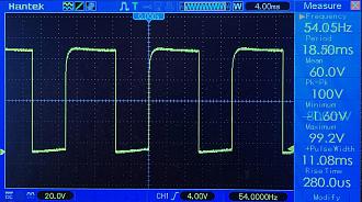

              Voltage divider

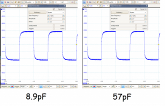

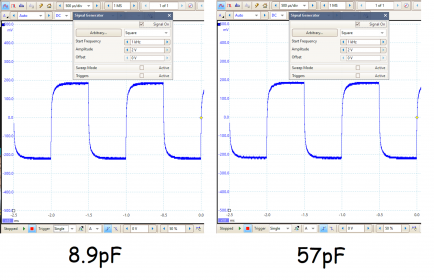

              Furthermore I put a +/-2V 1kHz square wave signal from my scope on the voltage divider and used the probe from the same scope to compensate/tune the radius-ed edge of the square wave output with the trimmer, but to no avail: in the screenshot below you see the signals with the trimmer in both extreme positions, 8.9pF & 57pF. Any idea what might be the cause? Before using the voltage divider I did calibrate the probe itself with the same square wave signal (but without the voltage divider in between).
              I disconnected the trimmer to double check if it didn't burn out in the soldering process (very tiny and sensitive thing ), but it was working properly and connected it again.
              Click image for larger version  Name:	Post 81 - Voltage divider n2.jpg Views:	0 Size:	75.0 KB ID:	74156
              Another thing I realized is that I do have an additional set of HV probes, with a ratio of 100:1. My question is; could I use on of those probes directly, or would the energy in the spike be too much and damage it? https://eleshop.eu/owon-oscilloscope-probes-2kv.html

                From memory, my little cap adjustment inside the voltage divider didn’t do much either but the adjustment on the cable feed to the scope channel did so I was able to get nice square waves using that.
                However, if you are going to use the voltage divider then you will need to calibrate it against an ‘impulse’ signal from a signal generator and not a square wave. The 5V impulse signal I used is far more like the spikes you will be measuring. Super accuracy here is not required since the divider is just to give confirmation of the peak HV and which should be similar to the avalanche rating of the device.
                There is no reason why you can’t use your 2000V probe. The conventional power in the spikes is small as there is hardly any ‘hot current, a fact demonstrated by the fact that the small relays are passing the HV spikes through to the correct battery with no problem or damage.

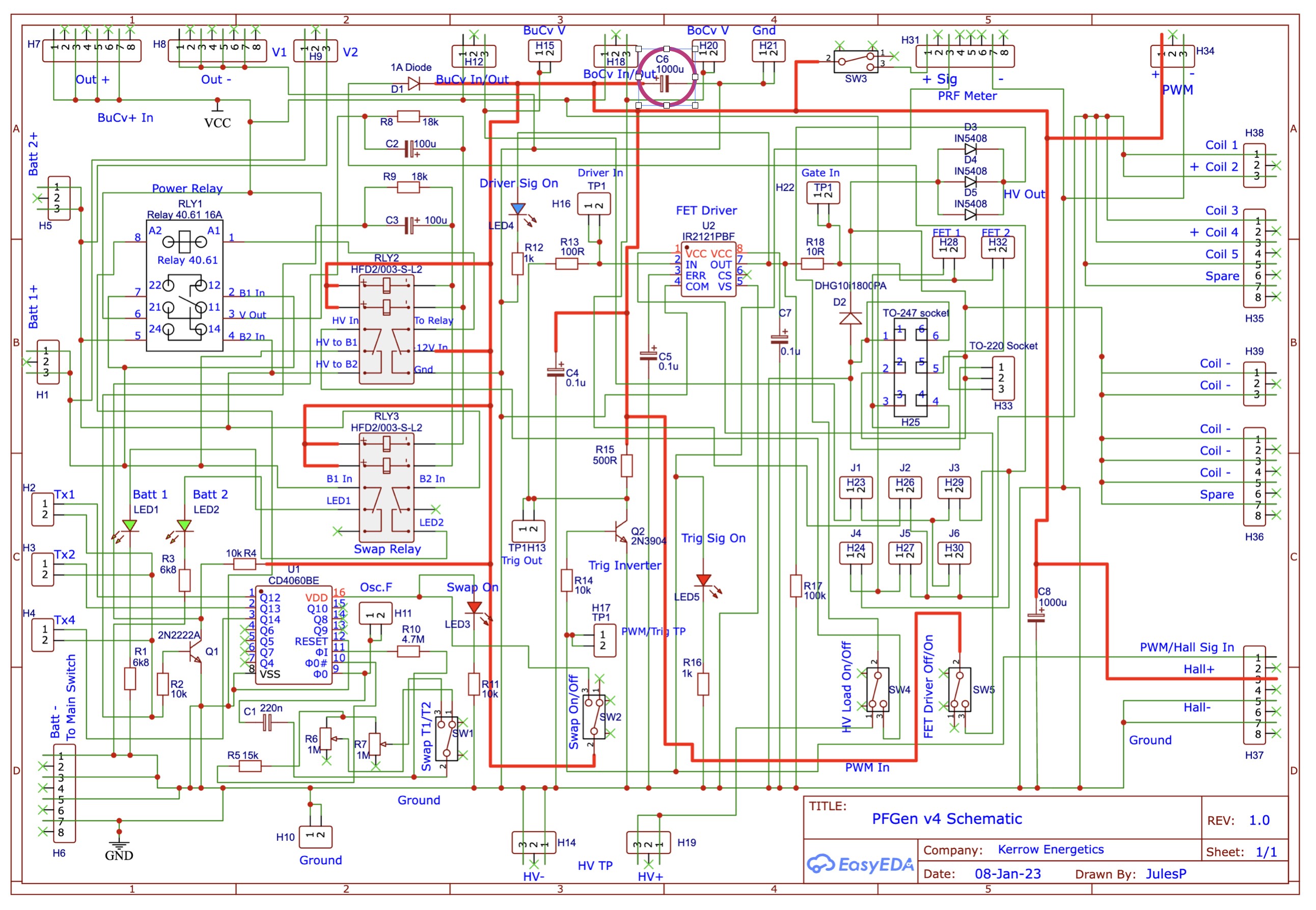

                    Hi Julian,
                    Swap LED 3
                    I disconnected SW 2 completely (Swap On/Off), but LED 3 still lit very dimly as before when switching on the main switch. Maybe it relates to the topic below?:
                    FET driver chip / U2 / IR2121 issues/signal
                    For the measurements below the following things/settings were used:
                    -Jumper 4 and jumper 5 capped (connected)
                    -None of the 5 coils was connected to the PCB
                    -PWM module “V-“ and “Ground” connection connected to each other (and together connected to H34 (PWM-)
                    -C7 is indicated on the electrical schematic as a polarized capacitor, I used a non polarized:
                    https://www.reichelt.com/de/en/folie...NGUAGE=EN&&r=1
                    1) H13 & H16, SW5 OFF -> approx. 10V square-ish signal
                    When I disconnect SW5 completely, the signal stays the same (=no leak through switch).
                    2) H13 & H16, SW5 ON -> approx. 12V Square signal
                    3) Pin 1 IR2121, SW5 OFF -> approx. 8V Sawtooth-ish signal
                    4) Pin 1 IR2121, SW5 OFF, PWM module OFF -> approx. 8V signal
                    5) Pin 1 IR2121, SW5 ON -> approx. 12V signal
                    6) H22/Pin7 IR2121 SW5 ON -or- OFF -> no signal
                    I assume 1) 3) 4) are signal readings that are not supposed to be there with SW5 switched off. Do you have an idea what could be wrong/what I should check?
                    Post 84.pdf
                    Manual update, page 47:
                    Where it reads: “…then an output should be measured at TP-H17…”
                    I think it should read: “…then an output should be measured at TP-H22…”
                    Best regards,
                    Rodolphe
                    • #85
                      Hi Rodolphe,
                      Bad connections have been a problem with me on occasions when a circuit error occurred and only by going through every possible option step by step in a logical way, and including the most unlikely things, was the fault found. In one case a biasing resistor for a transistor, that is involved in switching on one of the cap dump routing FETs was not in fact 10k but around 5ohms! Is it Murphy’s Law or another one? So now I check each component before I solder it in place.
                      When I ‘hot’ recharged a battery after a test involving a controlled discharge and then HV pulse charging (as in the regular CoP test run), the battery would be left till the charger naturally stopped and then usually left overnight. So long as you know the voltage when you start a controlled discharge, and then leave it for an hour or more before you start the pulse charging, then it shouldn’t really matter what voltage is reached. You’re not expected to have a ‘globally’ consistent value and each test I treated as its own independent one.
                      I expect batteries and capacitors will both display an ‘electret’ effect that will boost the voltage a little but the degree and significance are worthy of another whole study!

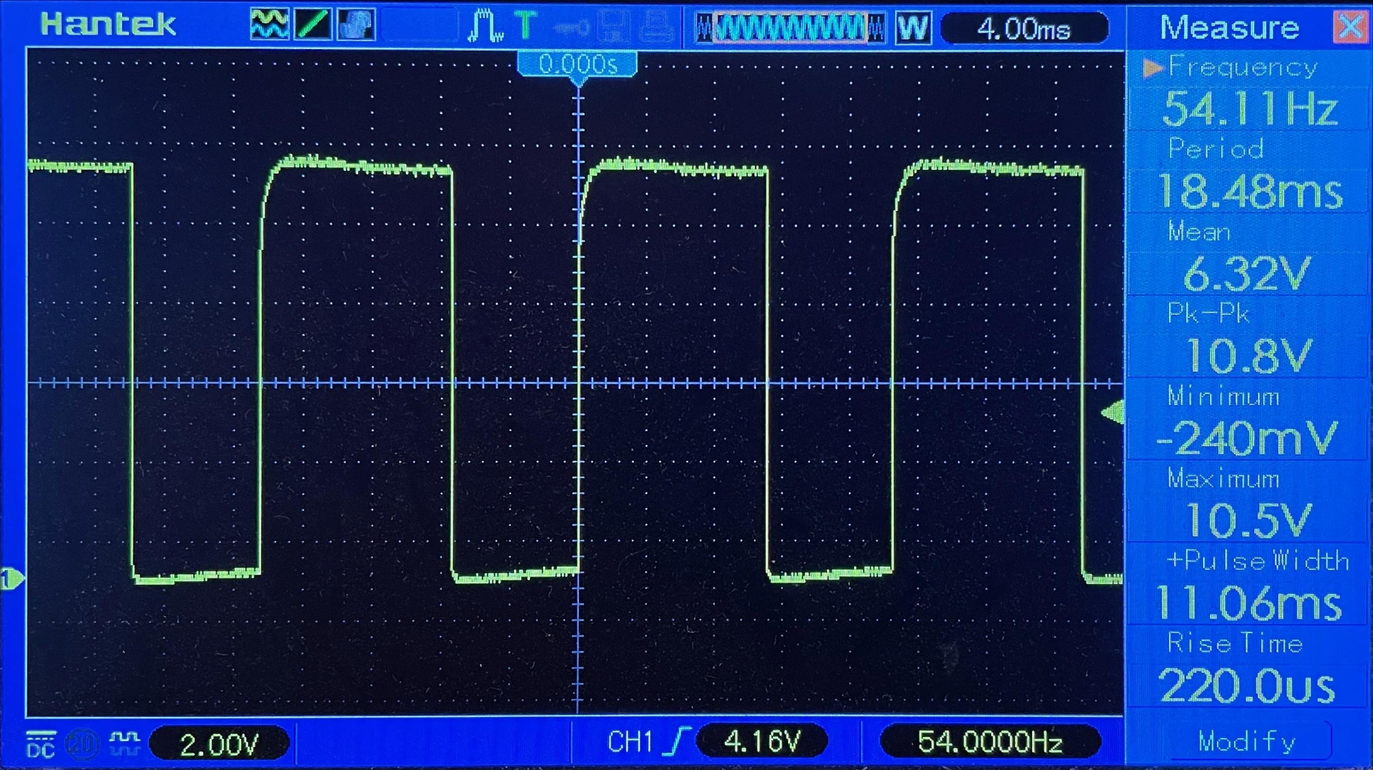

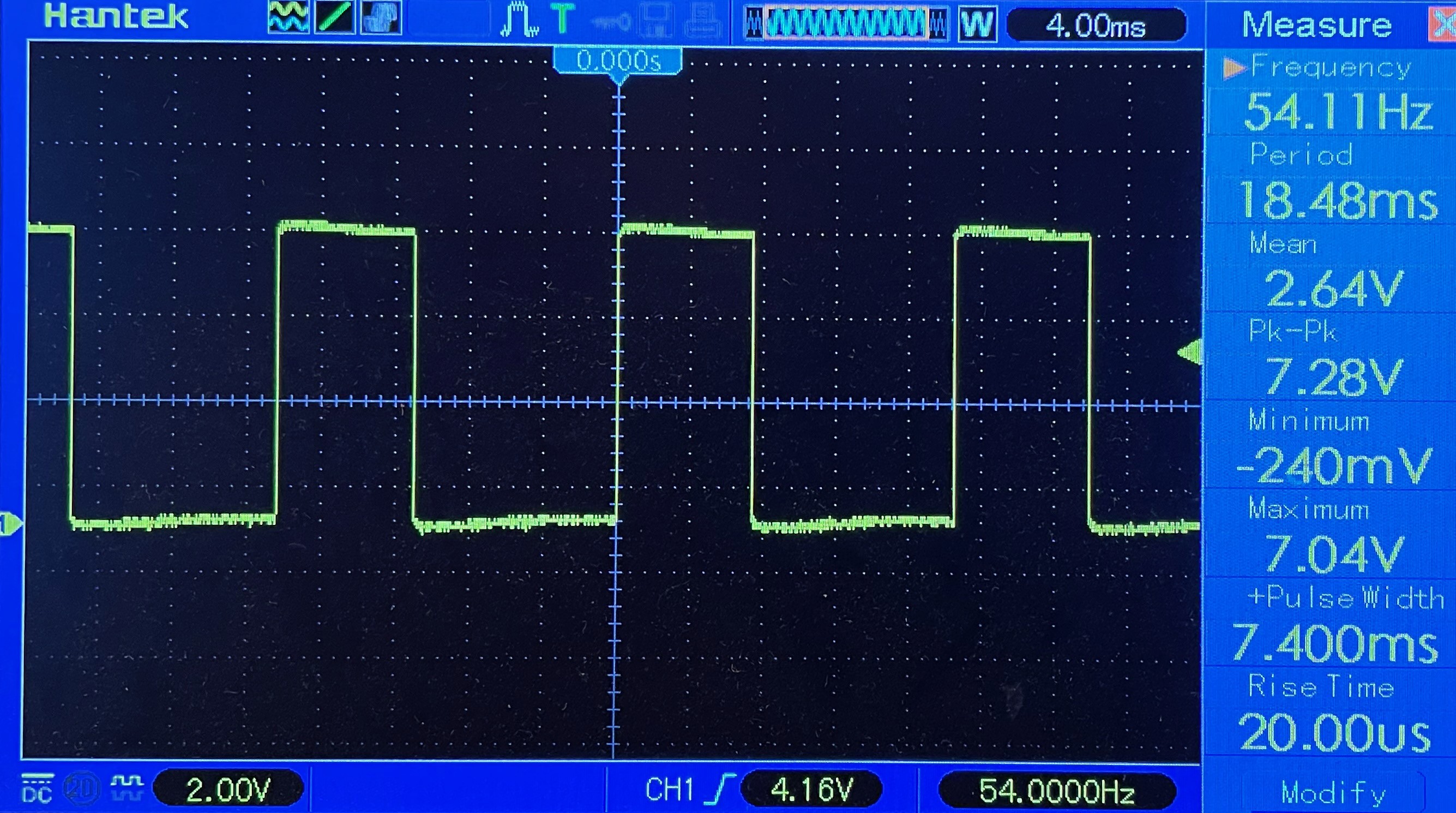

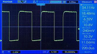

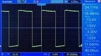

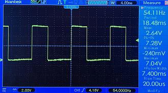

                      Regarding your PWM measurements, you should see the following traces on the various TP points going from the PWM input on H37-1 through to the Driver output/ FET Gate input on H22 (yes that should be H22 in the manual) and with the Driver off (SW5 off).
                      H37-1 and H17-1/2 where you should see the PWM square wave input as here, so about 7V max:
                      Click image for larger version  Name:	H37-1 (& H17).jpeg Views:	0 Size:	850.3 KB ID:	74167
                      H13-1/2 where you should see the inverse of the above but it will probably look the same timing-wise on the scope. If not then replace the 2N3904 and repeat
                      Click image for larger version  Name:	H13.jpeg Views:	0 Size:	527.1 KB ID:	74168
                      H16-1/2 where you should see a similar square wave but I expected a lower voltage as it enters pin 2 of the Driver. It reads 100V since I noticed later that I moved the x10 switch on the probe, so really it's 10.0V.
                      Click image for larger version  Name:	H16 .jpeg Views:	0 Size:	532.2 KB ID:	74169
                      H22-1/2 there should be a similar square wave of increased voltage to 'hard drive' the FET gate for rapid switch on and off. Again this is really 12.6V max.
                      Click image for larger version  Name:	H22.jpeg Views:	0 Size:	887.1 KB ID:	74170
                      If not then switch out the IR2121 chip and repeat.
                      These checks should allow you to zoom in on the problem.
                      Regards,
                      Julian

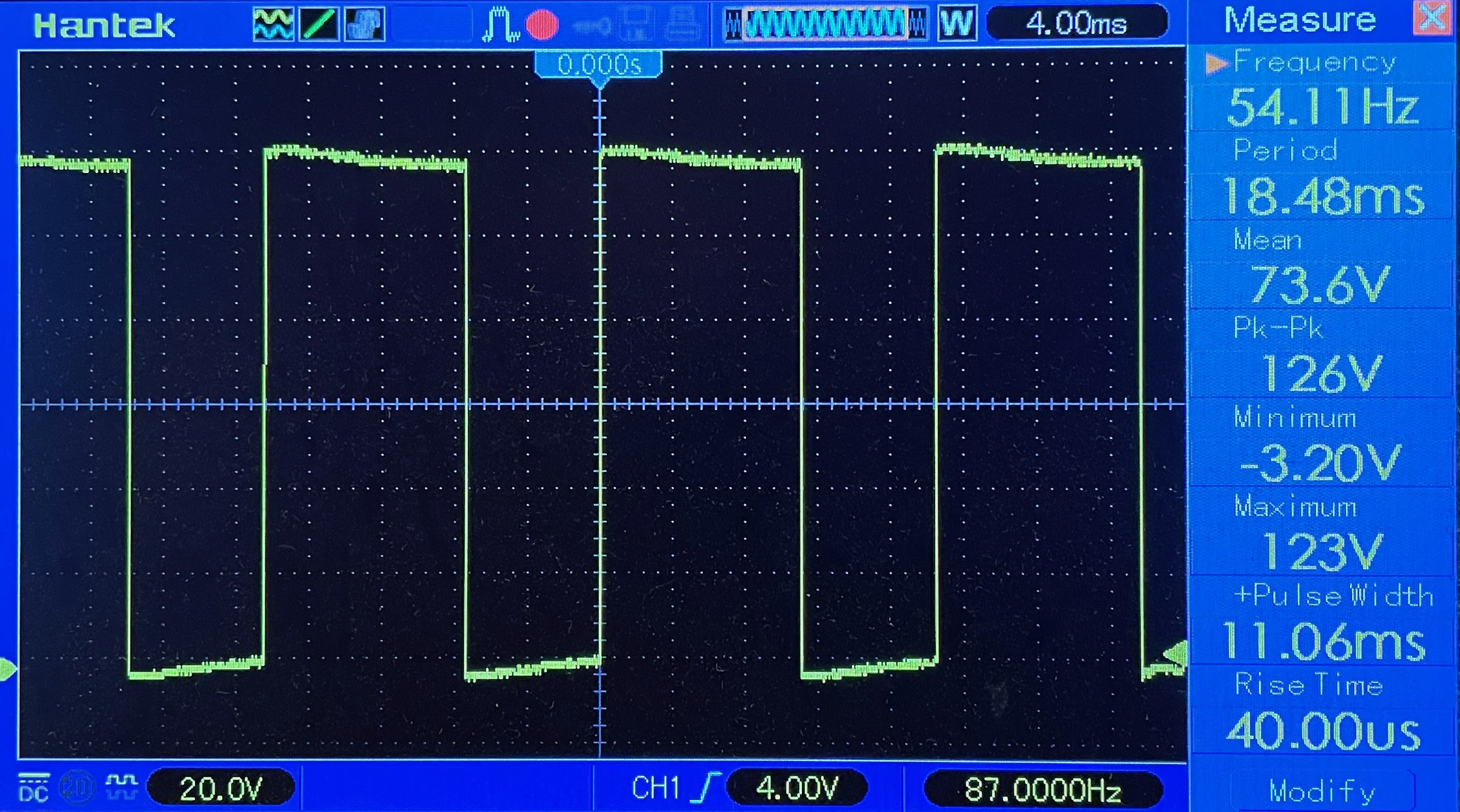

                              Hi Julian,

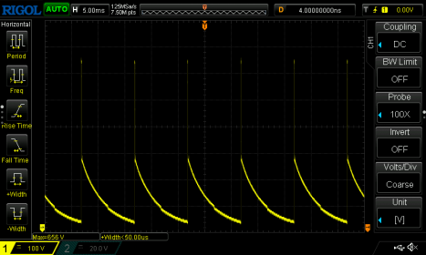

                              Some quick HV pulse measurement results with the following setup:
                              -100:1 probe between H19 and H10/H14:
                              -IRF840 as active device
                              -100Hz / 50% duty cycle
                              -Input battery voltage under load: 12.07V
                              (-Input battery voltage @ rest: 12.13V)
                              -Air coils (no core material) 62.31mH/coil: 656V (see image below)
                              -Welding rod as core material, 267mH/coil: 632V
                              The max voltage of the peaks seemed to be climbing slightly when leaving the machine run. E.g. with the welding rods it started out at +/-596 and climbed to 632V. It might have climbed a bit further if I would have left it on longer.
                              Regards,
                              Rodolphe
                              Click image for larger version  Name:	2023-05-28 - HV pulses - Air core 62.3mH - 100Hz, 656V.png Views:	15 Size:	47.8 KB ID:	74211
                              Last edited by pearldragon; 05-31-2023, 11:54 AM. Reason: peak voltage of air core and welded rods core were swapped, corrected them

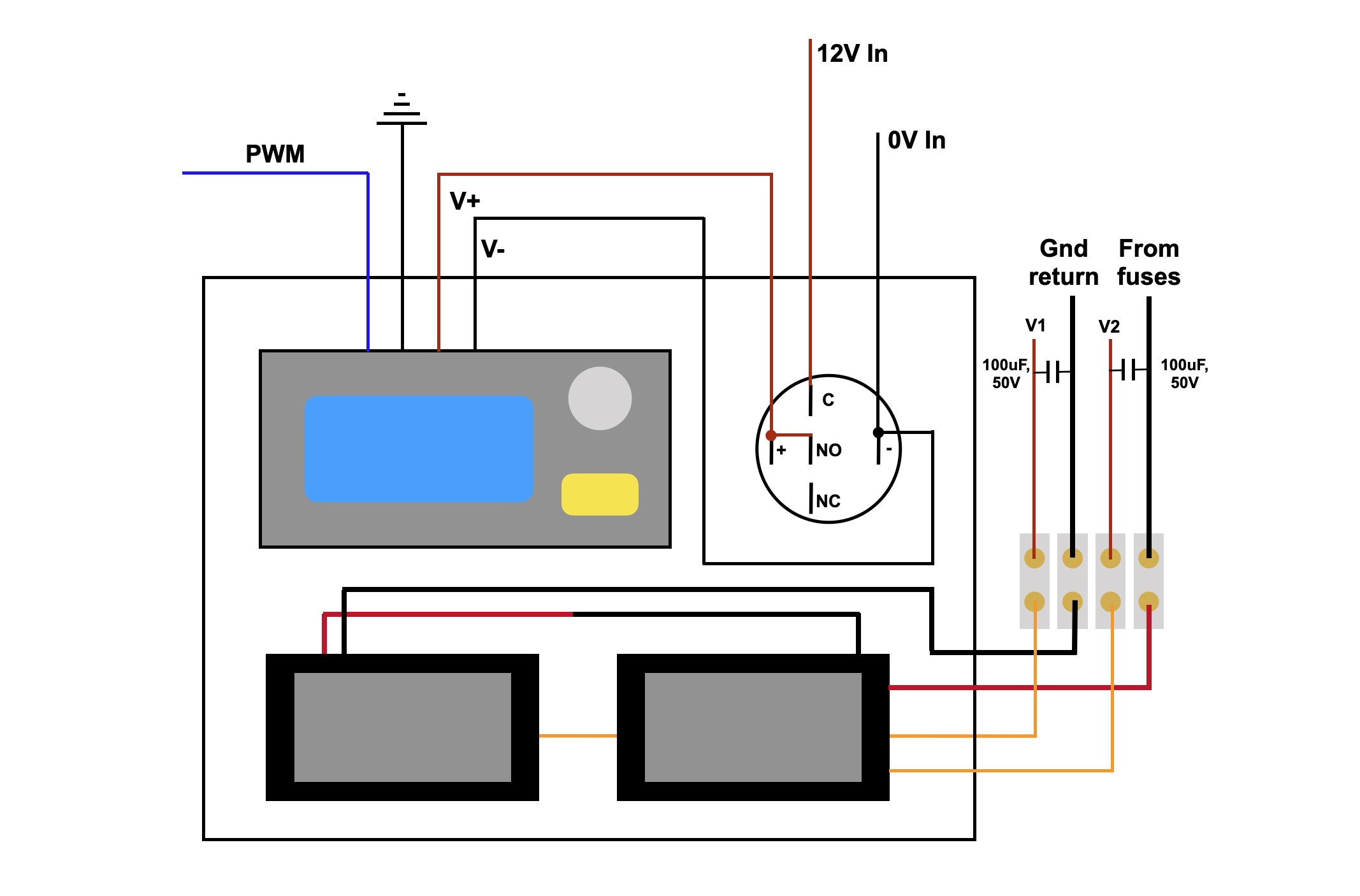

                              • #90

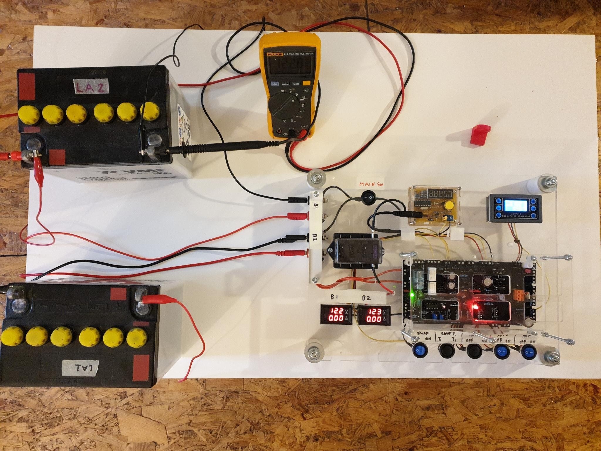

                                I'm sorry I forgot to include the issue of spike effects on the meter. Yes, initially I had a similar issue with the meters being unable to cope with the HV spikes being added to the DC voltage, although the main battery should normally act as a sink for them to effectively dampen them, so theoretically they should not reach the meters.
                                What I did was put two small capacitors (100uF, 50V) across the negatives and the meter voltage feeds as shown in the attached graphic and the photo, and that seemed to solve the problem.
                                Click image for larger version  Name:	PWM & Meters.jpg Views:	0 Size:	164.2 KB ID:	74214
                                Click image for larger version  Name:	Meter cap placement.jpg Views:	0 Size:	839.3 KB ID:	74215
                                The graphic shows the wiring for the panel that holds the PWM module, with its own On-Off switch, and the two small (not very accurate) panel meters.
                                Your spike voltages are good for the device used (IRF840) although seem to be switching off slower, hence the curved slopes. Off course the time base you are using will change the appearance a lot.
                                J
                                PS. Please note that my inserting the ammeter into the negative line via the plug panel is not in fact the best place for it to get an accurate reading. I found that going from the supply battery directly to the meter and then out to the negative line was best. I can give more info on that if you need. Of course, with battery swapping, you can't really use a digital meter since when the meter is in battery line during the charging stage, it won't like the spikes and may damage it so I used the configuration shown with swapping off for the CoP tests, and also similarly when substituting the supply battery with a PSU.
