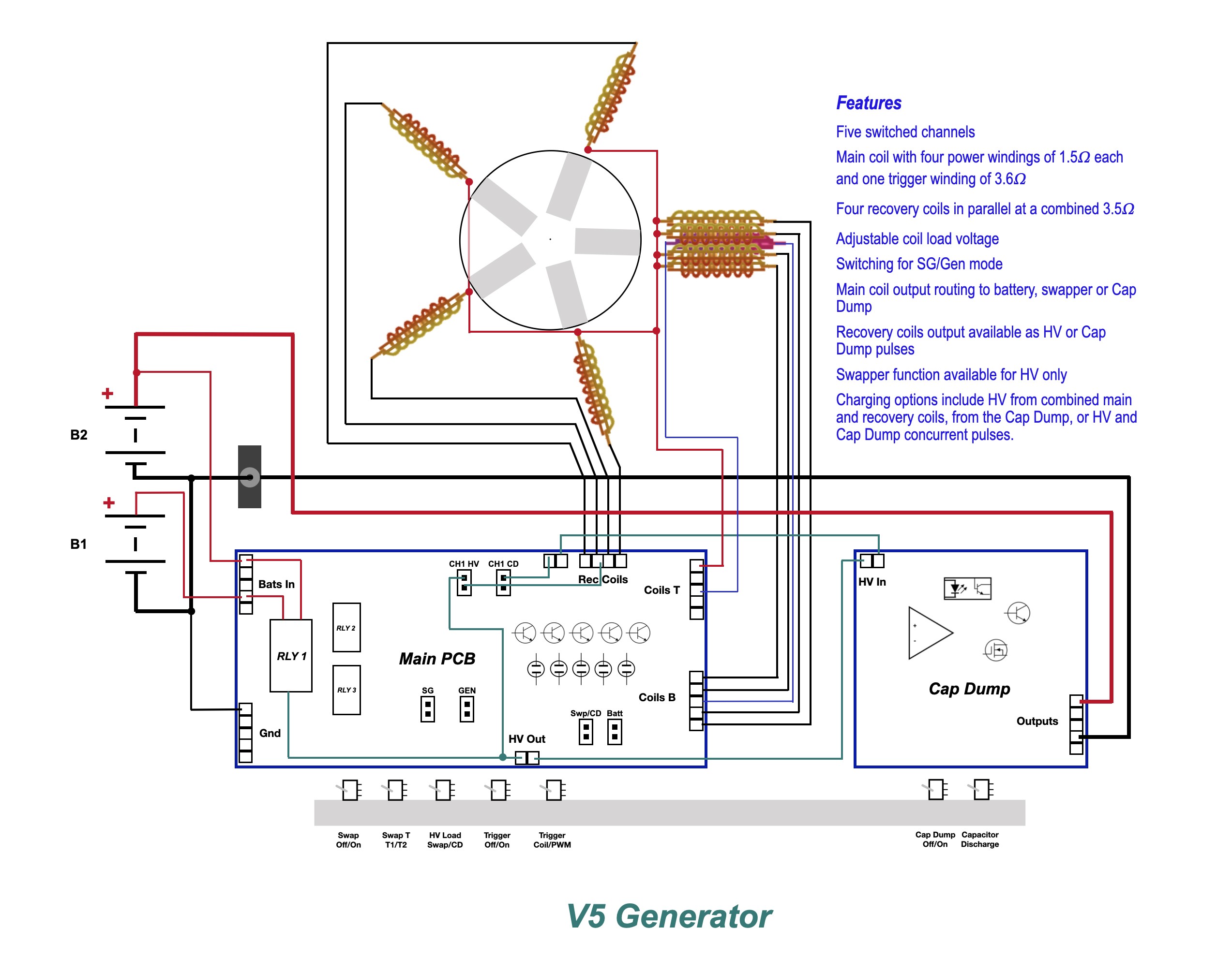

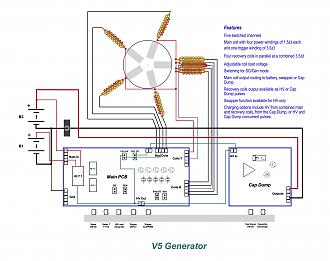

              I will clarify my coil arrangements and also those of the impending v5:
              In my SSG there is one coil with a power winding and a trigger coil. In my v5, which is the v4 developed and informed by my ‘retro’ work with the SSG (BD1 circuit), I have wound the main coil with four power windings and one trigger coil. The other four out of five spaces for coils will use the v4 coils as additional recovery coils. With the five switched channels available, four will be used with the MC and the remaining single channel will operate with the four recovery coils in parallel.
              This is all shown in the layout image together with notes on the various charging options. I would expect the most effective charging to be seen with the HV (from the MC) concurrent with cap dump pulses derived from the recovery coils via the cap dump unit.
              Click image for larger version  Name:	V5 Generator Layout.jpg Views:	0 Size:	457.9 KB ID:	74371
              As indicated, one can use just one channel of the v5 such that it will be in effect the BD-1 and with the revisions.

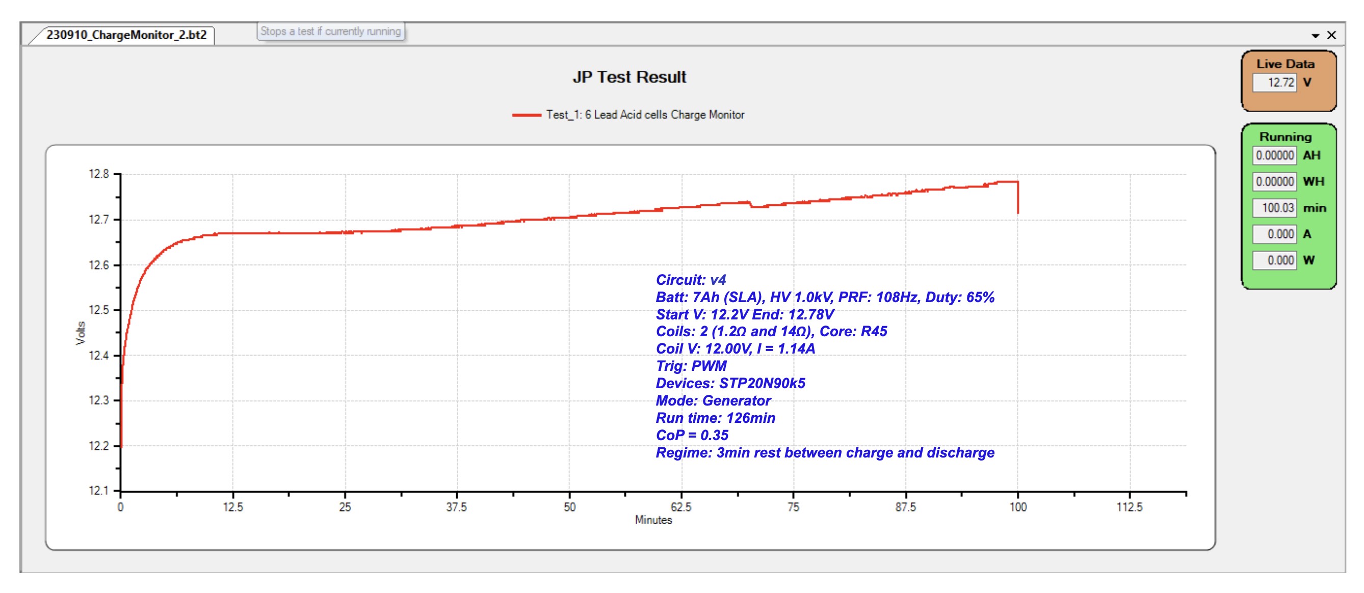

              V4 EXPERIMENTS
              Regarding the supply current flow, having just wound my new MC (4+1), I thought I would do a test using the v4 board on a small 7Ah battery.
              I connected up just one of its four coils and also one of the recovery coils and the current was about 1.2A. This resulted in a faster voltage rise in the battery and a shape similar to what you have obtained with your v4. But again, after 2 hours I still only reached a 12.8V peak, falling back slowly. I then did a discharge and derived a CoP of 0.35.
              Here is the graph:
              Click image for larger version  Name:	Charging curve.jpg Views:	0 Size:	276.5 KB ID:	74372
              I think there is more that is similar now between our v4s than before, but it’s still not clear how and why you can get a 12Ah battery up to 15V after only a few hours. I’m less concerned by that than I was but it is annoying.

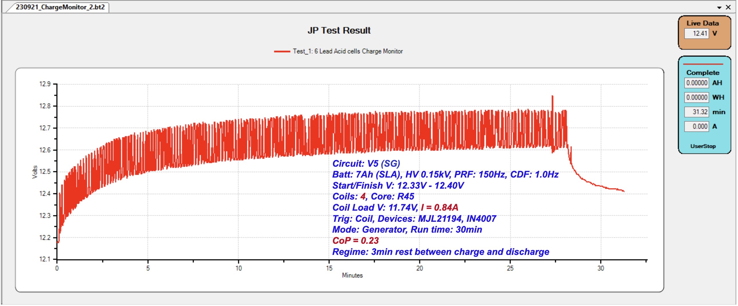

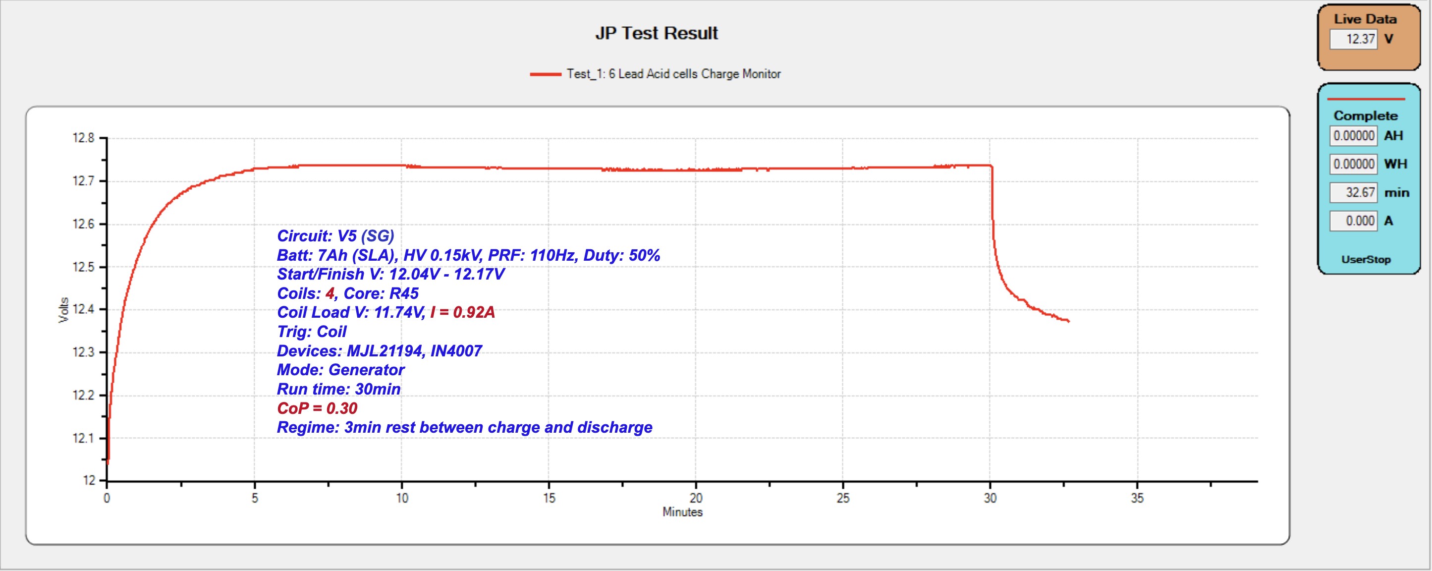

                    Low Input Currents:
                    A figure of 0.25A for input current is about what I found with the BD1 and any higher and it erodes the CoP value since the denominator is increasing in the CoP energy calculation.
                    This is seemingly a problem with the v5 I am testing which has four windings in its MC. The current is four times higher but the charging effect is not up by the same factor. Maybe using a REAC will improve matters.
                    Here are some V5 charging graphs, the upper with HV from the 4 winding MC and the lower from the cap dump unit.
Name:	V5 Charging 1.jpg
Name:	V5 Charging 2.jpg
                    After doing most of my tests with a small 7Ah AGM battery, I am now starting with a 110Ah deep cycle battery. Everything takes a lot longer though!

                      #129 Low Input Currents:
                      If I look at the first image of your graph there, it looks exactly like my graphs. To me it just seems you would need to let it run for waaaaay longer… that dimple you see, it is the same in my graphs, only after that the voltage starts rising slowly again.
