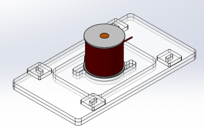

What you’re saying is: if the gap is too close, you couple the coils, and the drag/load will be noticeable in the SG output performance, whilst when sufficient space is between the coil, you only capture stray flux, and the effect is not noticeable on the SG output. And because you/I only capture the stray flux, I do need to put the windings in series to get an high enough output of the 2nd coil. Correctly summarized like that?
