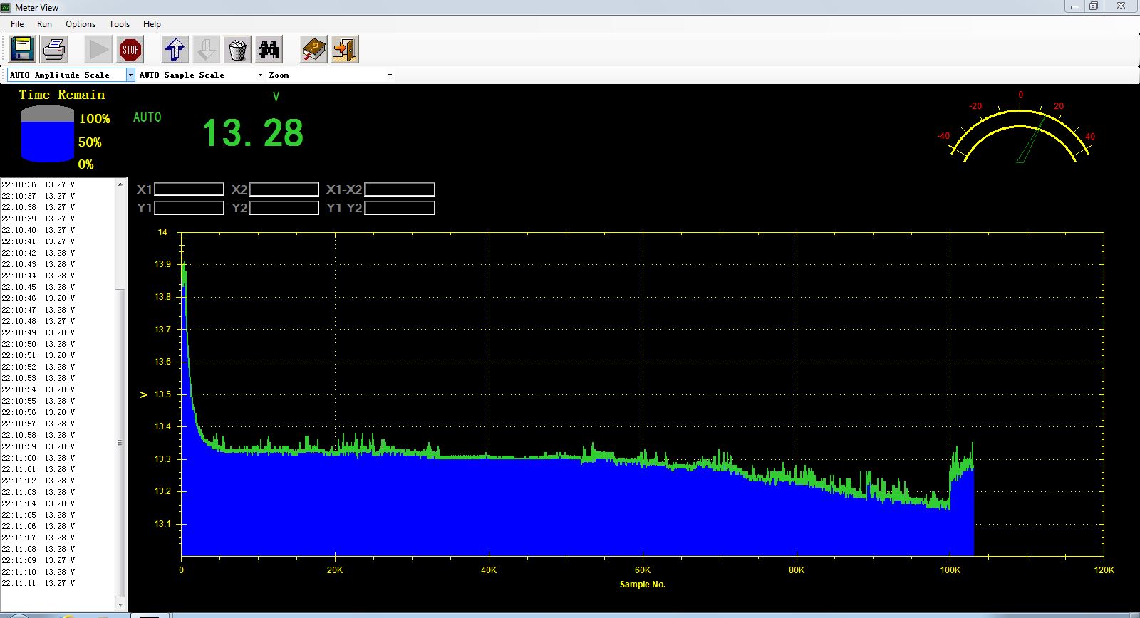

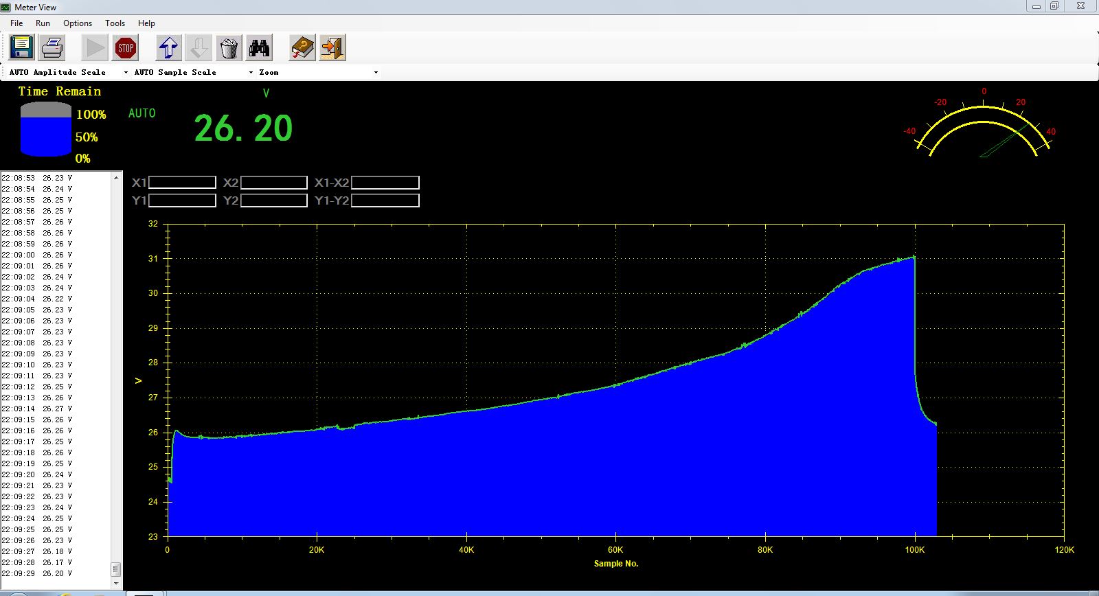

          Today I am showing this LifePO4 pack being used in bedini tech. Faraday didn't elaborate much with his statement but I think what he was trying to say is the same as I will say here now. Lithium batteries make awesome primaries for many reasons. One of the biggest reasons is that you get almost no voltage drop across a run. You can see this in the chart below. This run was approximately 28 hours at 1A and the primary hardly sagged at all.
          The run was done on a SSR solid state mode one type of circuit. On the front we have the battery that this thread is about and on the back we had two garden batteries in series. These garden batteries were very depleted although you would not know it looking at their starting voltage. These batteries always bounce back up to a fairly high voltage no matter where I drag them down too, I think in part because of the radient charging they have received. I did not mention it in the video but I had actually run these down to about 9v by accident the night before with them as a primary in parallel. They had bounced back to around 12.2 from that and that is where they got setup for this charge.
          Anyway here are the charts:

            that is a great run bob! I love the lithiums for primaries!! I use the LiFePo4 with a cap on the front on some of my runs, they seem to like it there, and the cap buffers the spike nicely.
              Thanks Tom. Yes I know what you mean with the cap, I have done that too. Originally I had this board setup with a very small cap on front and back and another SSR to control a dump for the output (notice the blank space on the board opposite of the 1st SSR), but I decided to go pure mode one with it for now. I change things around on my setups pretty often and am never really married to one setup for too long. This little board would make a fantastic portable unit though. I am thinking about getting a small solar panel, maybe 20 watt just for this unit to operate on. To me that is the huge advantage of going solid state, the sun can come out or hide and it will just go with it, no problem with a wheel stalling.
