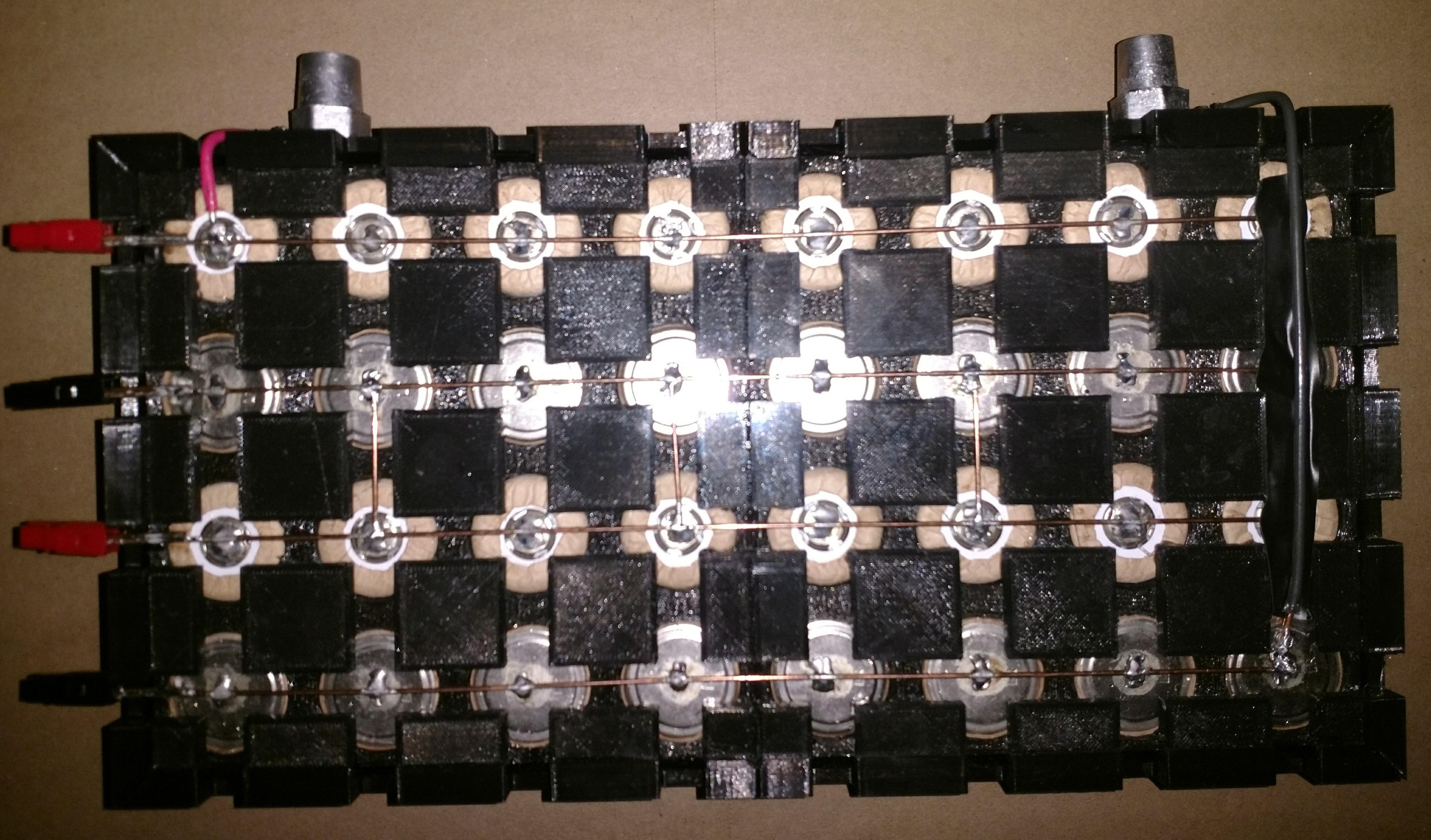

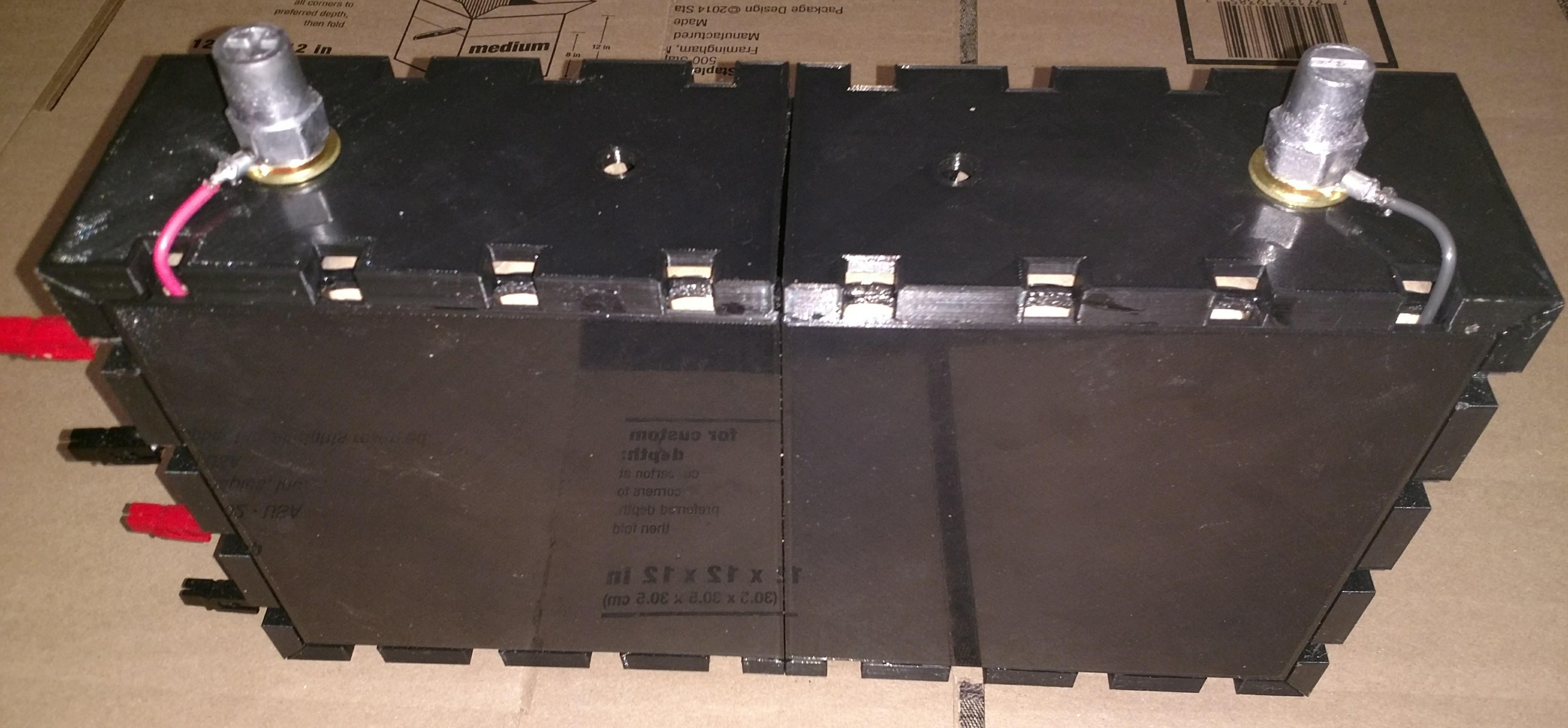

      Hello Group,
      I finished my prototype build of the 44AH LifePO4 pack. I think it turned out great. I have not had time to post the files yet but I will try to get them posted soon if anyone wants to use them.
      So I used the anderson plugs on the ends for connecting the charge bleeder boards. These are the same ones I used on the earlier packs (red ones) from this post. Those boards are a little expensive so I have designed all of my packs to use the same ones and I can just move them around when charging, you do not need them attached when running loads. So that is what you see coming off the sides in the picture below. I used some auto battery side bolt to post converters to make posts on the top and fastened a ring terminal between a brass washer and the post to make the connection. One of the big features of this pack vs the original red ones I made is that each cell is suspended in it's own place so they are not just all glues together. There are vent holes all around to let heat escape, although I usually don't run them hard enough for heat to be a problem it's still a much smarter design this way.
      Here is a picture with it all wired up before I put the outer covers on.

      And here is the finished battery.
      I am charging it up right now but I will try post a discharge curve in a few days to see how it performs.

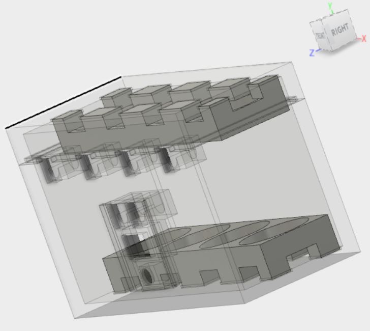

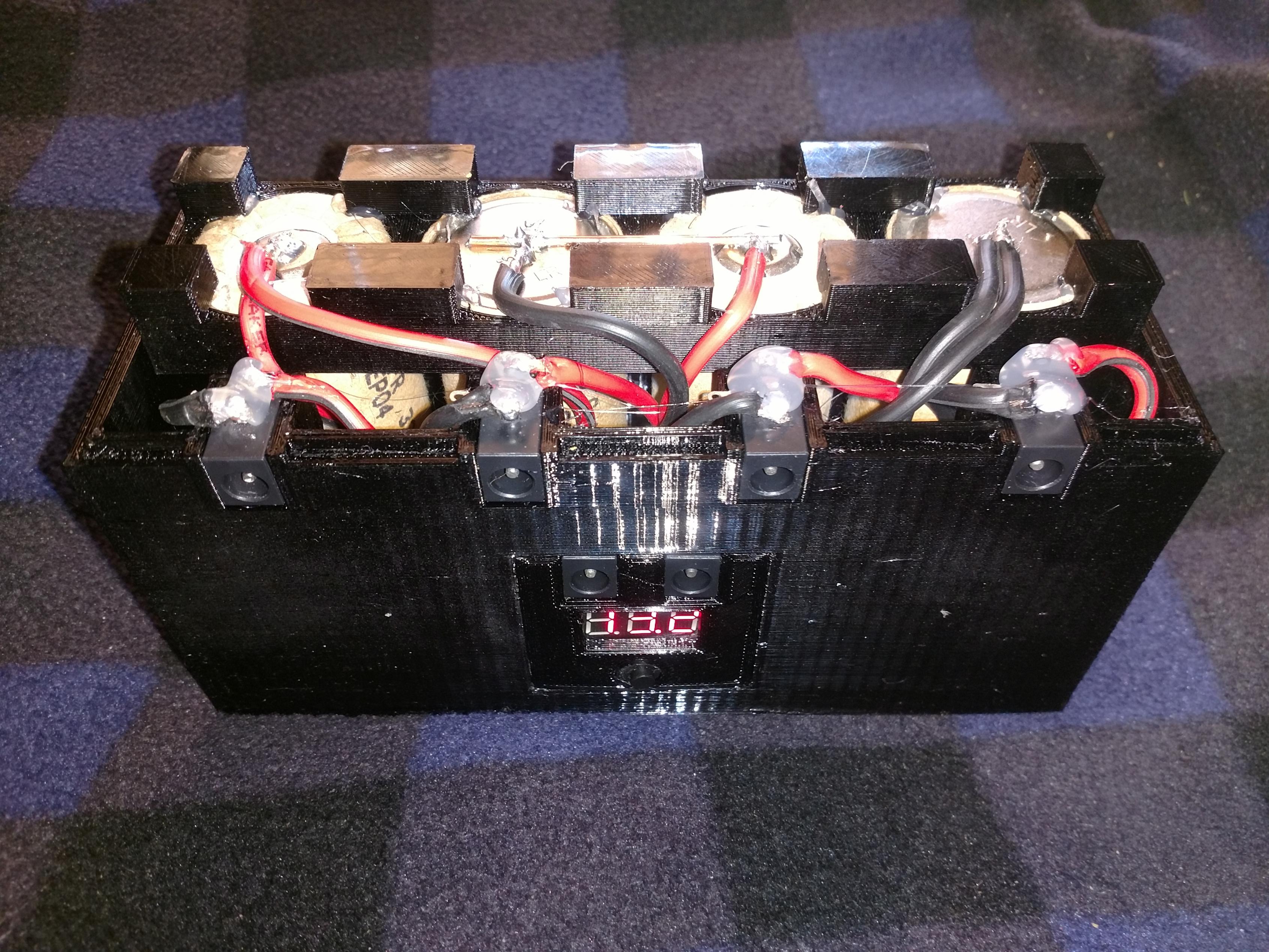

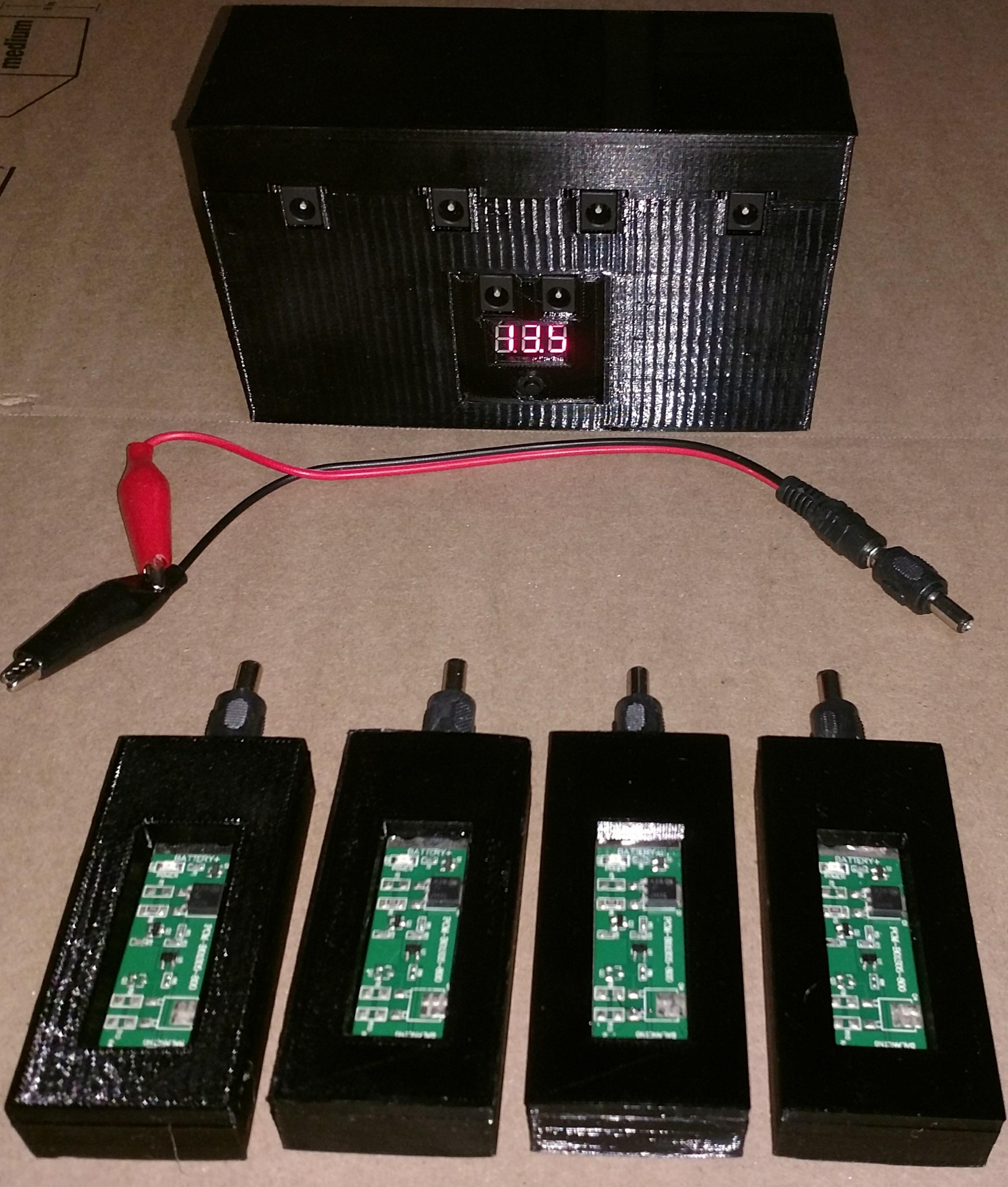

              Hello group,
              I have a few pictures of a prototype battery box using the LFP cells. On this particular one I was having issues with my printer when I printed the bottom half but it came out usable so I went ahead with building it. The next one will look better. What this has is 4 LFP cells in series with two 12v jacks on the front to connect standard 2.1mm dc jacks to. I didn't need posts on this small one but larger ones I will add them. The other jacks across the top are connected across each cell for balance boards. For larger packs I will just build backwards on the rows in parallel with the first of each.
              I have been running my medium size machine on it quite well which pulls about 700ma. I also have done away with the power pole plugs for connecting the bleeders that I used on the models before this one and am using male to male adapters and jacks which are so much nicer. I printed little boxes for the bleeder boards to hide the wiring and protect them.
              Anyway I just thought I would share some pics of this little battery made from LFP cells.

              Here is is with the lid off.
Name:	BZ-LFP 4CBox-2.jpg
              And a transparent mechanical drawing so you can see better what we are looking at
Name:	BZ-LFP 4CBox - angle.JPG
