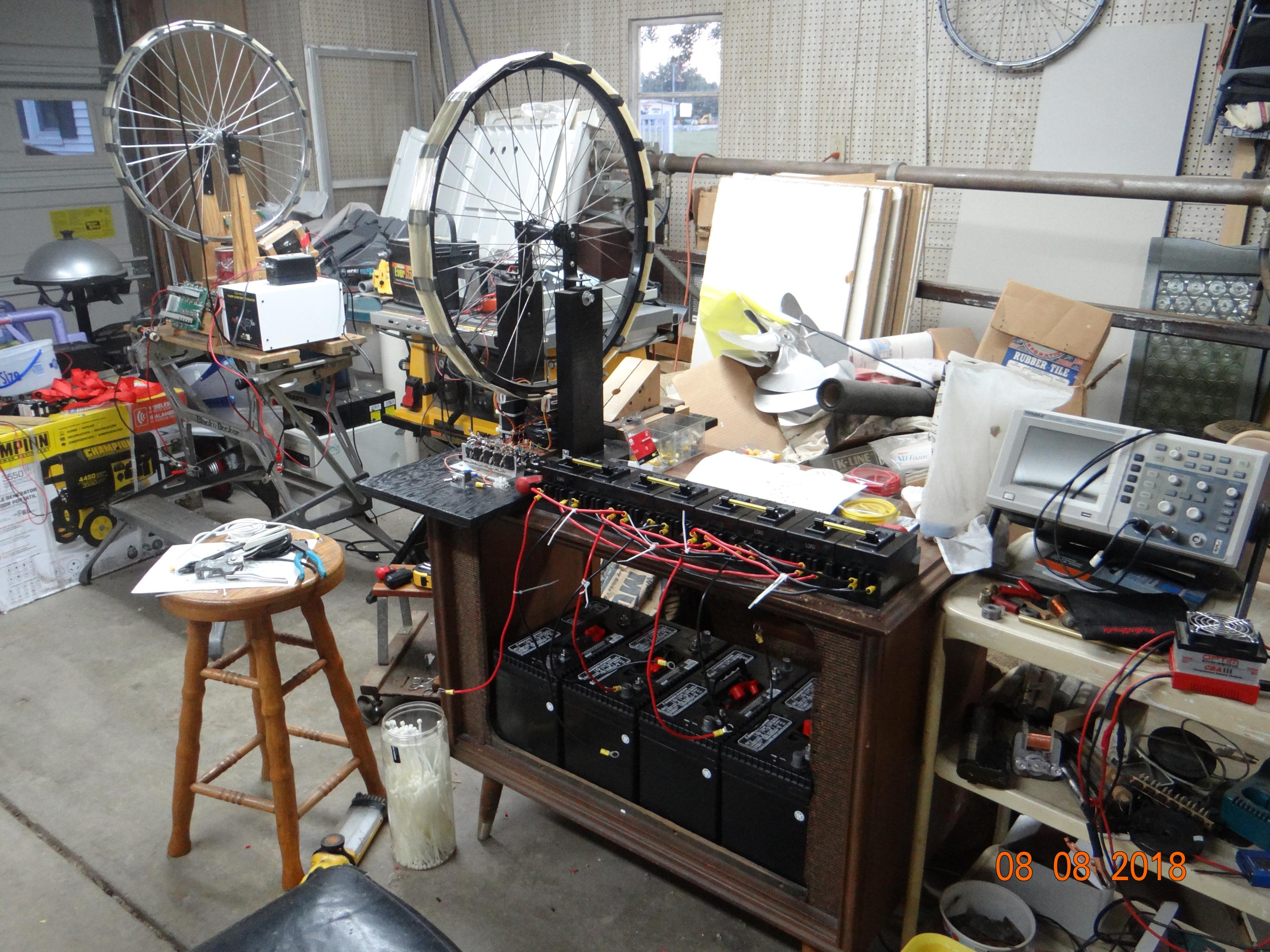

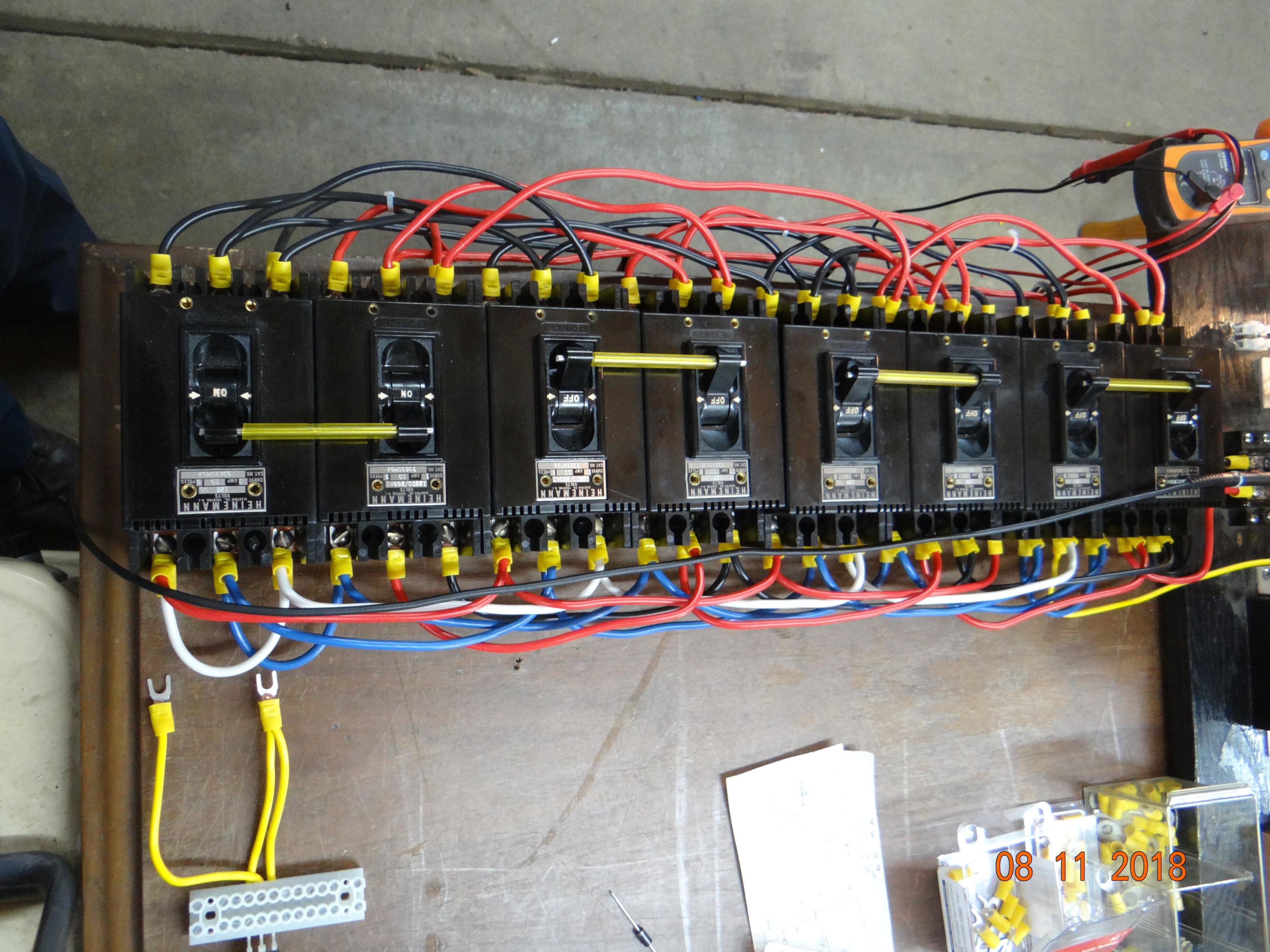

            Been working on modifying my old SSG and wiring up a "poor man's split the positive" battery rotation to drive it. I'm wiring everything up with 10 gauge wire. This is the SSG that I changed over to hall triggering a few years back. It's coil will use 4 power strands of 18 gauge wire and a separate strand of 18 gauge wire to harvest the spikes.
            Here's a couple of pics of the progress so far.

              good going Gary, i bet those breakers were not cheap....
                Hi RS,
                Thanks. I think I got a deal on old surplus items, they were only $12.99 each plus shipping. I ganged them together in pairs with stainless welding rod through the toggles.

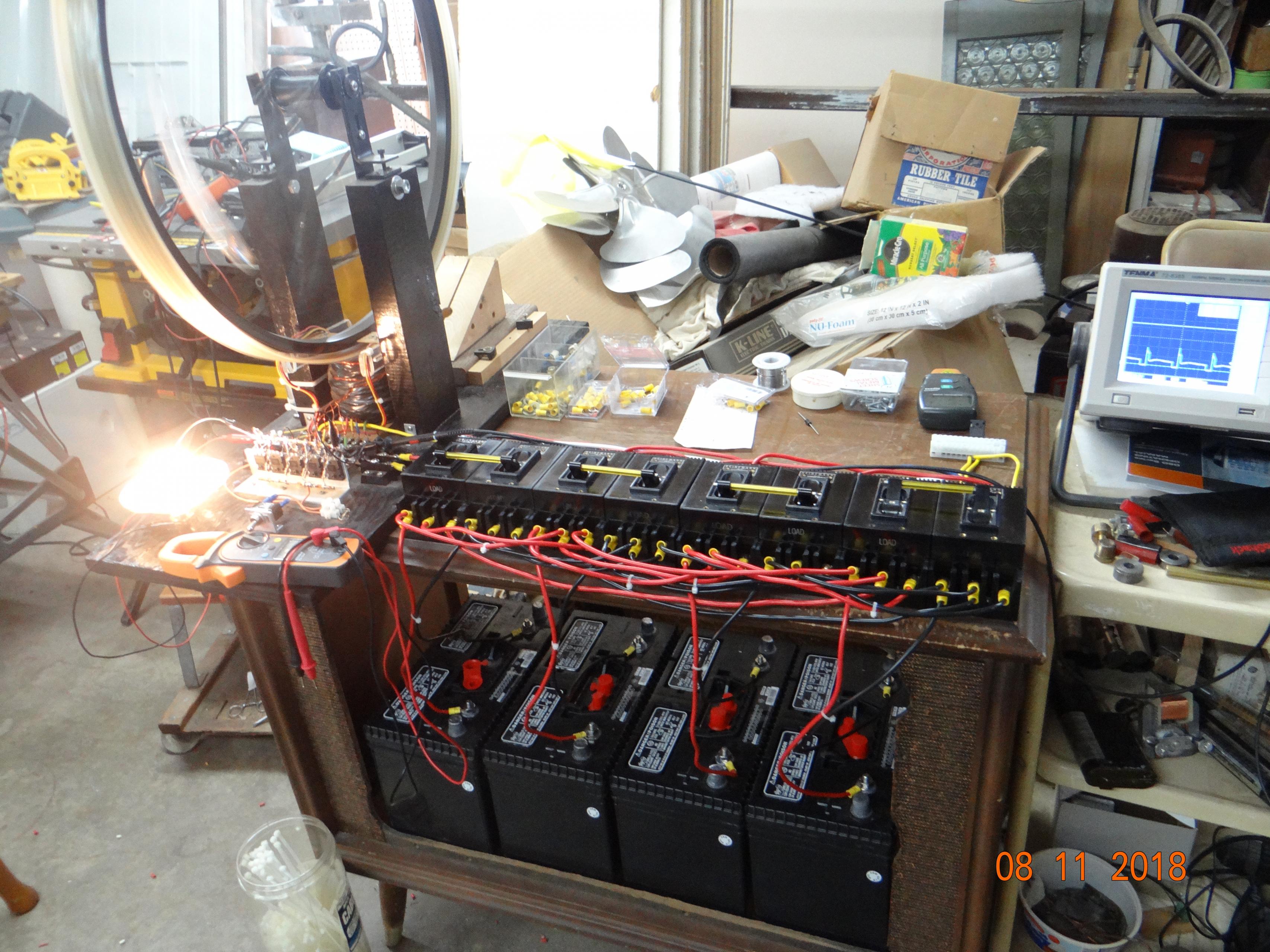

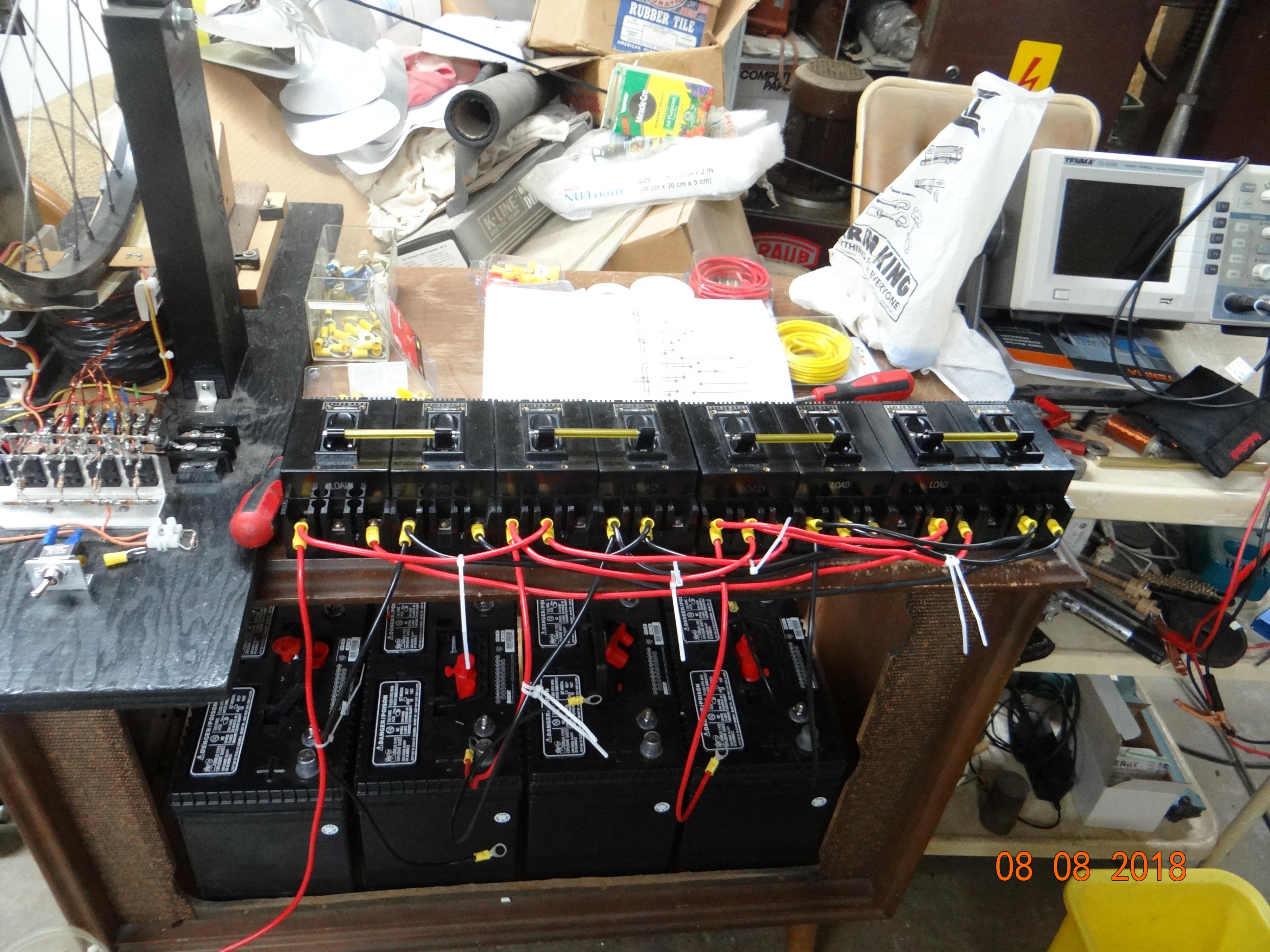

                    Got my split the positive battery rotator all wired up last night and tried it out. All the batteries had been fully charged a few days ago and were sitting at 12.8 volts. First thing I did was pull 6AH out of the battery in the charge position with my CBA III. It came back up to about 12.7 volts.
                    I ran thru a complete rotation of all four batteries charging each one in turn up to about 13.3 volts. The one I had discharged took over an hour and the others varied from 30 minutes to 45 minutes. The SSG was only pulling 0.75 amps, so getting to a higher charge voltage was going to take a lot longer than I had anticipated. Took the Bradley GT to a car show this morning so didn't get back to the SSG til this afternoon.
                    Since the c20 rate of these batteries is 5.25 amps, I decided to add an additional load in parallel with the SSG by hooking a 35 Watt headlamp across it. This brought the current flow thru the batteries up to 3.25 to 3.5 amps depending on which battery was being charged. With the light in the circuit it is taking about 15 minutes to bring each battery up to 13.8 volts except for the one I discharged first. I'm in the process of giving it a longer charge time and stopping it at 13.5 volts.
                    I'm hoping to get all of them equalized and topping out at 13.8 volts in 15 minutes. This may take awhile. But it appears, just starting out, that the load is running mostly off the radiant and maybe stealing the surface charge.

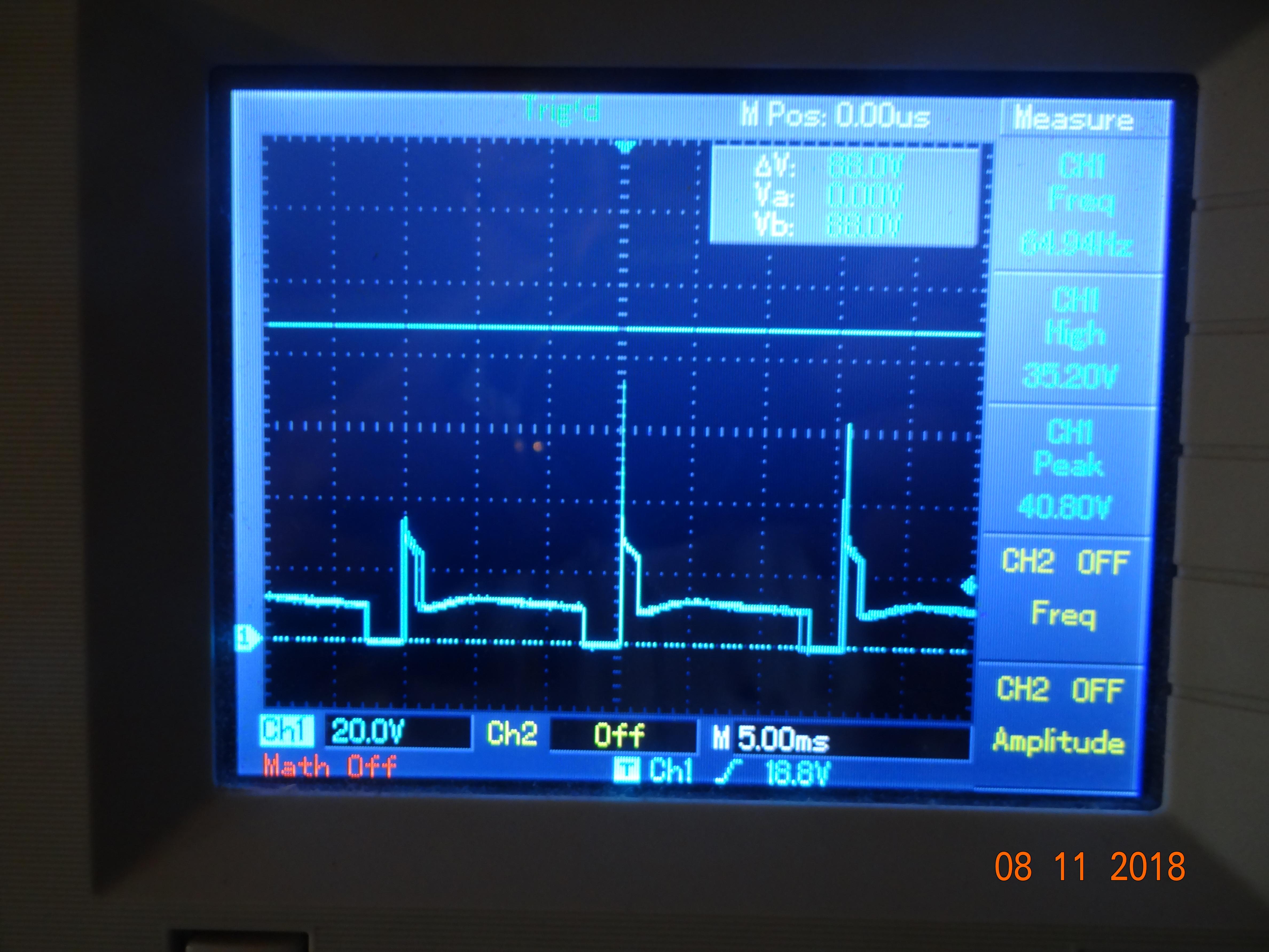

                    Adding the fast diode between the buses didn't help at all. It actually reduced the size of the radiant spike and lowered the charge rate, so it's running with the buses wired directly together. The batteries must be absorbing all the spike as it doesn't show much at all when scoping the radiant collection winding (2.16 volts without the 30 watt headlamp installed). But the transistors show an 80 volt spike without the headlamp installed, and a 50 volt spike with it.
                    Here are some photos of it running.

                      Well that isn't happening. After running for several hours each battery was either taking longer to charge to the same voltage or if always charged the same length of time would charge back to a lower voltage. So all the batteries were very slowly loosing charge.
                      The batteries must be absorbing all the spike as it doesn't show much at all when scoping the radiant collection winding.
                      I scoped again directly across the radiant collection winding with the 30 watt headlamp in the circuit and it showed about a 15 volt spike. About 1/3 the value of what was appearing across the transistors. I think I need a stronger SSG with more collection windings for this to work properly with these size batteries.
