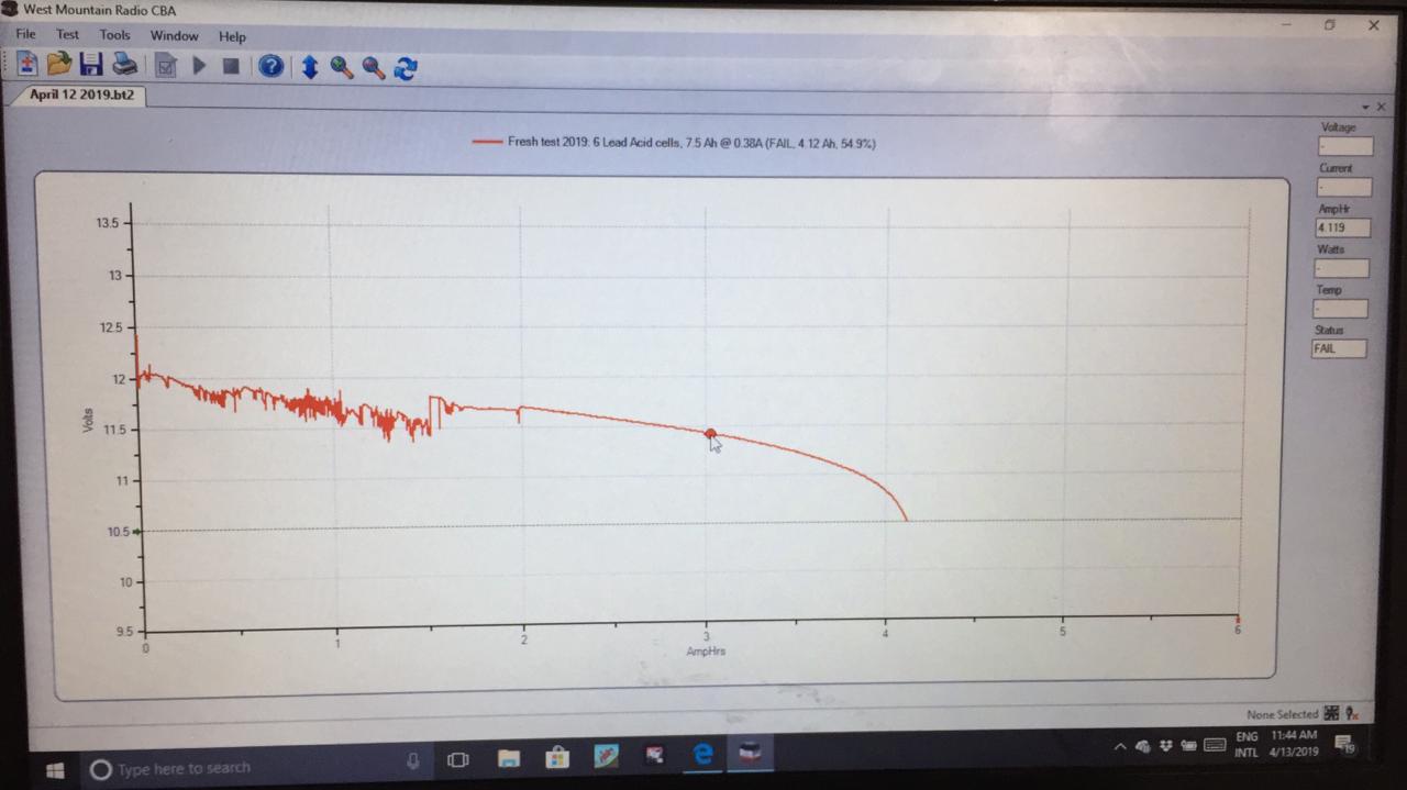

                  Load testing and COP calculation underway...Qualitatively though the batteries seem to give out more the more you load them (kind of a anti-Puerkt law) and charge right up faster (DC Resistive load) this is in premise with what JK said in his post earlier. attached CBA discharge profile @C20 rate. This Battery measured 12.29V when purchased. I was looking for batteries in the range 13.25V or above since these would reliably of good quality. to my surprise the gel cells in the shop were all in the same range of 12.35-40V
                  Over the years the quality of these gel cells have declined. None of the previous batteries I purchased have stood up the test for a capacity test.
