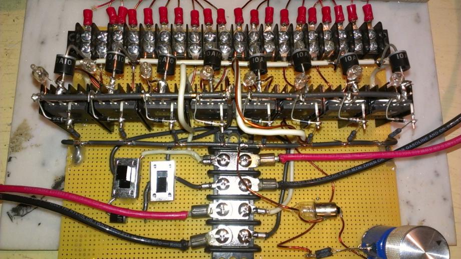

    I built a new board that I want to share with the group. I have it configured as a solid state charger at the moment but it may get converted to mechanical at a later time.
    This board is using 10A diodes on the collector, 200Ohm wire wound 1 percent resistors on the base. The coils are from Teslagenx 130ft 18Awg 4 strand (two of them) and a 2k Ohm pot.
    To start out this post I am going to do some "normal" runs with charts so we can observe it in mode 1 at various inputs and later on I will start adding in my tricks like Gen mode and cap dumping. We will just start out with basic runs though.
    Here are some shots of the board:

      - Is it really necessary to have 10A diode? they seem to be over sized for the job.

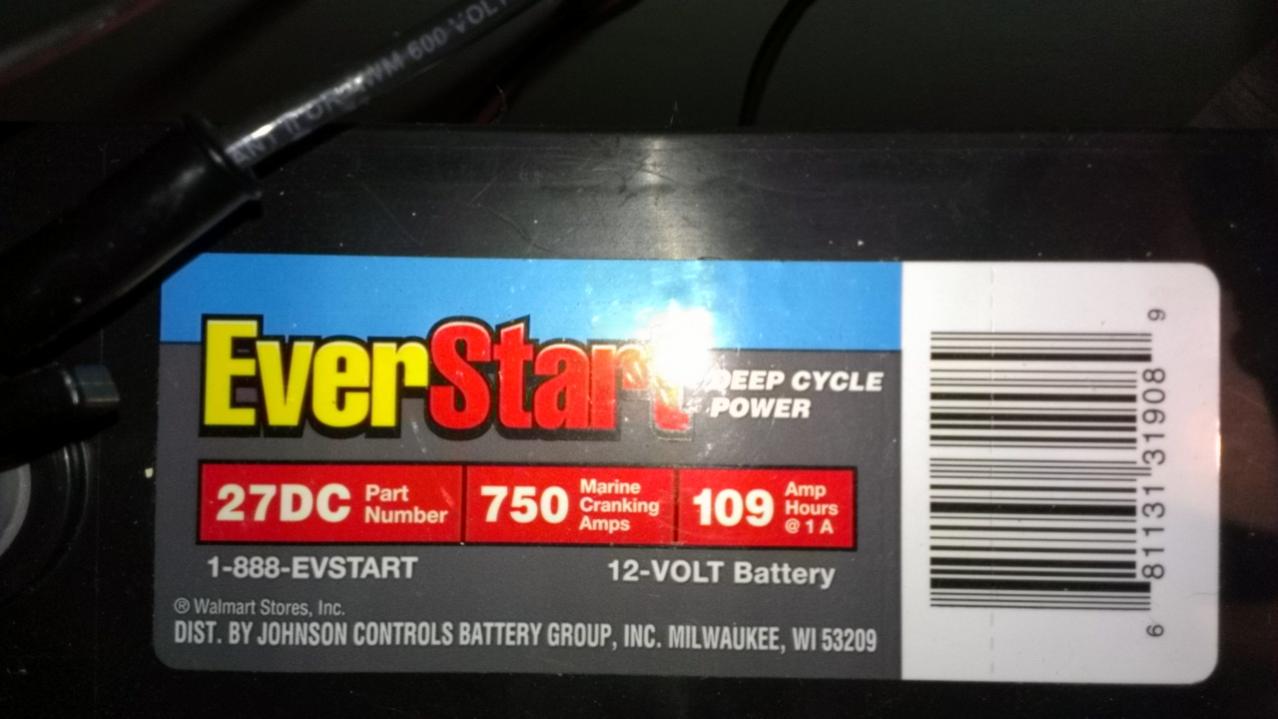

        That is a great question but I do not know the actual rating of this battery. On the sticker it says "109AH @ 1A" now what the fook does that mean? I have tries to find actual C rates for this thing but cannot.
        Here is a link to the page for them:
        http://www.walmart.com/msharbor/ip/16795212
        I do have some other AGM's, actually the one in that video is a true 100AH with 4A c20 but I am doing the run now with the walmart batteries on both ends. Basically to answer your question I will run higher than a C20 usually, more like c30 or 40. That will be part of the series I am going to do charts on for this post though. Right now I am doing a run drawing 1.5 , I will do another at maybe 3 so we can compare.

        No the 10A diodes are not necessary, I am using them because I intend to run this thing hard occasionally and especially gen mode will push more current than the original.

          so C ratings are the number of amps at a given number of hours it will provide. 109/20=5.45 amps for 20 hours. 80 percent of that is 87.2 amps at C20. that is unreasonable from the standpoint of actual usage. temperature, state of the plates, and what is called the peukert effect, allow higher ratings above C100. they are telling you what the C109 rate is. so they expect this battery to be used very lightly to run a few led's or something, its a very disengenuos rating...... but if you are running an SG under 1 amp, it should run a few days before needing recharging. the peukert effect is one of those little "secrets" that allow batt manufacturers to expand the claims of their batteries.
          from wikipedia
          Peukert's law, presented by the German scientist W. Peukert in 1897, expresses the capacity of a battery in terms of the rate at which it is discharged. As the rate increases, the battery's available capacity decreases
          everyone should know this, it will help you analyse your batteries true capacity and cop figures. it leads to some questions like what happens if you run your primary BELOW its self discharge rate? or run a battery above C100? will the primary stay charged on an SG?
            Thanks tom, I was pointing out their bull**** way of stating the capacity but I didn't elaborate. Any normal company would provide a C20 rate but they want sheeple to think they are getting a 109AH (C20) for 80 bucks Lol. Most people would look at another brand which says maybe 40AH c20 or whatever and then see this one and go wowo it says 109AH

            For giggles here is a up close of this deceptive sticker:

            The battery is sold for trolling motors primarily I would say your estimate is about right. The trolling motor is not going to pull a steady load and not constant either as you only bump it on here and there to get around coves when out fishing but those bumps are probably between 3 - 6 A. Anyway people who use them for this purpose seem to think they are pretty good batteries. I got them because they were cheap and at least they are flooded. All of my other deep cells are those AGM's that I have had since before I Knew better. They are good too but you have to be careful about drying those out.
